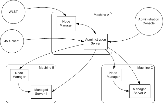

Figure 2-1 illustrates the relationship between Node Manager, its clients, and the server instances it controls.
Figure 2-1 Node Manager in the WebLogic Server Environment

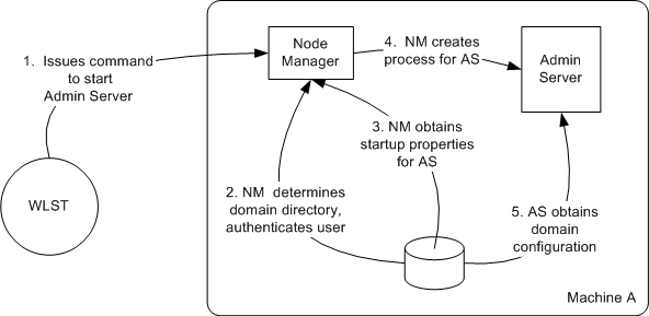

Figure 2-2 illustrates the process of starting an Administration Server with Node Manager.
This section assumes that you have installed the Administration Server and created its domain directory using the Configuration Wizard.
Node Manager is running on Machine A, which hosts the Administration Server. The stand-alone Node Manager client is remote.
Figure 2-2 Starting an Administration Server
An authorized user issues the WLST offline command nmConnect to connect to the Node Manager process on the machine that hosts the Administration Server. (If the Node Manager instance is the SSH version, the user can connect using the SSH client). The nmConnect command provides the Node Manager username and password that are used to authenticate the user with the Node Manager.
Then, the user issues the nmStart command and provides the credentials for starting the Administration Server. For example:
prps = makePropertiesObject("username=weblogic, password=welcome1")
nmStart("AdminServer",props=prps)
If the user has previously connected to the Node Manager, aboot.properties file exists, and the user does not have to supply username and password.The nmStart command identifies the domain and server instance to start.
Node Manager looks up the domain directory in nodemanager.domains, and authenticates the user credentials using a local file that contains the encrypted username and password.
Node Manager obtains the startup properties for the Administration Server.
Node Manager creates the Administration Server process.
The Administration Server obtains the domain configuration from its config directory.
After the Administration Server is running, you can update the user credentials and startup properties using the WLST online command,nmGenBootStartupProps.
Alternatively, when the Administration Server and Node Manager are running, you can update the user credentials and startup properties in the Administration Console, on the AdminServer > Configuration > Server Start page. The Administration Server then pushes the updates to the running Node Manager and the Node Manager writes the information to the disk.

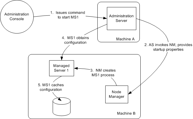

Figure 2-3 illustrates the process of starting a Managed Server with Node Manager.
Node Manager is running on Machine B, which hosts Managed Server 1. The Administration Server for the domain is running on Machine A.
From the Administration Console, the user issues a start command for Managed Server 1.
A stand-alone client can also issue a start command for a Managed Server.The Administration Server issues a start command for Managed Server 1 to the Node Manager on the Machine B, providing the remote start properties configured for Managed Server 1. For information about the arguments and how to specify them, see Step 5: Configuring Remote Startup Arguments.
Node Manager starts Managed Server 1.
Node Manager starts the Managed Server using the same root directory where the Node Manager process is running. To run the Managed Server in a different directory, set the Root Directory attribute in the Server > Configuration > Server Start Administration Console page.
Managed Server 1 contacts the Administration Server to check for updates to its configuration information.
If there are outstanding changes to the domain configuration, Managed Server 1 updates its local cache of configuration data.

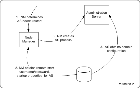

Figure 2-4 illustrates the process of restarting an Administration Server with Node Manager.
Node Manager is running on the machine that hosts the Administration Server. The Administration Server, which was initially started with Node Manager, has exited. The Administration Server's AutoRestart attribute is set to true.
If a server instance'sAutoRestart attribute is set to false, Node Manager will not restart it.Figure 2-4 Restarting an Administration Server
Node Manager determines from the Administration Server process exit code that it requires restart.
Node Manager obtains the username and password for starting the Administration Server from the boot.properties file, and the server startup properties from the server_name/data/nodemanager/startup.properties file.
Node Manager starts the Administration Server.
The Administration Server reads its configuration data and starts up.

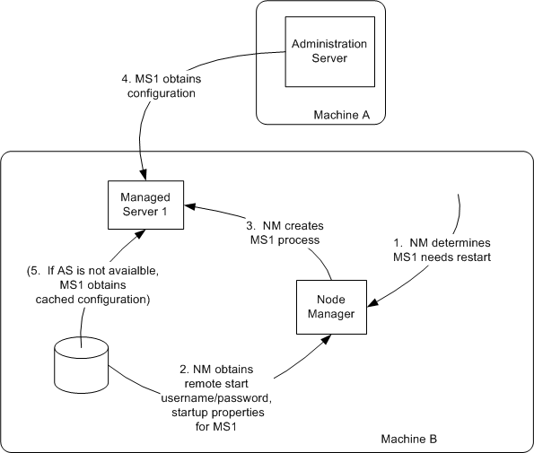

Figure 2-5 illustrates process of restarting a Managed Server with Node Manager.
Node Manager is running on Machine B, which hosts Managed Server 1. Managed Server 1, which was initially started with Node Manager, has exited. Managed Server 1's AutoRestart attribute is set to true.
If a server instance'sAutoRestart attribute is set to false, Node Manager will not restart it.Node Manager determines from Managed Server 1's last known state that it requires restarting.
Node Manager obtains the username and password for starting Managed Server 1 from the boot.properties file, and the server startup properties from the startup.properties file. These server-specific files are located in the server directory for Managed Server 1.
Node Manager waitsRestartDelaySeconds after a server instances fails before attempting to restart it.Managed Server 1 attempts to contact the Administration Server to check for updates to its configuration data. If it contacts the Administration Server and obtains updated configuration data, it updates its local cache of the config directory.
If Managed Server 1 fails to contact the Administration Server, and if Managed Server Independence mode (MSI) is enabled, Managed Server 1 uses its locally cached configuration data.
Managed Server Independence mode is enabled by default.Figure 2-6 illustrates the communications involved in shutting down a Managed Server that is under Node Manager control. Depending on the state and availability of the Managed Server, Node Manager might need to try alternative strategies to successfully initiate the shutdown.

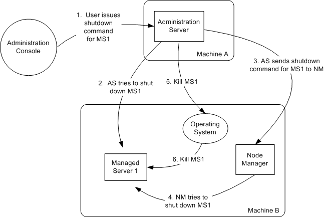

Figure 2-6 Shutting Down a Server Instance Under Node Manager Control
Through the Administration Console, an authorized user issues a shutdown command for Managed Server 1.
The Administration Server issues the shutdown command directly to Managed Server 1. If it successfully contacts Managed Server 1, Managed Server 1 performs the shutdown sequence described in "Graceful Shutdown" in Managing Server Startup and Shutdown for Oracle WebLogic Server.
If, in the previous step, the Administration Server failed to contact Managed Server 1, it issues a shutdown command for Managed Server 1 to Node Manager on Machine B.
Node Manager issues a request to the operating system to kill Managed Server 1.
The operating system ends the Managed Server 1 process.

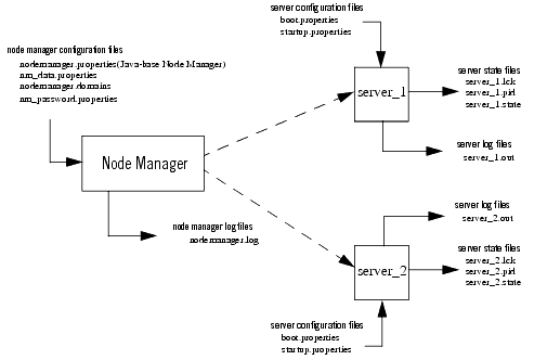

Figure 2-7 Node Manager Configuration and Logging Environment
The following sections describe Node Manager configuration and log files:
Except where noted, configuration files apply to both Java-based and script-based Node Manager.
This is the configuration file used by the Java-based version of Node Manager. See Reviewing nodemanager.properties.
This file is located in WL_HOME/common/nodemanager, where WL_HOME is the location in which you installed WebLogic Server.
This file contains mappings between the names of domains managed by Node Manager and their corresponding directories. See Step 4: Configuring nodemanager.domains File.
This file is located in WL_HOME/common/nodemanager.
This file stores the encryption data the Node Manager uses as a symmetric encryption key. The data is stored in encrypted form.
This file stores the Node Manager username and password. See Step 2: Specify Node Manager Username and Password.
This file is located in DOMAIN_HOME/config/nodemanager.
Node Manager uses this file to specify user credentials when starting a server. See General Node Manager Configuration.
This file is located in DOMAIN_HOME/servers/server_name/data/nodemanager.
Each Managed Server instance has its own startup.properties file with properties that control how Node Manager starts up and controls the server. Node Manager automatically creates this file by using properties passed to Node Manager when the Administration Server was last used to start the server. This allows a Node Manager client or startup scripts to restart a Managed Server using the same properties last used by the Administration Server.
For more information on startup.properties, see Step 6: Setting Server Startup Properties. These properties correspond to the server startup attributes contained in ServerStartMBean and the health monitoring attributes in ServerStartMBean.
server_name.addr stores the IP address added when a server starts or is migrated. This file is generated after the server IP address is successfully brought online during migration. server_name.addr is deleted when the IP address is brought offline. The server IP address is used to validate remove requests to prevent addresses being erroneously removed while shutting down the server.
server_name.lck is generated by each server and contains an internally used lock ID.
server_name.pid is generated by each server and contains the process ID of the server. Node Manager checks the process ID generated by the server during crash recovery.
server_name.state is generated by the server and contains the server's current state. Node Manager monitors the contents of this file to determine the current state of the server.
Do not delete or alter this file. Without this file Node Manager cannot determine the current state of the server.This file is located in DOMAIN_HOME/servers/server_name/data/nodemanager.

For each server instance that it controls, Node Manager maintains a log file that contains stdout and stderr messages generated by the server instance. If the remote start debug property is enabled as a remote start property for the server instance, or if the Node Manager debug property is enabled, Node Manager will include additional debug information in the server output log information.
You cannot limit the size of the log files Node Manager creates. Logging tostdout is disabled by default.This file is located in domain_name/servers/server_name/logs.
Node Manager creates the server output log for a server instance in the server instance's logs directory, with the name:
server_name.out
where server_name is the name of the server instance.
