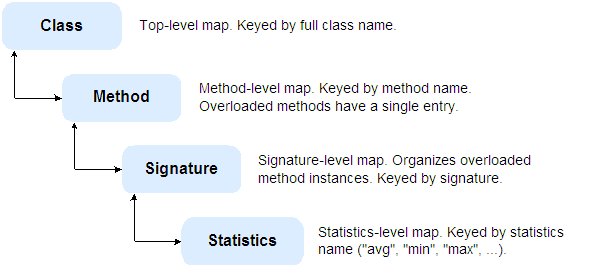

The WLDFInstrumentationRuntimeMBean instance for a given scope exposes the data collected from MethodInvocationStatisticsAction instances, which are attached to configured Diagnostic Around monitors, using the MethodInvocationStatistics attribute. The MethodInvocationStatistics attribute contains a hierarchy of Map objects, keyed as shown in Figure B-1:
Figure B-1 Structure of MethodInvocationStatistics Attribute
The following semantics are used in the MethodInvocationStatistics attribute:
MethodInvocationStatistics::= Map<className, MethodMap> MethodMap::= Map<methodName, MethodParamsSignatureMap> MethodParamsSignatureMap::= Map<MethodParamsSignature, MethodDataMap> MethodDataMap::= <MetricName, Statistic> MetricName:= min | max | avg | count | sum | sum_of_squares | std_deviation

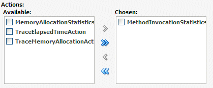

In the Actions table, assign MethodInvocationStatisticsAction to the custom monitor, as shown in Figure B-2:
Figure B-2 Choosing MethodInvocationStatisticsAction for Custom Monitor
Click Save, at the bottom of the Settings for MethodStatsMonitor page.

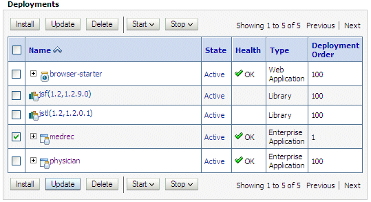

In the Domain Structure pane, select Deployments.
On the Summary of Deployments page, select Control, and click the selection box adjacent to medrec in the Deployments table, as shown in Figure B-3:
Figure B-3 Selecting the MedRec Deployment
Click Update.
In the Update Application Assistant page, select Redeploy this application using the following deployment files.
Click Next, then click Finish.

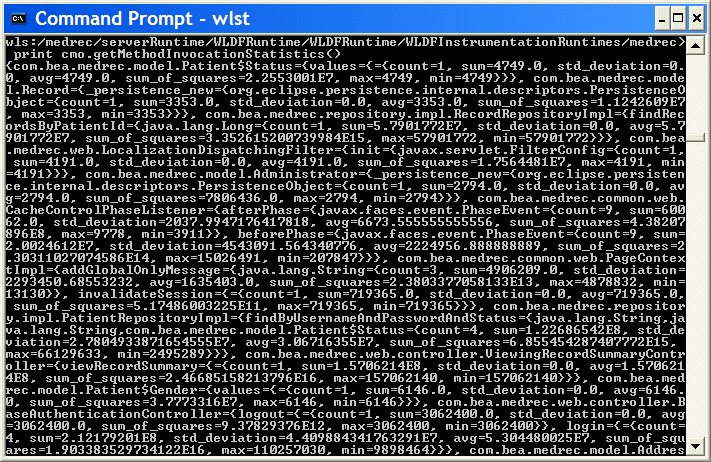

Note that if you display the entire set of data values that have been collected, a large amount of information could be displayed in the WLST console, as shown in Figure B-4:
Figure B-4 Displaying All Data Values Collected by MethodInvocationStatisticsAction
As an alternative, you can create a WLST script to invoke MethodInvocationStatistics and to format the collected data so that it is more easily read, as in the following example:

The following shows the output produced by the WLST script shown in Example B-1:
# Class Method | Count | Min | Max | Average | Std-dev | jsp_servlet.__index _isStale() | 1 | 1378000 | 1378000 | 1378000.0 | 0.0 | jsp_servlet.__index _getBytes(java.lang.String) | 3 | 1000 | 754000 | 252666.66666666666 | 354497.1399351795 | jsp_servlet.__index _staticIsStale(weblogic.servlet.jsp.StaleChecker) | 1 | 861000 | 861000 | 861000.0 | 0.0 | jsp_servlet.__index _jspService(javax.servlet.http.HttpServletRequest,javax.servlet.http.HttpServletResponse) | 2 | 70000 | 2113000 | 1091500.0 | 1021500.0 | jsp_servlet.__index$MyMap containsKey(java.lang.Object) | 2 | 2000 | 101000 | 51500.0 | 49500.0 | jsp_servlet.__index$MyMap containsValue(java.lang.Object) | 2 | 1000 | 2000 | 1500.0 | 500.0 |

The MethodMemoryAllocationStatisticsAction uses the JRockit API to track the number of bytes allocated by a thread during a method call. Statistics are kept in-memory on the memory allocations, and no instrumentation events are created by this action.
The MethodMemoryAllocationStatisticsAction is very similar to the existing MethodInvocationStatisticsAction. However, the statistics tracked by MethodMemoryAllocationStatisticsAction are related to the memory allocated within a method call.
The MethodInvocationStatisticsAction does not create an instrumentation event. When JRockit is available, the statistics are available through the WLDFInstrumentationRuntimeMBean.
The following statistics for each method are kept:
count
min
max
avg
sum
sum_of_squares
std_deviation
