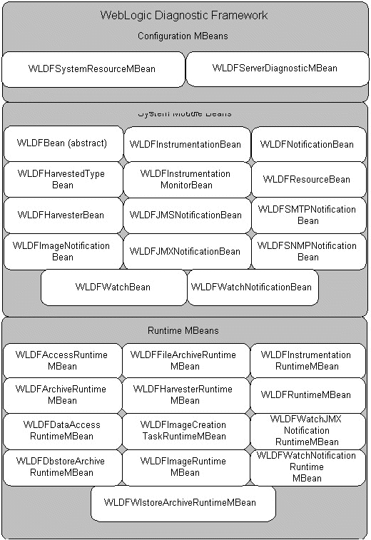

Table 16-1 lists the beans and packages associated with WLDF and its components. Figure 16-1 groups the beans by type.

Figure 16-1 WLDF Configuration MBeans, Runtime MBeans, and System Module Beans

The configuration and runtime APIs configure and monitor WLDF. Both the configuration and runtime APIs are exposed as MBeans.
The configuration MBeans and system module Beans create and configure WLDF resources, and determine their runtime behavior.
The runtime MBeans monitor the runtime state and the operations defined for the different components.
