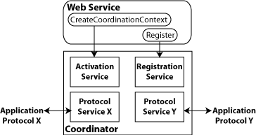

These specifications define an extensible framework for coordinating distributed activities among a set of participants. The coordinator, shown in the following figure, is the central component, managing the transactional state (coordination context) and enabling Web services and clients to register as participants.
Figure 10-1 Web Services Atomic Transactions Framework
The following table describes the components of Web services atomic transactions, shown in the previous figure.
Table 10-1 Components of Web Services Atomic Transactions
| Component | Description |
Coordinator |
Manages the transactional state (coordination context) and enables Web services and clients to register as participants. |
Activation Service |
Enables the application to activate a transaction and create a coordination context for an activity. Once created, the coordination context is passed with the transaction flow. |
Registration Service |
Enables an application to register as a participant. |
Application Protocol X, Y |
Supported coordination protocols, such as WS-AtomicTransaction. |

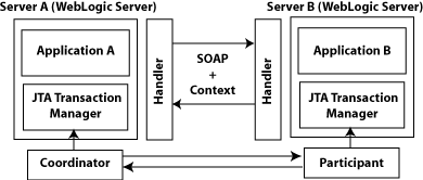

The following figure shows two instances of WebLogic Server interacting within the context of a Web services atomic transaction. For simplicity, two WebLogic Web service applications are shown.
Figure 10-2 Web Services Atomic Transactions in WebLogic Server Environment
Please note the following:
Using the local JTA transaction manager, a transaction can be imported to or exported from the local JTA environment as a subordinate transaction, all within the context of a Web service request.
Creation and management of the coordination context is handled by the local JTA transaction manager.
All transaction integrity management and recovery processing is done by the local JTA transaction manager.
For more information about JTA, see Programming JTA for Oracle WebLogic Server.
The following describes a sample end-to-end Web services atomic transaction interaction, illustrated in Figure 10-2:
Application A begins a transaction on the current thread of control using the JTA transaction manager on Server A.
Application A calls a Web service method in Application B on Server B.
Server A updates its transaction information and creates a SOAP header that contains the coordination context, and identifies the transaction and local coordinator.
Server B receives the request for Application B, detects that the header contains a transaction coordination context and determines whether it has already registered as a participant in this transaction. If it has, that transaction is resumed and if not, a new transaction is started.
Application B executes within the context of the imported transaction. All transactional resources with which the application interacts are enlisted with this imported transaction.
Server B enlists itself as a participant in the WS-AtomicTransaction transaction by registering with the registration service indicated in the transaction coordination context.
Server A resumes the transaction.
Application A resumes processing and commits the transaction.
