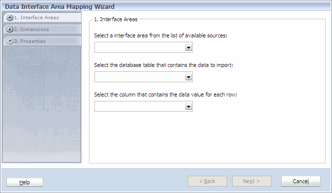

Select File, New, Data Interface Area Definition.
Select the interface table source, database table that contains the data to import, and the column that contains the data values for each row, and click Next.
Define the dimension by selecting a column on the left and entering the dimension name on the right. Then, click
to add more columns.
For example, if the column name is SCENARIO_DIMENSION_NAME, you can change the name displayed to “Scenario.”
Tip: | Click |
Enter the interface table name, optional description, and then click Finish.
