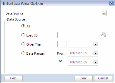

Options for the interface tables area:
To clear interface tables:
In the Dimension Library, select File, Import, Clear Interface Area.
Select the data source.
Select one of the options for the type of data source load information to clear.
You can enter multiple Load IDs separated by comma or can search for load IDs by clicking
Click Clear.
Click Yes to confirm.
Click OK at the success message.
