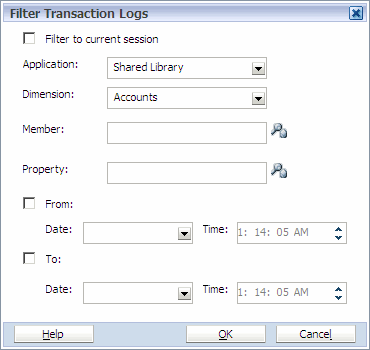

From the Dimension Library, select View, and then Download Transaction Logs or click
Select an application or select Shared Library to view all dimensions in the Shared Library.
Note: | You must at least select an application or Shared Library to filter the transaction logs. |
Note: | Only dimensions for the selected application or Shared Library are displayed in the drop-down list, and you can select only one dimension. |

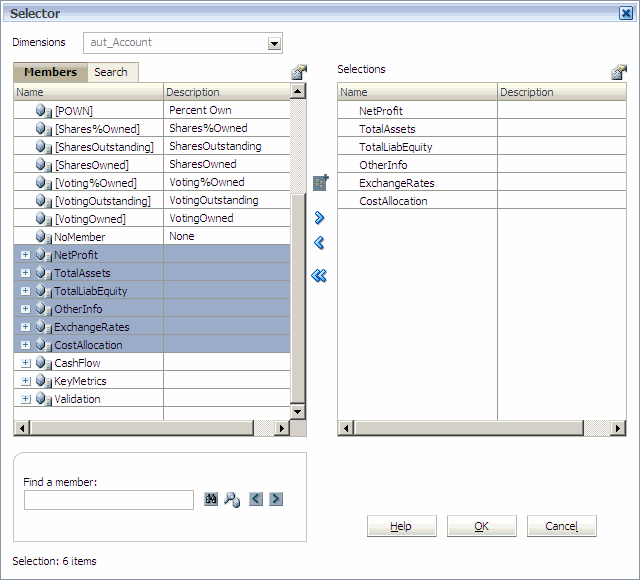

Optional: Click
to select one or more members to include in the log, and click OK.

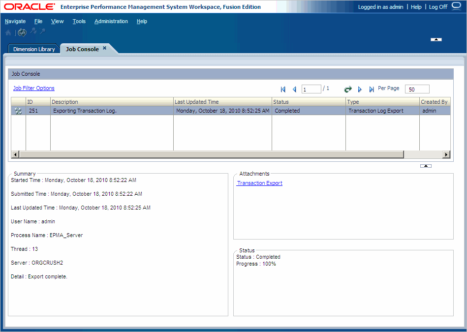

After the job is submitted, click the link in the message box to go to the exported transaction log.
In the Attachments area, click Transaction Export.
Select to open or save the transaction log.
