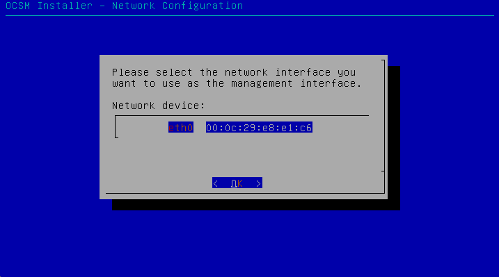

Select the network adapter that is to be used for the management Web interface. A list of the supported network interfaces together with their hardware addresses (MAC) is shown.
Figure 2-2 shows the network adapter selection screen.
Choose the interface to use for accessing Session Monitor. Access via this interface is required to finish the installation. Refer to the documentation of the machine for further information about the location of network interfaces.

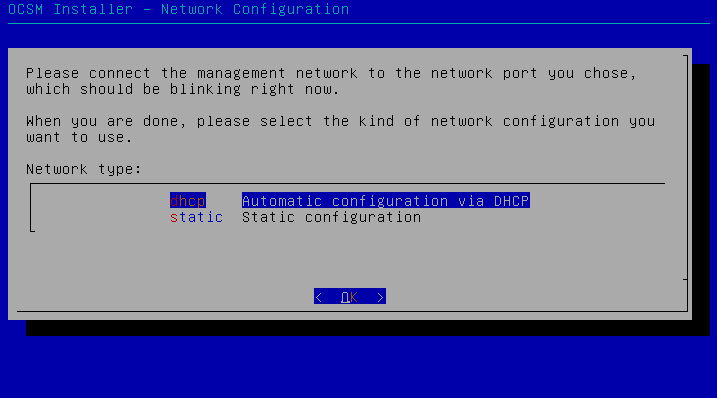

Select the IP configuration for the management network adapter. You can select to configure static IP settings manually or using DHCP.
Figure 2-3 shows the network adapter IP configuration selection screen.
No error checking is performed to validate the network configuration; verify your inputs before proceeding.Figure 2-3 Network Adapter IP Configuration Selection

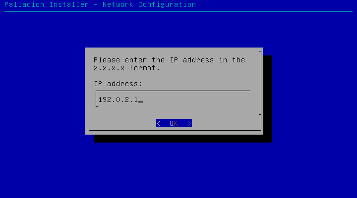

If you select static IP configuration, the installer prompts for the IP address, netmask, and the default gateway of your network.
Figure 2-4 shows the network adapter IP address specification screen.
Figure 2-4 Network Adapter IP Address Specification

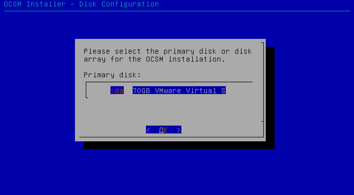

Select the primary disk or disk array for the installation. The primary disk will hold the Session Monitor operating system and the database. In the second step you can choose to use another disk for long-term stored data or to keep all data on one disk.
Caution:
Session Monitor installer erases any existing files on the disk to prepare the disk with the operating system. Make sure to back up any important files on the disk before proceeding with the installation.Figure 2-5 shows the primary disk selection screen.
The primary disk can have a size between 70GB and 2TB. If you want to use a larger disk array for data storage, configure it as a secondary disk.Important:

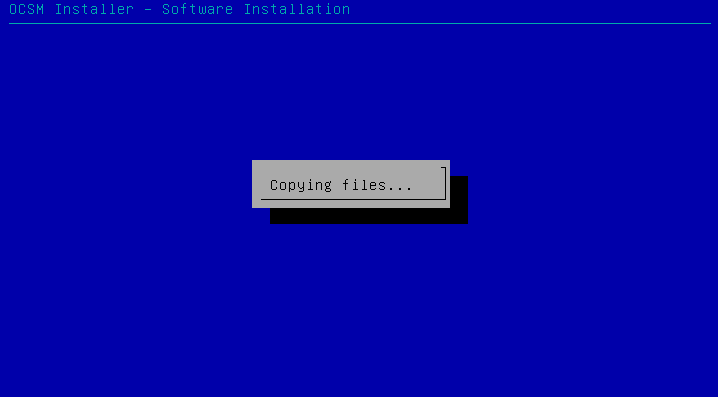

Configuring a machine with a secondary disk as a standalone Probe is not supported. Only Mediation Engine and Mediation Engine with embedded Probe machines can use a secondary disk.The installer prepares the disks and sets up the system. This installation process usually takes about 10 minutes.
Figure 2-6 shows the installation screen.

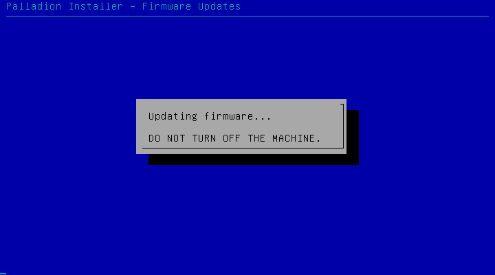

The installer updates the firmware required for the hardware components on the machine. This process can take several minutes to complete.
Do not power off the machine during this process, as this may leave components in an unusable state.Figure 2-7 shows the firmware update screen.

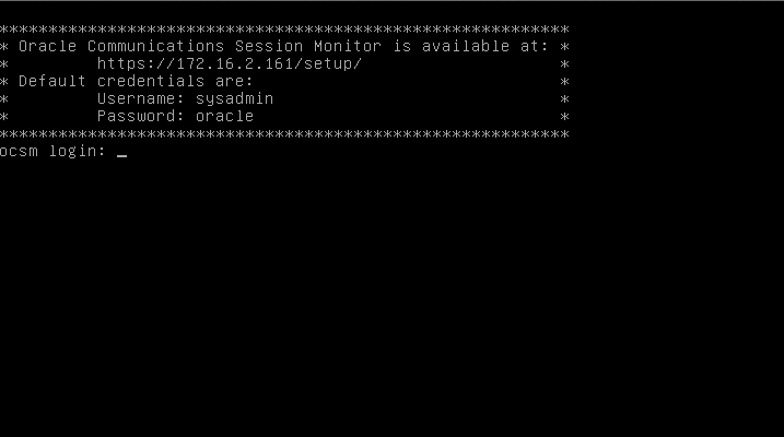

After rebooting, the machine shows the IP address that it uses. Open the URL https://ip-address/ in your Web browser to continue with the configuration of the Session Monitor system. You should see the login dialog to the Session Monitor Platform Setup Application (see "Configuring Session Monitor").
