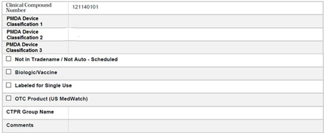

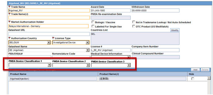

Three new dropdown fields have been added to Console > Business Configuration > Products and Licenses.
These dropdowns list fixed dropdown options, as specified below in the same order.
PMDA Device Classification 1:
High Level Controlled Medical Device
Generic Medical Device
PMDA Device Classification 2:
Biogenous
Specific Biogenous
Other
PMDA Device Classification 3:
Single Use Medical Device
Reiteration Use Medical Device
These fields have <Blank> as the default value for these drop-down lists.
These fields are displayed to only an Argus J user when Japanese module is enabled.
These fields are editable only when Authorization Country is selected as Japan and License Type is selection as either of "Marketed Device " or "Investigational Device". Otherwise, these are displayed as blank and disabled.
The dropdown option values are displayed in English even to the Argus J user as this is an English base screen. The Japanese value specified for these dropdowns is used to populate these in PMDA Device Expedited Form 8 and 10.
Existing fields - "Medical Device Information" and "Clinical Compound Number" have been adjusted in the user interface of the application.
These three fields are printed in License Print PDF in three different rows, right below Clinical Compound Number field in alternate-colored rows thereafter.
These fields are audit-logged.
These fields are covered by the back-end PL/SQL APIs for License Configuration data table updates and audit-logging.

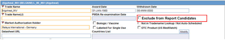

A new checkbox - "Exclude from Report Candidates" field has been added to Console ' Business Configuration ' License Configuration screen as shown below.
This checkbox is displayed to only an Argus J user and when Japanese module is enabled.
By default, this field is unchecked.
This checkbox will only be enabled when the Authorization Country = Japan. Otherwise, it is unchecked and displayed as disabled.
This field value is printed in License Configuration print PDF.
The updates to this field value is audit-logged.

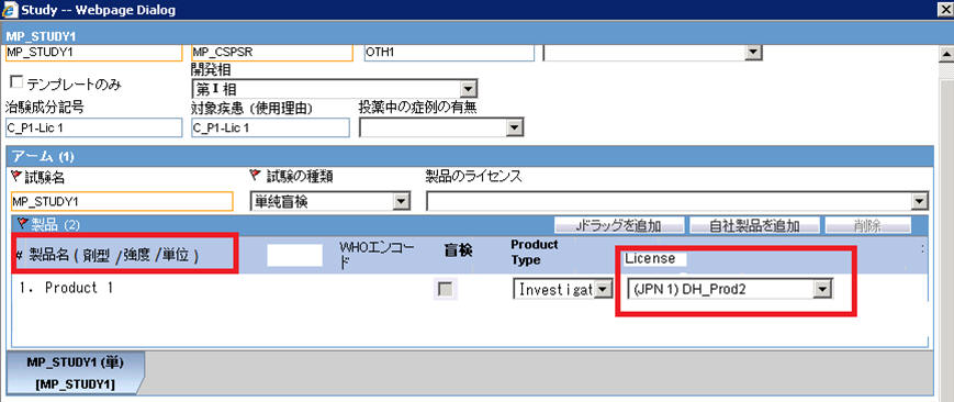

The Product Grid in both the English and J Study Configuration pop-up screens has been updated as follows:
Product, Dosage, Unit, and Formulation have been merged into one column called Product Name (Dosage Form / Strength / Unit), as shown below:
As listed above, a new license selection drop-down list has also been added in the J pop-up Product Selection grid. This drop-down lists all the J Licenses that are present for the respective product.
This license is used as the primary selected license when you select the product as the study drug in the Case Form, in the following format:
Trade name<space>(License Type)<space>Clinical compound Number or License Number
The License Type is printed as "MKT" for Marketed Drug/Device/Vaccine and "INV" for Investigational Drug/Device/Vaccine.
This license should be used as Primary license if the case is accepted as Initial/Follow-up from E2B, Literature Intake or Case Intake.

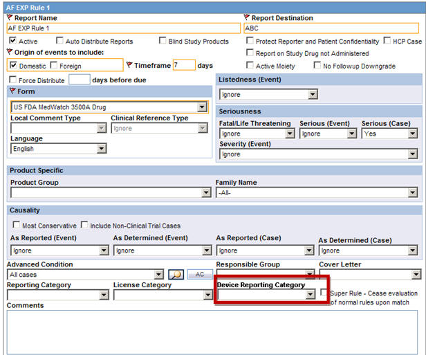

A new dropdown field - "Device Reporting Category" has been added to Console > Business Configuration > Expedited Reporting Rules screen as displayed in the screen mockup below:
This dropdown field is displayed to English as well as Japanese users only when Japanese module is enabled.
This dropdown displays the English values as specified in the "Device Reporting Category" Code List and marked as "Display".
It contains <Blank> as the first option and it is also the default value.
This field is printed in Expedited Report Rules Print PDF right below License Category field in alternating colored row.
This field is audit-logged.
It is covered by the back-end PL/SQL APIs for Expedited Reporting Rules data table updates and audit-logging.
