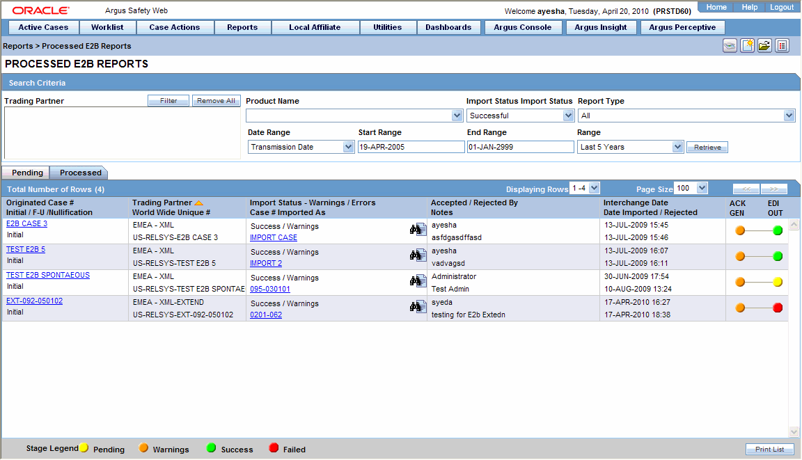

Processed E2B Reports
The Processed E2B Reports screen contains a list all processed E2B Reports. Click the Processed E2B Reports tab on the Incoming Reports screen to view the Processed E2B Reports screen.
Surrounding text describes procsdreps.gif.
The Processed E2B screen contains the following:
  • Search Criteria
  • Total Number of Rows
Total Number of Rows Fields
The following table lists and describes the fields in the Total Number of Rows section on the Processed E2B screen.
Field Description
Originated Case# Displays the Originated Case Number of the case.
Initial/F-U/Nullification Displays the Initial/F-U/Nullification status.
Trading Partner The name of the trading partner.
World Wide Unique# The World Wide Unique # for the case.
Import Status - Warnings/Errors The import status of the case and any associated warnings/errors.
Case # Imported As The Case Number used when importing the case.
Accepted / Rejected By Identifies who accepted or rejected the case.
Notes The case notes.
Interchange Date The Interchange Date.
Date Imported/Rejected The date the case was imported/rejected.
ACK Gen Yellow indicates the case is still pending
Orange indicates the case is accepted with warnings / errors
Red indicates the user or system rejected the case.
Green indicates the case has been successfully imported.
EDI Out Yellow indicates the system is waiting to send the report out of the EDI / XML or PHY out folders
Green indicates the report is already sent out of the EDI / XML or PHY out folders
Red indicates that the EDI gateway failed to send the report out of the EDI / XML or PHY out folders.
