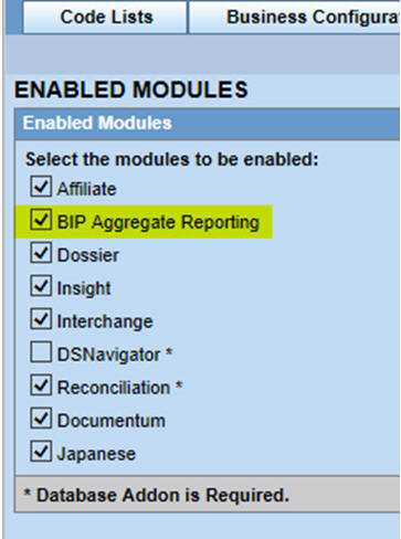

On the Argus Console, navigate to System Configuration > Enabled Modules. Make sure that BIP Aggregate Reporting is checked.
Figure D-1 BIP Aggregate Reporting Enabled

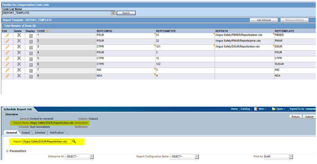

The Report path in the REPORT_TEMPLATE is empty or has an incorrect path.
Solution
The Report path present in the code list REPORT_TEMPLATE must have a proper value. The value can be verified by comparing it against the actual report path in the BIP Publisher catalogs.
