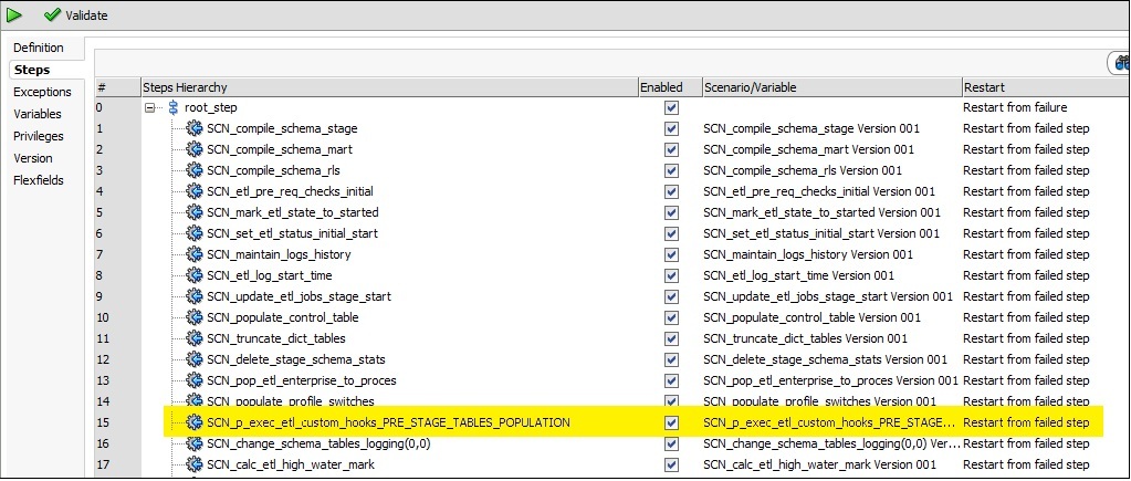

The ODI Load Plan lists all the ETL scenarios, as shown below:
Figure 2-1 ODI Load Plan
Surrounding text describes Figure 2-1 .

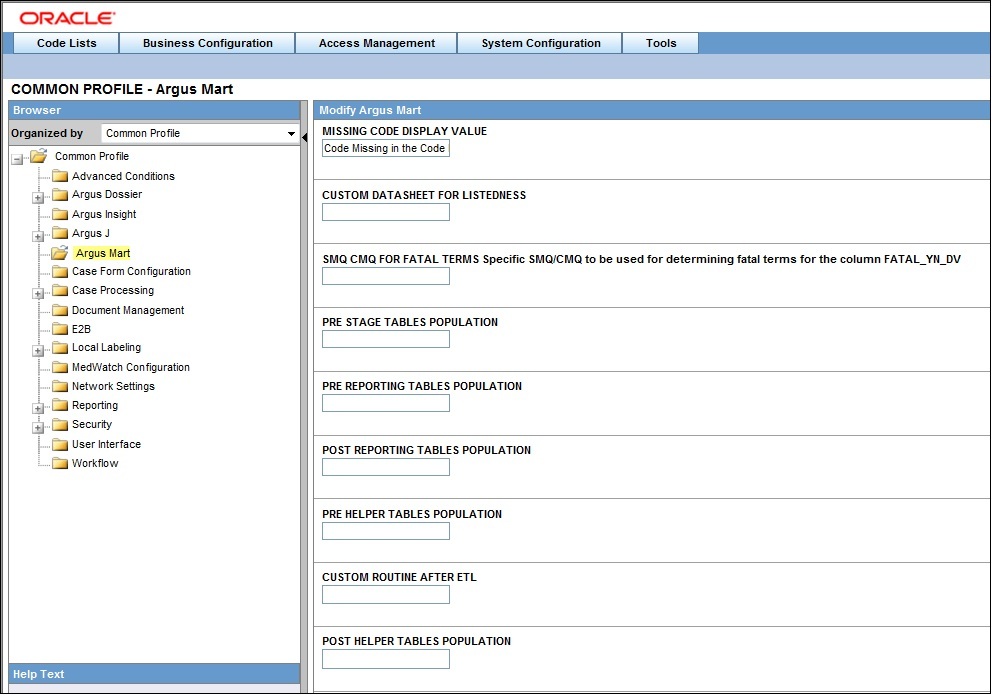

    ETL hooks are the global-level switches, visible on Argus Safety Console when you are logged-in through the default enterprise. These switches are visible only after installing and creating Argus Mart schema.
Figure 2-2 Argus Safety User Interface
Surrounding text describes Figure 2-2 .

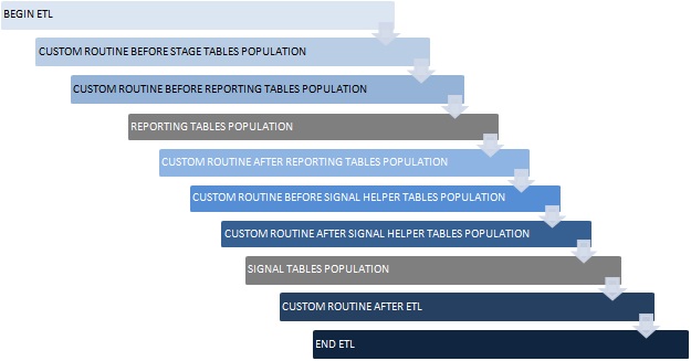

The ETL Hooks can be executed at different staging levels.
  1. Before populating the reporting tables, execute CUSTOM ROUTINE BEFORE STAGE TABLES POPULATION, and/or CUSTOM ROUTINE BEFORE REPORTING TABLES POPULATION.
  2. Before populating the signal tables, execute ETL Hooks CUSTOM ROUTINE AFTER REPORTING TABLES POPULATION, CUSTOM ROUTINE BEFORE SIGNAL HELPER TABLES POPULATION, and/or CUSTOM ROUTINE AFTER SIGNAL HELPER TABLES POPULATION.
  3. After populating reporting and signal tables and before populating the results, execute CUSTOM ROUTINE AFTER ETL.
Figure 2-3 Sequence of ETL Hook Execution
Surrounding text describes Figure 2-3 .

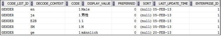

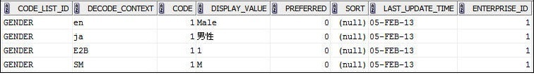

For a code list GENDER, data in the table CODE_LIST_DETAIL_DISCRETE for code 1 is available in the following four decode contexts (languages):
Figure 2-4 Original Decode Contexts (Languages)
Surrounding text describes Figure 2-4 .

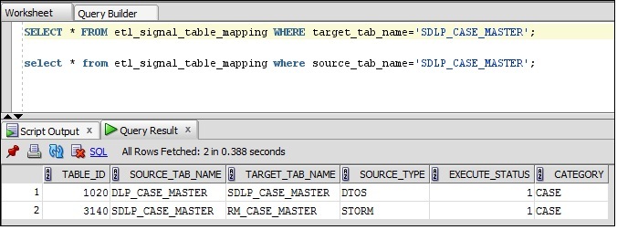

  1. Check mapping between the source and the target tables, through the table ETL_SIGNAL_TABLE_MAPPING.
  2. Based on the mapping between the Argus Safety and RM tables, fetch the desired column in the RM table through ETL Hooks.

Follow the steps given below to populate a new column in the table RM_CASE_MASTER:
  1. Check the mapping between RM_CASE_MASTER, and the source table (SDLP_CASE_MASTER) to fetch columns from the staging table into the RM table. In this case, the source type is STORM.
  2. Check the source table for target table (SDLP_CASE_MASTER), where columns are fetched from Argus Safety into the staging table. In this case, the source type can be ATOS/DTOS.
    Figure 2-6 Populating New Columns in the RM Table
    Surrounding text describes Figure 2-6 .
  3. Once the mapping of the tables has been identified, fetch these column(s) from Argus Safety/DLP into Argus Mart, as required.

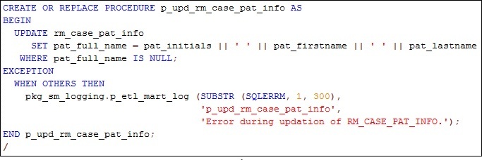

Example 2-3 Creating a custom procedure
Creating a procedure called P_UPD_RM_CASE_PAT_INFO, to populate a new column called PAT_FULL_NAME in the table RM_CASE_PAT_INFO. The value of this column is calculated, and populated from the existing columns of RM_CASE_PAT_INFO. Here, we concatenate three columns PAT_INITIALS, PAT_FIRSTNAME, and PAT_LASTNAME to populate this value as PAT_FULL_NAME.
  1. Create a procedure called P_UPD_RM_CASE_PAT_INFO.
  2. In the table RM_CASE_PAT_INFO, populate a new column called PAT_FULL_NAME.
  3. Concatenate three columns PAT_INITIALS, PAT_FIRSTNAME, and PAT_LASTNAME to populate this value as PAT_FULL_NAME.
    Figure 2-7 Creating Custom Procedure
    Surrounding text describes Figure 2-7 .

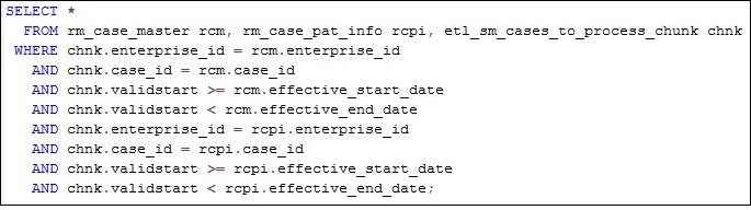

Example 2-4 Populating data into SM tables using the chunk table
In the example given below, two RM tables RM_CASE_MASTER and RM_CASE_PAT_INFO have been joined with the chunk table ETL_SM_CASES_TO_PROCESS_CHUNK to fetch data into the SM table with the help of the ETL Hooks.
Figure 2-8 Populating Data into SM tables using Chunk Table
Surrounding text describes Figure 2-8 .

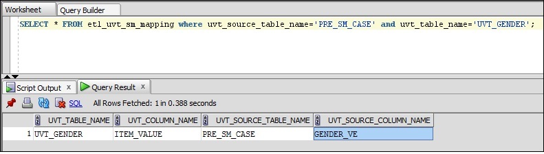

  1. Check the mapping between the source table PRE_SM_CASE and the target table UVT_GENDER from the table ETL_UVT_SM_MAPPING.
    Figure 2-9 Populating Custom UVT Table
    Surrounding text describes Figure 2-9 .
