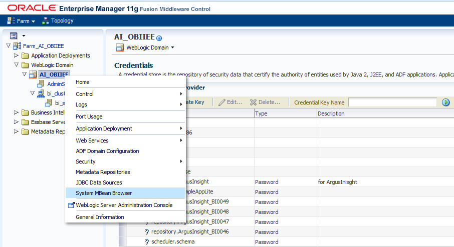

  2. Log in to EM, and create an encrypted key entry in the EM for the Oracle Argus Insight RPD.
    1. Expand the tree node Weblogic Domain and click on the bifoundation_domain (the domain created for OBIEE), and invoke the menu Weblogic Domain > Security > Credentials to give the screen as shown here:
      Figure 9-2 The bifoundation_domain Screen
      Surrounding text describes Figure 9-2 .
    2. Click Create Key, and enter the following details for the ArgusInsight rpd file:
      – Select Map: oracle.bi.enterprise
      – Key: repository.ArgusInsight
      – Type: password
      – User Name: Administrator
      – Password: password of choice
    3. Click OK to create the security key.
  3. Invoke the System MBean Browser.

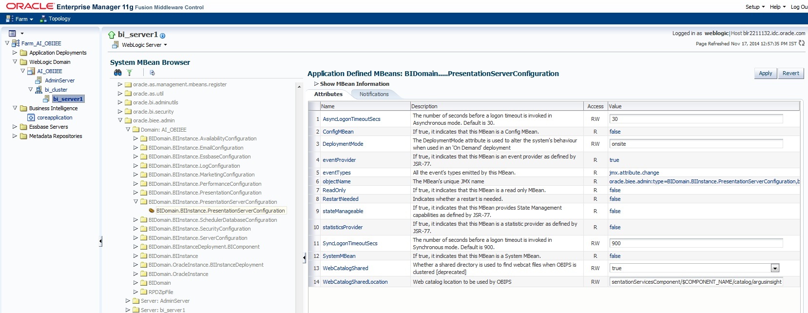

  7. Navigate to Domain: bifoundation_domain > BIDomain.BIInstance.PresentationServerConfiguration > BIDomain.BIInstance.PresentationServerConfiguration.
    In the Attributes tab, change the attribute WebCatalogSharedLocation as $ORACLE_INSTANCE/bifoundation/OracleBIPresentationServicesComponent/$COMPONENT_NAME/catalog/argusinsight, and click Apply.
    Figure 9-6 The Application Defined MBeans — BIDomain — Attributes Screen

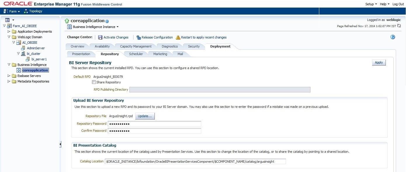

  9. Navigate through the tree control (Business Intelligence > coreapplication), and select a repository from the right side pane.
    Go to Deployment tab, select Repository tab, and click Lock and Edit.
    A confirmation message appears, click Close.
  10. Perform the following:
    • Repository file: Upload the Repository file ArgusInsight.rpd from the path where you have copied the rpd.
      For example: <AI Home>\report\ArgusInsight.rpd of AI)

  11. Confirm the catalog location as $ORACLE_INSTANCE/bifoundation/OracleBIPresentationServicesComponent/$COMPONENT_NAME/catalog/argusinsight.
  12. Copy the Catalog from the Oracle Argus Insight installed directory to the location mentioned above.
    For example:
    Installed location: d:\ArgusInsight\OBIEE\Catalog\argusinsight.zip to the location in WLS: MIDDLEWARE_HOME>\instances\instance1\bifoundation\OracleBIPresentationServicesComponent\coreapplication_obips1\catalog, and extract the zip file to the same location.
  13. Click Apply and then Activate Changes.

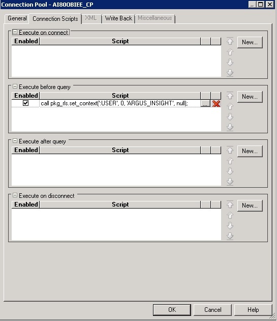

Set the Connection Script as "call pkg_rls.set_context(':USER', 0, 'ARGUS_INSIGHT', null);" at "Execute Before Query".
Figure 9-11 Connection Pool: AI80OBIEE_CP
Surrounding text describes Figure 9-11 .

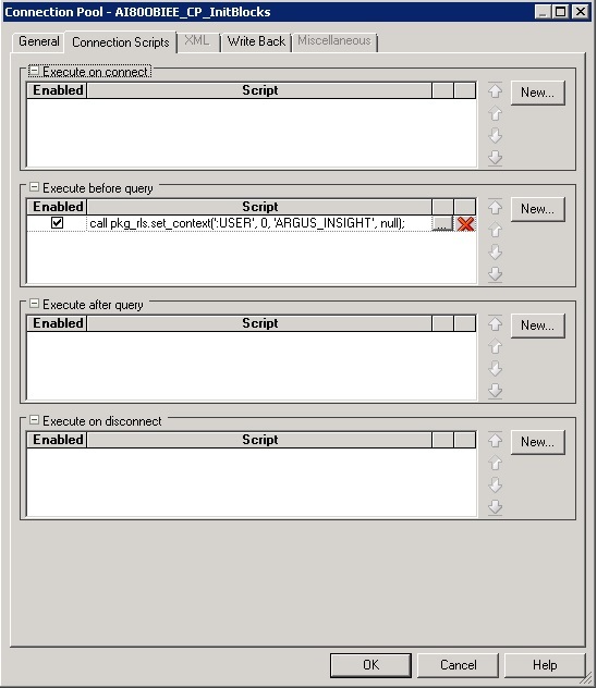

Connection Pool: AI80OBIEE_CP_InitBlocks
This connection pool should be created for Initialization blocks to run the select statements inside the Initialization strings.
Figure 9-12 Connection Pool — AI80OBIEE_CP_InitBlocks
Surrounding text describes Figure 9-12 .

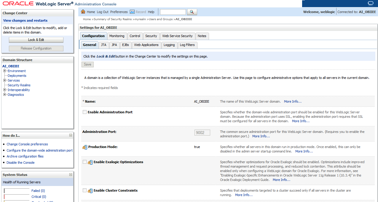

  1. Open a new browser window for the WebLogic Administration Console.
  2. Navigate to Security Realms > myrealm > Users and Groups tab.
    Figure 9-13 myrealm Settings — Users and Groups Tab
    Surrounding text describes Figure 9-13 .

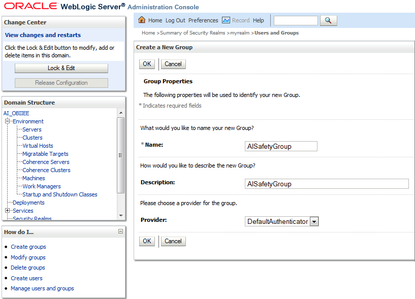

  3. Select the Groups tab, and click New.
  4. Enter the group name as AIAdmin, and click OK.
    Figure 9-14 myrealm Settings: Groups Tab — New Group
    Surrounding text describes Figure 9-14 .
  5. Follow the above process to create the groups AISafetyGroup and AIConsumersGroup.

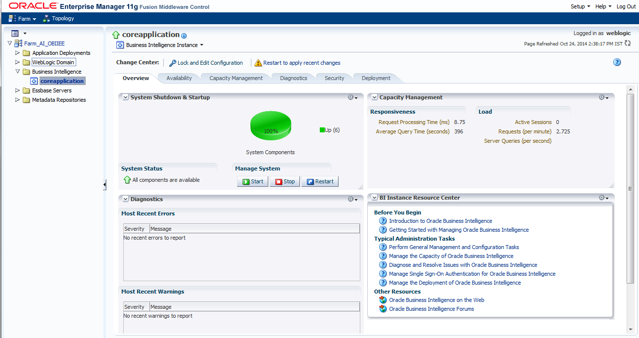

  1. Start a new browser window for the Enterprise Manager for Fusion Middleware Control, and navigate to the Business Intelligence > coreapplication Overview page.
    Figure 9-15 coreapplication Screen
    Surrounding text describes Figure 9-15 .

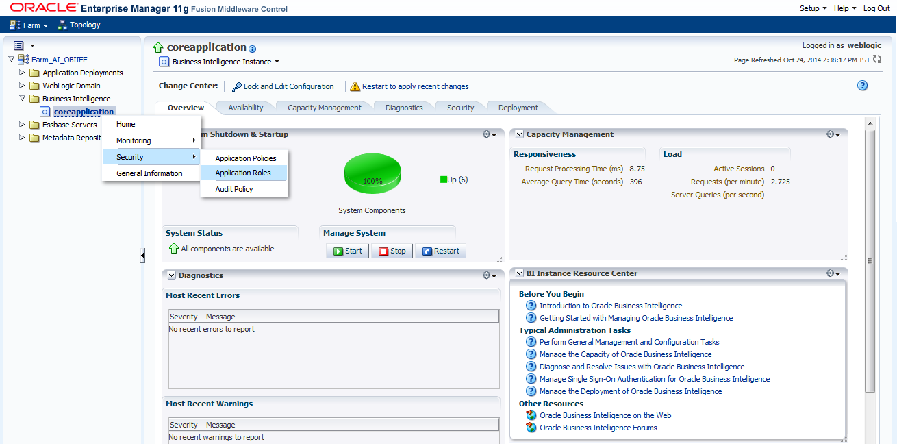

  2. Invoke the Application Roles by choosing from the menu drop down at Business Intelligence Instance > Security > Application Roles.
    Figure 9-16 coreapplication — Application Roles Screen
    Surrounding text describes Figure 9-16 .

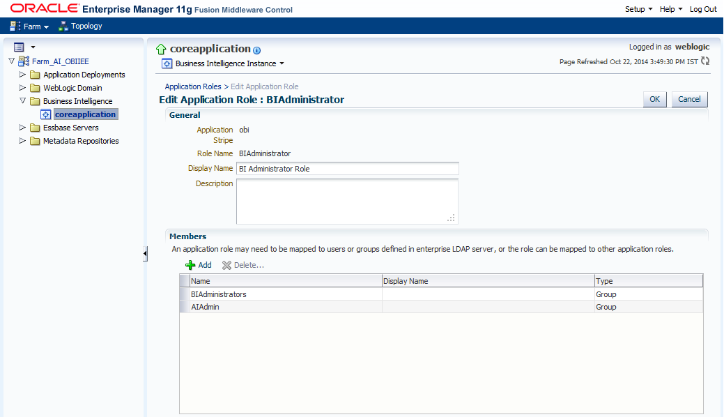

  3. Click on BIAdministrator application role, and add the group AIAdmin.
    Figure 9-17 coreapplication — Add Group
    Surrounding text describes Figure 9-17 .
  4. Click OK.
  5. Repeat the above steps to add the groups created as per the table given here:
    Table 9-1 OBIEE Application Roles and Groups
    Application Role Groups to be Added
    BIAdministrator
    AIAdmin
    BIAuthor
    AIAdmin, AISafetyGroup
    BIConsumer
    AIAdmin, AISafetyGroup, AIConsumersGroup
