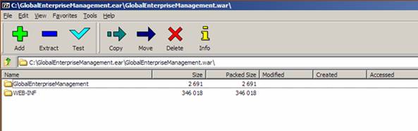

To deploy the portlets to the Oracle Portal Server, navigate to the Portlet Installation folder on the Web Server where the module was installed. Perform the following steps for each Portlet being installed.

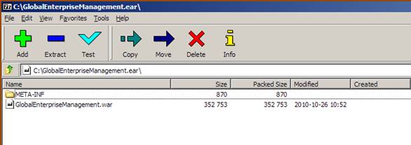

Open the .ear file using a Zip utility. The zip program will open with files as seen below.

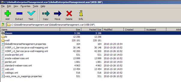

Double click the .war file and you will see the following screen. Double Click the WEB-INF folder.

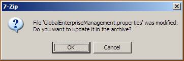

Double click the file portletname.properties where portletname is the name of the portlet ear file under modification.
In the editor find the key named ”ArgusURL” and modify the URL value to the value of your Argus Web Server or Argus Web Load Balancer.
ArgusUrl=http://10.178.91.250:8083. For OAM integration, Oracle recommends that using the FQDN of the machine.
Note: Please make sure there is no space between the tokens ”ArgusUrl”, ”=” and the actual URL value. |
Save the changes to the properties file and close it. Close the 7-zip manager window and press OK to save the changes in the archive. You are now ready to deploy the ear file.

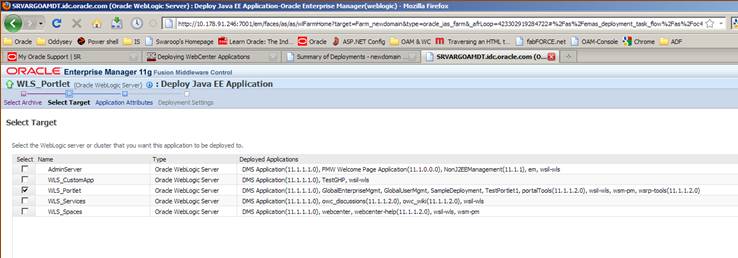

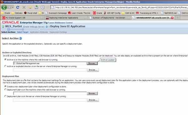

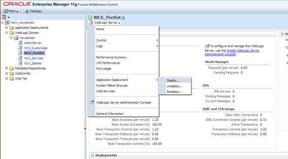

Log in to the Oracle Enterprise Manager Admin Console and navigate to WebLogic Domain>Your Domain>WLS_Portlet. From the top left corner, navigate to Weblogic Server >Application Deployment>Deploy.
Select Archive is on the machine where this web browser is running and click Browse. Browse to the modified .ear file on your local machine.

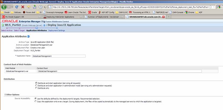

The Portlet will now get uploaded to the server.
Once the Portlet is uploaded, by default WLS_Portlet will be selected. If not then select and click Next.
Do not change the default selection. Click Next.

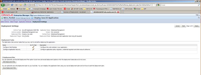

Click Deploy on the last screen to publish the Portlet. Verify that the Portlet was deployed successfully in the Status.

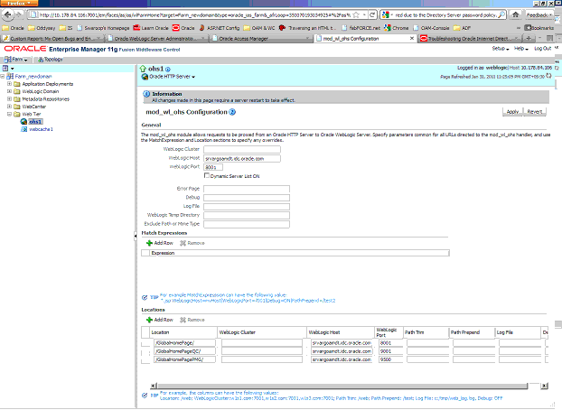

To update the Global Homepage Properties file:
Specify the SSO Header Key
This Key is used to show User Full Name on the Global Homepage.
Specify the Help URL
Update this property with the Argus Web Server or the Argus Web Load Balancer URL. This URL path launches the online Help for the Global Homepage.

Open the globalhomePage.ear file using a zip utility.
Open the GlobalHomePage.war file.

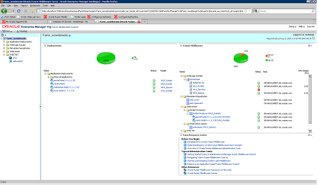

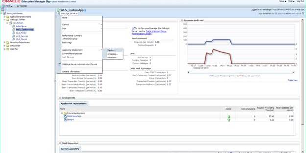

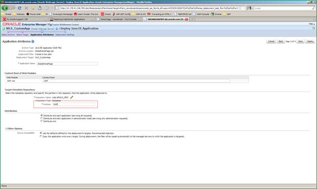

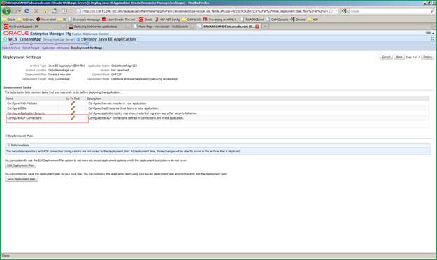

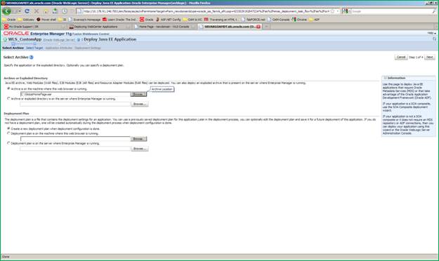

Now, perform the following steps to deploy the global home application on the Weblogic Server.
Log in to the Enterprise Manager Admin console. In the left hand tree navigation, select WebLogic Domain>Your Domain>WLS_CustomApp in the left hand tree navigation. The WLS_CustomApp is the name of the server that we have created to deploy Global Home Page. Click the menu just below the name of the server as shown below. Navigate to Application Deployment > Deploy.

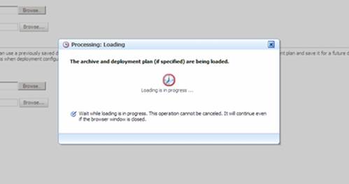

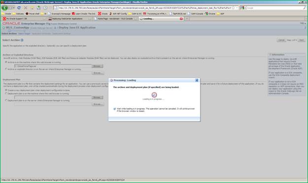

The following screen appears. Browse for the application. ear file and click Next.
Wait for the progressing dialog to finish.

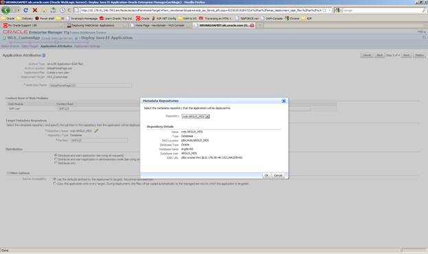

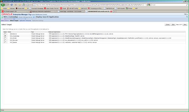

After modal dialogue is completed, you will see a screen for selecting targets. By default WLS_CustomApp will be selected, if not then select and click Next.
Click the ”pencil” icon in the Target Metadata Repository section.
A modal dialog appears that allows you to specify the metadata repository for this application. Choose a metadata repository and click OK.
Specify the ”partition” value. You may choose any value but Oracle recommends using the application name itself as the partition value. Click Next.

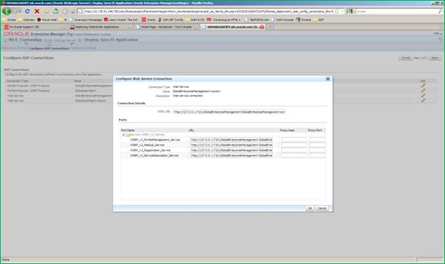

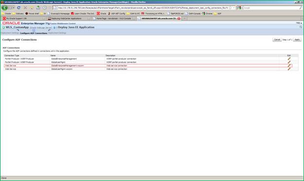

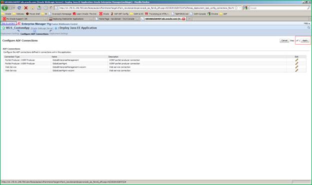

In the ”Configure ADF connections” section, click ”pencil” icon, you will be redirected to the ”Configure ADF connections” screen.
In the Configure ADF connections screen, modify the web service connection. Click the ”pencil” icon to edit the ADF connection settings.
A modal dialog comes where you can change ADF connections. You must modify the URL of the following fields to reflect the settings of your deployed portlets.
WSDL URL
WSRP_v2_PortletManagement_Service
WSRP_v2_Markup_Service
WSRP_v2_Registration_Service
WSRP_v2_ServiceDescription_Service
Click OK to close the modal dialogue and you will return to the parent screen. Click Apply in the top right corner. You will return to the deployment wizard screen 4 of 4. Click Deploy. The server will now deploy the ear file and report the success/failure status of the operation.

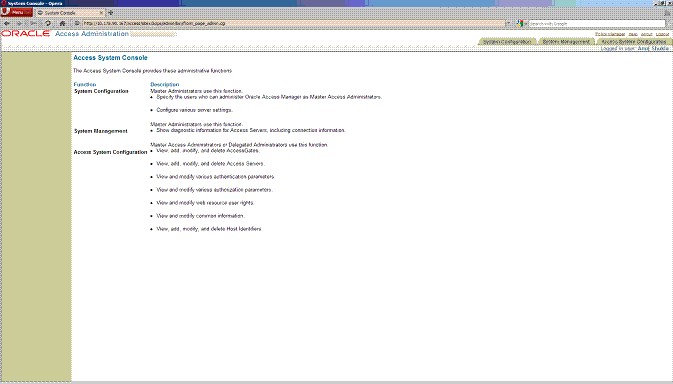

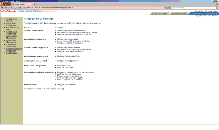

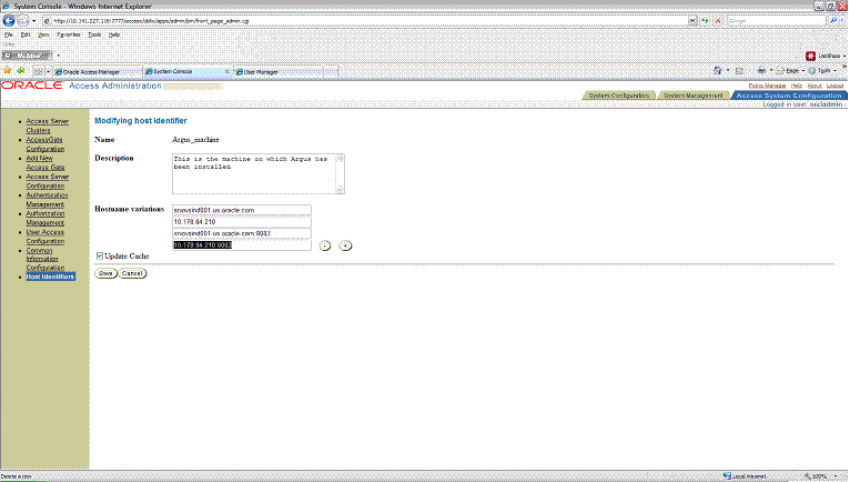

Navigate to the Access System console of OAM and click the Access System Configuration tab. Click Host Identifiers on the left panel. Provide the Fully Qualified Domain Name (FQDN), IP Address and both entries along with port numbers of the Argus Web Server machine. Click Save. For example:
srvovsind001.us.oracle.com
srvovsind001.us.oracle.com:8083
10.178.84.210
10.178.84.210:8083

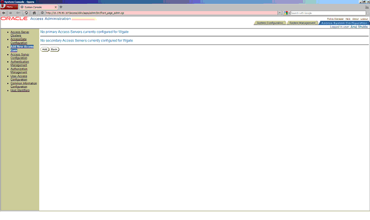

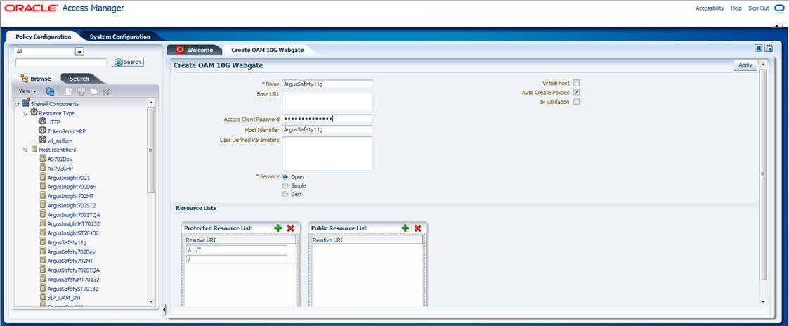

In the Access System console of OAM, click Access System Configuration.

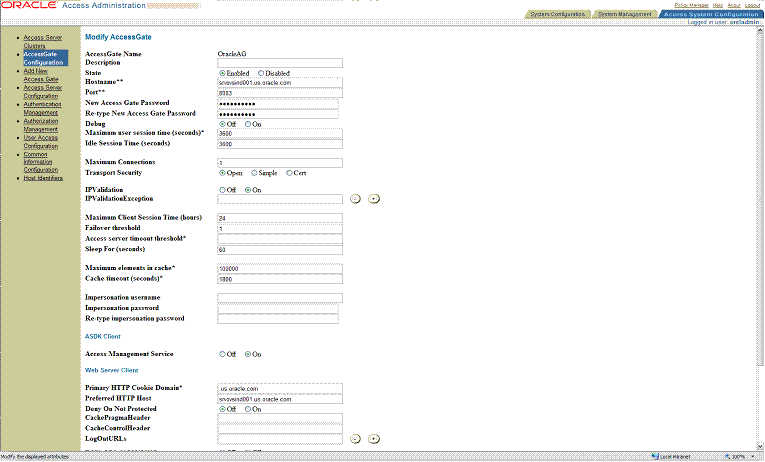

Click Add New Access Gate link on left panel.
Provide details like access gate name, port, and password. Also, enter the following details:
Hostname - provide the FQDN of the Argus Web Server where you will install webgate.
Access Management Service - select On. To enable a smooth installation, it is essential that this option is selected as On.
Primary HTTP Cookie Domain - provide FQDN of the machine where you will install webgate, prefixed by a period. For example, .idc.oracle.com. Note the . before the FQDN.
Preferred HTTP Host - provide the same value as Hostname.
CachePragmaHeader - enter value as private
CacheControlHeader - enter value as private
Once you have entered all the above details, click Save to add the webgate.
You will see the message "Please associate an Access Server or Access Server Cluster with this AccessGate."

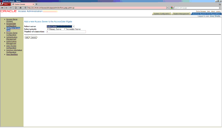

Click List Access Servers. The following screen appears:
Click Add. Select an access server from the dropdown and click add to associate webgate with access server.
Note: The access servers in this list will appear based on the access servers installed in the OAM image or installation that you have. Do not attempt adding Access Servers from OAM Console. |

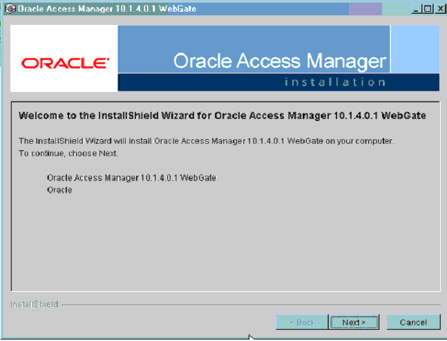

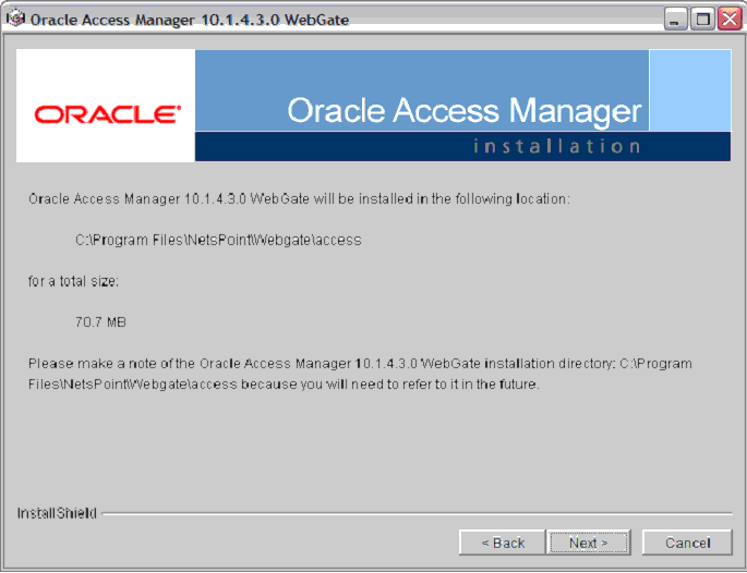

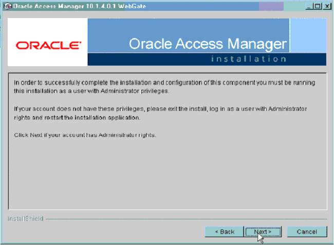

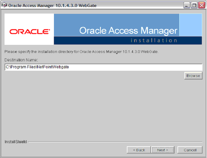

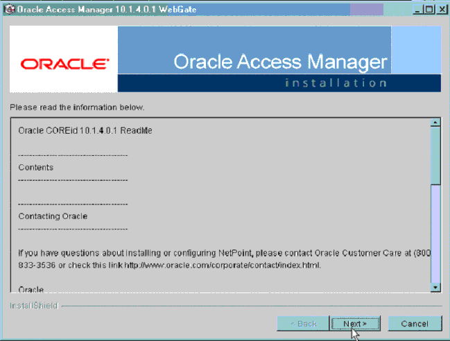

Run the file Oracle_Access_Manager10_1_4_3_0_Win32_ISAPI_WebGate.exe. The following screen appears. Click Next.
You must have administrative privileges to run the installation. If you are logged in as a different user, you must exit the installation, log in as the Administrator and then restart the installation. When the following screen appears, click Next.
In the Destination Name, set the installation directory and click Next.
Review the location to which WebGate for IIS is getting installed and the total disk space it will take for the installation. Then click Next.

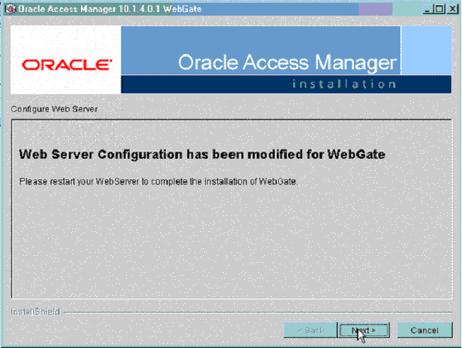

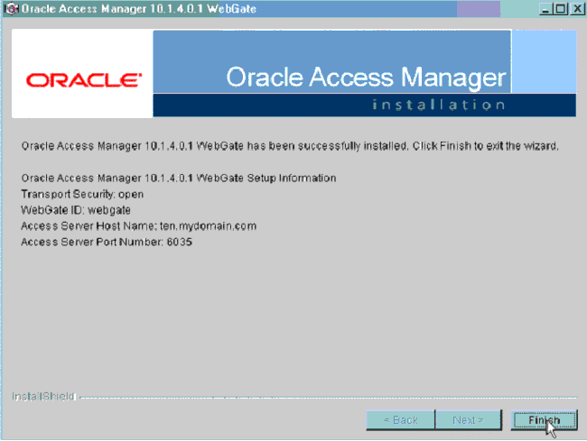

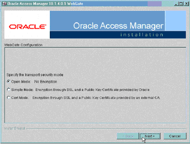

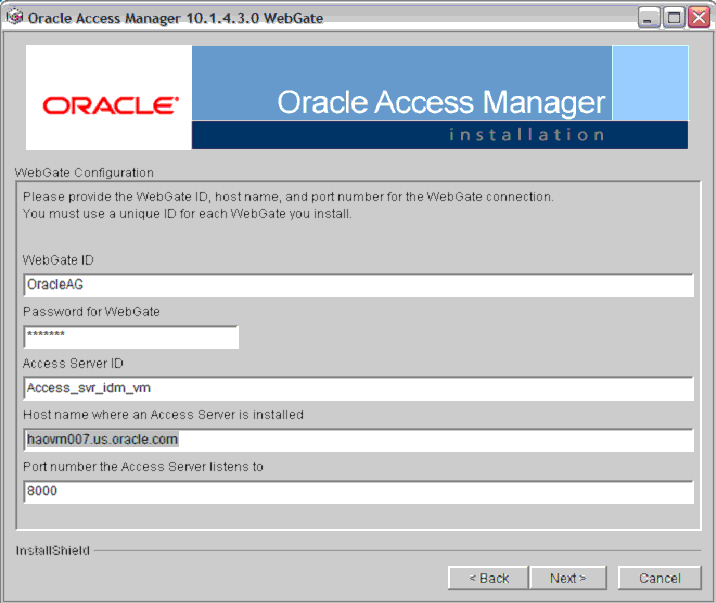

The installer begins copying the WebGate files for IIS. Now select Open Mode: No encryption for the transport security mode and click Next.
Provide the following details and click Next.
Table 12-1 Values for WebGate configuration
| Parameter | Description |
WebGate ID |
Name of the webgate. |
Password |
Password for the webgate. |
Access Server ID |
Name of the access server that is configured in access server console. |
Host name |
FQDN of the machine where the access server is installed. |
Port number |
Port of the access server |

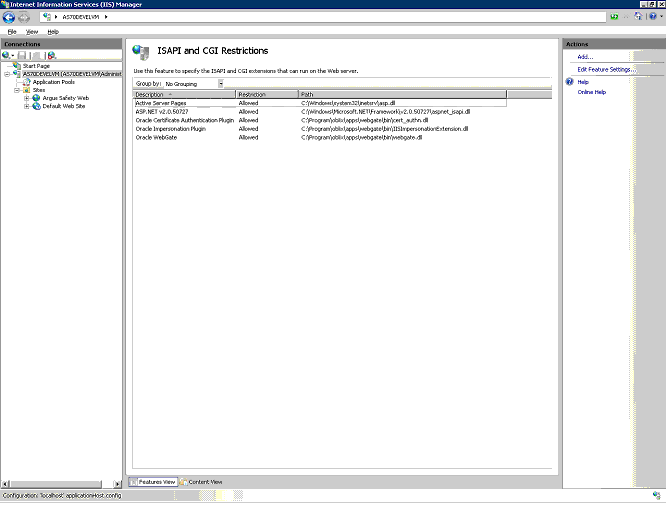

Open IIS manager and navigate to the top level node. On the home page, double click ISAPI and CGI restrictions to open the feature.

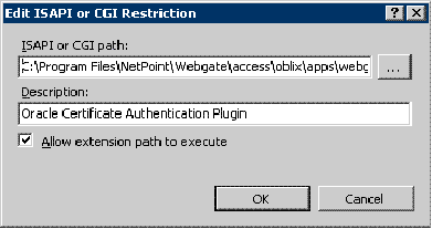

You have to correct the path for the following DLLs to reflect the path where you have installed the WebGate. To do this, double click the DLL entry and you will see the Edit ISAPI or GCI Restrictions dialog box as shown below. In this dialog box, enter the path given in the following table and click OK.
Table 12-2 Default path for DLL
| DLL Name | Default Installation Path |
Oracle Certificate Authentication Plugin |
Oracle Impersonation Plugin |
Oracle WebGate |

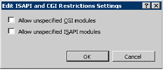

Note: For Windows 2008 R2, the DLLs must be manually added by clicking on the Add link in the right-most pane. |
Click Edit Feature Settings in the Actions panel in the right. The following dialog box appears:
Check both the boxes and click OK.

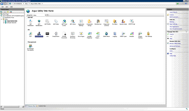

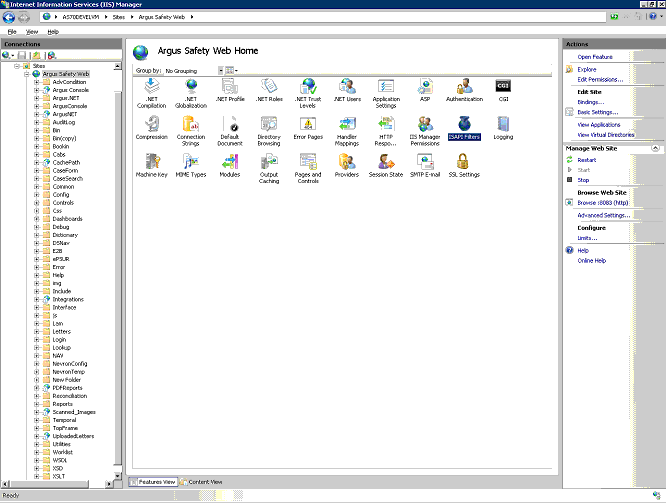

Click Argus Safety Web node, which will open the home page for the application as shown below.

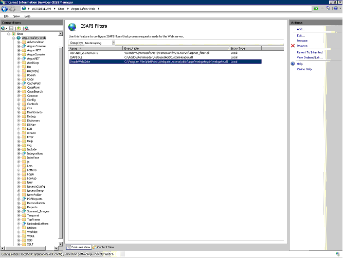

Click ISAPI Filters and the following screen appears:
Double click OracleWebGate and enter the path to where you have installed WebGate. The default path is C:\Program Files\NetPoint\Webgate\access\oblix\apps\webgate\bin\webgate.dll
You will now have to remove the <add segment="bin"/> entry from applicationhost.config file. Take a backup of the file before you make the following changes:

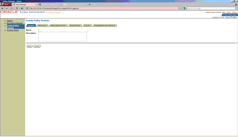

Navigate to the policy manager console and click Create Policy Domain.
Under the General tab provide a name and description and click Save.

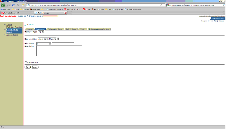

Click the Resource tab and then click Add.
Select Host Identifier from the dropdown list and select URL Prefix as / and provide a description. Click Save.

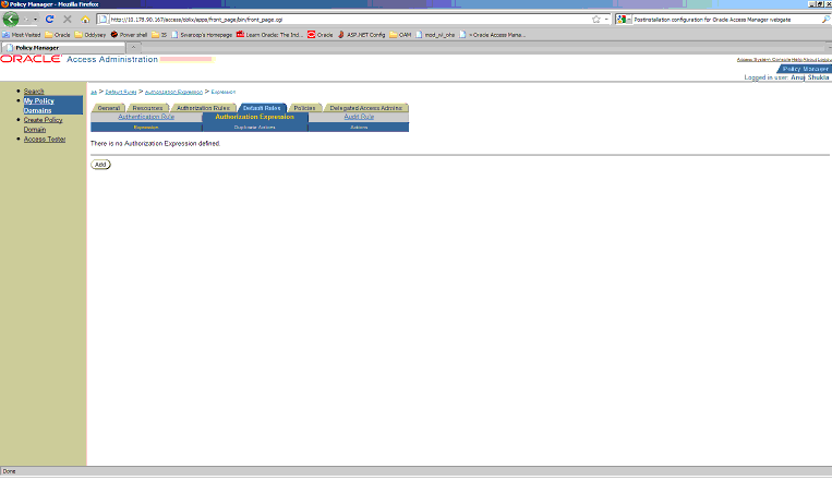

Click the Authorization Expression sub tab and click Add.
Select Authorization Rule from the dropdown. Click Add and then click Save.

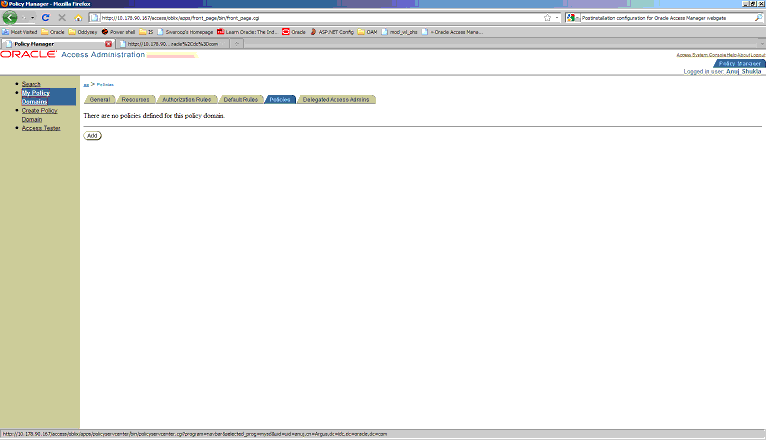

Click Policies and then click Add.
Provide the following details and click Save:

After you have completed the above steps your policy will appear as shown below:
To verify if you have correctly configured the policy check for the following prompt when you open the Argus URL:

Navigate to the System Configuration tab of OAM and select the New OAM 10g Webgate link.
The Create OAM 10g Webgate screen is displayed. Enter the name of the Webgate in the Name field and provide the password for the Webgate in the Access Client Password field. Click Apply.
The following screen is displayed:
Note: Refresh the Host Identifier list to view the newly created Webgate within the Policy Configuration tab. |

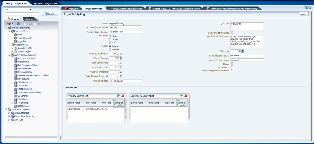

Provide details such as Primary Cookie Domain and Preferred Host, as shown above and click Apply:
Primary Cookie Domain - provide FQDN of the machine where you will install webgate, prefixed by a period. For example, .idc.oracle.com. Note the . before the FQDN.
Preferred Host - provide the IP Address of the Argus Web Server where you will install webgate.

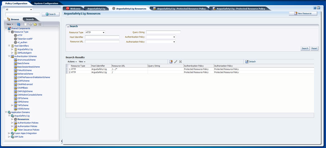

Expand the list of Application Domains and under this, expand the newly created Webgate.
Double-click on Resources. On the Resources screen, click the Create icon (displayed in the Search Results section, with the + symbol in red).
Create the resource type with the correct host identifier, as displayed in the following screen:

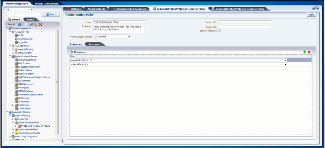

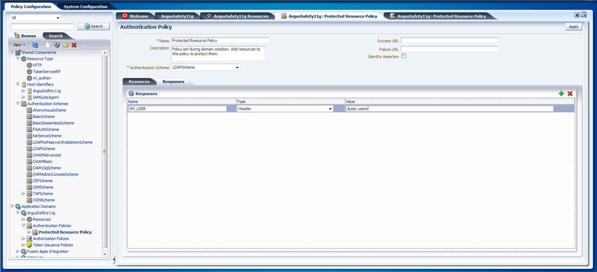

Expand the Authentication Policies under the newly created Webgate.
Double-click the Protected Resource Policy. The following screen appears:
Navigate to the Responses tab and click the + button to add the Name, Type, and Value for the responses, as shown in the following screen:

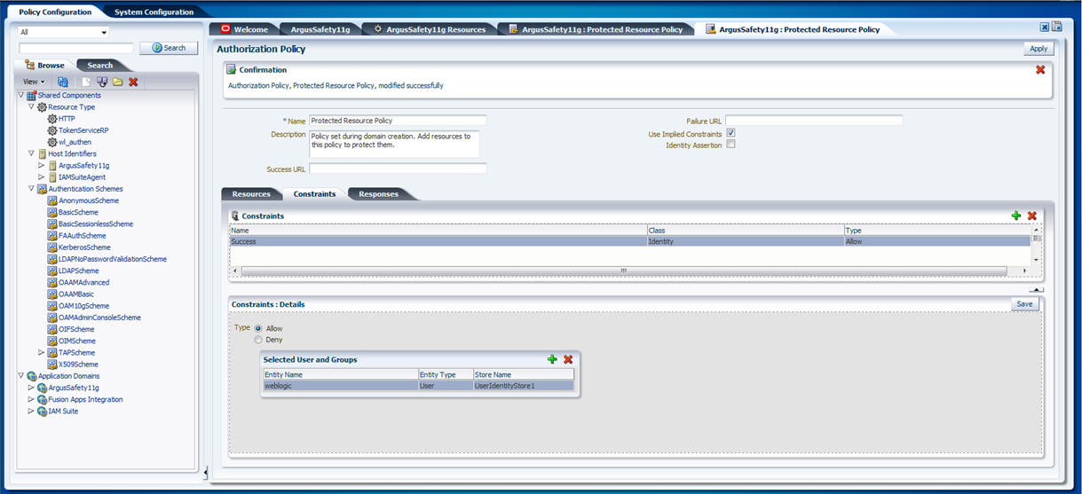

Expand the Authorization Policies under the newly created Webgate and double-click the Protected Resource Policy.
Select the Constraints tab and click the + button to add the Name, Type, and Class for the constraints, as shown in the following screen:
Note: All the names under the Constraints tab with Type as Allow can access the Argus Safety Server where Webgate has been installed. Select the Type as Deny if a user should be denied access to the Argus Safety Server where Webgate has been installed.If no constraint is added, all the users configured on the LDAP Server will have access to the Argus Safety Server where Webgate has been installed. |
Table 12-4 Values for WebGate configuration
WebGate ID |
Password |
Access Server ID |
Host name |
Port number |
Review the Readme page and click Next.
You can review the WebGate for IIS configuration settings and click Finish.
Table 12-5 Default path for DLL
Oracle WebGate |

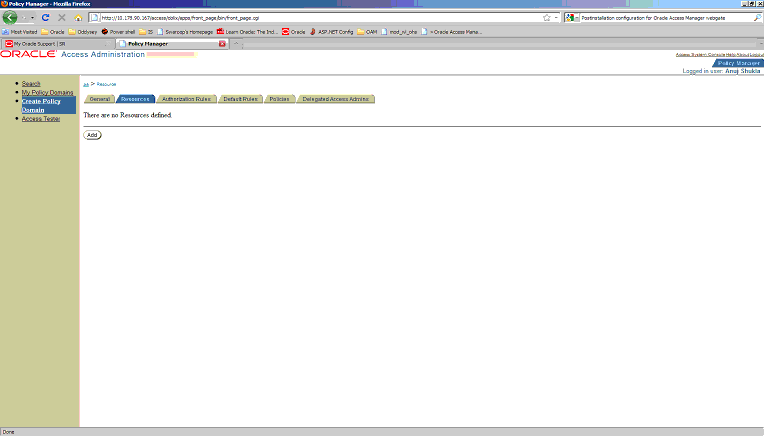

This section describes the procedure to create a policy to protect files under the Argus directory.

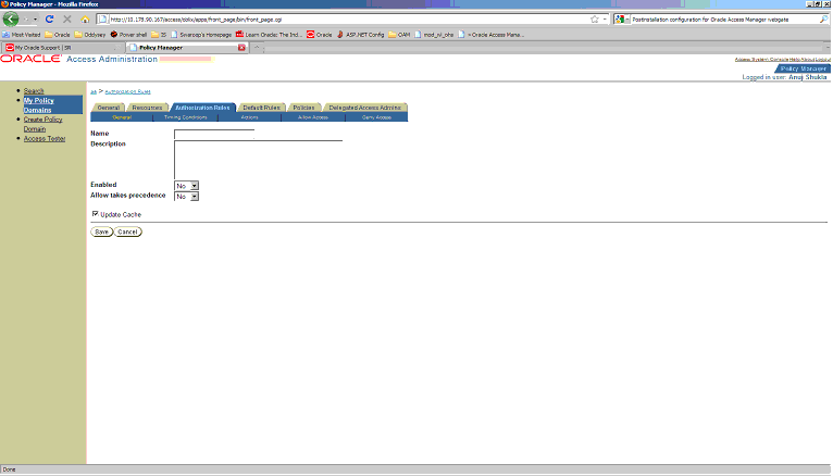

Click the Authorization Rules tab and select the General sub tab.
Enter the following details in this tab and click Save:
Name - Enter an appropriate name for the rule.
Description - Enter a description for the rule.
Enabled - Select Yes from the dropdown list.
Allow takes precedence - Select Yes from the dropdown list.

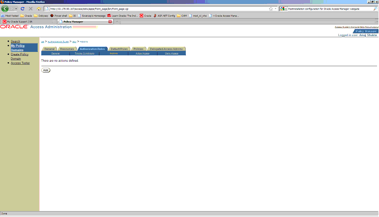

Now click the Actions sub tab. Click Add.
In the Authorization Success section under Return, enter the following values and click Save:

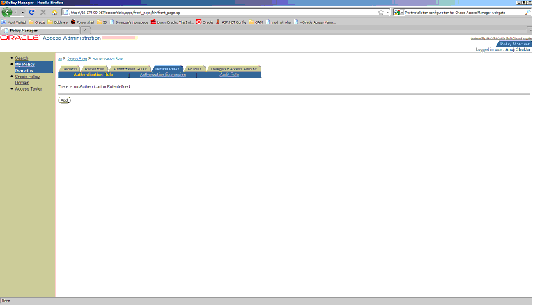

Navigate to Default Rules > Authentication Rule. Click Add.
Enter details for Name and decsription and select Authentication Scheme as Oracle Access and Identity Basic Over LDAP. Click Save.

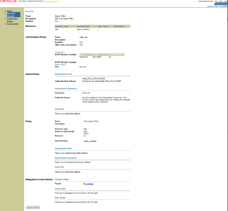

Now restart the Identity service and Access service. Also restart the IIS Argus Web Server. This completes the webgate installation and SSO policy configuration.

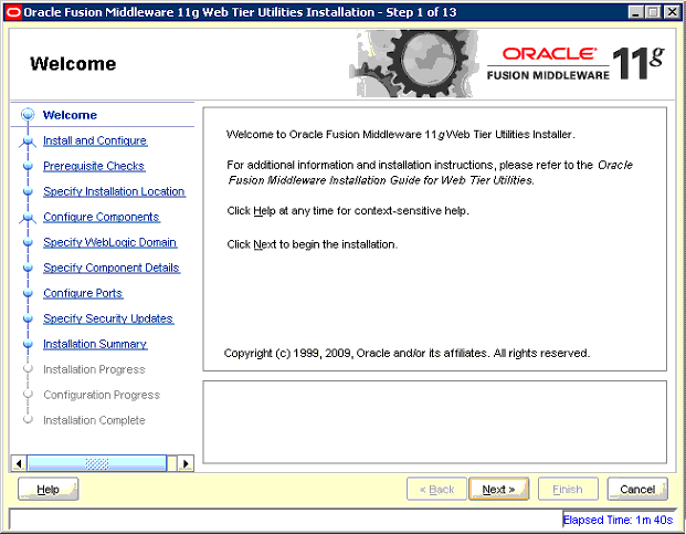

This section describes the procedure to install Oracle Web Tier (OHS). Prior to this installation, ensure that you have a running instance of WebLogic Server.

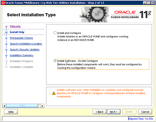

Navigate to folder \ofm_webtier_win_11.1.1.2.0_32_disk1_1of1\Disk1 and double click setup.exe to start the installer. The installer will begin after a check has been made for installer requirements.
Click Next to continue.
Select Install Software - Do Not Configure and click Next.

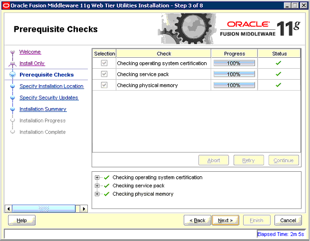

In the next screen, the installer performs Prerequisite Checks. Click Next to continue.

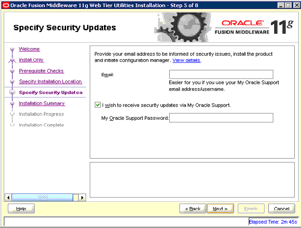

You can skip security updates so uncheck the option to receive security updates via My Oracle Support. The system will give a warning. Click Yes to close the screen and then click Next.

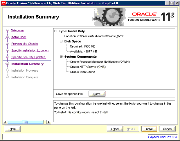

On the installation summary screen, click Install. This will install Oracle Web Tier.

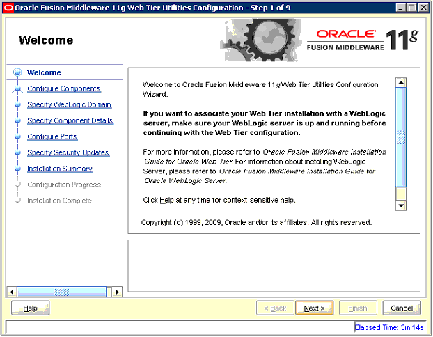

The following section describes the procedure to configure the Oracle Web Tier (OHS).

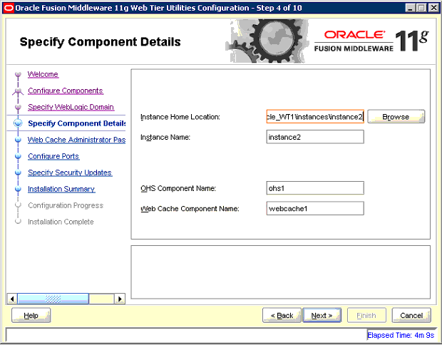

Navigate to the folder Oracle Middleware_Home\Webtier_Instance\bin. For example, C:\OracleNew\Middleware\Oracle_WT1\bin. Here Oracle_WT1 is the name of the webtier instance created during installation. In the folder, run config.bat to start the configuration wizard.
In the next screen, click Next.

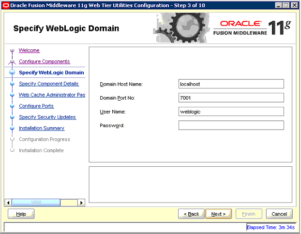

Enter details of the weblogic server and click Next.

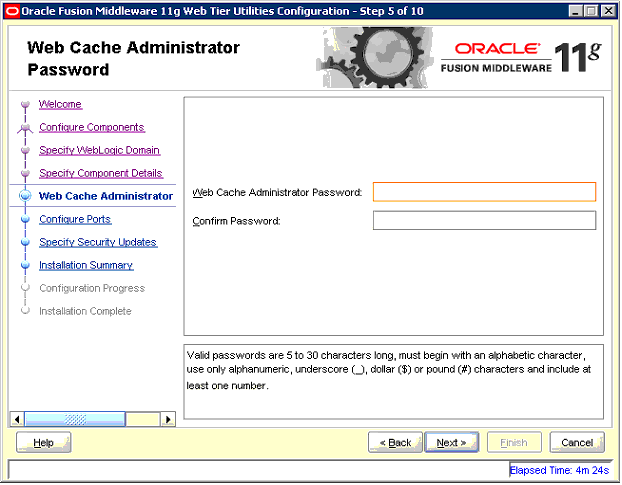

Enter a password for Web Cache and click Next.
Select auto configuration port in the Configure Ports screen. Click Next.
Skip security updates for now and then click Next to continue configuring the Web Tier.

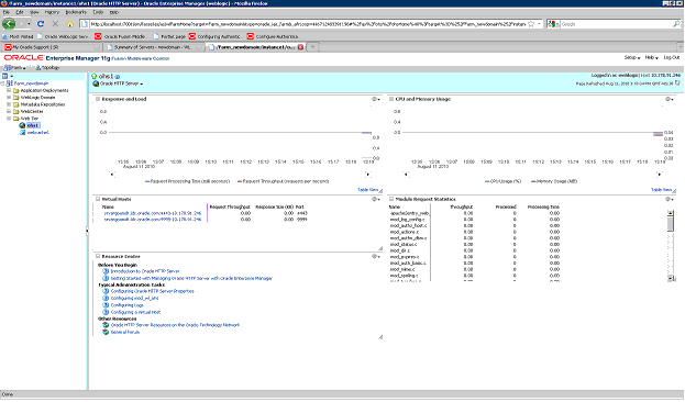

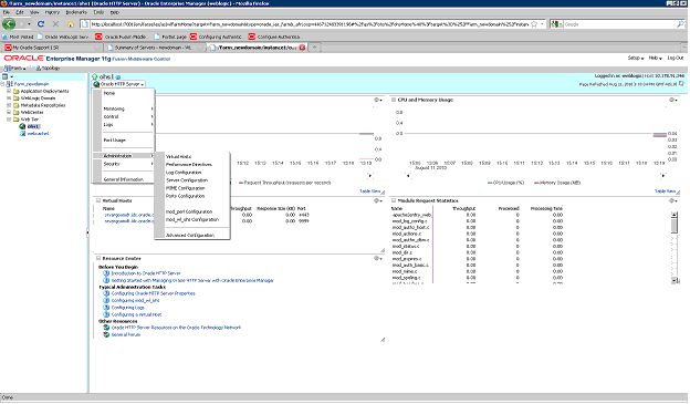

After the configuration, navigate to http://localhost:7001/em. This will open the Enterprise Management console for Fusion Middleware as shown below. Log in using the same credentials as that of the WebLogic server.
Click the Web Tier node on the left.
Click the name of the OHS instance that you have created during installation. In the following example, the OHS instance is ohs1.
You will see all the details related to Oracle Http server on this console.
This section describes the procedure to perform administrative tasks on the Oracle Http Server.
Perform steps 8 to 11 from the section Configuring Oracle Web Tier.
Click Oracle Http Server just below instance name at the top of right pane to access a menu.
This menu allows you to perform the following administrative tasks:
Control => Start Up - You can start an OHS instance using this option.
Control => Shut Down - You can stop and OHS instance using this option.
Control => Restart - You can restart an OHS instance using this option.

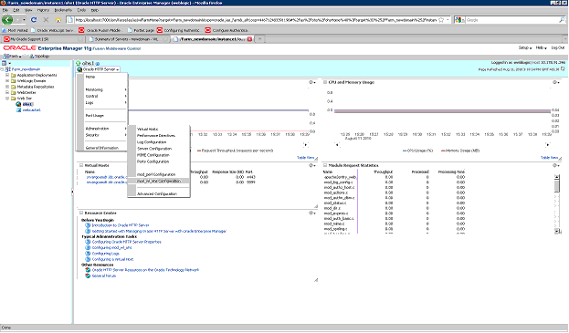

This section describes the procedure to configure the Oracle Http Server to act as a reverse proxy server for the WebLogic Server. Prior to following this procedure, ensure that you have a running instance of WebLogic Server and Oracle Web Tier. Also, you should have Global Home Page URL.
Navigate to Administration => mod_wl_ohs_configuration from the top menu.
In the General section enter the following information:
Weblogic host: FQDN of the machine where weblogic server and other managed servers are running.
Weblogic port: Port of the WebLogic server.
Debug: Give ERR.
Log File: You can provide a log file here.
In the Locations Section:
Click AddRow and add a new row.
In the WebLogic Host and Port field enter the same values as that in the general section of this page.
Location field: For entering a value in this field consider an example. If the URL for the Global Home Page deployed on custom server is http://srvargoamdt.idc.oracle.com:8001/GlobalHomePage/faces/GlobalHome, then srvargoamdt.idc.oracle.com is the FQDN of the machine where WebLogic server is installed and 8001 is the port at which custom server is listening. Now take the path after port /GlobalHomePage/faces/GlobalHome and enter this as the value in the location field.
Click Apply on the top right corner.
Restart the Oracle http Server using the Restart option of the top level menu.
After restarting, navigate to http://srvargoamdt.idc.oracle.com:7777/ GlobalHomePage/faces/GlobalHome. Here srvargoamdt.idc.oracle.com is the FQDN of the machine where the OHS instance is running and 7777 is the port at which the OHS server is listening.
Note: You should see the same page but this time it is being redirected from OHS to the WebLogic Server. |

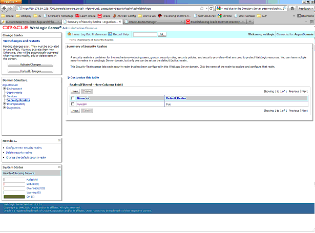

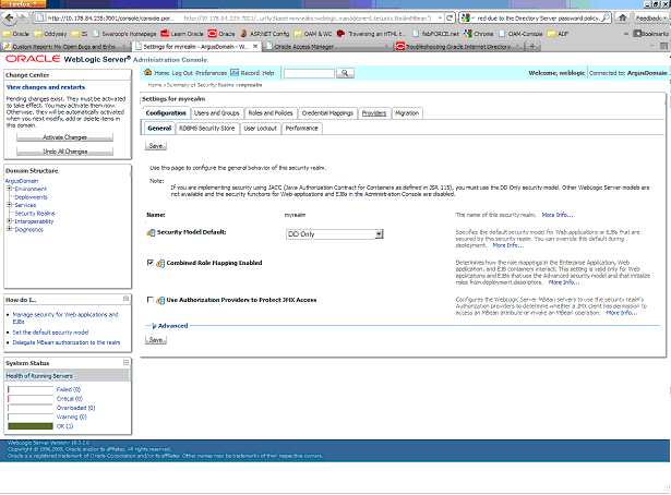

Log in to the WLS Administration Console. From the Domain Structure pane, click Security Realms. Then click myrealm.

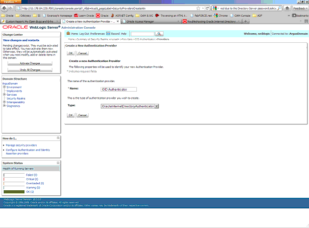

Navigate to Providers => Authentication. Click New to create a new provider.

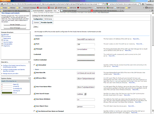

Enter Name as OID Authenticator and select type from the dropdown as OracleInternetDirectoryAuthenticator. Click OK.
Go back to the Providers tab and click OID Authenticator, which appears as link.
In the Common sub tab modify the Control Flag field to Sufficient and click Save.

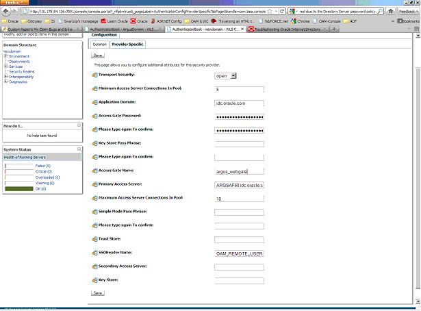

Click the Providers Specific tab and provide values for the fields described in the table below:
Table 12-7 Values for the Providers Specific tab
| Parameter Name | Description | Sample Value |
Host |
LDAP Hostname |
infra.vm.oracle.com |
Port |
LDAP Port |
389 |
Principal |
LDAP admin principal |
cn=orcladmin |
Credential |
Password for admin principal (password of cn=orcladmin) |
User Base DN |
User Search Base - This value can be obtained by checking the Users realm DN from OID |
For example, cn=Users,dc=idc,dc=oracle,dc=com |
All Users Filter |
Set as |
User Name Attribute |
Set to "uid" from "cn" |
uid |
Group Base DN - Group search base - Same as User Base DN |
Group Search Base - The DN used to search the Group, can be checked by Groups DN in OID |
For example, cn=Groups,dc=idc,dc=oracle,dc=com |
Retain the default values for the remaining attributes. Click Save.
This section describes how to configure the OAM identity asserter in WebLogic server security realm.
Click the Providers tab to see list of providers.
Click New. Enter name as OAMIdentity Asserter and select type as OAMIdentityAsserter.
Click OK to save the details. Now click the newly added OAMIdentityAsserter, which appears as link to view its details.
In the Common sub tab select control flag as REQUIRED and click Save.
Navigate to the Providers sub tab and provide the details in the table below:
Table 12-8 Values for Provider sub tab
Transport Security |
Encryption type for Access Gate communication |
Open |
Primary Access Server |
Provide OAM server endpoint information in HOST:PORT format |
argsaf60.us.oracle.com:6021 |
Access Gate Name |
Copy the Access Gate name from the AG created from Step 3. |
idc.oracle.com_AG |
Access Gate Password |
Type the Access Gate Password configured in access system console |
This section describes how to configure the deafult authenticator and set the prder of the providers.
Navigate to the list Click Default Authenticator from the list of Security Providers in the console, and set Control Flag to SUFFICIENT. Click Save.
Set the Order for providers as follows:
OAMIdentityAsserter - REQUIRED
OracleInternetDirectoryAuthenticator - SUFFICIENT
DefaultAuthenticator - SUFFICIENT
DefaultIdentityAsserter
Log in to the machine where web center has been installed and navigate to user_projects/domains/wc_domain/bin. Now edit the file setDomainEnv.cmd.
Note: Ensure that you take a backup of the file setDomainEnv.cmd before making changes. |
Add following code at the end of the file:
Let's say EXTRA_JAVA_PROPERTIES="-Dweblogic.security.SSL.ignoreHostnameVerification=true -Doracle.mds.bypassCustRestrict=true
-Djps.update.subject.dynamic=true -Doracle.webcenter.spaces.osso=true
-noverify ${EXTRA_JAVA_PROPERTIES}"
Export $EXTRA_JAVA_PROPERTIES
Restart the Admin servers, managed servers and HTTP Server.
