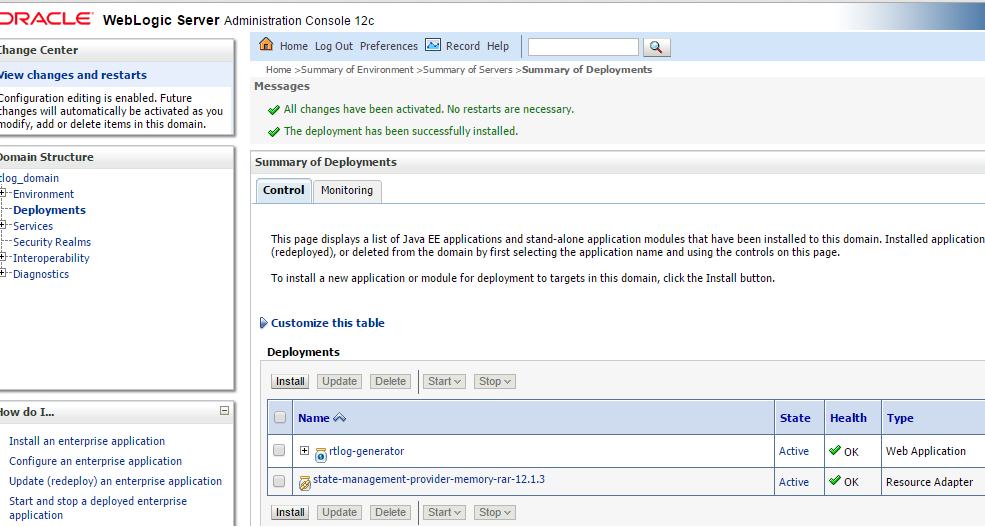

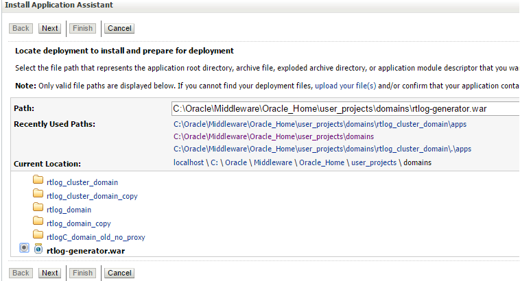

To deploy the RTLog Generator application:
  1. Log in to the WebLogic 12 Server Administration Console (http://<hostName>:<port>/console).
  2. Click the Deployment link from the left navigation menu.
  3. Click Install.
    Figure 6-4 Administration Console Control Page
    This image shows the Administration Console Control page.

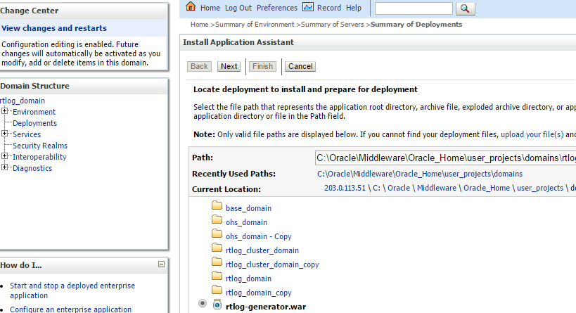

  4. Navigate to the rtlog-generator.war file directory. Select the rtlog-generator.war option.
    Figure 6-5 Administration Console Install Application Assistant Page
    Administration Console Install Application Assistant page

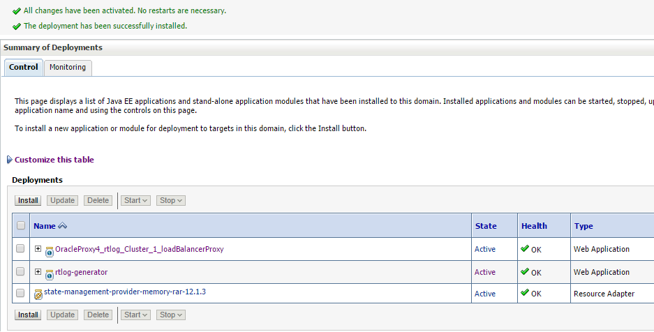

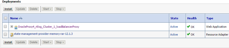

  5. Click Next and then Finish. Once deployed, RTLog Generator should be listed as one of the deployed applications as shown in Figure 6-6.
    Figure 6-6 Administration Console Summary of Deployments
    Administration Console Summary of Deployments page

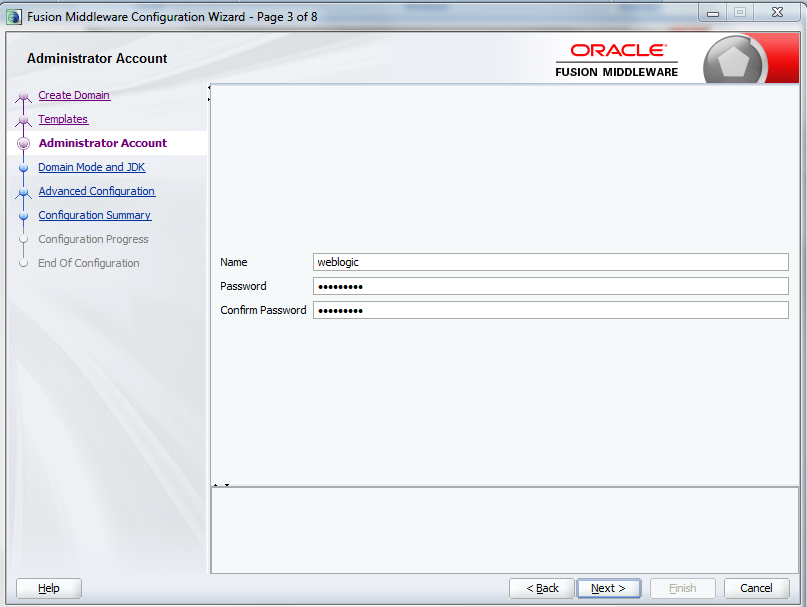

  4. On the Administrator Account page, enter the Administrator user name and password. Enter the password a second time to confirm. Click Next.
    Figure 6-9 Configuration Wizard Administrator Account Page
    Configuration Wizard Administrator Account page.

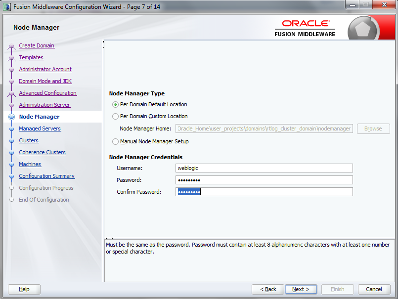

  8. On the Node Manager page, do not change the default node manager settings. For the credentials, enter weblogic as the user name and enter the password. Click Next.
    Figure 6-13 Configuration Wizard Node Manager Page

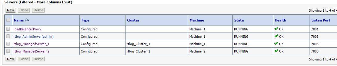

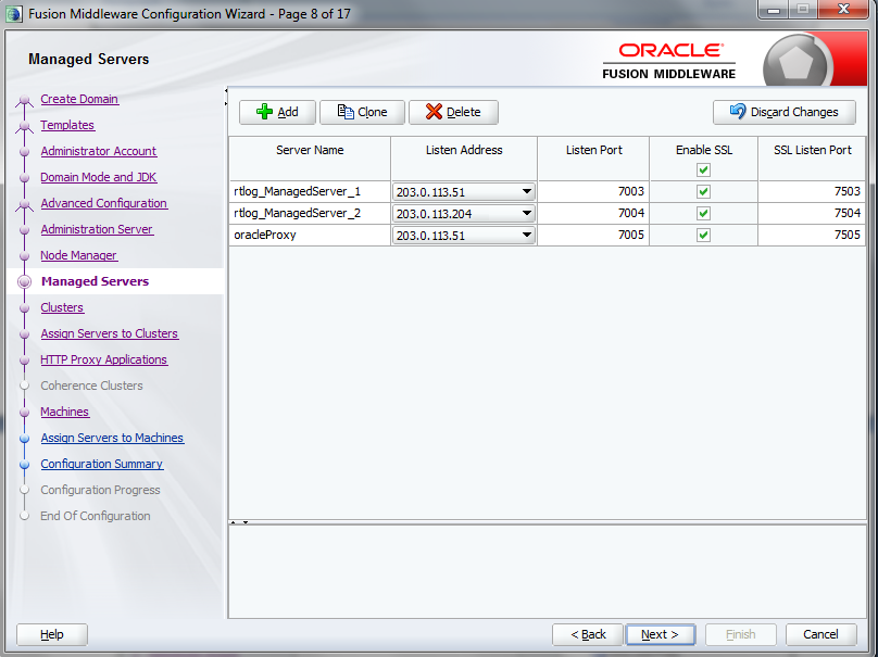

  9. On the Managed Servers page, add and configure each managed server:
    1. For the listen address, enter the IP address of the managed server. Do not select All local Addresses.
    2. rtlog_ManagedServer_1 will be running on Machine_1 in this configuration. Enter the Machine_1 IP address for the server.
    3. rtlog_ManagedServer_2 will be running on Machine_2 in this configuration. Enter the Machine_2 IP address for this server.
    4. oracleProxy is running on Machine_1, but is not a part of the cluster. It is an Oracle proxy HTTP cluster servlet used for failover and load balancing purposes. Enter the Machine_1 IP address for this server.
    5. Enable SSL for all the managed servers.
    6. Click Next.
    Figure 6-14 Configuration Wizard Managed Servers Page
    Configuration Wizard Managed Servers page.

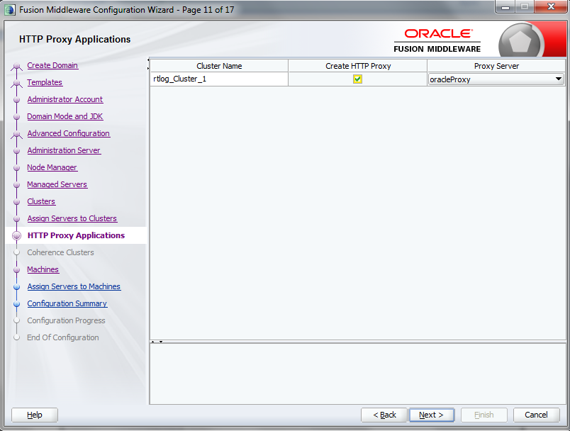

  12. On the HTTP Proxy Applications page, select Create HTTP Proxy and then select the server from the drop-down list. By default, it should have already been selected. Click Next.
    Figure 6-17 Configuration Wizard HTTP Proxy Applications Page
    Configuration Wizard Proxy Applications page

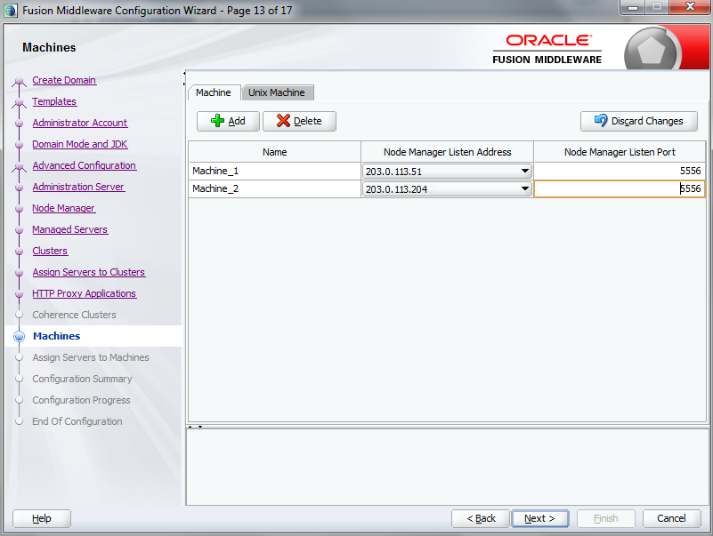

  13. On the Machines page, add and configure each machine. To add Machine_1 and Machine_2, click Add and enter the respective IP addresses. This configuration is for setting up the Node managers on both the machines. Since these node managers are physically separated, you can select the same host. Click Next.
    Figure 6-18 Configuration Wizard Machines Page

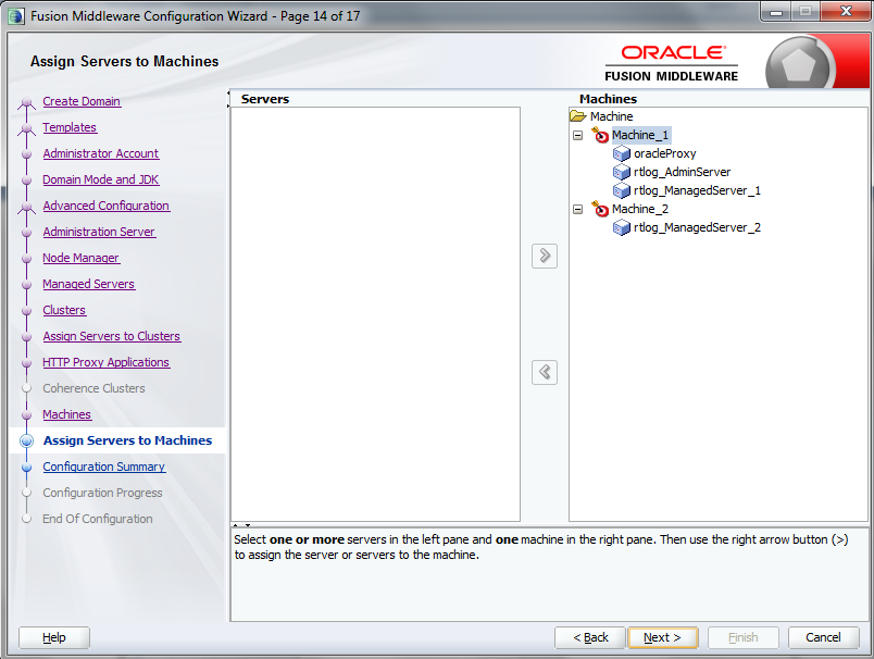

  14. On the Assign Servers to Machines page, assign the servers to the machines. In this example, Oracle proxy (load balancer), Administration server, and one managed server are configured on Machine_1. Another managed server is configured on Machine_2. Click Next.
    Figure 6-19 Configuration Wizard Assign Servers to Machines Page
    Configuration Wizard Assign Servers to Machines page

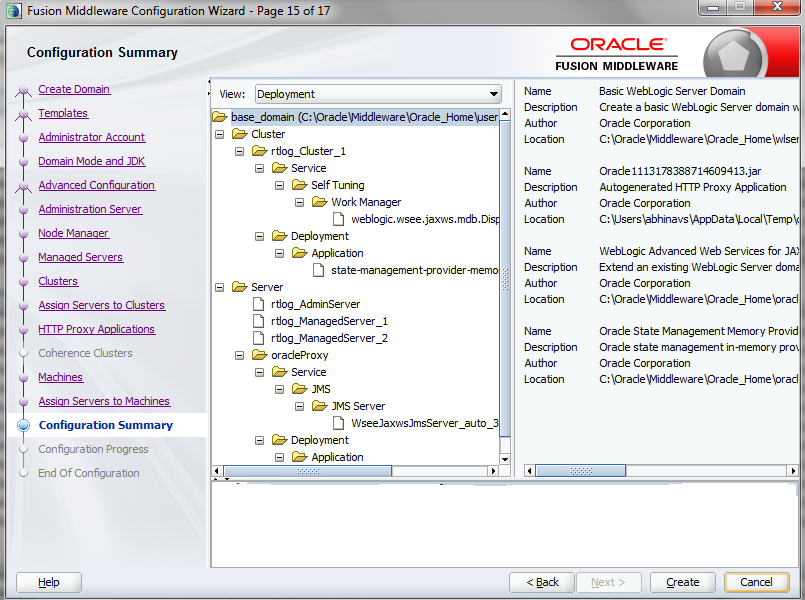

  15. On the Configuration Summary page, verify the selected configuration. Click Create. The domain is created.
    Figure 6-20 Configuration Wizard Configuration Summary Page
    Configuration Wizard Configuration Summary page

          <name>Machine_1</name>
          <nm-type>Plain</nm-type>
          <listen-address>203.0.113.51</listen-address>
        </node-manager>
     </machine>
     <machine>
        <name>Machine_2</name>
        <node-manager>
          <listen-address>203.0.113.204</listen-address>
        </node-manager>
      </machine>

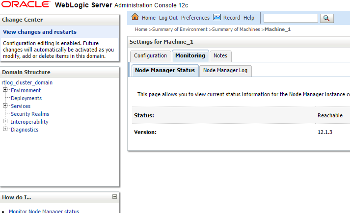

  7. Log in to the Administration Server console and make sure all the node managers are reachable. This can be found under Machines. Repeat this step for all the clustered machines to ensure all of them are reachable.
    Figure 6-21 Administration Console Settings Page
    Administration Console Settings page under Machines

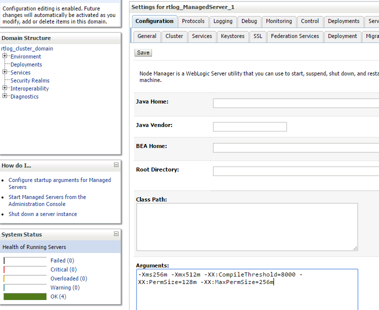

  8. For each managed server, select the Server Start tab. In the Arguments text box, add the following if it does not already exist:
    -Xms512m -Xmx512m -XX:CompileThreshold=8000 -XX:PermSize=512m -XX:MaxPermSize=512m
    Figure 6-22 Administration Console Configuration Page
    Administration Console Configuration page under ServerStart
    If you want to configure the non-default external RTLog configuration directory, include an additional JVM argument:
    -Drtloggen.config.dir=C:/<rtlog-gen-config_1>/
    The server-start arguments only work when you are using a NodeManager. If you do not have a NodeManager, specify the JVM argument in the start up scripts. You can also configure the same ext directory location in the RTLog Generator WAR's context-param. For more information, see "Configuration".
  9. Start all the managed servers including the Oracle proxy. Figure 6-23 shows an example of the list of managed servers.
    Figure 6-23 Administration Console List of Servers
    Administration Console List of Servers with Oracle Proxy

  2. Navigate to the Administration Console home page and click Deployments in the left navigation menu. Figure 6-24 shows an example of the page before deploying the RTLog Generator application.
    Figure 6-24 Administration Console Deployments Page
    Administration Console Deployments page.
  3. Click Install. The Install Application Assistant page appears. Select the path to the RTLog Generator WAR directory. Select the rtlog-generator.war option. Click Next.
    Figure 6-25 Administration Console Install Application Assistant Page
    Administration Console Install App Assistant for RTLog
  4. Select only the managed servers and click Next to finish the deployment.
    Figure 6-26 Install Application Assistant Select Deployment Targets Page
    Install Application Assistant Select Deployment Targets page
    After it is successfully deployed, the RTLog Generator application appears in the Summary of Deployments page.
    Figure 6-27 Summary of Deployments Page
    This image shows the Summary of Deployments page.

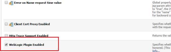

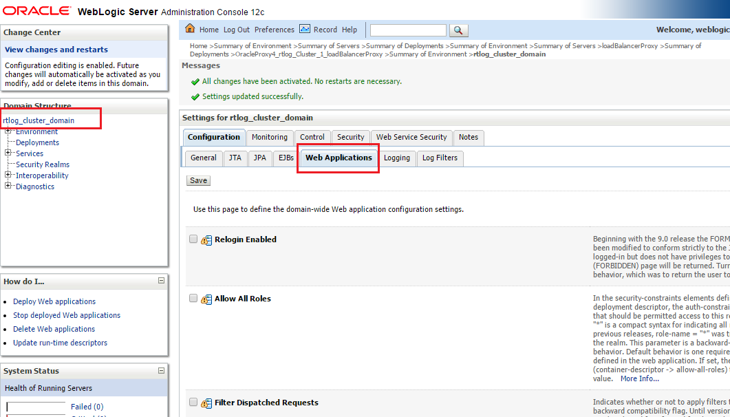

  6. To enable the WebLogic Plugin Enabled parameter from the cluster domain:
    1. Click the <rtlog_cluster_domain> link in the left navigation menu. Navigate to the Web Application tab.
      Figure 6-28 Administration Console Settings Page
      Administration Console Settings for the Web Application tab
    2. Scroll down the page and select WebLogic Plugin Enabled. Click Save.
      Figure 6-29 WebLogic Plugin Enabled Parameter
      This image shows the WebLogic Plugin Enabled parameter.

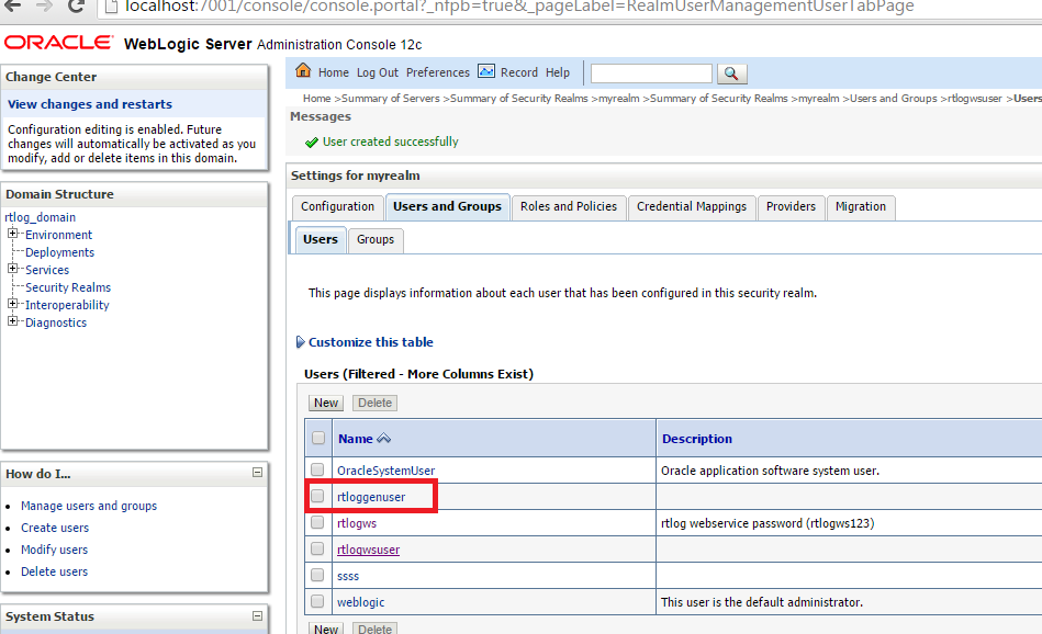

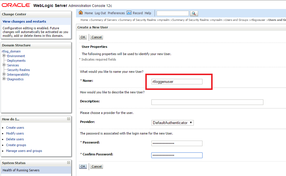

  5. Select the Users tab and click New. Enter a user name and password and click OK.
    Figure 6-32 Create a New User Page
    This image shows the Create a New User page.
  6. In the list of users, click the newly created user.
    Figure 6-33 Users Page
    This image shows the Users page.

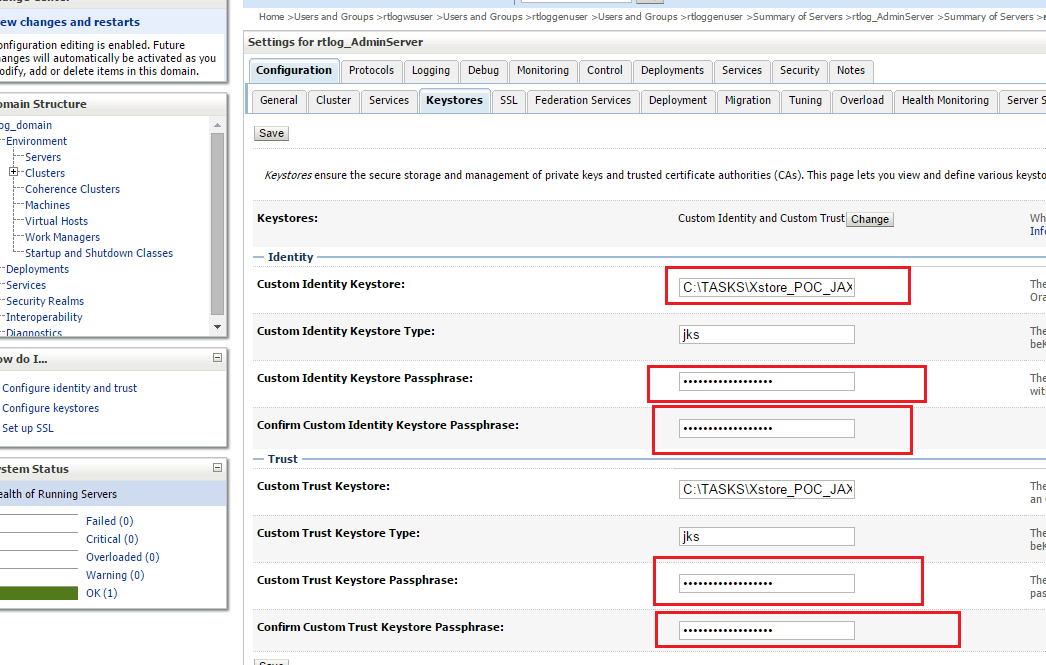

  5. Click the linked name for the Administration Server. The page containing the settings for the Administration Server appears. Select the Keystores tab.
    Figure 6-38 Settings for the Administration Server
    This image shows the settings for the Administration Server.
  6. Enter the path to keystore.jks, including the file name, and enter the custom Identity Keystore passphrase you created for the keystore. Repeat this for trustore.jks, but enter the appropriate passphrase for the truststore. For an example, see Figure 6-38.
  7. Switch to the SSL tab. Enter the alias name and private keyphrase as created during the certificate generation. To save the changes, click Save.
    Figure 6-39 Save Settings for Administration Server
    Save settings for the Administration Server
