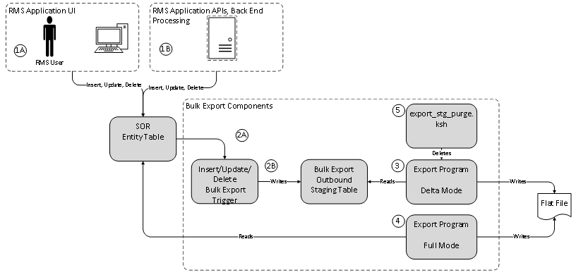

RMS Foundation Data Extracts
RMS writes data to .dat files using a series of .ksh extract scripts. These scripts support both kill/fill (full) and delta processing. Many of these scripts also support creating files that apply either to all stores (for Xcenter, to facilitate cross store processing) or store-specific files. For an example, see Figure 2-5.
There are some entity specific variations, but RMS uses a general pattern for foundation data bulk export as shown in Figure 2-2.
Figure 2-2 RMS Foundation Data Bulk Export
Surrounding text describes Figure 2-2 .
The following steps describe the data bulk export flow shown in Figure 2-2:
  1. A business user using the RMS application UI (1A) or an API/Batch Process (1B) performs an insert/update/delete on a System of Record (SOR) table.
  2. Trigger on SOR entity table fires on insert/update/delete (2A). Trigger writes new/changed/deleted information to the outbound staging table (2B).
  3. In delta mode, the program reads the bulk export staging table to get recently created, modified, and deleted records and writes them to a file. Records are marked as exported.
  4. In full mode, the program reads all current records from the SOR table and writes them to a file. Note that recently deleted records are not part of the data set.
  5. export_stg_purge.ksh drops aged partitions from the export outbound staging tables.
    If bulk extract programs are not run for some time, it is possible that delta records will be purged without having been exported. It is important to run these jobs daily.
For more detailed information, see the following documents:

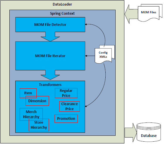

Xstore DataLoader
DataLoader is the Xstore component responsible for translating RPM and RMS flat files into database data that can be used by Xstore. It can consume .mnt files from third-party sources, or the foundation data batch .dat files produced by RMS and RPM.
The DataLoader interacts with Xstore Office, Xcenter, Xenvironment, and Xstore Point of Service to provide a complete automated solution for the propagation of foundation data changes to the centralized and store-level databases used in an enterprise Xstore deployment. Xstore data not supplied by RPM and RMS can also be loaded by the DataLoader using its native .mnt format.
The DataLoader is designed to adapt flat files of data into relational data that Xstore can use. These flat files are referred to generically as data files within the DataLoader. Each field in a data file is delimited by a vertical bar (|) character. The DataLoader is configured to detect file types so it can process a data file's lines in distinct units of work appropriate for the type of file. For most file types, a unit of work corresponds to a single line of flat file data; however, RPM promotion files are an example of a file type where a unit of work can consist of multiple lines of flat file data.
If a failure occurs during DataLoader processing of a data file, all SQL statements associated with the unit of work are rolled back and the error is logged. Processing continues with the next unit of work in the data file.
  • Retail Reference Architecture
  • Oracle Retail Xstore Point of Service Host Interface Guide available on My Oracle Support.
Both documents are available on My Oracle Support.
DataLoader Detailed Description
DataLoader is configured at the corporate and store level. It is responsible for detecting and sorting incoming data files, and iterating through them to convert each file record into persistable objects (DAO or SQLQuery) and writing them into the database. All its major components are spring loaded from dataloader-bean.xml, and are therefore highly customizable.
Figure 2-4 shows the flow of the DataLoader.
Figure 2-4 DataLoader Flow
Surrounding text describes Figure 2-4 .

File Detection
DataLoader is configured with a list of detectors to identify known file types that can be processed. Unknown file types are skipped and not processed. A Merchandising file detector is configured to identify all types of Merchandising data files and their meta data.
The detection is based solely on file names. Regular expressions are configured to perform pattern matching in file name to identify Merchandising file types and its meta data including target store ID, fill type, timestamp, and line count:
  • Merchandising file type detection
    A file name is matched against regular expressions configured to detect its Merchandising type. If no match is found, the file is not a Merchandising file type. The keys in the bean configuration are the Merchandising file types that Xstore/Xcenter care about.
  • Target store detection
    Target store ID is used by DataLoader as well as Xstore Office to determine the deployment target of a Merchandising file.
    A file name is matched against regular expressions configured to detect its target store ID. Not all Merchandising file types have a target store ID configured:
    • If a store ID is not detected, the file is deployed to all stores and imported into Xcenter.
    • If a store ID is detected and is corp, the file is imported into Xcenter only.
    • If a store ID is detected and is not corp, it is deployed to the store. With the exception of Item Header batch, it is also imported into Xcenter.
  • Timestamp detection
    Timestamp is used by DataLoader to sort the files. For more details, see "File Sorting". A file name is matched against regular expressions configured to detect its timestamp.
  • Line count detection
    Line count is used by DataLoader to validate a file. If the number of lines in the file (excluding FHEAD and FTAIL) does not match the line count, a warning is logged. A file name is matched against regular expressions configured to detect its line count. Only RMS extracts support line count in their file names.
File Sorting
There are some data dependencies when importing RMS files into Xstore, such as related item detail that needs to be imported after the related item header. When DataLoader is called to import multiple Merchandising files in the same deployment, it applies sorting to the files before importing them.
A detector is configured to have a sorting strategy, which is used to sort all the files the detector detects. A Merchandising file sorting strategy bean is configured for the Merchandising file detector to perform sorting for all Merchandising files based on their file types. Files of the same Merchandising file type are sorted based on their timestamps. Out of the box the following sorting order is specified:
  • Org Hierarchy
  • Store
  • Store Address
  • Merchandise Hierarchy
  • VAT
  • Diff Group Head
  • Diff Group Detail
  • Diff
  • Item Head
  • Item Loc
  • VAT Item
  • Related Item Head
  • Related Item Detail
  • Regular Price Change
  • Clearance Price Change
  • Promotion Price Change
File Loading Dependency
Although the sorting strategy configuration lists all Merchandising file types, not all file types have file loading dependencies. The actual dependencies are shown in the following table:
File Type Depends on
VAT Item Item Loc
Store Address Store
Related Item Detail Related Item Head, Item Loc
Item Loc Item Head
Item Head Diff, Diff Group Detail, Diff Group Head, Merchandise Hierarchy
Diff Group Detail Diff Group Head
Diff Diff Group Detail, Diff Group Head
File Iteration and Transformation
DataLoader processes each file in the sorted order. It invokes a file iterator to process each file. A file iterator implements Java Iterator interface. During each iteration, it transforms flat file records into a list of IPersistable (DAO or SQLQuery) objects, and returns them.
A Merchandising file iterator is configured for each Merchandising file type. It processes lines between unit dividers as a data unit that should be transformed together:
  • A single line iterator that expects each line in the file, other than FHEAD or FTAIL, is a data unit that gets transformed during each iteration. One and only one line in a unit is expected. An exception is raised if that is not the case.
  • A multi-line iterator expects multiple lines to form a data unit that gets transformed together during each iteration. A unit may contain one or more lines. Out of the box, only promotion price change is configured to have a multi-line iterator.
  • Unit dividers are lines that end a unit. They are configured as unit definitions for each Merchandising file type.
A Merchandising transformer is called to convert a unit of data from a flat file to a list of IPersistable (DAO or SQLQuery) objects. A transformer is configured for each Merchandising file type.
All Merchandising transformers implement the IMOMDataTransformer interface, which defines two APIs:
  • The transform API is invoked by the iterator in each iteration. It does all the transformation to turn a unit of flat file data to a list of IPersistable objects to create, update, or delete foundation data records in database.
  • The purgeData API is invoked once for a file by the iterator. It is only called if the file is for a full reload. It returns a list of IPersistable objects to remove all existing records sourced from Merchandising.
Persisting into the Database
DataLoader saves IPersistable objects to database in batches. A batch contains a list of AtomicPersistables objects. The maximum number of AtomicPersistables objects in a batch is configurable. An AtomicPersistables is a container of a group of IPersistable objects that must all be persisted or rolled back together as a unit. All IPersistable objects returned in one iteration are grouped into one AtomicPersistable object.
DataLoader first attempts to persist and commit all IPersistable objects from all AtomicPersistables objects in a batch together. If it fails, it tries to persist and commit IPersistable objects from one AutomiPersistables at a time. The number of succeeded and failed records are written to summary.ini files.
