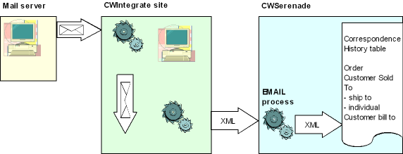

Emails Repository Process Overview
The CWIntegrate email site:
• picks up an incoming email sent from your mail server
• converts the email to XML
• sends the XML message to CWSerenade
Once the email is in CWSerenade, the EMAIL process in Integration Layer Job Control:
• translates the XML message to a Correspondence History record
• assigns ("routes") the email to customers based on the message identifier(s) specified, or by searching for a customer with a matching email address
• flags the email as Unrouted if the email includes invalid, inconsistent, or insufficient identifying information.

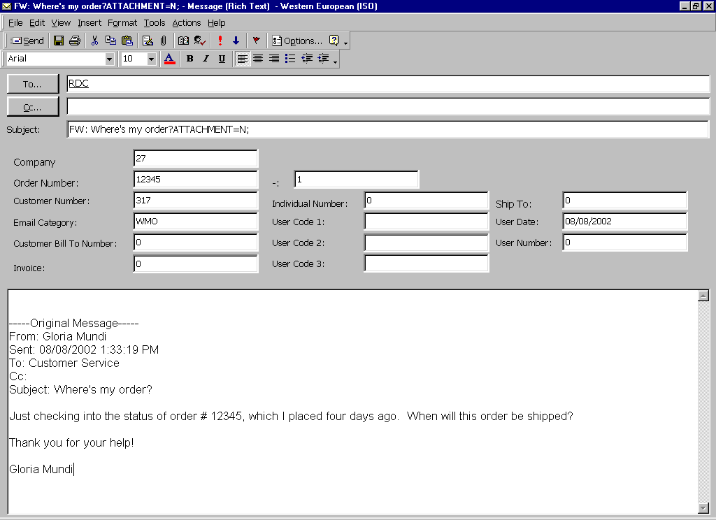

Using the Outlook form: The email site includes a form that customer service representatives can install and use in Outlook to make forwarding and identifying emails easier. The form includes fields to specify key email identifiers, such as: order, drop ship purchase order, or order invoice number; sold-to and other customer numbers; and user-defined information. The “to” address on the form directs the email to the email site, which translates the email to XML and then forwards it into CWSerenade.
Including email identifiers in the subject line: If you use the email site, you can also enter email identifiers in the subject line of an email. For example, by entering COMPANY=27;CUSTOMER=317 in the subject line, you indicate to the system that the email is related to customer # 317 in company 27. There are email identifiers that:
• you can enter using the form fields or the subject line (for example, customer number)
• you can enter only at the subject line
• that the system fills in for you on the subject line (for example, ATTACHMENT=N; or ATTACHMENT=Y;)
• that you need to enter only as an override to the default (company number)
