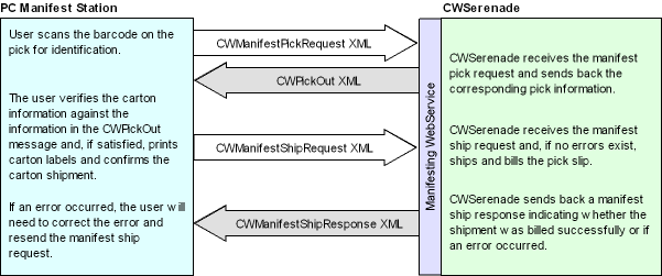

PC Manifesting Process Overview
Purpose: Use the PC Manifesting interface to process shipment confirmations between a PC manifesting system and CWSerenade.
Voiding or unshipping a shipment confirmation: The current PC Manifesting interface between CWSerenade and a PC manifest system does not provide the ability to unship a package or send a void request from the manifest station to CWSerenade.
PC Manifesting Process:
The typical shipment confirmation process between a PC manifest system and CWSerenade includes the following steps.
1. You generate pick slips for an order and send the pick slip information to the warehouse for fulfillment.
2. A user in the warehouse uses the pick slip to fulfill the order, packaging the items in one or more cartons. Optionally, you can use Working with Pick/Pack Verification (WPPV) to confirm the cartons are packed correctly.
3. A user at the PC manifest station scans the barcode on the pick slip in order to request package information from CWSerenade.
Typically, the pick slip barcode includes the company code, pick control number, and pick control label number.
4. The manifest station sends a Manifest Pick Request Message (CWManifestPickRequest) to CWSerenade. The CWManifestPickRequest message includes the CWSerenade company code and pick control number, and optionally, the pick control label number.
5. CWSerenade receives the Manifest Pick Request Message (CWManifestPickRequest) and determines if a pick slip exists for the company code, pick control number, and optionally, pick control label number defined in the CWManifestPickRequest message.
If a pick slip exists for the company, pick control number, and pick control label number specified, CWSerenade:
• uses records in the Pick Control Header and Pick Control Detail tables to generate a Pick Message from CWSerenade (CWPickOut) to send to the PC manifest station.
• stores a copy of the Pick Message from CWSerenade (CWPickOut) in the Pick Out table. CWSerenade needs to store a copy of the CWPickOut message in the Pick Out table because once the first carton for a pick control number is confirmed, the system removes the associated records from the Pick Control Header and Pick Control Detail tables. If another CWManifestPickRequest message is received from the manifest station for the pick control number, CWSerenade can use the record in the Pick Out table to regenerate the CWPickOut message to resend to the manifest station.
If a pick slip does not exist for the company, pick control number, and pick control label number specified, CWSerenade returns a Manifest Pick Request Message (CWManifestPickRequest) to the PC manifest station containing a description of the error in the invalid_message tag. See Manifest Pick Request Errors for a list of errors.
6. The PC manifest station receives the CWPickOut message and displays the information in the message on the manifest station screen.

7. The user at the PC manifest station verifies that the name and address information and items that display on the manifest station match the name and address information and contents of the carton at the manifesting station.
8. The user at the manifest station weighs the carton in order to enter weight information and selects the carrier to ship the carton.
9. The user at the manifest station confirms the carton shipment.
The manifest station:
• prints a label to attach to each carton. Typically, the carton label includes the following information:
• pick control number and pick control label number
• ship to customer name and address information
• carton details, such as the weight and tracking number
• name of the carrier that is shipping the carton
• sends a Manifest Ship Request Message (CWManifestShipRequest) to CWSerenade, indicating the carton has been shipped and confirmed.
The CWManifestShipRequest message includes the company, pick control number and pick control label number that has been confirmed, as well as the date and time. In addition, the CWManifestShipRequest may include meter charges, the weight of the carton, the shipper used to ship the carton, and the carton’s tracking number.
Note: If the shipment is split into more than one carton, the user at the manifest station will need to confirm each carton shipment. You can print additional pick control labels using Printing Additional Pick Labels (PAPL).
10. CWSerenade receives the Manifest Ship Request Message (CWManifestShipRequest) and creates an active procedure for the company code, pick control number, and pick control label number while it processes the shipment.

PC Manifest Message Flow
Purpose: A sample of the message flow between the PC manifest station and CWSerenade is presented below.
1. A user at the PC manifest station scans a pick slip and sends a Manifest Pick Request Message (CWManifestPickRequest) to CWSerenade, requesting pick slip identification.
CWManifestPickRequest message:
<Message source="ManifestStation" target="CWSerenade" type="CWManifestPickRequest">
<CWManifestPick company="7" pick_control="6" pick_label="1" />
</Message>
2. CWSerenade receives the Manifest Pick Request Message (CWManifestPickRequest) and returns a Pick Message from CWSerenade (CWPickOut) to the PC manifest station. The user at the PC manifest station uses the CWPickOut message to verify that the name and address information and items in the CWPickOut message match the name and address information and contents of the carton at the manifesting station.
CWPickOut message:
<Message source="CWSerenade" target="ManifestStation" type="CWPickOut" date_created="2009-04-05" time_created="15:33:09">
<PickHeader transaction_type="A" company="7" pick_nbr="6" pick_status="M" nbr_labels="2" billing_batch_nbr="4" date_printed="2009-04-05" time_printed="13:00:08" cart_batch_nbr="1" pick_zone1="P" nbr_lines="1" gen_type="R" merch_amt="5.00" amt_paid="10.00" total_order_amt="5.00" first_pick="Y" master_carton_nbr="6" master_carton_pick="N" master_label_order="N" order_nbr="6" order_shipto_nbr="1" sold_to_customer_nbr="2" ship_to_fname="BERNADETTE" ship_to_initial="T" ship_to_lname="MIRANDA" ship_to_addr1="109 RIVER LN" ship_to_country="USA" ship_to_country_name="UNITED STATES OF AMERICA" ship_to_city="TEMPLETON" ship_to_state="MA" ship_to_state_name="MASSACHUSETTES" ship_to_postal_code="01468" ship_to_delivery_code="R" ship_to_day_phone="5085550100" ship_to_day_ext="911" ship_to_eve_phone="9785550101" ship_to_po_box_flag="N" ship_via="1" ship_via_desc="PARCEL POST - USPS" drop_point="1" whse="1" whse_company="7" nbr_cartons="2">
<CustomerSoldToAddress company="7" sold_to_customer_nbr="2" sold_to_alternate_id="000000002" sold_to_fname="BERNADETTE" sold_to_initial="T" sold_to_lname="MIRANDA" sold_to_addr1="109 RIVER LN" sold_to_country="USA" sold_to_country_name="UNITED STATES OF AMERICA" sold_to_city="TEMPLETON" sold_to_state="MA" sold_to_state_name="MASSACHUSETTES" sold_to_postal_code="01468" sold_to_delivery_code="R" sold_to_email_status="O1" sold_to_po_box_flag="N" sold_to_day_phone="5085550101" sold_to_day_ext="911" sold_to_eve_phone="9785550102" />
<OrderHeader company="7" order_nbr="6" nbr_recipients="1" order_date="2009-04-05" entered_date="2009-04-05" entered_time="09:15:56" sold_to_customer_nbr="2" order_type="P" order_type_desc="PHONE ORDER" sales_rep_nbr="1" source="2007" customer_class="CL" entity="100" entity_description="AVIAN FRIENDS"/>
<OrderShipTo company="7" order_nbr="6" order_shipto_nbr="1" tax_code="N" arrival_date="2009-04-05" cancel_bo="N" gift_order="N" merch_amt="10.00" merch_balance_amt="10.00" ship_complete="N" nbr_lines="2" ship_via="1" ship_via_desc="PARCEL POST - USPS" />
<OrderPayments>
<OrderPayment pay_type="1" pay_type_desc="CASH, CHECKS" pay_category="1" />
</OrderPayments>
<PickDetails>
<PickDetail company="7" pick_nbr="6" pick_line_nbr="1" original_qty_printed="1" qty_printed="1" cart_bin_nbr="3" affect_inventory="Y" selling_price="5.00" selling_price_extended="5.00" qty_ordered="1" order_nbr="6" order_shipto_nbr="1" order_detail_nbr="2" item="SHIPALONE" item_desc="SHIPALONE ITEM DESCRIPTION" sku="">
<PickLocations>
<PickLocation company="7" pick_nbr="6" pick_line_nbr="1" whse="1" whse_company="7" whse_zone="P" whse_location="PRIMARY" qty_allocated="1" />
</PickLocations>
<OrderDetail company="7" order_nbr="6" order_shipto_nbr="1" order_detail_nbr="2" affect_inventory="Y" arrival_date="2009-04-05" date_printed="2007-01-05" date_reserved="2007-01-05" original_price="5.00" selling_price="5.00" qty_ordered="1" qty_printed="1" qty_reserved="1" time_reserved="09:16:19" gift_wrap="N" date_entered="2009-04-05" time_entered="09:15:56" freight_override="N" offer_price="5.00" price_method="6" set_main_item="N" prediscount_amt="5.00" warranty_item="N" item="SHIPALONE" item_desc="SHIPALONE ITEM DESCRIPTION" offer="207" source="2007" />
<Item Company="7" Item_Number="SHIPALONE" Allow_SKUs="N" Drop_ship_item="N" Non-inventory="N" Serial_Nbr_tracking="N" Ship_alone="S" Standard_cost="15000" ITM_Allow_Pct_discount="Y" ITM_Oversize_flag="N" ITM_Description="SHIPALONE ITEM DESCRIPTION" ITM_Exclude_From_Flex_Pay="N" ITM_Royalty="N" ITM_Membership="N" ITM_Create_Date="1070104" Buyer="BTM" Buyer_Name="BERNADETTE T MIRANDA" Unit_of_measure="EA" UOM_Description="EACH" UOM_Units="1" Vendor_Nbr="7" VIA_Ship_via_code="0">
<SKU SKU_Subscription="N" SKU_Gift_certificate="N" Out_of_stock_flag="N" Restrict_orders="N" Short_SKU="3" Sale_credit_flag="N" SKU_Open_qty="1" SKU_Standard_Cost="15000" SKU_VAT_Exempt_flag="N" SKU_Suppress_BO_Card="N" SKU_Returnable="N" SKU_Excl_Store_Restock="N" SKU_Last_Download_Qty="100" SKU_Create_Date="1070104" Warehouse="1" Warehouse_name="WAREHOUSE 1" Location="PRIMARY" SKU_Element_1_Code="" SKU_Element_1_Name="COLR" SKU_Element_2_Code="" SKU_Element_2_Name="SIZE" SKU_Element_3_Code="" SKU_Element_3_Name="OTHR" />
</Item>
</PickDetail>
</PickDetails>
</PickHeader>
</Message>
3. The user at the PC manifest station confirms the package shipment. The manifest station prints a carton label and sends a Manifest Ship Request Message (CWManifestShipRequest) to CWSerenade, indicating the carton has been shipped and confirmed.
CWManifestShipRequest message:
<Message source="ManifestStation" target="CWSerenade" type="CWManifestShipRequest">
<CWManifestShip company="7" pick_control="6" pick_label="1" batch_date="01/07/2007" batch_time="17:30:12" scan_date="01/08/2006" scan_time="08:30:10" meter_charges="1.45" weight="12.85" station_id="Manifest1" tracking_nbr="1237894598717" ship_via="01" miscellaneous_data1="9785550102" miscellaneous_data2="50865550100" miscellaneous_data3="87" />
</Message>
4. CWSerenade receives the Manifest Ship Request Message (CWManifestShipRequest) and if the message includes valid data, ships and bills the pick slip. Once the pick slip has been shipped and billed in CWSerenade, CWSerenade returns a Manifest Ship Response Message (CWManifestShipResponse) to the PC manifest station, indicating if the shipment updates were successful.
CWManifestShipResponse message:
<Message source="CWSerenade" target="ManifestStation" type="CWManifestShipResponse" date_created="2007-01-08" time_created="09:28:48">
<CWManifestShip batch_date="01/07/2007" batch_time="17:30:12" company="7" meter_charges="1.45" miscellaneous_data1="9785550104" miscellaneous_data2="5085550103" miscellaneous_data3="87" pick_control="6" pick_label="1" scan_date="01/08/2006" scan_time="08:30:10" ship_via="01" station_id="Manifest1" tracking_nbr="1237894598717" weight="12.85" pass_fail="PASS" />
</Message>
The PC manifesting station sends this message to CWSerenade when it receives a pick slip to confirm.
CWSerenade also writes a copy of the message to the Manifesting log (MANIFEST.log).
CWSerenade returns a Pick Message from CWSerenade (CWPickOut) to the PC manifest station, providing pick slip details to match to the package at the manifest station.
See Manifest Pick Request: Sample XML for a sample of the CWManifestPickRequest message and see PC Manifesting Interface for an overview.
The PC manifest station sends this message to CWSerenade when it confirms a pick slip at the manifesting station.
Note: Numeric values in this message include decimals; for example, the meter_charges tag would display a charge of 5.50 instead of 550.
See Manifest Ship Request: Sample XML for a sample of the CWManifestShipRequest message and see PC Manifesting Interface for an overview.
