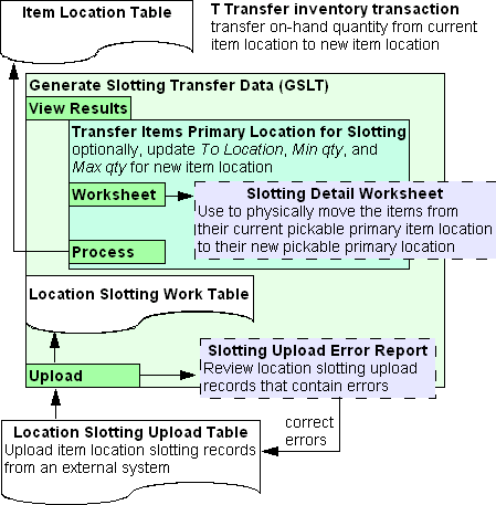

Standard Item Location Slotting Upload Process
Use the following steps to upload item location slotting records from an external system using the standard method.
• Populate the Location Slotting Upload Table
• Upload Records from the Location Slotting Upload Table to the Location Slotting Work Table
• Review and Work with Item Location Transfers
• Process the Item Location Transfers
Use the Working with File Uploads (WUPL) menu option to populate the Location Slotting Upload Table (INLCSU) with item location transfer records from an external system.
When you are ready to upload the records from the Location Slotting Upload table to the Location Slotting Work table use the Generate Slotting Transfer Data Screen to enter the Warehouse associated with the records in the Location Slotting Upload Table (INLCSU) you wish to upload and select Upload. The system displays the message Job has been submitted to batch.
• An error message displays if there are no records to process for the specified warehouse: There are no records to process in the upload table for the current warehouse.
• An error message displays if records already exist in the Location Slotting Work table for the specified warehouse: Results exist. Upload cannot be performed. Must clear or process first.
For each record in the Location Slotting Upload table for the specified Warehouse, the system:
• Validates that the required fields contain information and the fields that require a valid value contain a valid value. The minimum fields required for a Location Slotting Upload record are:
• Company; validated against the Company table.
• Warehouse; validated against the Warehouse table.
• Item; validated against the Item table.
• SKU if the item contains SKUs; validated against the SKU table.
• From Loc; validated against the Location table and Item Location table.
• To Loc; validated against the Location table. Note: Records with a blank To location print on the Slotting Upload Error Report; however, the system uploads the record to the Location Slotting Work table with the Confirm setting set to N.
• Loc Min Qty; If you set this field to 0, the system uses the From location’s minimum quantity as the minimum quantity for the new primary item location.
• Loc Max Qty; If you set this field to 0, the system uses the From location’s maximum quantity as the maximum quantity for the new primary item location.
• Validates that the From Loc and To Loc are different and are both pickable primary locations.
• Validates that there are no open picks for the From Location. Note: Records with open picks print on the Slotting Upload Error Report; however, the system uploads the record to the Location Slotting Work table with the Confirm setting set to N.
• Validates that the From item location is not involved in a pending replenishment or a batch inventory transaction.
Failed Location Slotting Upload
If a record in the Location Slotting Upload table does not pass validation, the system includes the record on the Slotting Upload Error Report and deletes the record from the Location Slotting Upload table. See Slotting Location Upload Errors for a list of errors.
Successful Location Slotting Upload
If a record in the Location Slotting Upload table passes validation, the system:
• Creates a record in the Location Slotting Work table.
• Deletes the record from the Location Slotting Upload table.
Once you have uploaded the records from the Location Slotting Upload table to the Location Slotting Work table, select View Results on the Generate Slotting Transfer Data Screen to advance to the Transfer Items Primary Location for Slotting Screen, where you can review the records in the Location Slotting Work table. On this screen, you can change the To Loc, Min, and Max for each record in the Location Slotting Work table. Once you have modified the records to transfer, select Yes in the Confirm field for each record you wish to transfer.
Once you have flagged the records in the Location Slotting Work table you wish to transfer:
• Select Worksheet on the Transfer Items Primary Location for Slotting Screen to generate the Slotting Detail Worksheet to help you physically move items from their current primary location to a new primary location.
• Select Process to perform a T Transfer type inventory transaction to transfer the on-hand quantity from the From location to the To location. See Slotting Item Location Transfer Process for processing details.

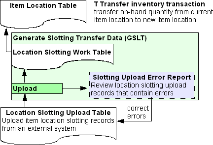

Streamlined Item Location Slotting Upload Process
Use the following steps to upload item location slotting records from an external system using the streamlined method.
• Upload and Process Item Location Transfers
When you are ready to upload and process the records from the Location Slotting Upload table use the Generate Slotting Transfer Data Screen to enter the Warehouse associated with the records in the Location Slotting Upload Table (INLCSU) you wish to upload and select Upload/Process. The system displays the message Job has been submitted to batch.
If a record in the Location Slotting Upload table does not pass validation, the system includes the record on the Slotting Upload Error Report. See Slotting Location Upload Errors for a list of errors.
• Performs a T Transfer type inventory transaction to transfer the on-hand quantity from the From location to the To location. See Slotting Item Location Transfer Process for processing details.
