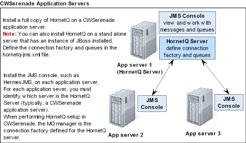

1. Install HornetQ on one of the CWSerenade application servers.The recommended version is hornet-2.0.0.GA, which you need to download from the HornetQ web site: http://hornetq.jboss.org/downloads.html. Note: MICROS recommends you install HornetQ on one of the CWSerenade application servers; however, you can install HornetQ on a separate server.
2. Configure CWSerenade to use HornetQ. See CWSerenade Property Settings for HornetQ, HornetQ Configuration File, and HornetQ Jar Files.
3. Create queues for the CWSerenade processes that send and receive messages with another system via queues; see Creating HornetQ Queues.
4. On each CWSerenade application server, install and configure HermesJMS, or some other extensible JMS console, to allow you to review and work with the messages processed by HornetQ.
5. When performing queue setup in CWSerenade, the MQ manager is the connection factory on the HornetQ server.
HornetQ illustration

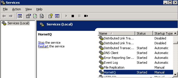

• Verify that the HornetQ service is started. To start the HornetQ service:
• Advance to the Services window by selecting Control Panel > Administrative Tools > Services.
• Highlight the HornetQ service; right-click, and select Start.
Note: The status of the HornetQ service changes to Started immediately; however, if you have a large number of messages in the queues, the HornetQ server may take a while to start. To verify that the HornetQ server is available, look for a message similar to the following in the server log: HornetQ Server version...started.
