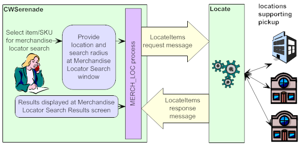

Overview: A typical process of inquiring on locations where an item is available for pickup is described below.
Used when? This process applies when the CW_LOCATE_MESSAGE_VERSION specified in Working with Customer Properties (PROP) is 3.0 or 3.1 for integration with those releases of Locate.
1.
A customer wants to know if an item/SKU is available for pickup at a nearby store. You select the item/SKU for merchandise locator inquiry. This option is available in order entry, order maintenance, and at the Display Item Availability Screen.
2.
You advance to the Merchandise Locator Search Window (Searching for an Item), where you provide or confirm the customer’s geographic location, and the radius to search within (for example, search all stores within 25 miles of the customer’s home).
Note: The Order Broker supports merchandise locator searches only in the U.S. and Canada.
3.
In the background, the MERCH_LOC integration layer process:
• Generates the LocateItems request message and sends it to an external system such as Locate. Locate checks the availability of the item in stores that stock the item/SKU within the search area.
• Receives the LocateItems response returned by Locate. This message lists the item/SKU’s current or estimated availability in each searched location that stocks the item.
4.
You advance to the Merchandise Locator Search Results Screen, displaying the item/SKU’s availability in each of the locations, including information on any open purchase orders.
How does Locate select the locations to include? Only store locations flagged as Pickup available can be included in the search results. Also, Locate uses any probability rules you have set up to determine whether to include locations in the results, and the available quantity to indicate. For example, you might set up a probability rule for certain locations indicating to exclude them if the available quantity falls below 5 units, or to reduce the available quantity returned in the response message by 10%.
What information does Locate return for each location? For each location included in the search results, Locate indicates:
• the available quantity, next purchase order date, and next purchase order quantity
• the name, address, and phone number of the location.
• the distance from the search address:
• locations are sorted in ascending order by distance (closest location listed first)
• locations that are not flagged to Use Proximity Locator are listed without a distance
See the Merchandise Locator Search Results Screen and the Sample LocateItems Messages (Message Version 3.0 or 3.1) for more information.

• Click OK. The system generates the:
• LocateItems request message if the CW_LOCATE_MESSAGE_VERSION in Working with Customer Properties (PROP) specifies version 3.0 or 3.1. See Sample LocateItems Messages (Message Version 3.0 or 3.1) for more information.
• ProductAvailability request message if the CW_LOCATE_MESSAGE_VERSION in Working with Customer Properties (PROP) specifies a version of 5.0 or higher. See Sample ProductAvailability Messages (Message Version 5.0+) for more information.
When the system receives the response message, you advance to the Merchandise Locator Search Results Screen.
