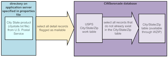

Upload Process
1. When you receive the City State product, use the Working with File Uploads (WUPL) menu option to copy the data file to the location on your application server specified in the CWDIRECTCP_USPS_ UPLOAD_FILE setting in the CWDirectCP Server Properties File. By default, this setting indicates a file name of ctystate.txt in the C:\CWSerenade\LZIP directory on your application server, but you can override this default.
2. Use the Load USPS File Screen to submit the LZPS job, which uses the contents of the ctystate.txt data file to create records in the Zip/City/State table if these records do not already exist. The job performs the following steps:
• Deletes any existing records in the USPS Zip/City/State work table and creates a record in this table for each eligible entry from the ctystate.txt data file. A record in the data file is eligible for upload if it is flagged with a D (detail) and is also flagged as mailable. See the Fields in the USPS Zip/City/State Table for mapping details.
• Compares the data in the USPS Zip/City/State work table with the existing records in the Zip/City/State table. If a record in the work table does not exist in the Zip/City/State table, the job creates it.
• If your current logging level supports it, the job uses the CWSerenade Application Log to track data such as the total number of records found in the data file and the total number of new records created in the.Zip/City/State table.
• The ctystate.txt data file as delivered by the U.S. Postal Service does not include delimiters between records, but the U.S. Postal Service does provide a utility to insert line breaks to make the data more readable. Important: Do not use this utility to transform the presentation of the records in the data file; if you do, the Load USPS File job will not work.
• The job does not create City/State/Zip Tax records. To create tax records at the postal code level if needed, use Setting Up the Zip/City/State (Postal Code) Table (WZIP).
• The entire process can take several minutes to a half hour to run. You can expect the job to take longer to run if you are creating records in the City/State/Zip table for the first time.
• The job tracks activity in the application log only if your current logging level (as specified in the MQ_LOG_LEVEL in Logging Properties) is set to INFO or higher.
For more information: See Troubleshooting the Zip/City/State Upload.
Purpose: The LZPS job reads each record in the file specified by the CWDIRECTCP_USPS_ UPLOAD_FILE setting in the CWDirectCP Server Properties File (the City State product file from the U.S. Postal Service) that is:
• flagged with a detail code of D
• identified as mailable by a setting of N at byte 56
The job clears the previous contents of the USPS Zip/City/State work table and then writes the selected records from the City State data file into the USPS Zip/City/State work table as follows:
City State data file from U.S. Postal Service
Copyright detail code
D
Zip code
Bytes 2-6
City state key
Bytes 7-12
City state name
Bytes 14-39 (last 3 bytes are truncated)
City st mail name ind
Byte 56
State abbrev
Bytes 100-101
The remaining fields in the USPS City/State/Zip work table are left blank.
