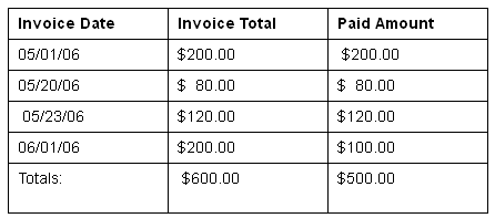

The system can partially pay an A/P invoice. For example, if the amount to disburse is $500.00:
The system will fully pay the oldest invoices and can partially pay the last eligible invoice to fully disburse the full $500.00. In the example, the invoice dated 06/01/06 for $200.00 is eligible to be paid; however, only $100.00 can be paid on this invoice at this time.
Numeric, 11 positions with a 2-place decimal; optional.

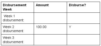

You can assign weekly disbursement amounts to a vendor on the Change Vendor Extended Screen to apportion your vendor payments over a 4 week period. This helps you monitor your cash flow.
For example, you can set up a vendor's weekly disbursement schedule as:
This schedule indicates that the vendor will be eligible for disbursements only in Week 2 and Week 4.
If you select any of the Disburse week fields on the Generate A/P Checks Screen, the system will generate A/P checks only if:
• the vendor is scheduled for a disbursement on the designated week
• the A/P invoice meets the other criteria for check generation
