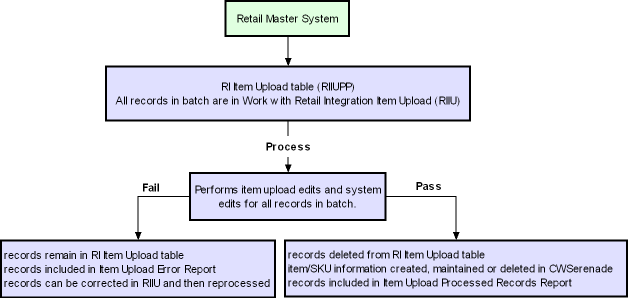

Item Upload Batch Processing
Batch processing overview: This flowchart summarizes the process of passing batch item upload records from your retail system to CWSerenade.
How do you upload retail merchandise information? Use Working with File Uploads (WUPL) to upload retail merchandise information into the RI Item Upload Table (RIIUPP).
How do you process records in the RI Item Upload table? Once you have passed item upload records from your retail master system to the RI Item Upload table, you can view all the records in the batch using the Working with Retail Integration Item Upload (RIIU) menu option. In order to process the records in the RI Item Upload table:
• Select Process at the Work with Retail Item Upload Screen.
• Select Accept at the Copy Item to Company Window in Working with Existing Items (MITM).
• Submit the RIUPLD function using the PFR0084 program. See Scheduling Jobs for background.
Records that pass all edits: The system deletes these records from the RI Item Upload table and the requested update (create or maintain) is made in CWSerenade.
Records that fail one or more of the edits: The system retains these records in the RI Item Upload table and also creates a record for each RI Item Upload record in error in the RI Item Upload Error table. You can review and correct the errors, or delete the record(s) using Working with Retail Integration Item Upload (RIIU). You can review item upload records in error on the:
• Item Upload Error Report: lists item upload records that are in error.
• Record Deleted from RI Item Upload Report: lists item upload records that you manually deleted at the Work with Retail Item Upload Screen.
Retail Item Upload email: If a valid email is defined in the Email address field for the user that submitted the RI Item Upload Program, the system sends a Retail Item Upload Email to the user’s email address when the job completes indicating whether all records were processed successfully or whether any records contain errors.
For more information: See Working with Retail Integration Item Upload (RIIU).
