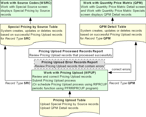

Pricing Upload Process
Use the following steps to upload Special Pricing by Source records and Quantity Price Matrix Detail records from an external system.
1.
Populate the Pricing Upload Table with Special Pricing by Source and Quantity Price Matrix Detail records from an external system.
Note: It is your responsibility to populate the Pricing Upload table using your preferred method.
2.
Review, and optionally change, the Pricing Upload records in the Work with Pricing Upload (WPUP) menu option.
3.
When you are ready to upload the records from the Pricing Upload table, use the Work with Pricing Upload Screen to submit the Pricing Upload process.
The Record Type field indicates whether the record is a Special Pricing by Source Upload record or Quantity Price Matrix Detail Upload record.
• Record Type SRC indicates the record is a Special Pricing by Source Upload record. See Uploading Special Pricing by Source Records for processing details.
• Record Type QPM indicates the record is a QPM Detail Upload record. See Uploading Quantity Price Matrix Detail Records for processing details.
Scheduling the Pricing Upload process: You can also schedule the Pricing Upload process to run periodically by setting up the RIPRCUP periodic function using the PFRRIPRCUP program. See Scheduling Jobs for background.
The system performs the following validation when you upload a Special Pricing by Source record (Record Type SRC) through the Pricing Upload Interface.
1.
Validates that the required fields for the Special Pricing by Source upload record in the Pricing Upload table contain information and the fields that require a valid value contain a valid value.
The minimum fields required for a Special Pricing by Source upload record in the Pricing Upload Table are:

2.
Determines whether the Special Pricing by Source upload record in the Pricing Upload table creates, updates, or deletes a Special Pricing by Source record in the CWSerenade database.
The system uses the Company #, Item, Source, and Quantity fields for the Pricing Upload record to determine if a match exists in the Special Pricing by Upload table.
• If a match exists and the Request Type is U, the system updates the existing record.
• If a match exists and the Request Type is D, the system deletes the existing record.
• If a match does not exist and the Request Type is U, the system creates a new record.
• If a match does not exist and the Request Type is D, the system places the upload record in an error status: Record does not exist for Dlt.
3.
Failed Special Pricing by Source Upload
If the Special Pricing by Source Upload record in the Pricing Upload table does not pass validation, the system:
• Prints the record on the Pricing Upload Error Records Report.
• Retains the record in the Pricing Upload Table in an error status until the record is fixed or deleted. You can work with Pricing Upload records that are in an error status using the Work with Pricing Upload (WPUP) menu option.
4.
Successful Special Pricing by Source Upload
If the Special Pricing by Source Upload record in the Pricing Upload table passes validation, the system:
• Creates, updates, or deletes the Special Pricing by Source record. See Special Pricing by Source Table Updates for more information on how the system creates or updates a Special Pricing by Source record.
• Deletes the record from the Pricing Upload Table.
• Prints the Special Pricing by Source Upload record on the Pricing Upload Processed Records Report.
The system performs the following validation when you upload a Quantity Price Matrix Detail record (Record Type QPM) through the Pricing Upload Interface.
1.
Validates that the required fields for the QPM Detail upload record in the Pricing Upload table contain information and the fields that require a valid value contain a valid value.
The minimum fields required for a QPM Detail upload record in the Pricing Upload Table are:

2.
Determines whether the QPM Detail upload record in the Pricing Upload table creates, updates, or deletes a QPM Detail record in the CWSerenade database.
The system uses the Company #, QPM Code, Quantity, Source, either the Item Category or Item and SKU, and either the Customer Sold To # or Customer Price Group, for the Pricing Upload record to determine if a match exists in the Special Pricing by Upload table. See
3.
Failed QPM Detail Upload
If the QPM Detail Upload record in the Pricing Upload table does not pass validation, the system:
• Updates the Status of the record in the Pricing Upload Table to E (Error).
• Prints the Pricing Upload record on the Pricing Upload Error Records Report.
4.
If the QPM Detail Upload record in the Pricing Upload table passes validation, the system:
• Updates the Status of the record in the Pricing Upload Table to P (Processed).
• Prints the Pricing Upload record on the Pricing Upload Processed Records Report.
• Creates, updates, or deletes the QPM Detail record. See QPM Detail Table Updates for more information on how the system creates or updates a QPM Detail record.
