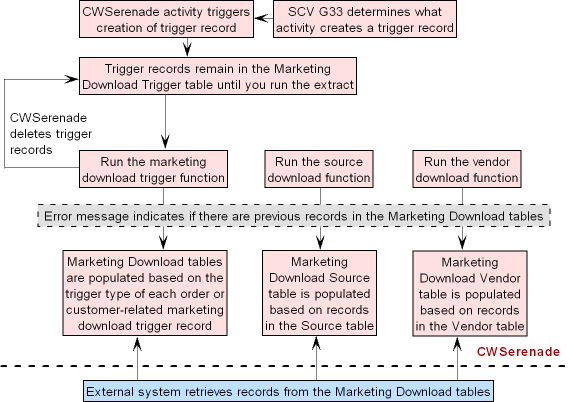

Purpose: The Marketing Download Extract allows you to download order, customer, source code, and vendor information from CWSerenade to an external system.
To download order and customer-related data: The system creates records in the Marketing Download Trigger table as a result of certain actions in CWSerenade. You can then:
• Run the MDEXTR Marketing Download Order and Customer Extract (CSX1041) periodic function to extract order and customer-related records in the Marketing Download Trigger table to the appropriate Marketing Download table.
• Run the MDEXPRT Marketing Download Export (PFR0130) periodic function to extract the data in the Marketing Download tables to a pipe delimited text file in the Marketing folder of the directory defined in the CWDIRECTCP_ FTP_FOLDER property.
See Creating Marketing Download Trigger Records.
To download source code and vendor data: The marketing download extract works differently for source code and vendor data than it does for order and customer-related data. You can run a periodic function to create records in the Marketing Download Source Download table and Marketing Download Vendor Download table, based on the records in the Source Code table and Vendor table. See Populating the Marketing Download Tables.

Marketing download process:

Marketing Download Extract Process
What activity creates a trigger? The setting of the Populate Marketing Download Trigger File (G33) system control value determines what type of activity in CWSerenade causes the system to populate the Marketing Download Trigger table. Valid values are:
• ORDER: order entry or maintenance
• CUSTOMER: customer maintenance or catalog requests
• ORD/CUST: order entry or maintenance, customer maintenance, or catalog requests
The Marketing Download source code and vendor extracts do not use the Marketing Download Trigger table; instead, there are periodic functions that extract these records directly to the related Marketing Download tables. See Populating the Marketing Download Tables for more information.

Setting up the Marketing Download Extract
System control values: The following system control values control trigger creation logic:
• Populate Marketing Download Trigger File (G33): controls the type(s) of triggers to create
• Include All Customer Inquiry Triggers for Marketing Download (I09): controls whether to create customer inquiry triggers if there are corresponding order header triggers
Periodic functions: The Marketing Download extract uses the following periodic functions:
• MDSRC (CSR1033) populates the Marketing Download Source Download table
• MDVND (CSR1038) populates the Marketing Download Vendor Download table for vendors whose User 1 field contains the text ACTIVE.
• MDEXTR (CSX1041) populates the Marketing Download order-related and customer-related tables (all the Marketing Download tables besides Marketing Download Source Download and Marketing Download Vendor Download) based on the records in the Marketing Download Trigger table.
• MDEXPRT Marketing Download Export (PFR0130) exports the data in the Marketing Download order-related and customer-related tables to pipe-delimited files and places the files in the Marketing folder of the directory defined in the CWDIRECTCP_ FTP_FOLDER property. Once the extract files are created, the system deletes the records in the associated Marketing Download tables.
How to set up: To set up the Marketing Download functions for periodic processing:
• Use Working with Periodic Functions (WPER) to set up each of the required Marketing Download periodic functions (for example, enter CSR1033 as the Program name for the function that populates the Marketing Download Source Download table)
• Use Working with Periodic Processes (WPPR) to assign each of the periodic functions to a periodic process
• Use Scheduling Jobs to indicate when and how often to run the periodic process
You can run the periodic functions listed above under Setting up the Marketing Download Extract to create records in the Marketing Download tables.
You can also run the periodic functions on demand through Working with Periodic Processes (WPPR).
If there is already data in the download tables: If you run the Marketing Download (CSX1041) periodic function while there are still records in the Marketing Download order or customer tables, the function writes an error to the APP.log: Data already exists in Marketing Download files. Please clear the files before running Download. See the CWSerenade Application Log for information on how to review this log.
You must first download or delete the records that are already in the Marketing Download order and customer tables before you can populate these tables with new information.
Order and customer-related tables: The Marketing Download periodic function creates records in these Marketing Download tables:
• Marketing Download Order Header Table and Extract File
• Marketing Download Order Detail Table and Extract File
• Marketing Download Customer Status Change Table and Extract File
• Marketing Download Customer Inquiry Table and Extract File
• Marketing Download Customer Address Change Table and Extract File
• Marketing Download Customer Ownership Table and Extract File
• Marketing Download Customer Profile Table and Extract File
During processing, the function changes the status of each selected trigger record to P (processed). Once the Marketing Download records are created, the function deletes the processed marketing download triggers.
You can then run the MDEXPRT Marketing Download Export (PFR0130) periodic function to export the data in the Marketing Download order-related and customer-related tables to pipe-delimited files in the Marketing folder of the directory defined in the CWDIRECTCP_ FTP_FOLDER property.
Source and vendor data: The MDSRC and MDVND periodic functions populate the Marketing Download Source Code Table and Marketing Download Vendor Download Table tables. See Setting up the Marketing Download Extract for more information on setting up these periodic functions.
