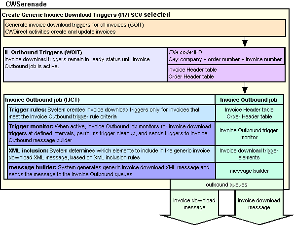

Invoice information flow: This flowchart explains how invoice information is downloaded from CWSerenade.

Invoice Download Process
The system creates invoice download triggers in the IL Outbound Trigger table when an invoice or credit invoice is created. The Invoice Outbound job in the Working with Integration Layer Processes (IJCT) menu option monitors the IL Outbound table for invoice download triggers to process and generates an Invoice Download XML Message (CWInvoiceOut) to send to the remote system.

Invoice Download Processing
To generate an Invoice Download XML Message (CWInvoiceOut), the system:
1. Creates invoice download triggers, based on CWSerenade activities that create an invoice. See Invoice Outbound Trigger Activities for a list of the activities that create invoice download triggers.
2. Evaluates the trigger rules for the Invoice Outbound job to determine if the invoice download trigger is created. Invoice Outbound Trigger Rules define the criteria the invoice must meet in order for the system to create an invoice download trigger.
3. When active, the job’s trigger monitor looks for unprocessed invoice download triggers to process at defined intervals, based on the Outbound delay time.
The Invoice Outbound trigger monitor:
• looks for invoice download triggers with the File code IHD and a status of ready (R).
• removes duplicate invoice download triggers. See Invoice Trigger Cleanup.
• determines which invoice to download, based on the Key for the invoice download trigger. The Key for invoice download triggers consists of company + order number + invoice number. For example, the Key 555000063970001713 indicates the invoice information is located in company 555 for order number 6397 and invoice number 1713.
• sends each invoice download trigger to the job’s message builder.
4. For each invoice download trigger, the message builder determines which elements to include in the invoice download message, based on XML inclusion rules; see Invoice Outbound XML Inclusion.
5. The Invoice Outbound message builder sends the generated invoice download messages to the queues defined for the Invoice Outbound job whose Enabled field is selected. See Outbound Interface Queues.
