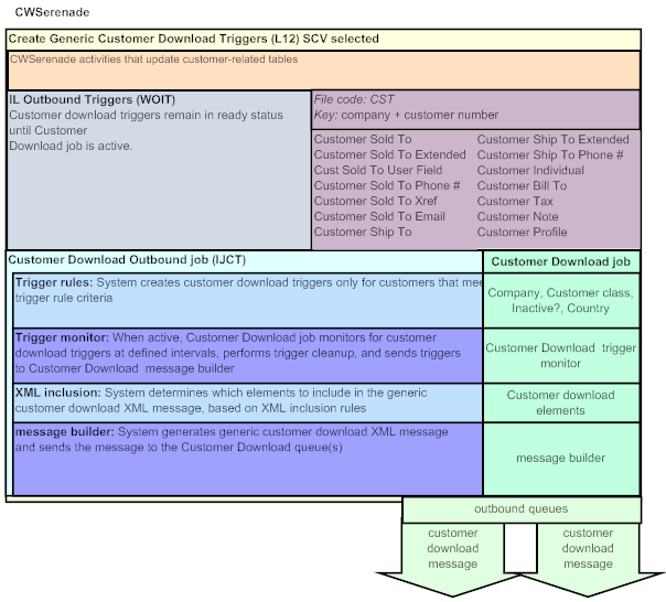

The system creates customer download triggers in the IL Outbound Trigger table when a customer is created, changed, or deleted. The Customer Outbound job in the Working with Integration Layer Processes (IJCT) menu option monitors the IL Outbound table for customer download triggers to process and generates a Customer Download XML Message (CWCustomerDownload) to send to the remote system.

The Create Generic Customer Download Triggers (L12) system control value controls whether the system creates customer download triggers in the IL Outbound Trigger table.
• If this system control value is selected, certain actions in CWSerenade triggers the system to create customer download triggers in the IL Outbound Trigger table with a File code of CST. The IL Outbound Trigger table acts as a “to do” list for the customer information that requires download. See Customer Outbound Trigger Activities for a list of activities that create triggers.
• If this system control value is unselected, the system does not create customer download triggers.
To generate a customer download message:
1. The system creates customer download triggers, based on CWSerenade activities that create, change, or delete customers who qualify based on the Customer Outbound Trigger Rules. See Customer Outbound Trigger Activities for a list of the activities that create the customer download triggers.
2. When the Customer Outbound job is active, it monitors the IL Outbound Trigger table for unprocessed customer download triggers. At the interval defined in the Outbound delay time, the job:
• checks for customer download triggers whose File code is CST and whose status is ready (R).
• removes duplicate customer download triggers. See Customer Trigger Cleanup.
• identifies the customer by the Key field for the customer download trigger. This field consists of company + customer code. For example, the Key 012000014776 indicates the vendor information is located in company 12 for customer 14776.
• generates the Customer Download XML Message (CWCustomerDownload).
• determines which elements to include in the customer download message, based on XML inclusion rules; see Customer Outbound XML Inclusion.
Note: The system creates a customer download message for customer outbound triggers with a delete (D) Capture type immediately, regardless of whether the Customer Outbound job is active or inactive; see Processing Customer Delete Triggers.
• sends the generated customer download message to each Customer Outbound queue whose Enabled field is selected. See Outbound Interface Queues.

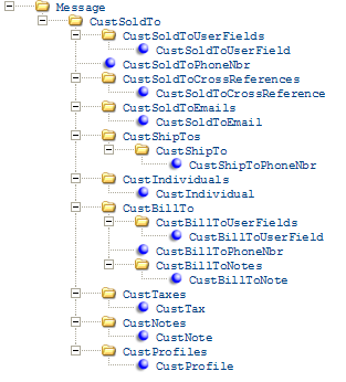

For each customer download trigger, the Customer Outbound message builder determines which elements to include in the Customer Download XML Message (CWCustomerDownload), based on XML inclusion rules.
You can define Customer Outbound XML inclusion rules at the Outbound Interface XML Inclusion Screen.
XML inclusion defines which elements to include in the Customer Download XML Message (CWCustomerDownload).
• If the element is included, that element and its parents are included in the generated customer download message.
• If the element is excluded, that element and its children are excluded from the generated customer download message.
This table indicates which elements in the customer download message are included, based on which elements you flag to include or exclude.

CWSerenade Setup for the Customer Download API
Before you can generate customer download messages, you must perform the necessary CWSerenade setup and processing.
Information requiring setup includes:
System Control Value |
Description |
Select this field to create customer triggers in the IL Outbound Trigger table when you create, change, or delete a customer. |
Enter the number of days to retain records in the IL Outbound Trigger table before purging them. Run the PURGIJT periodic function (program name ILR0026) to delete any records if: Last processed date is less than the current system date by the number of purge days and Status is X. You can also use the Purge option at the Work with Outbound Interface Transactions Screen to purge records. Example: Today is 5/10 and you have set this value to 1. Any record whose Last processed date is 5/10 or earlier is purged. |
Menu Option |
Description |
Use to review, delete, or resend IL outbound trigger records. |
When active, the Customer Outbound job creates a Customer Download XML Message (CWCustomerDownload) for each unprocessed customer trigger in the IL Outbound Trigger table. You can also define: • trigger rules; see Customer Outbound Trigger Rules • XML inclusion rules; see Customer Outbound XML Inclusion • the queues where the customer download message is sent; see Work with Integration Layer Process Queues Screen |
The customer download message contains customer information to send from CWSerenade to another system, such as a retail store or accounts receivable system. See Generic Customer Download API for an overview.
Message formatting specific to customer download:
• A separate message is generated for each customer you create, change, or delete.
• Delete transactions contain only the Customer element, the program that performed the deletion, and the company. See Sample Customer Download Message: Deletion for an example.
• If you exclude the element CustomerSoldTo element and all of its children (using the Customer Outbound XML Inclusion rules), the system sends a customer download message including only the Message element and its attributes.
See Generic Download Message Formatting for more information on how the system formats all download messages.
Samples: See Customer Download Message: Sample XML Messages for sample messages.

CustShipTo A CustShipTo element is included for each existing permanent ship-to address for the customer. See Creating and Updating Ship-to Customers (WCST) for an overview. |

CustShipToPhoneNbr A CustShipToPhoneNbr element is included if the customer ship-to has a daytime, evening, or fax phone number. |

CustIndividual The message includes a CustIndividual element for each individual customer record associated with the sold-to customer. |

CustBillTo The message includes a CustBillTo element if a bill-to customer number is assigned to the sold-to customer. See the Bill-to field at the Second Create Customer Sold To Screen for background. |

CustBillToUserField A CustBillToUserField element with a type of CBT is included for each user-defined field that exists for the bill-to customer associated with the sold-to customer. See Work with User Fields Screen for an overview. |

CustBillToPhoneNbr A CustBillToPhoneNbr element is included if there are any phone numbers identified for the bill-to customer associated with the sold-to customer. See Work with Bill To Phone Numbers Screen for information on entering phone numbers for a bill-to customer. |

CustBillToNote The message includes a CustBillToNote element for each note entered for the bill-to customer associated with the sold-to customer. See Work with Bill To Notes Screen for background. |

CustTax A CustTax element is included for each existing exemption or certificate for the customer in a particular state or province. See Working with Customer Tax Status for background. |
cst_tax_country |
alpha |
3 |
The country where the customer has a reseller or other tax exemption. Country codes are defined in and validated against the Country table; see Setting Up the Country Table (WCTY). |
cst_tax_state |
alpha |
2 |
The state or province where the customer has a reseller or other tax exemption. State codes are defined in and validated against the State table, which is accessible through the Work with Countries menu option; see Setting Up the Country Table (WCTY). |
cst_tax_code |
alpha |
1 |
The tax status of the customer in the state. Valid values are: • Exempt = The customer is exempt from paying any taxes, including VAT, in this state or province. • GST Only = Not currently implemented at the state or province level. To flag a customer as eligible for Goods and Services tax only, use the Tax exempt setting at the customer level. • Non-Tax = Not currently implemented. • PST Only = Not currently implemented at the state or province level. To flag a customer as eligible for Provincial Sales Tax only, use the Tax exempt setting at the customer level. • Resale = The customer is a reseller and exempt from paying any taxes, including VAT, in this state or province. • Standard = The customer is subject to tax. Although you can create tax records using any of the codes above, retrieving tax status for any tax code but Resale or Exempt is not currently implemented. |
cst_tax_resale_exempt_nbr |
alpha |
15 |
A number that the state issues to identify a customer who is not subject to taxes on purchases. This number applies only if there is no Exempt certificate set up at the customer level. |
cst_tax_expiration_date |
numeric |
8 |
The date the customer's exempt or reseller certificate expires in this state. This expiration date applies only if there is not an Exempt expiry (Tax exempt certificate expiration date) specified at the customer level. |
CustNote A CustNote element is included for each existing informational message about the customer. Operators can enter customer notes, or they can be written by the system for actions such as address updates. See Edit Customer Notes Screen for background. |
cst_note_seq_nbr |
numeric |
3 |
A unique number assigned by the system to identify the customer note. |
cst_note_type |
alpha |
1 |
Indicates the type, if any, used identify a type of note. You can use note types to make the note display automatically in a pop-up window in order entry or order maintenance, or default into the Notes field. See Working with Customer Note Types (WNTY) for background. |
cst_note |
alpha |
60 |
The text of the note. |
cst_note_entry_date |
numeric |
8 |
The date the note was created. YYYY-MM-DD format. |
cst_note_user |
alpha |
10 |
The user or system process that created the note. |
CustProfile A CustProfile element is included for each existing profile data entry for the customer. See Work with Customer Profile Screen for an overview on capturing demographic data for customers, and see Setting Up Customer Profiles (WPFL) for setup information. |
cst_profile_code |
numeric |
3 |
Identifies the type of demographic information captured, such as gender. |
cst_profile_code_desc |
alpha |
30 |
The description of the profile code. |
cst_profile_data_code |
alpha |
1 |
Identifies the demographic response from the customer, such as female. |
cst_profile_data_code_desc |
alpha |
30 |
The description of the response. |
