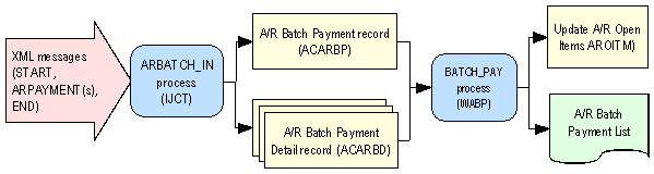

Uploading A/R Batch Payments
Purpose: Use the ARBATCH_IN process in Working with Integration Layer Processes (IJCT) to process A/R payments from XML messages you receive from a remote system. You can use CWIntegrate to provide a seamless integration with an external system that passes A/R payment information, but the ARBATCH_IN process creates A/R payment records if the XML messages are correct, regardless of source.
For more information on using CWIntegrate to translate and forward A/R payments, see the A/R Batch Payments Integration manual.
CWMessageIn Web Service
You can use the CWMessageIn Web Service to route ARPayment messages. In this situation, the target for each inbound message must match the Inbound program name for the integration layer process queue, as specified at the Integration Layer Process Queue Screen.
Web service authentication? The Require_Auth field in the Webservice table defines whether the web service requires basic web service authentication. See Working with Web Service Authentication (WWSA) for an overview.
If you are using the CWMessageIn RESTful web service: You POST inbound CWMessageIn messages to the web service’s URI, or endpoint, of the RESTful service. The individual URL for the CWMessageIn RESTful service uses the following format: http://server:port/SerenadeSeam/sxrs/application/CWMessageIn, where server:port identifies the application server where the RESTful service is located and CWMessageIn is the name of the web service to call.
If you are using the CWMessageIn SOAP-based web service: The endpoint specified in the CWMessageIn.wsdl file is where you need to post messages in order for the CWMessageIn web service to process them. The endpoint is typically set to http://server:port/CWDirectCPService/services/CWMessageIn, where server:port identifies the application server where the wsdl is located and CWMessageIn is the name of the web service to call. The CWMessageIn SOAP-based web service requires that inbound messages be embedded in SOAP envelope tags.
Creating Batches of Payments
The process of creating the A/R payment records based on the information in the Inbound A/R Payment XML Message (ARPayment)is as follows:
1. The ARBATCH_IN process receives a START message (see Sample START Message), indicating the bank and division, and creates a new A/R Batch Payment record, assigning a new batch number. At this time, the batch is in P (in process) status, and you cannot work with detail or delete the batch from the Work with A/R Batch Payments Screen.
2. The ARBATCH_IN process receives an ARPAYMENT record (see Sample ARPAYMENT Message), indicating which invoice to pay and the amount of the payment, and creates a new A/R Batch Payment Detail record.
3. The ARBATCH_IN process continues creating new detail records as long as it receives new ARPAYMENT records.
4. The ARBATCH_IN process receives an END message (see Sample END Message). If the Process A/R Batch Automatically after Creation through IJCT (I95) system control value is:
• selected: the BATCH_PAY job processes the batch automatically. It flags any payments in error, and applies correct payments to the related records in the A/R open item table. Also, the job produces the A/R Batch Payment List, listing all errors and processed payments. See Processing A/R Batches for more information.
• unselected: the batch status changes to open. You can use the Work with A/R Batch Payments Screen to review or work with the batch, or select Proc all batches to submit it for processing.
Processing: To process any open A/R payment batches:
1. At the Work with A/R Batch Payments Screen, select Process all batches to process all of the A/R batch payments that are displayed on this screen.
2. A pop-up window displays to confirm the process. Select OK to process the A/R batches, or back to cancel.
The system produces the A/R Batch Payment List, which lists all of the invoices that have been processed along with any errors that have occurred. All batches displayed on this screen change to an S (submitted) status while the BATCH_PAY job is running.
Note: If you receive a batch through the ARBATCH_IN process as described under Uploading A/R Batch Payments and the Process A/R Batch Automatically after Creation through IJCT (I95) system control value is selected, the batch immediately goes into Submitted status after the ARBATCH_IN process has finished creating it. If the batch has no errors, or if the Retain A/R Batch Errors After Processing (I33) system control value is unselected, the BATCH_PAY job deletes the batch after processing it.
Updating open items: Payments that are successfully processed update the related open item.
• If the invoice open item is paid in full after applying the A/R payment, the status changes to processed (P) and the balance is zero. The bill-to customer’s Total A/R balance is also reduced.
• If the invoice open item is not paid in full after applying the A/R payment, the system reduces the balance by the payment amount and reduces the bill-to customer’s Total A/R balance. It is possible to apply a partial payment against an invoice open item through A/R batch entry only if the Allow Underpayment in A/R Batch Processing (I44) system control value is selected.
Delete payments in error? If the Retain A/R Batch Errors After Processing (I33) system control value is selected, any payments that are in error remain, and the status of the batch returns to open. In this case, you can correct the payments in error and resubmit the batch, as long as the errors are not related to the invoice number or bill-to number provided.
If the Retain A/R Batch Errors After Processing (I33) system control value is unselected, any payments that are in error are deleted, and the batch itself is deleted.
Note: If the Retain A/R Batch Errors After Processing (I33) system control value is selected and then you change the setting, you will need to manually delete each batch that was retained before you reset the value; the system will not delete these batches automatically.
