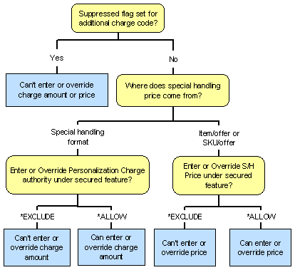

Overriding the Special Handling Charge or Price
You can enter a special handling price at the special handling screen or the Work with Order Line Screen if you have the required authority. Two secured features control access:
• Enter or Override Personalization Charge (A40): Controls access to the Charge field when you are working with custom special handling formats in order entry (when the charge is established at the special handling format)
• Enter or Override S/H Price (B12): Controls access to the S/H price field when you are working with custom special handling formats in order entry (when the special handling price is defined for the item/offer or SKU/offer)

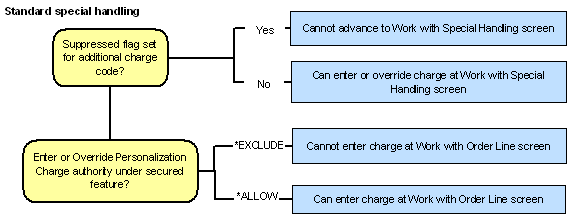

Standard special handling: The following chart summarizes how the system controls access for standard special handling formats:
Custom special handling: The following chart summarizes how the system controls access for custom special handling formats:
Summary: The following table summarizes the situations in which you can enter or override the special handling charge or price:
Screen
You can enter or override special handling charge/price if:
Special handling type = standard
Authority under the Enter or Override S/H Price secured feature is *ALLOW
Work with Special Handling Screen
Display of the special handling screen is not suppressed
Work with Custom Special Handling Screen
Special handling type = custom
And:
• If the special handling price is derived from the special handling format: authority under the Enter or Override Personalization Charge = *ALLOW; or,
• If the special handling price is derived from the item/offer or SKU/offer: authority under the Enter or Override S/H Price secured feature = *ALLOW

Suppress S/H window
Indicates whether to suppress the display of the Work with Special Handling Screen or the Work with Custom Special Handling Screen when you add an item with special handling in order entry. You might want to suppress display in order to automatically add a charge to the Handling bucket on an order without requiring the order entry operator to complete or accept the information on the special handling screen. Valid values are:
• blank = Leave this field blank if the S/H type field is blank, indicating the additional charge code is not for special handling.
• Suppress = Suppress the display of the related special handling screen in order entry when you add an item with this additional charge code; however, any related handling charge is still added to the order.
• Do not suppress = The related special handling screen is available for entry.
Not a valid entry for an additional charge code that does not have a Special handling format.
Additional considerations when suppressing the special handling screens:
Displaying special handling screens on demand: If the automatic advancement to the special handling screen is suppressed, you cannot display the screen on-demand. For example, a special handling screen is not available by selecting Special Handling for an item in order entry or order maintenance. However, you can still advance to the Display Special Handling or the Display Custom Special Handling screens in standard order inquiry, or display special handling information in streamlined order inquiry, regardless of the setting of this field. If you would like to prevent the special handling screen automatically but retain the ability to display it on demand, use the Bypass S/H flag instead of the Suppress S/H window flag.
Entering returns through order entry: If a special handling format is set to suppress display and applies to the order detail line, then the handling charge will be automatically added to the order as a credit when you create a return by entering a negative quantity in order entry. However, if the special handling format is not set to suppress display, you advance to the special handling screen and have the option of accepting or rejecting the charge.
Note: This flag causes the special handling charge to be added to the order automatically when you use interactive order entry. For example, the charge is not added automatically through the generic order message (order API).
Optional.
