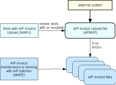

About the A/P Invoice Upload: Process Overview
Overview: The steps involved in the A/P invoice upload are described below. The CDC job manages the upload processing.
• Populate the A/P Invoice Upload Table (APINUP)
• CDC Async Job Processes the Uploaded Invoice
• The CDC Async Job Creates the A/P Invoice
• If Errors Occurred, Resubmit using Work with A/P Invoice Upload Errors (WAPU)
