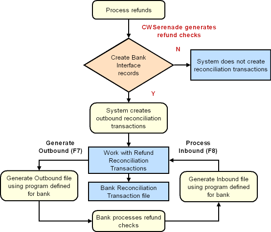

Process Overview

Generating the Bank Reconciliation Transaction Outbound Table
Purpose: Use this pop-up window to specify the bank for which you wish to send bank reconciliation transactions.
When you generate outbound transactions, the system sends O (outbound) bank reconciliation transactions that the system created when you generated checks in Processing Refunds (MREF) that are in an open status and do not have a sent date.
Note: If you void a check in Reconcile Checks that is associated with an outbound transaction that is available to send to the bank, the system does not remove the outbound transaction and you can still send the transaction to the bank.
How to display this window: Select Gen. Outbound on the Work with Bank Reconciliation Transaction Screen.

Processing the Bank Reconciliation Transaction Inbound Table
Purpose: Use this window to specify the bank for which you wish to receive bank reconciliation transactions.
When you process the Inbound table, the system tries to match each inbound transaction with refund check information in the Bank Reconciliation Transaction Table (ACBRTF). If a match is found, the inbound transaction is processed; if a match is not found, the inbound transaction is placed in an error status.
How to display this window: Select Process Inbound on the Work with Bank Reconciliation Transaction Screen.
Field
Description

When you select Process Unrecon to generate the Inbound table, the system:
• creates the Positive Pay Refund Check Inbound Table (CSPPIP), which includes a record for each inbound bank reconciliation transaction.
• generates the Bank Reconciliation Transaction List. This report displays each inbound transaction that has errors.

Processing Unreconciled Bank Reconciliation Transactions
To process unreconciled checks: Select Process Unrecon at the Work with Bank Reconciliation Transaction Screen to process bank reconciliation transactions that have not yet been reconciled.
To reconcile an inbound transaction, the system looks for corresponding refund check information in the Bank Reconciliation Transaction table, using:
• Check number
• Dollar amount
• Blank reconciliation date
If the system finds an exact match:
• the inbound transaction is reconciled
• the system writes a record to the Bank Reconciliation Transaction Table (ACBRTF)
• the system writes an order transaction history message indicating the transaction has been reconciled.
If the system cannot find an exact match:
• the inbound transaction is not reconciled and is placed in an error status.
• the inbound transaction that is in error must be purged
• the system generates the Bank Reconciliation Transaction List indicating the transactions in error.
The system only processes inbound bank reconciliation transactions that are in an O (open) status and that do not have a date defined in the Date reconciled field in the Bank Reconciliation Transaction Table (ACBRTF).
Edits performed: To reconcile a bank reconciliation transaction, the system looks at the Bank Reconciliation Transaction Table (ACBRTF) to determine if a matching bank reconciliation transaction exists:
• the system validates that a matching check number exists. If a matching check number does not exist, the system assigns the bank reconciliation transaction an error status with the error description: No matching record.
• the system validates that a matching check amount exists. If a matching check amount does not exist, the system assigns the bank reconciliation transaction an error status with the error description: Check amount does not match.
• the system validates that the check has not been voided. If the check has already been voided, the system assigns the bank reconciliation transaction an error status with the error description:
Check Voided.
• the system validates that a reconcilement date does not exist. If a date exists in the Date reconciled field in the Refund Reconciliation table, and/or the Bank Reconciliation Transaction table, the system assigns the bank reconciliation transaction an error status with the error description: Already reconciled.
If the bank reconciliation transaction passes all of the edits above, the system reconciles the transaction and assigns the transaction a P (processed) status. For each transaction that has been reconciled, the system writes an order transaction history message.
Note: The system does not write an order transaction history message when you reconcile a check through Reconcile Checks.
If a bank reconciliation transaction fails the edits above, the system lists the transaction on the Bank Reconciliation Transaction List.
