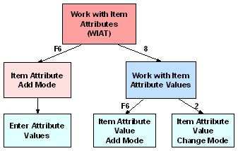

Work with Item Attributes Screen
Purpose: Use this screen to create Attribute codes you can assign to items or SKUs to group them by customer preferences. You can define specific Values of each attribute, and specify threshold quantities that will flag the attribute value as a customer preference. See Item Attributes and Values.
How to display this screen: Enter WIAT in the Fast path field at the top of any menu or select Work with Item Attributes from a menu.

Item Attribute Screen: Add Mode (Creating an Item Attribute and its Values)
Purpose: Use this screen in Add mode to create an item attribute.
How to display this screen: Select Create at the Work with Item Attributes Screen.

Enter Attribute Values Screen
Purpose: Use this screen to create one or more values for an attribute.
To set Affinity thresholds for a value, you must return to the Work with Item Attributes screen after creating the value, and advance to the Item Attribute Value Screen: Add Mode (Setting Affinity Thresholds). See How do you create an attribute and its values?.
How to display this screen: You advance to this screen automatically after completing the fields in the Item Attribute Screen: Add Mode (Creating an Item Attribute and its Values).

Work with Item Attribute Values Screen
Purpose: Use this screen to change, delete, or display values associated with an item attribute, or to create new values for an attribute. From this screen you can also set Affinity thresholds for the attribute value.
How to display this screen: Select Values for an attribute at the Work with Item Attributes Screen.
Purpose: Use this screen to create a new attribute value for an existing attribute and to set Affinity thresholds for the value.
Note: You can create multiple values at the Enter Attribute Values Screen, which you advance to automatically when you create an item attribute; however, to set Affinity thresholds for each value you have created, you must return to the Work with Item Attributes Screen, and advance to the Work with Item Attribute Values Screen (Select Values for an attribute), where you can select Change to set thresholds for the value, or Create to create a value and set its thresholds on the same screen. See Work with Item Attributes and Values (WIAT) for a chart showing the screens you use to create an attribute and its values.
How to display this screen: Select Create at the Work with Item Attribute Values Screen, or select Change for a previously created attribute value to advance to this screen in Change mode.
