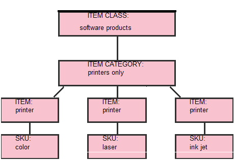

Item category codes classify and group similar items on a level below Item Class. For example, you can assign a group of items within the same item class an Item category of “printers only” to differentiate printers from the other items under that item class.
