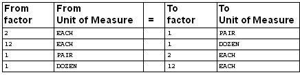

From factor
The number by which you multiply the From unit of measure to calculate the total quantity of the To unit of measure.
(From factor) X (From unit of measure) = (To factor) X (To unit of measure).
In other words:
2 EACHES = 1 PAIR
12 EACHES = 1 DOZEN
1 PAIR = 2 EACHES
1 DOZEN = 12 EACHES
