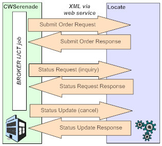

3.
If the BROKER process in Working with Integration Layer Processes (IJCT) is active, it immediately generates the submit order request message to Locate to request order creation and assignment in the Order Broker. At this time, it also:
• changes each Order Broker record’s status to W (waiting)
• creates an Order Broker History record for each line to track the order submission (A - Send Order Request)
• writes an Order Transaction History message indicating that each order line was submitted to the Order Broker (for example, Ln#: 2 Submitted To Broker)
See the Brokered Backorder Submit Order Request Message Sample.
4.
The Order Broker module in Locate receives the submit order message. If CWSerenade sent each line separately, Locate creates each order line as a separate order in its database; otherwise, if you use the split order option, Locate creates a single order including all of the order lines that were eligible for submission as brokered backorders. The Order Broker assigns each order or line to a location for fulfillment based on inventory availability and the business rules you have defined in Locate. At this point, the order status in the Locate database is new_order.
5.
When the message version is 3.0 or 3.1: If the order is:
• assigned to a single fulfilling location, Locate sends a response message to CWSerenade indicating the assigned fulfilling location and the unique request ID it uses to identify each order. See the Submit Order Response Message Sample: Single Location (Message Version 3.1 or 3.0).
• split across multiple fulfilling locations, Locate sends a response message indicating that the order was assigned to multiple locations, and providing the unique request ID it uses to identify each order. See the Submit Order Response Message Sample: Multiple Locations (Message Version 3.1 or 3.0).
If the order is split, CWSerenade immediately sends a status inquiry message so that it can determine the assigned fulfilling locations for each item on the order. See the Status Response Message Sample.
When the message version is 5.0 or higher: Locate sends a response message to CWSerenade indicating each assigned fulfilling location and the unique request ID it uses to identify each order. See the Submit Order Response Message Sample: Message Version 5.0 or higher.
The message version is specified in the Locate Properties.

Brokered Backorder Fulfillment Process: After Order Creation and Status Updates
Status inquiry and response process: The BROKER process in Working with Integration Layer Processes (IJCT) sends periodic status inquiry requests to the Order Broker. You use the Order Broker Status Update Interval (K10) system control value to define how many minutes CWSerenade should wait before sending status inquiry requests.
