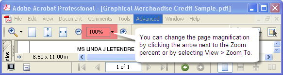

Before you print a merchandise credit, you must select certain settings in order to print the merchandise credit correctly:
• Set the page magnification to 100%. You can change the page magnification by clicking the arrow next to the Zoom percent or by selecting View > Zoom To.
• When you select to print, make sure that the Page scaling option in the Print window is set to None.
