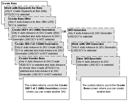

Creating SKUed items screen flow: Select the SKUs field on the Create Item Screen to create a SKUed item. The system automatically advances you through the following screens to create a SKUed item.
1.
Create Item Screen
2.
First Work with Keywords for Item Screen (only if the Create Keywords at Item Entry (F78) system control value is selected)
3.
Create Item Offer Screen (only if the Auto Advance to Item Offer (J05) system control value is selected)
4.
Depending on whether you are using the SKU Generator:
• Create SKU 1 of 2 (With Overrides) Screen (only if the Auto Advance to SKU Create (B34) system control value is selected and the Auto Advance to SKU Generator (J06) system control value is unselected)
• SKU Generator Screen (Entering SKU Information) (only if the Auto Advance to SKU Generator (J06) system control value is selected)
5.
• Create SKU 2 of 2 (With Overrides) Screen (only if the Auto Advance to SKU Create (B34) system control value is selected and the Auto Advance to SKU Generator (J06) system control value is unselected)
• Work with SKU Generator Screen (only if the Auto Advance to SKU Generator (J06) system control value is selected)
6.
• Create Vendor Item Screen (only if the Auto Advance to SKU Create (B34) system control value is selected, the Auto Advance to Vendor Item Create (E78) system control value is set to Yselected and the Auto Advance to SKU Generator (J06) system control value is unselected)
• Enter SKU Base Information Pop-Up Window (only if the Auto Advance to SKU Generator (J06) system control value is selected)
Once you have completed creating the item and SKU, the system returns you to the:
• Create SKU 1 of 2 (With Overrides) Screen if you are not using the SKU Generator, where you can create another SKU.
• Create Item Screen if you are using the SKU Generator, where you can create another item.
Defines whether the system automatically advances to the Create SKU 1 of 2 (With Overrides) Screen when you are Performing Initial Item Entry (MITM) for an item that has SKUs.
Yes/No field: Select this field if you want the system to automatically advance to the Create SKU 1 of 2 (With Overrides) Screen when you create an item that has SKUs using the Work with Items (MITM) menu option.
See Creating Items Screen Flow for more information on which screens automatically display when you create an item/SKU.
Note: If the Auto Advance to SKU Generator (J06) system control value is also selected, the system advances you to the SKU Generator Screen (Entering SKU Information) instead of the Create SKU 1 of 2 (With Overrides) Screen.
If you leave this field unselected, the Create SKU with Overrides screen won't display, but you can access it from the Work with SKUs Screen. You can also create SKUs automatically Using the SKU Generator (ESKG).
Defines whether the system automatically advances to the SKU Generator Screen (Entering SKU Information) when you are Performing Initial Item Entry (MITM) for an item that has SKUs.
Yes/No field: Select this field if you want the system to automatically advance to the SKU Generator Screen (Entering SKU Information) when you create an item that has SKUs using the Work with Items (MITM) menu option. The SKU Generator screen allows you to create multiple SKUs for an item at one time.
Leave this field unselected if you do not want the system to automatically advance to the SKU Generator Screen (Entering SKU Information) when you create an item that has SKUs.
You can select the Auto Advance to SKU Create (B34) system control value if you want the system to automatically advance to the Create SKU 1 of 2 (With Overrides) Screen when you create an item that has SKUs. The Create SKU 1 of 2 (With Overrides) screen allows you to create a single SKU for an item.
However, if the Auto Advance to SKU Generator (J06) system control value and Auto Advance to SKU Create (B34) system control value are both unselected, the system does not automatically advance you to any SKU screen when you initially create an item.
• You can advance to the Create SKU 1 of 2 (With Overrides) Screen from the Work with SKUs Screen.
• You can advance to the SKU Generator Screen (Entering SKU Information) from the Generate SKUs (ESKG) menu option; see Using the SKU Generator (ESKG).
