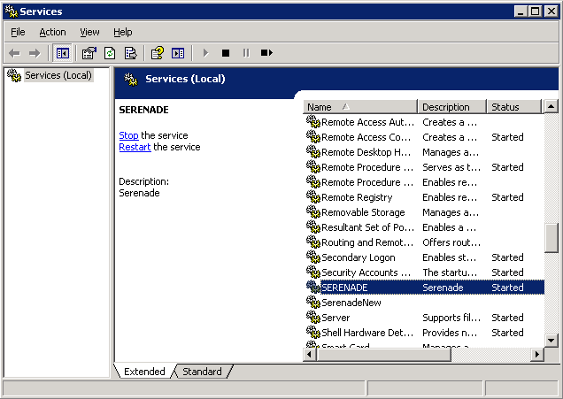

Restarting the SERENADE Service
1.
Advance to the Services window by selecting Control Panel > Administrative Tools > Services.
2.
Highlight the Serenade service and select Stop to stop the service.
3.
After the service stops, select Restart to restart the service.
