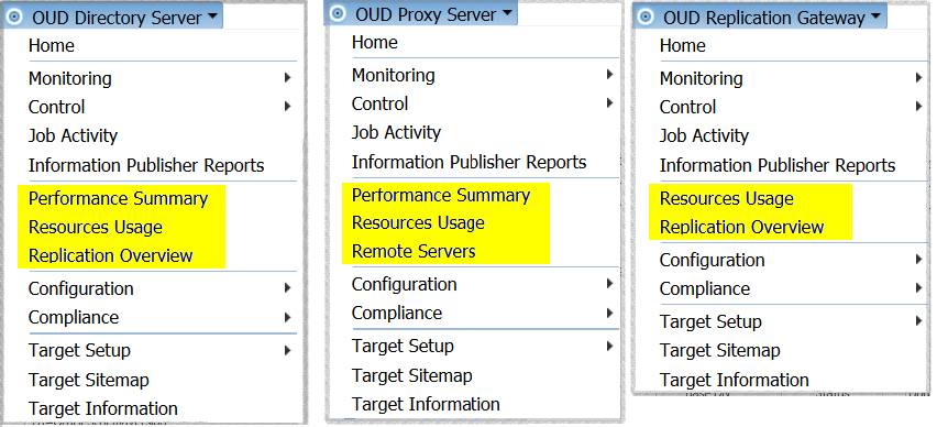

Figure 1-1 Comparison of Target Instance Submenus
Description of Figure 1-1 follows
Description of ''Figure 1-1 Comparison of Target Instance Submenus''
Table 1-1 compares submenus for an OUD Directory Server instance, OUD Proxy Server instance, and OUD Replication Gateway instance. All submenus include many identical commands including: Home, Monitoring, Control >, Job Activity, Information Publisher Reports, Configuration >, Compliance >, Target Setup >, Target Sitemap, and Target Information. For each target instance, however, the Home page presents different high-level information based on the target instance type.
In Table 1-1, the following differences are highlighted:
  • For a Directory Server instance, the submenu provides access to the following information: Performance Summary, Resources Usage, and Replication Overview.
  • For a Proxy Server instance, the submenu provides access to the following information: Performance Summary, Resources Usage, and Remote Servers.
  • For a Replication Gateway instance, the submenu provides access to the following information: Resources Usage and Replication Overview.

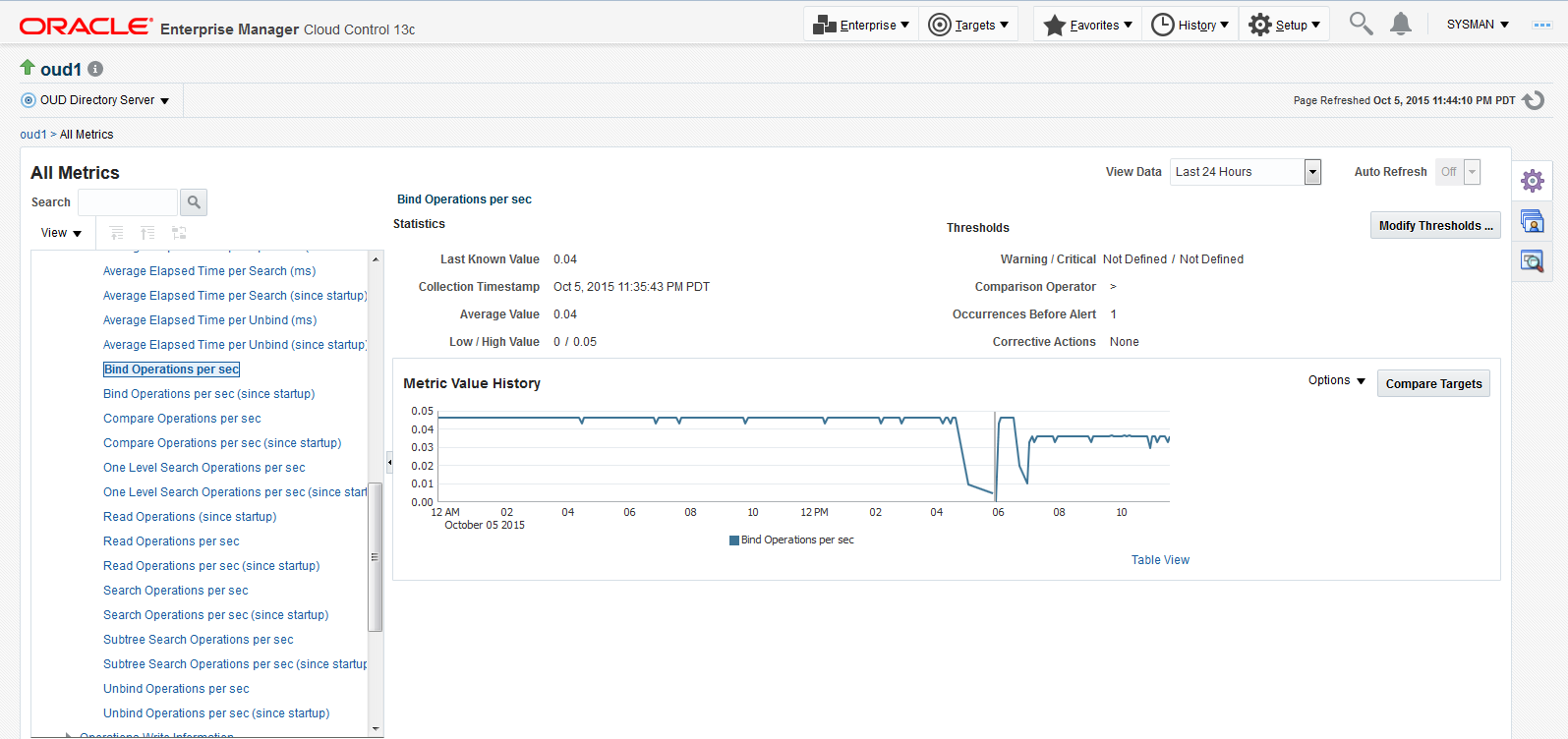

Metrics are organized in logical groups. The following figure illustrates the metrics available when the Operations Read Information group is expanded, and Bind Operations Per Second is selected.
Figure 1-2 Operations Read Information
Description of Figure 1-2 follows
Description of ''Figure 1-2 Operations Read Information''

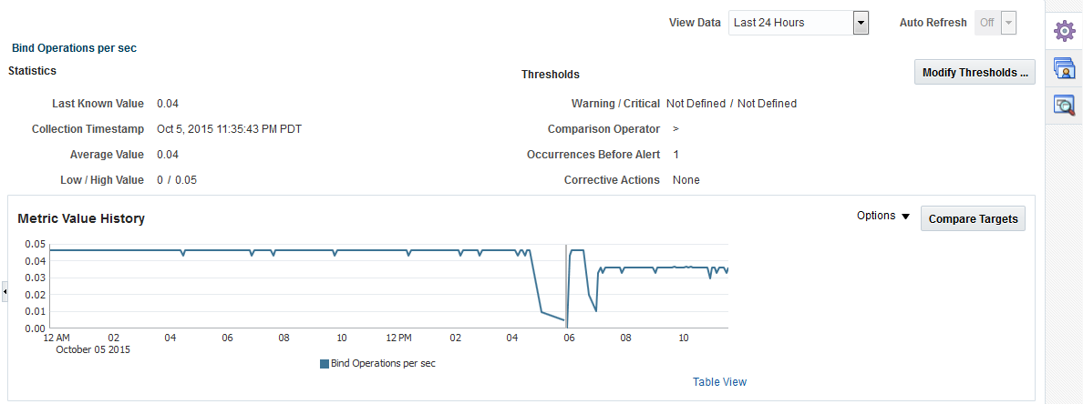

To display details of the metric, click on the metric name. In Figure 1-3, to display information about Bind Operations Per Second within the last 24 hours, you need to choose the Bind Operations per sec metric from the All Metrics page. A new page dedicated to this metric is displayed.
Figure 1-3 lists the following Statistics:
  • Last Known Value: 0.04
  • Average Value: 0.04
  • Low Value: 0
  • High Value: 0.05
  • Warning Threshold: Not Defined
  • Critical Threshold: Not Defined
  • Occurrences Before Alert: 1
  • Corrective Actions: None
A graph is labeled with metric values ranging from 0.00 to 0.50, and hourly intervals spanning 24 hours. The graph data illustrates activity peaks between the hours of 08AM and 08AM the following day.
Figure 1-3 One Level Search Operations Per Second page
Surrounding text describes Figure 1-3 .

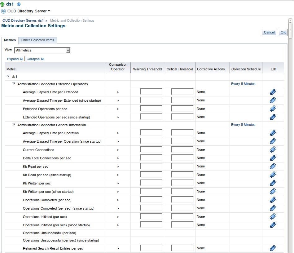

1.3.3 Setting Metric Thresholds
Metric thresholds enable you to specify when alerts should be generated for a specific monitored metric. For example, if you want to receive an alert when the number of read operations per second exceeds a certain maximum, you can configure a threshold for this metric.
To configure a metric threshold:
  1. From the Home page of the Target Instance menu, go to Monitoring > Metric and Collection Settings.
    By default, the list of metrics for which thresholds have been defined is displayed. See Figure 1-4.
  2. From the View list, select All metrics.
  3. Scroll down to locate the metric for which you want to set a threshold.
  4. Enter a value in the Warning Threshold column to specify the point at which you should receive a warning alert.
  5. Enter a value in the Critical Threshold column to specify the point at which you should receive a critical alert.

Figure 1-4 shows the All Metrics view for a directory server target instance. The view contains two tabs: Metrics and Other Collected Items. The Metrics tab contains a table which lists metrics collected for this directory server instance. For each metric, the following values may be reported: Comparison Operator, Warning Threshold, Critical Threshold, Corrective Actions, and Collections Schedule.
To reconfigure the settings for a metric, click the Edit icon the end of its row.
Figure 1-4 The Metric and Collections Settings Page for a Directory Server Target Instance
Description of Figure 1-4 follows
Description of ''Figure 1-4 The Metric and Collections Settings Page for a Directory Server Target Instance ''

1.3.6 Summary of Replication Gateway Monitoring Information
1.3.6.1 Replication Gateway Instance Home Page Metrics
The replication gateway instance Home page provides the following basic information:
  • General information about the replication gateway instance and its the current status including: up time, administration port, full version of the server, install and instance paths, server role, and whether replication is enabled or disabled
  • Availability of the server
  • List of configured suffixes with replication status, the Updates Sent to ODSEE Per Second, Updates Received from ODSEE Per Second, Updates Sent to OUD Per Second, and Updates Received from OUD Per Second
  • Performance overview with line charts representing the number of updates sent to ODSEE Per Second, the number of Updates Received from ODSEE Per Second, the number of Updates Sent to OUD Per Second, and the number of Updates Received from OUD Per Second
In addition, the Home page displays any alerts that might have been generated by the monitored replication gateway instance.
1.3.6.2 Replication Gateway Instance Resources Usage Page Metrics
The OUD Replication Gateway Resource Usage Page displays the following:
JVM Information
  • VM information: the Java version, Java home, Java Architecture, Max Allowed Memory (MB), Total Memory (MB), Used Memory (MB) and the Free Memory (MB)
  • A line chart representing the Free Memory in Heap, and the Used Memory in the heap
  • A line chart representing the JVM Non Heap Usage (MB)
1.3.6.3 Replication Gateway Instance Replication Overview Page Metrics
The OUD Replication Gateway Replication Overview Page displays the following:
Local Replication Server
  • Administration port
  • Replication Enabled Replication Port, Missing Changes, Oldest Missing Changes, Replication Delay, Received Updates Per Second, Sent Updates Per Second, Untrusted Changes Per Second
  • A line chart representing the number missing changes in the local replication server
  • A line chart representing the age of the Oldest Missing Changes
Local Replication Domains
  • A bar chart representing, for each domain, the average number of Replication Updates Received Per Second for this replication domain
  • A bar chart representing, for each domain, the average number of Replication Updates Sent Per Second for this replication domain
Global Replication Report
The Global Replication Report provides a summary of all servers in a replicated topology, as well as the overall replication status across the topology.
