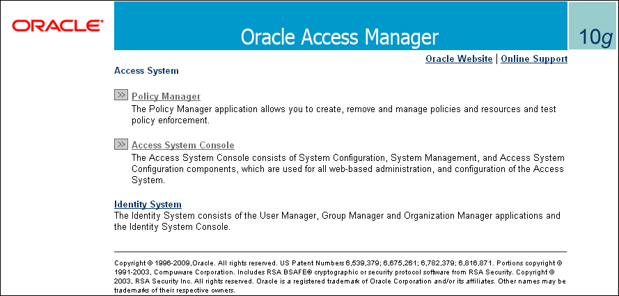

Direct your web browser to The Oracle Access Manager server interface. If you are unsure of the required URL, you should contact the OAM system administrator. The page shown in Figure 7-1 appears.

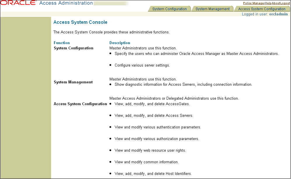

Click the Access System Console link. The page shown in Figure 7-2 appears.

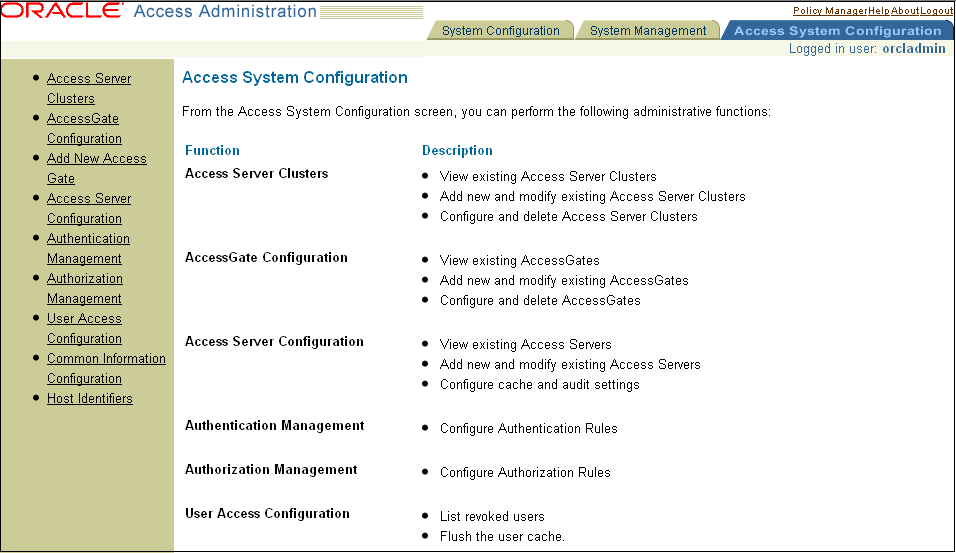

Click the Access System Configuration tab. The page shown in Figure 7-3 appears.
Figure 7-3 OAM Access System Configuration Page

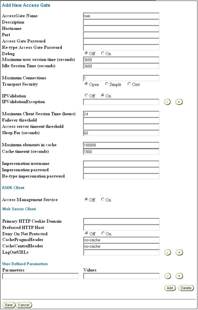

Click the Add New Access Gate option on the left-hand side of the page. The page shown in Figure 7-4 appears.
Provide the following information:
Access Gate Name: specify a unique ID for the new Access Gate. For example, ruei.
Hostname: specify the hostname of the RUEI Reporter system.
Port: specify the port RUEI should monitor for OAM-based traffic. This should be port 443.
Access Gate Password: specify the password that should be used to authorize the RUEI Reporter system to access the OAM server.
Re-Type Access Gate Password: confirm the authorization password.
Preferred HTTP Host: specify SERVER_NAME.
Note that the remaining fields can be left blank or with default values specified.
When ready, click Save.

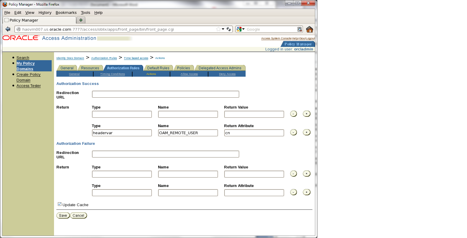

To configure the OAM_REMOTE_USER header variable, complete the following:
Click the Policy Manager link, as shown at the top of the screen in Figure 7-1, "OAM Server Interface".
From the Authorization Rules tab, click Time based access, then click Actions.
Under ”Authentication Success”, configure the following header variable:
Type=headervar, Name=OAM_REMOTE_USER, and Return Attribute=cn.
Click Save.
