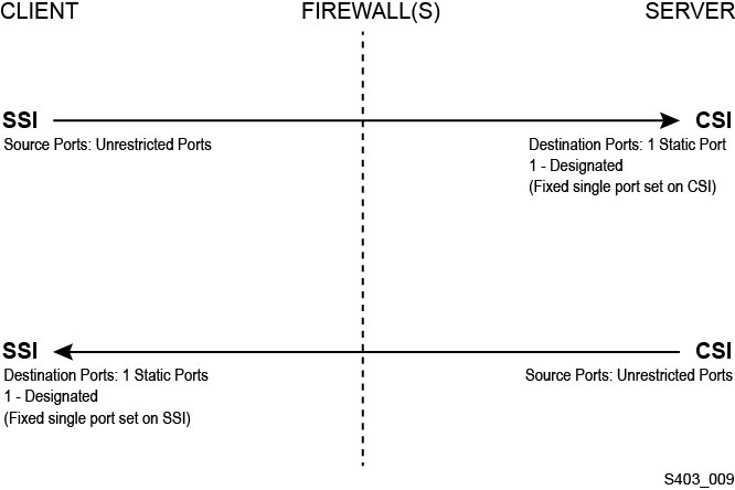

ACSLS Firewall Security Option
If client applications, which use ACSLS to mount tapes and manage tape libraries, are separated from ACSLS by a firewall, we recommend enabling the Firewall Security Option. Even if the client applications are not separated from ACSLS by a firewall, implementing the Firewall Security Option provides additional ACSLS security by restricting the ports used for communication between ACSLS and its client applications, as shown below. For these reasons, the CSI_FIREWALL_SECURE static variable defaults to TRUE in ACSLS 8.1 and later releases.
Surrounding text describes s403_009.jpg.
For details, see the ”Firewall Security Option” appendix in the ACSLS Administrator's Guide.

  • For client applications to communicate with ACSLS through the ACSAPI, the following ports must be open:
    • The client application must be able to communicate with the ACSLS CSI's listening port. This defaults to 30031, and is set by the CSI_INET_PORT static variable.
      You can discover which ports are in use by ACSLS to listen for requests from ACSAPI clients with the following command from your Unix shell:
      rpcinfo -p | egrep "300031 | 536871166"
      The port IDs will be listed in the last field of the display.
    • The ACSAPI client (for example, a NetBackup or SAM-QFS server) sets its fixed incoming port using the SSI_INET_PORT environmental variable. Specify a port in the range of 1024-65535, excluding ports 50001 and 50004. The ACSLS server must be able to communicate with this port.
      On an ACSAPI client server, ports 50001 and 50004 are used for AF_INET domain IPC communication to the mini-Event Logger and from client applications to the SSI.
    See the Firewall Security Option appendix in the ACSLS Administrator's Guide for more details about communication between client applications and ACSLS.
  • If the XAPI component is installed, the XAPI server uses a fixed listening port to receive incoming TCP requests from ELS clients. The XAPI listening port is defined by the XAPI_PORT static variable. XAPI_PORT defaults to 50020. It must be between 1024 and 65535, and cannot conflict with any other port used by ACSLS or other applications.
    Please see the XAPI Client Interface appendix in the ACSLS Adiminstrator's Guide for more details about the XAPI_PORT. This appendix also provides details about how to display and set the XAPI_PORT static variable.
