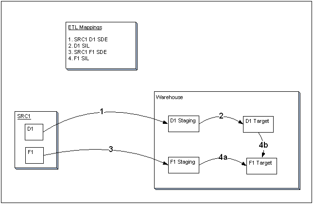

Figure 2-2 shows the ETL process for extracting data from two tables (one dimension D1 and one fact F1) in one source application database.
Figure 2-2 ETL for One Source Database
Description of Figure 2-2 follows
Description of "Figure 2-2 ETL for One Source Database"
Each numbered arrow represents the execution of a Mapping. The Mappings are executed in the order indicated by the numbers. Mapping 4, the SIL that loads fact F1 into the warehouse target table for the fact, has two components. The first part (4a) represents the copy, transformation, and derivation of the staged data for the fact. The second part (4b) represents the setting of the values of each record's foreign key to dimension D1. The result is that dimension D1 can be queried as one of the dimensions in the star-schema centered on fact F1.
OHSCDA provides SIL for each of its warehouse tables. It provides SDE to stage data for these tables from InForm, Oracle Clinical, and Siebel Clinical database. The execution of the mappings is under the control of ODI.

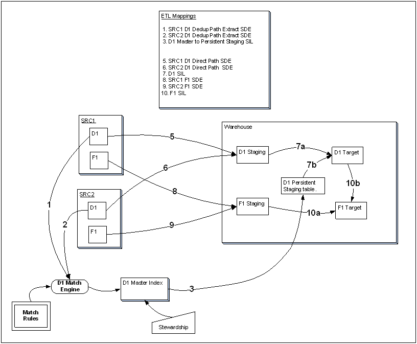

If data is loaded from more than one data source, it is necessary to integrate the data, by identifying and merging duplicate source records. To address this, OHSCDA provides a multi-source integration capability. Figure 2-3 illustrates how OHSCDA's ETL architecture expands to support multi-source integration. Multi-source integration is described in detail in Chapter 3, "Multi-Source Integration".
Figure 2-3 OHSCDA ETL in Multi-source Integration
Description of Figure 2-3 follows
Description of "Figure 2-3 OHSCDA ETL in Multi-source Integration"
The OHSCDA ETL architecture is flexible. It allows you to integrate data from multiple databases instances for one application (for example, multiple Oracle Clinical databases), or databases from different source applications (for example, one Oracle Clinical and one Siebel Clinical), or any combination of these.
