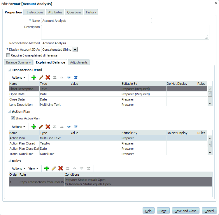

The following is an example of an Account Analysis Explained Balance tab with the Transaction Detail, Action Plan, and Rules sections:

Transaction Detail
The attributes assigned to the transaction, including standard and attributes. Assign sufficient attributes to enable Preparers of reconciliations to fully document the nature of the transaction.
Action Plan
Lists the action plans related to reconciliation transactions. The attributes in this section have different behavior according to the access privileges to ensure that Preparers can document resolution of outstanding items, even after the reconciliation is submitted.
Rules
Lists the rules related to reconciliation transactions.
