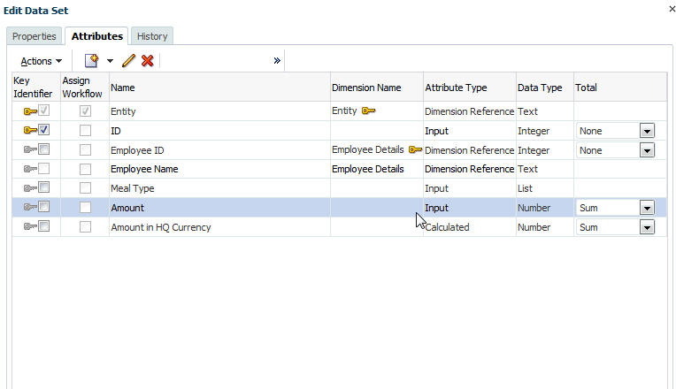

  1. Select the data set and select Actions, then Edit.
    sample data set showing Amount attribute

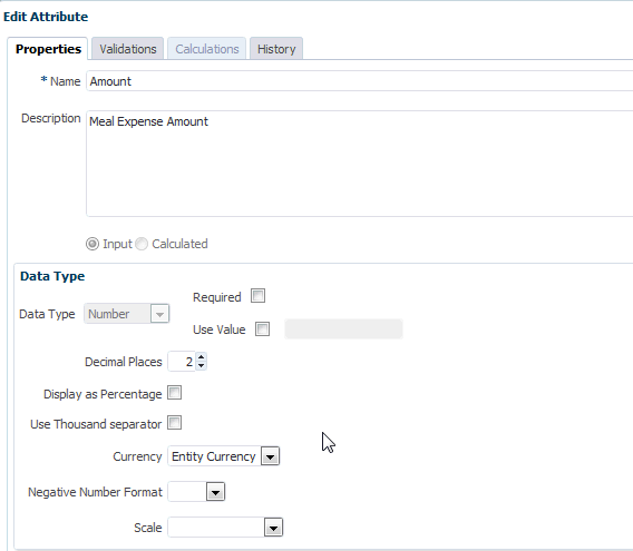

  2. From the Attributes tab, select the attribute (for example, Amount which is the input value for the meal expenses from various teams around the globe, and click Actions, then Edit.
    Edit Attribute dialog showing Properties for Amount attribute.
  3. In Currency, selecting Entity Currency means that this attribute (Amount) will inherit the currency of the Entity that the form is deployed to, which is "USD" (dollars) in this example.

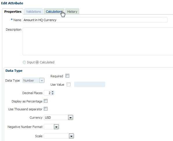

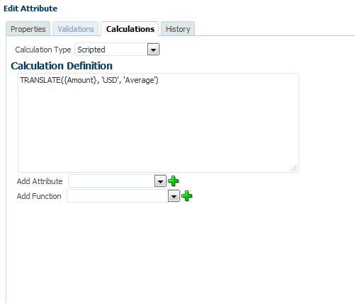

  4. Now look at the calculated attribute, Amount in HQ Currency, that was set up with Currency in USD (dollars).
    Properties dialog showing the calculated attribute, Amount in HQ Currency.
  5. In Calculations, note how the Translate function has been set up to translate the values in "Amount" to USD currency using the "Average" exchange rate.type.
    Translate function for calculated attribute Amount in HQ Currency

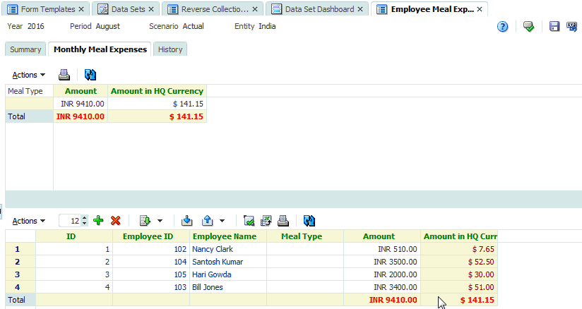

  6. Once the data set setup is complete, you can see the translation work in a deployed form. Here's an example showing a form template that has been deployed to four different entities having four different currencies.
    Deployed form showing four entities with four different currencies
    Let's take a look at the Monthly Meal Expenses for India. Once you enter the "Amount", the translated currency value shows up once you Save it. Note that the translation is calculated using the values from exchange rate table.
    Input value shown in Amount column and translated to HQ currency

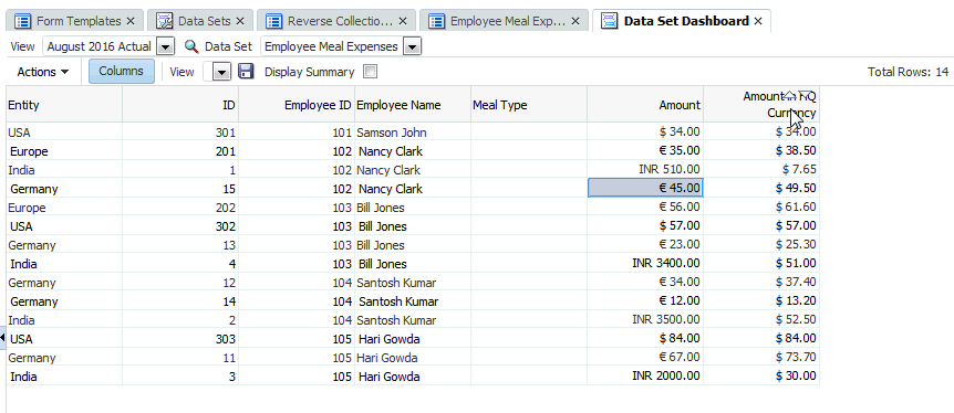

  7. You can also see how this looks in the Data Set dashboard. Note that currency symbol in the "Amount" column and the translated values in the "Amount in HQ Currency" column.
    view in Data Set Dashboard of translated currencies from input amount in local currency to HQ currency in USD
