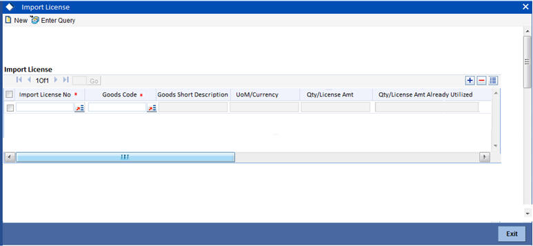

Import License Click this link to capture import license details,

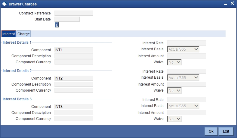

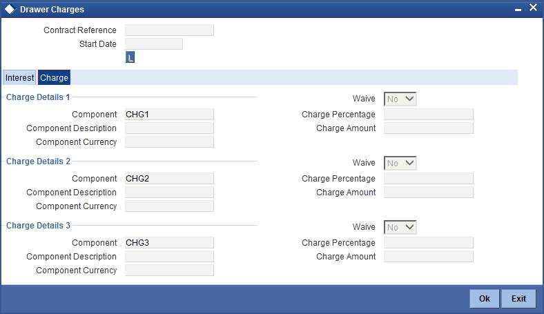

Drawer/Drawee IC Click this link to invoke the ‘Drawer/Drawee Interest and Charges’ screen. You can define the charge and interest components at the time of initiation of contract.

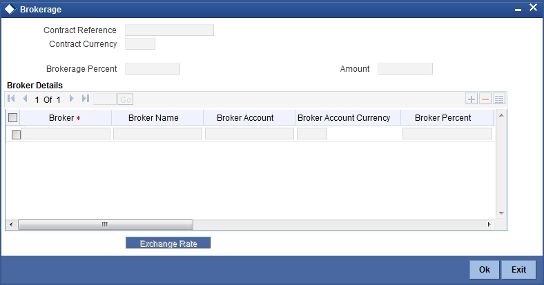

Brokerage Click this link to specify the details of the broker and brokerage.

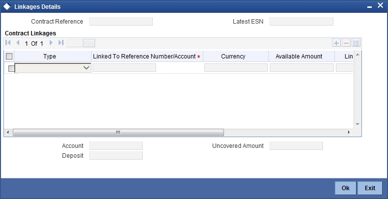

Linkages Details Clicking this link invokes the Contract Linkages screen. Here, you can link the bill to funds available in an account or deposit.

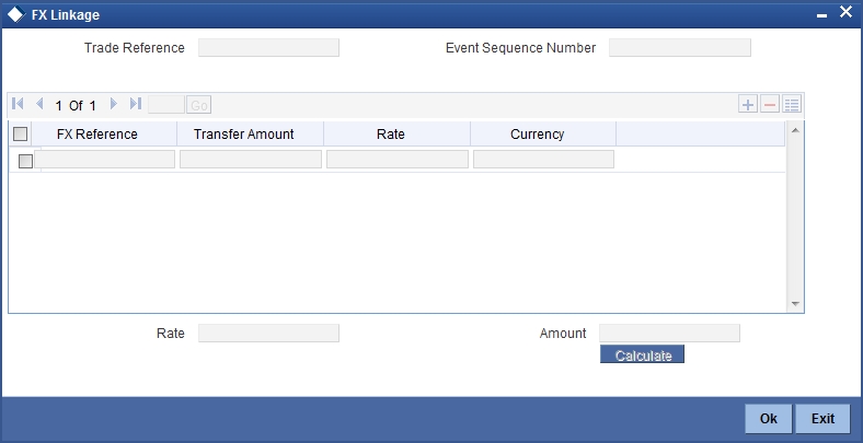

FX Linkage This link invokes a screen in which you can link a bill involving a specific counterparty with FX deals involving the same counterparty.

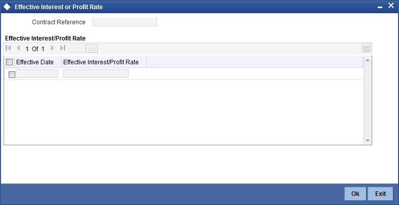

Effective Inter­est Rate Click on this link to specify effective interest rate details.

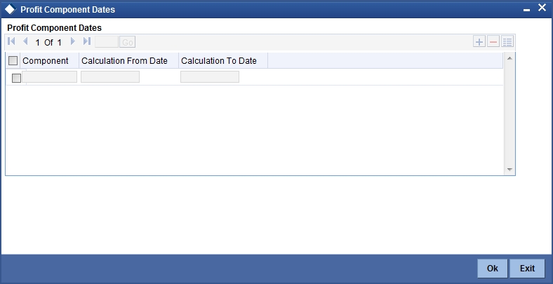

Interest Dates Click on this link to capture forfeiting interest computation dates.

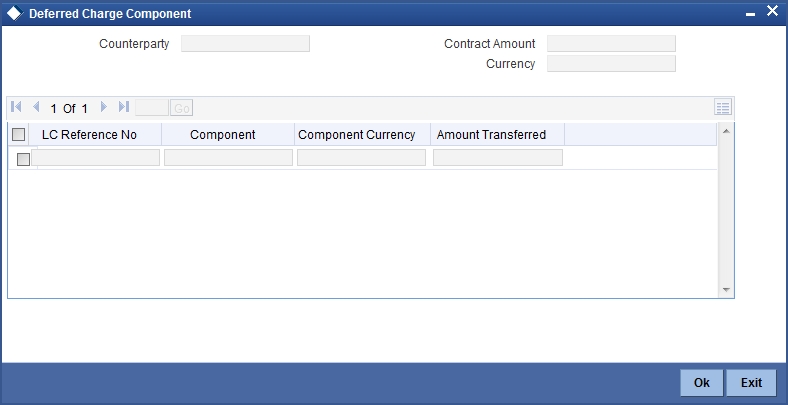

Charges Trans­fer Click this link to invoke the ‘Deferred Charge Component’ screen.

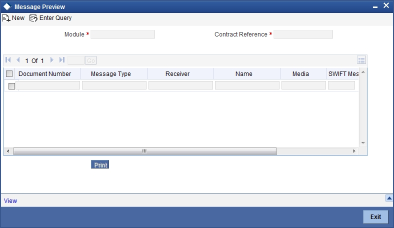

Message Pre­view Click this link to view the messages or advices generated for the contract.
All Messages Click this link to view all messages associated to contract.

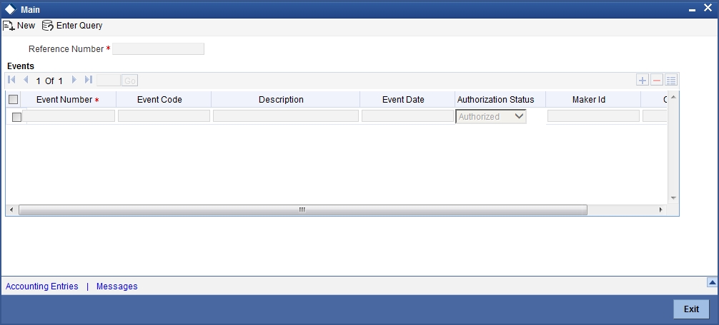

6.1.2 Events Button
Click ‘Events’ button in the ‘Bills and Collections - Contract Input - Detailed’ screen and invoke the ‘Event Details’ screen. The details of events, that have already taken place on the contract, will be displayed along with pending events. The date on which the event took place will also be displayed.

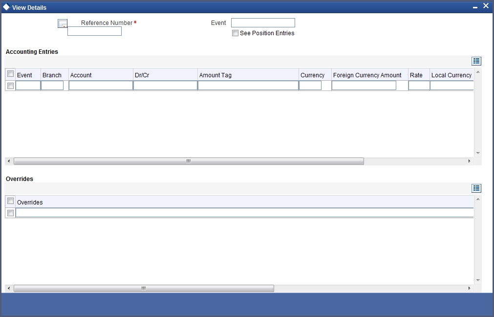

Click ‘Accounting Entries’ button to view the accounting entries for the event. Click ‘Message’ button to view the messages applicable to the event. Click ‘Exit’ or ‘Cancel’ button to return to the Bills Contract Detailed screen.
6.1.2.1 Viewing the Accounting Entries Passed for the Bill
From the ‘Event Details’ screen, click ‘Accounting Entries’ button and view the ‘View Details’ for the event. The details of the accounting entries that were passed for the event can be viewed here. The accounting entries that are passed depend on the type of bill you are processing.
The following information is provided for each event:

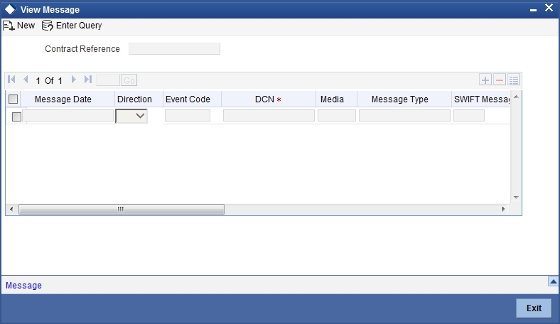

6.1.2.2 Viewing Advices

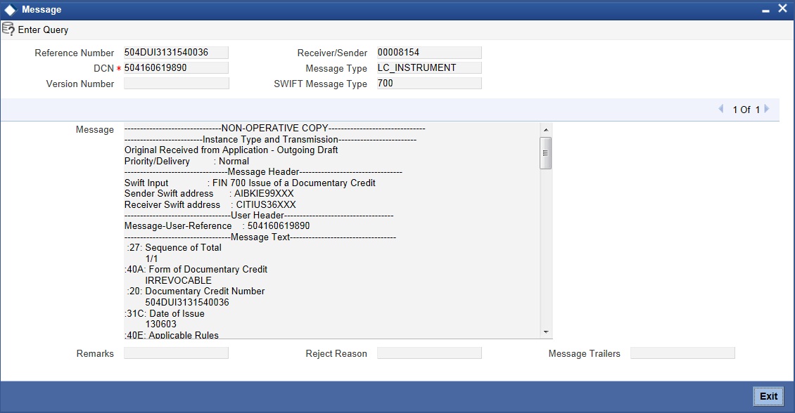

Click ‘Message’ button from the ‘View Events’ screen and view the list of advices applicable to a particular event in the lifecycle of the bill.
The following details of a message are displayed:
To view the text of a message, highlight the message and click ‘Message’ button. Click ‘Exit’ or ‘Cancel’ button to exit the screen.

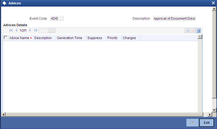

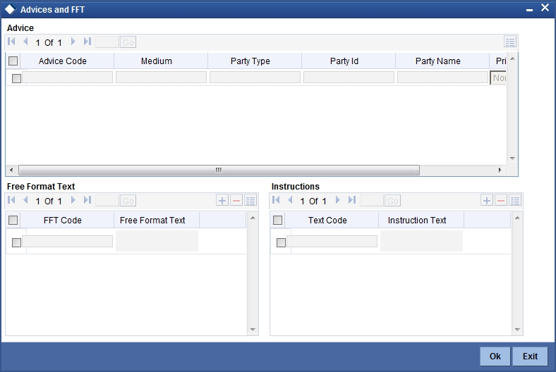

6.1.3 Advices/FFT Button
The advices that have to be generated for an event during the lifecycle of a bill are specified for the Product involved in the bill. While processing a bill, you can:
From the ‘Bills and Collections - Contract Input - Detailed’ screen, click ‘Advices / FFT’ button. The ‘Advices / Free Format Text’ screen is displayed.
6.1.3.1 Specifying Advice Details
The advices inherited from the product involved in the bill you are processing will be displayed in the Advice Code field.
Suppress
By default, all the advices that have been defined for a product will be generated for the bills involving it. As certain advices may not be applicable to the bill you are processing, you can suppress its generation by indicating the same in this screen.
Priority
For messages sent through media like SWIFT or TELEX, you can specify the priority with which the advice should be generated. By default, the priority of all advices is marked as Normal. You have the option to prioritize advices to one of the following options:
However, you can change the priority of an advice to Urgent only for Payment Advices.
Medium
If advices are to be generated, for the bill you are processing, it is mandatory for you to also specify the medium through which an advice is to be transmitted. An advice that is generated can be transmitted Mail, TELEX, or SWIFT. You can select the appropriate medium code from the option list.
Advice Code
This is the code that identifies the advice that can be generated for a bill. All the advices specified for the product to which the bill is linked will be displayed in this screen. If the advice is not applicable to the LC you are processing you can suppress its generation in the corresponding fields on this screen.
Party Type and Identification
This is the type of party involved in the bill. For example, drawee, drawer etc. The party type is displayed based on your specifications in the Parties screen.
Party Name
This is the name of the party involved in the bill to whom the advice is to be sent.
6.1.3.2 Specifying FFTs for a Bill
Free Format Texts (FFTs) may be a set of statements that should be printed on the advices generated to the parties, involved in the bill. Additional information that should be a part of the bill instrument can be entered in the form of an FFT.
While defining a product, you also specify the FFTs that should accompany an advice generated for a bill, involving the product. These FFTs will appear when you select an advice code. This indicates that the FFTs that you specify will appear on the advice which is highlighted.
If the Applicable Rule in the ‘LC Product Preferences’ screen is selected as ‘OTHR’, you need to specify a rule narrative for the LC Product. If the Rule Narrative exceeds the limit predefined (35 characters), the same can be defined as a Free Format Text. For BC contracts, FFT codes are associated with advices in the LC contract. The 47A and 47B tags are linked to FFT codes. The message types supported by 47A tag are:
Message Types supported by 47B tag are:
You can add to or delete from the list of FFTs that are defaulted from the product involved in the bill. To add an FFT to the list, click add icon and select the code that identifies the FFT, from the option list. The description of the FFT is automatically picked up and displayed. You can edit the FFT description that is defaulted to suit the requirements of the bill you are processing.
To delete an FFT from the list, highlight the code that identifies the FFT and click delete icon.
Note
For the values of Field 72, Field 75 and Field 76 to be populated in MT 422, it is mandatory that you enter a description for the following FFT codes:
6.1.3.3 Specifying Instructions for a Bill
You have defined instructions and assigned them codes, in the Instruction Code Maintenance screen. These instructions can be sent, along with the advices that are generated, to the parties involved in the bill.
When you select an advice code, the advice code is displayed in the Instruction section, of the screen. This indicates that the Instructions that you choose will appear on the advice, which is displayed.
The Instruction Codes indicated for the product to which the bill is associated will be defaulted to this screen. You can add or delete instruction codes, from the defaulted list of Instructions that accompanies an advice generated for the bill.
You can add to or delete from the list of Instructions, defaulted from the product involved in the bill.
The list of instructions associated with an advice is displayed. You can add to or delete from the list of defaulted instructions.
To add an Instruction to the list, click add icon and select the code that identifies the instruction from the option list. The description of the instruction is automatically picked up and displayed. You can edit the description that is defaulted.
To delete an instruction from the list, highlight the code that identifies the Instruction and click delete icon.

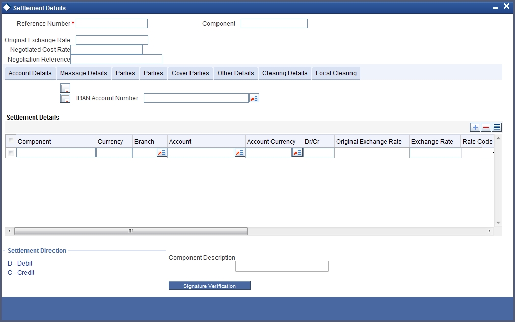

6.1.4 Settlement Button
You can capture the settlement details of a bill in ‘Settlement Details’ screen. Click ‘Settlement’ button in ‘Bills and Collections - Contract Detailed’ screen to invoke the ‘Settlement Details’ screen.
The bill gets settled based on the details specified in the settlement screen.
For more details on this screen, refer the section titled ‘Processing Settlements’ in Settlements user manual.

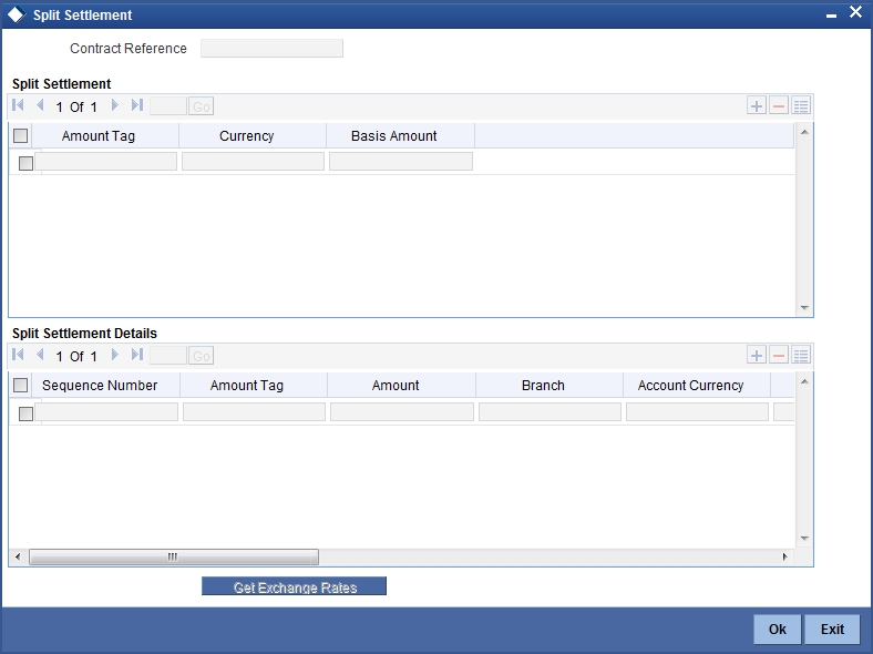

6.1.5 Split Settlement Button
You can capture split settlement details for the bill using the ‘Split Details’ screen by clicking ‘Split Settlements’ button in the ‘Bills and Collection - Contract Input - Detailed’ screen.
On clicking the Split Settlement button, if you have checked the ‘Settle Available Amount’ box in the ‘Additional’ tab of the Contract screen, then the system will check for the customer balance. If there is no sufficient balance in the Customer account including the OD limit, then the available amount will be adjusted towards the Bill Liquidation Amount.
6.1.5.1 Basis Details
Amount Tag
The bill amount tag defined for the current event in the bills contract is displayed here. It is picked up from those defined for the INIT event. You cannot change them.
CCY
The currencies associated with the amount tags (as picked up from the INIT event) are displayed here. You cannot change them.
Amount
The amount for each amount tag (picked up from the INIT event) is displayed here. You cannot change them.
6.1.5.2 Split Details
S. No
The system generates a running sequence number for each split record. You cannot modify it. The system automatically generates the sequence number on introducing a new split.
Amount Tag
The selected amount tag in the basis details section is displayed here in the split details section. If there are no settlement tags for the event being processed, the system will display an error.
Amount
Specify the split amount for the split amount tag. The sum of amount should not be greater than the basis amount. The system calculates the amount on the basis of the split percentage. You cannot leave this field blank.
Percentage of Proceeds
Specify the split percentage of the Bill Amount for each account. The sum of split amounts should be equal to the total amount specified for the corresponding basis amount tag. You cannot leave this field blank.
Customer
Specify the customer to whom the split amount should be assigned. The adjoining option list displays all the customers maintained in the system. You can select the appropriate one.
Branch
The system displays the branch where the settlement account for the split amount tag resides. The adjoining option list displays all the valid branches in the system. You can choose the appropriate one.
Account Currency
The settlement account currency for the split amount tag is defaulted based on the settlement account chosen. You cannot change it.
Account
Select a valid account for the specified settlement account branch, from the option list.
Loan Account
Check this box if you want the split amount to be booked as a loan. The split settlement amount entered as the Loan Amount is used to create the loan contract. You can select more than one Account as Loan account. This is enabled only for settlement tags BILL_LIQ_AMT or BILL_LIQ_AMTEQ.
Exchange Rate
If the basis amount currency is different from the settlement account currency, you need to specify the exchange rate that should be used for conversion.
Negotiated Cost Rate
Specify the negotiated cost rate that should be used for foreign currency transactions between the treasury and the branch. You need to specify the rate only when the currencies involved in the transaction are different. Otherwise, it will be a normal transaction.
The system will display an override message if the negotiated rate is not within the exchange rate variance maintained at the product.
Negotiated Reference Number
Specify the reference number that should be used for negotiation of cost rate, in foreign currency transaction. If you have specified the negotiated cost rate, then you need to specify the negotiated reference number also.
Note
Oracle FLEXCUBE books then online revaluation entries based on the difference in ex­change rate between the negotiated cost rate and transaction rate.

6.1.7 Effective Interest Rate Button
You can view the effective interest rates applied for the contract through the ‘Effective Interest Rate’ screen. Click ‘Effective Interest Rate’ button to invoke the screen.
In this screen you will be able to view the Effective Interest Rate and the date from which interest rate is effective.
6.1.8 Interest Dates Button
Forfaiting refers to purchasing of an exporter's receivables (the amount importer owes the exporter) at a discount by paying cash.
The purchaser of the receivables (forfaiter) becomes the entity to whom the importer is obliged to pay his/her debt. You bank can process such transactions for export bills under an LC and Usance export bills. As mentioned in the earlier chapters, you can specify the change of operations for such bills at the product level.
While entering a bills contract, you can capture forfaiting interest details in the ‘Interest Computation Dates’ screen. Click ‘Interest Dates’ button in the ‘Bills and Collections – Contract Input - Detailed’ screen and invoke this screen.
Interest Component
Specify the interest components. You can choose the appropriate one from the adjoining option list. The forfaiting and rebate interest components will be displayed in this list only if the bill operation has changed to ‘Forfaiting’.
Calculate From Date
You can specify the start date for interest computation. The start date for the main interest component and acceptance interest components are defaulted from the ‘Bills and Collections - Contract Input - Detailed’ main screen. However, for the main component, you can specify the base date. The start date for forfaiting and rebate interest components is defaulted as the current date. However, you can change this. For components that have already been liquidated, you cannot change this date.
The start date for all interest components can be less than or equal to the current date. You cannot input a date in the future.
Calculate To Date
Specify the end date for interest computation. This date for the main interest component and acceptance interest components are defaulted from ‘Bills and Collections - Contract Input’ main screen. However, for the main component, you can specify the date corresponding to the base date + bill tenor. The system defaults the end date for the forfaiting and rebate interest components as the contract maturity date. However, you can change this. For components that have already been liquidated, you cannot change this date.
The end date for all interest components should be greater than the start date. Oracle FLEXCUBE supports the upload of component-level interest start and end dates.

6.1.10 Brokerage Button
You can capture the brokerage details for a BC contract and set your preferences for sharing the brokerage amount among multiple brokers using ‘Brokerage’ screen. To invoke the screen, click ‘Brokerage’ button on ‘Bills and Collections Contract Detailed’ screen.
Contract Reference
The system displays the reference number of the contract.
Contract Currency
The system displays the currency of the bills contract. You cannot modify the contract currency.
Brokerage Percentage
Specify the percentage of the contract amount that should be paid as brokerage. Based on the percentage set here, the system calculates the brokerage amount. The brokerage amount calculation takes place at the Bills contract level.
In case of Bills contracts, you may directly enter the brokerage amount. However, if you specify the brokerage percentage as well as the amount, the system ignores the amount and calculates it afresh based on the percentage specified here.
Brokerage Amount
Specify the brokerage amount to be paid. However, if you have entered the brokerage percentage, the system ignores the amount mentioned here and calculates it afresh based on the brokerage percentage.
You can directly enter the contract amount for Bills contracts only. In case of LC contracts, the system displays the amount based on the brokerage percentage and contract amount. You cannot modify the brokerage amount in that case.
Brokerage Details
You can share the brokerage amount among multiple brokers. Click add button to add more brokers to the list.You can define the percentage of brokerage amount to be paid to each broker selected under this list
Broker
Specify the broker ID. The option list displays all valid broker IDs maintained in the system. Choose the appropriate one.
You can maintain multiple records for the same broker ID.
Broker Name
Based on the broker ID selected, the system displays the name of the broker.
Broker Account
Specify the broker account. The option list displays all valid accounts maintained for the selected broker along with the Nostro accounts and GLs for which posting is allowed. Choose the appropriate one.
Broker Currency
The system displays the currency of the selected broker account.
Percentage
Specify the percentage of total brokerage amount that should be paid to the selected broker. This will make the selected broker eligible for that percentage of the total brokerage amount shown above.
You can allot a specific percentage of the brokerage to each broker selected here. The system will verify whether the percentages allotted for all brokers together equals to 100 or not.
Amount in Account Currency
The system displays the portion of brokerage amount allotted to the selected broker in terms of local currency.
Exchange Rate
The system displays the exchange rate between the local currency and the account currency. This rate is used to convert the brokerage amount into the account currency. You can modify the exchange rate.
Amount in Contract Currency
The system calculates and displays the portion of brokerage amount allotted to the selected broker in terms of contract currency.
Original Exchange Rate
The system displays the actual exchange rate. This rate is inclusive of all available customer spreads.
Negotiated Rate
Specify the rate of exchange agreed upon after the negotiations with the broker.
Negotiation Reference Number
Specify the negotiation reference number.
Once you have captured the details, save the contract. The system allows modification of brokerage details until its liquidation.
The system will default the brokerage details to the bill contracts associated with this LC. You may modify the brokerage details at the bills contract level.
You can use ‘Exchange Rate’ button to get the exchange rates between the broker account currency and bill currency for all the brokers listed in the screen.
The system defaults the brokerage details in ‘Spilt Settlements’ screen. Those details are then used in settlements. You can enter the routing details for the messages in case the settlement takes place through Nostro account. If you modify the default brokerage details in ‘Split Settlements’ screen, the system displays an error message.
During liquidation of the brokerage, the system generates credit advices for each of the brokers involved.
6.1.11 Charges Transfer Button
Click ‘Charges Transfer’ button to invoke the ‘Charges Transfer’ screen. This screen displays charge components transferred from export LC and component wise outstanding charges for the LC against which the Bill is being availed.
Following details are displayed:
The total amount transferred onto the Bill for a component is internally allocated amongst the various events of the LC during which the component was charged. System transfers the charge from LC completely and the same gets marked as liquidated. If export LC is not linked to import bill, system displays a message instructing you to visit linkages screen to link export LC to a bill and then visit ‘Charges Transfer’ screen.
This screen does not display any waived components.

6.1.12 Drawer/Drawee IC Button
For inward and outward bills collection, system records and displays the Presenting Bank’s additional charges and interest on advice, as claimed by the drawer. System can record charges and interest with interest rate and other details i.e. interest rate, start date and basis of calculation (360/365) and against this charge component, you have to mention the following in the system:
You can view all these details on the advice and upon the settlement of the bill. System populates and validates all the data.
For instance, in normal scenario drawer’s bank charges are collected from the drawer and drawee bank’s charges are collected by the drawee. However, some time drawer’s bank ask their charges also from the drawee only and additionally, drawer also will like to collect some interest as well along with the invoice value. System records the details of this charges/interest and mentions if these charges can be waived or not.
Click ‘Drawer/Drawee IC’ button to invoke the ‘Drawer/Drawee Interest and Charges’ screen. In this screen, you can define the charge and interest components at the time of initiation of contract.
Specify the following details in this screen:
Contract Reference Number
Contract Reference Number is displayed.
Start Date
Specify the Start date for interest details. Start date cannot be less than bill booking date.
6.1.12.1 Interest Tab
Specify the following details pertaining to interest:
Interest Details 1
Specify the following details:
Component
Specify the interest component.
Component Description
Specify the description of the interest component.
Component Currency
Specify the currency of the interest component.
Interest Details 2
Component
Component Currency
Interest Details 3
Component
Component Currency
Interest Rate
Specify interest rate. Interest rate cannot be greater than 100.
Interest Basis
Select the interest basis from the drop-down list. You have the following options:
Interest Amount
The interest amount is the interest to be levied on drawer.
Waive
Select the waiver from the drop-down list. You have the following options:
System considers the period between the start date and the date of liquidation for calculating interest amount.
During liquidation, system calculates and displays the amount for each of the defined component.
6.1.12.2 Charge Tab
In the ‘Drawer/Drawee Interest and Charges’ screen click ‘Charge’ tab to maintain the charge details.
Specify the following details pertaining to the charges:
Charge Details 1
Component
Specify the charge component.
Specify the description of the charge component.
Component Currency
Specify the currency of the charge component.
Charge Details 2
Component
Component Currency
Charge Details 3
Component
Component Currency
Waive
Charge Percentage
Specify charge percentage. It cannot be greater than 100.
System calculates the final charge based on this value.
Charge Amount
The charge amount is the charge to be levied on drawer.

6.1.13 Message Preview Button
You can preview the messages or advices that will be generated for the contract using ‘Message Preview’ screen. To invoke this screen, click ‘Message Preview’ button.
For the contract, you can view the following details of the messages:
If the contract is authorized. you cannot use the message preview feature. The ‘Message Preview’ button will be disabled in that case.
Message preview functionality is available on save for all the BC transactions. Along with the preview option, you will be allowed to print the required message/advice from the preview screen.
6.1.13.1 Viewing Message/Advice
Select a message/ advice and click ‘View’ button to view the complete message/advice. The system will display the following details in a new window.
You can view the following details:
6.1.13.2 Printing Message/Advices
From the ‘Message Preview’ screen, you can print or spool a message/advice using ‘Report Options’ screen. Select the message/advice and click ‘Print’ button to print the message/advice.
6.1.14 All Messages Button
Click ‘All Messages’ button to invoke the ‘View Message’ screen. This screen displays all the incoming and outgoing messages associated to the contract.
The following details are displayed:
Contract reference number
Displays Reference number of the contract, for which messages are generated.
Message Date
Displays the message generation date or received date
Direction
Displays whether the message is an incoming or outgoing message
DCN
Displays document reference number of a contract.
Media
Displays whether the message is a swift message or mail message
Message Type
Displays the type of message
Swift Message Type
Displays the Swift MT number of the message sent or received
Receiver/Sender
Displays Receiver or Sender ID.
Name
Displays the name of the Sender or Receiver
Message Status
Displays current status of message
Test Status
Displays the test status
Authorized
System displays whether the status is authorized or unauthorized.
Acknowledgement Status
Displays the Ack/Nack status of a message
PDE Flag
Displays the PDE flag
Select a message and click on Message button to view details of the message.
6.1.15 Import License Button
You can link the import license to an import BC contract and update the utilization amount or quantity for the linked import licenses. Click on ‘Import License’ to view the import license details.
Import License No
Select the import license number from the adjoining option list.The import licenses maintained for the party type ‘Applicant’ in the Import License Maintenance screen is displayed in the option list.
Goods Code
Select the goods code from the adjoining option list.
Goods Short Description
The system displays the goods code description maintained in the ‘Bills and Collections Commodity Code Maintenance’ screen.
UoM/Currency
The system displays the unit of measurement or currency captured for the goods code of import license.
Note
If the basis is ‘Quantity’, then the system displays the UoM maintained for the goods code.
If the basis is ‘Amount’, then the system displays the currency maintained for the import license.
Qty/License Amount
The system displays the Quantity or License Amount captured for the goods code of import license.
Qty/License Amt Already Utilized
The system displays the sum total of Quantity or License Amount already utilized for the goods code.
Qty/License Amt Already Reinstated
The system displays the sum total of Quantity or License Amount already reinstated for the goods code.
Available Qty/License Amt
The system displays either the Available Quantity or Available License Amount for the goods code.
Qty/License Amt Utilized
Specify the quantity or the license amount utilized.
Note
If the license utilization basis is Quantity, then the system defaults the License Amount Uti­lized as Quantity Utilized * Rate/Unit.
Qty/License Amt Reinstated
Specify the quantity or the license amount reinstated.
Note
If a goods code is classified as licensed or prohibited and is captured for an import LC or BC contract and if the import license details are not specified, then on save the system displays an override message as 'Import License Details are not entered for the contract'.
After authorization, you cannot modify or delete import licenses linked to a BC contract.
Note
If the good is classified either as Licensed or as Prohibited and the import licence details are not entered in the LC or BC contract screens, then the system displays an override message as ‘Import license details are not entered for the contract’.

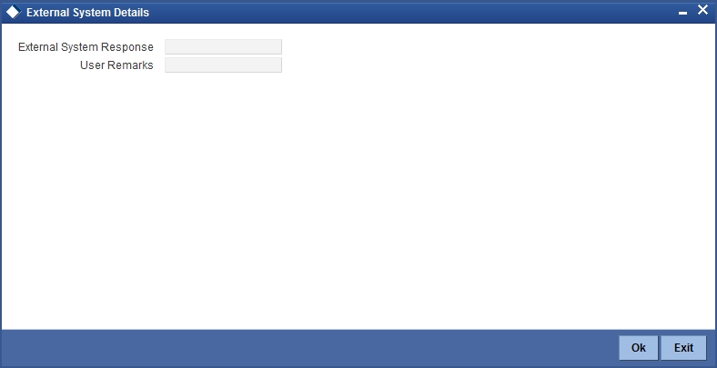

6.1.16 OFAC Check Button
OFAC check enables the application to call an external web service to perform black list check for customer and customer accounts and give warnings appropriately while transacting with black listed customers. You can also capture your remarks before overriding the black list warning.
Click ‘OFAC Check’ button in ‘Bills and Collections - Contract Input - Detailed’ screen to view the OFAC check response in the ‘External System Detail’ screen On clicking ’OFAC Check’ button, system will build the request XML and call the web service. The ‘External System details’ screen displays the response is received from the external system and you will be also allowed to enter your remarks in this screen. The response received will also be sent to Oracle FLEXCUBE Database layer for any further interpretations of the same. This button can be made visible while carrying out the actual customization. Request building response interpretation in the database layer needs to be done as part of customization to enable this.
Here, you can view /capture the following details:
External System Response
The response from the external system regarding the black listed customer is displayed here.
User Remarks
Specify your remarks regarding the black listed customer here.

6.1.18 Linkage Details Button
In the Contract Details screen, you can specify the type of linkage. The bill can be linked to a:
For export LC, note the following:
Note
For shipping guarantee, if bill amount is less than the shipping guarantee amount, an error will be displayed. In case bill amount is more than the shipping guarantee amount, an over­ride message will be displayed.
Specifying the Details of the Linkage
If the bill you are processing is linked to a deposit, you should enter the Reference Number of the deposit. The deposit should be a valid contract in Oracle FLEXCUBE, with a Value Date that is earlier than, or the same as the Value Date of the bill, and a Maturity Date that is the same as, or later than that of the bill.
If you link the bill to an account, you must specify the account number. The account has to be a Current or Savings Bank account.
Version Number
The version number of the bill on which you are working is displayed in this field.
Currency
The currency of the linkage type to which the bill is linked is displayed once the linkage details are specified.
Exchange Rate
If the currency of the bill is different from the currency of the deposit or account to which it is linked, the mid-rate for the day will be picked from the Exchange Rate table, and displayed in the screen.
Linked Amount
In this screen, you should also indicate the contract amount that has to be linked to the deposit or account. This amount can be the entire bill amount, or a portion of it. The ‘amount available for linkage’, in the specified deposit or account, is arrived at taking into account the other linkages and uncollected funds, and the unauthorized balance (in case an account).
The system will display the following amounts, once you specify the Linked Amount:
Type
This is the type or nature of the document that you have specified in the Document code field. This field is defaulted based on the document code you have selected.
The documents required under a bill can be of the following types:
Linked to Reference Number Account
Specify the contract/account to which you wish to link the bill.
Converted Linked Amount
If the linked contract is in a different currency (than that of the bill), the system will convert the account/contract amount into the bill currency and display it here.
Available Amount
The system displays the amount available in the linked contract/amount.
6.1.19 FX Linkage Button
Oracle FLEXCUBE allows you to link a bill involving a specific counterparty with FX deals involving the counterparty. This feature guards you against exchange rate fluctuations. For instance, in case cross currency settlements are made for a bill, you would, typically, enter into a forward deal with the counterparty (or ask the counterparty to enter into a forward deal).
Click ‘FX Linkage’ button from the Contract screen. The ‘FX Linkage’ screen is displayed.
You can link one or more FX deals to a bill. The value of an FX deal should not exceed the value of the bill it hedges. If you link several FX deals to a bill, the total value of all the deals should not exceed the bill amount.

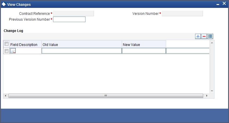

6.1.20 Change Log Button
You can view the values that were modified in a specific version of a bills contract. In the Contract Details screen, click ‘Change Log’ button to see the changes made at a specific version. The values that changed in the version will be displayed in a screen, as follows:
6.1.20.1 Viewing Different Versions of a Bill
When you enter a bills contract, it is allotted the version number 1. From then on, each amendment that you make to the contract results in the next version of the contract being created. In Detailed View screen of a contract the latest version will be displayed. To navigate between the various versions, use the arrow buttons to view the previous and next versions.

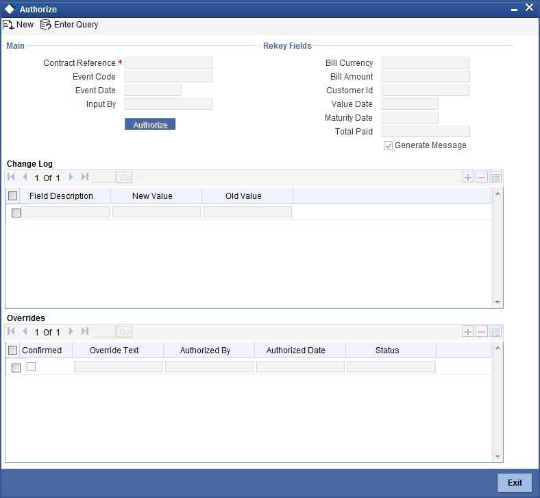

6.3 BC Authorize Contract Details
6.3.1 Authorizing BC Contracts
You can use the ‘BC Authorize Contract’ screen to authorize BC contract registration, input, amendment and payment operations. You can invoke this screen by typing ‘BCDTRAUT’ in the field at the top right corner of the Application tool bar and clicking on the adjoining arrow button. The screen is displayed below:
Contract Reference
Specify the contract number which you are authorizing.
Generate Message
Check this option to generate the messages.
Rekey Fields
Rekey the following details for authorizing a contract.
Change Log Details
If there are any values changed in the contract, then the following details are displayed here:
Overrides
The following override details of the contract for all operations is displayed here:
Note

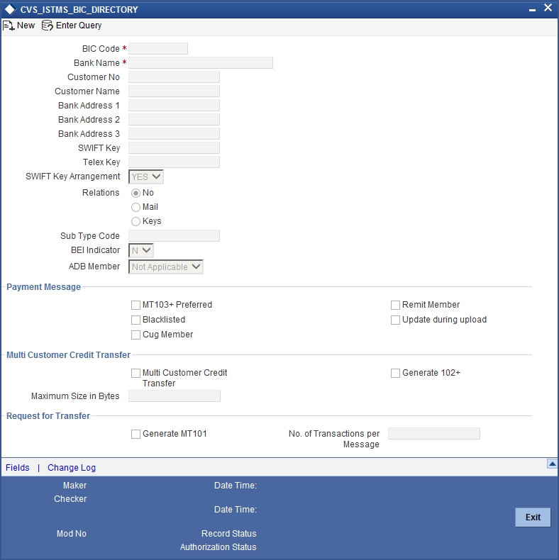

6.5 BIC Code Details
This section contains the following topic:
6.5.1 Capturing the BIC Details of a Customer
When the media type of the party is SWIFT, and the customer address you have specified happens to be a BIC customer, the system automatically displays the related BIC details in the ‘BIC Code Details’ screen. You can invoke this screen by typing ‘ISDBICDE’ in the field at the top right corner of the Application tool bar and clicking on the adjoining arrow button.I

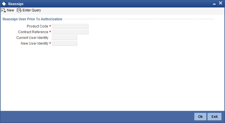

6.6 Bills and Collections Contract Reassign
6.6.1 Reassigning a Contract to another User
A contract can be deleted only by the user who entered it. If a contract has to be deleted and the user who input the same is not available to do it, you can reassign the contract to another user so that the other user can delete it. Typically, this situation may arise during EOD operations, when a contract that is not authorized has to be deleted and the user who input it has left office for the day.
You can invoke the ‘Bills & Collections Contract Reassign’ screen by typing ‘BCDTREAS’ in the field at the top right corner of the Application tool bar and clicking on the adjoining arrow button.
To reassign a contract to another user, the following steps are required:
  1. Step 1 - Indicate the product associated with the bill. You can select a product code from the option list, which contains a list of the authorized products that you have created.
  2. Step 2 - Indicate the contract reference number of the bill you wish to reassign, to another user. You can select a reference number from the option list, which contains a list of all the active bills.
  3. Step 3 -Select the User ID of the user to whom you, are assigning the contract.
Note
This user to whom you reassign a contract should have access rights to enter bill con­tracts.
Your User ID will be defaulted from the login screen. Select ‘Save’ from the Application toolbar or click save icon to save the specifications you have made. Click ‘Exit’ or ‘Cancel’ button if you do not want to save the details that you entered.

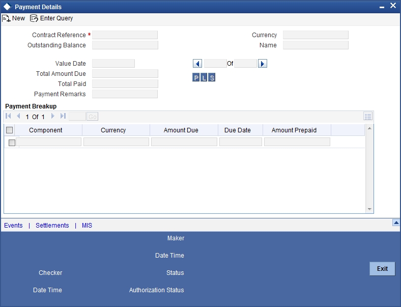

6.8 Bills and Collections Payment Input Details
6.8.1 Liquidating Overdue Components
You can liquidate the overdue components i.e. Normal and Penal components partially or fully through the ‘Payment Input’ screen.
You can invoke the ‘Bills & Collections Payment Input’ screen by typing ‘BCDTRPAY’ in the field at the top right corner of the Application tool bar and clicking on the adjoining arrow button.
Specify the following in this screen:
Contract Reference
Specify the contract you want to liquidate. You can also select the contract from the adjoining option list. The list displays all the active contracts with bill amount ‘zero’.
Total Due Amount
Total due amount of all the sub-components of a multi tenor contract is displayed here. However, for a non-multi-tenor contract, the system displays the total amount due for all the components.
Click ‘P’ button to display the outstanding amount. This screen also displays all the overdue interest and penalty interest on Principal.
On clicking ‘L’ button, the system will allocate the payment amount towards each component. On clicking ‘S’ button, the system displays the total amount paid and this total amount will be displayed in the ‘Total Paid’ field.
The following details are displayed in ‘Payment Breakup’ section of the screen:
Note
This provision is applicable for incoming advance bills where interest is collected in arrears and outgoing discounted/purchased bills (penalty interest is always collected in arrears). In case the components are liquidated, the screen amends the status of the contract as liquidated. You can also reverse the interest component that is liquidated.
On saving the transaction, the bill amount is validated against the product transaction limit and the user input limit maintained in the system. The system displays an appropriate override/error message if the amount exceeds the allowed input limit. It also indicates the level of authorisation required if the transaction the amount is in excess of the transaction limit maintained.
The system converts the bill amount using the standard mid rate to the transaction limit currency and check against the transaction limit amount maintained for the product if the bill currency is different from the transaction limit currency.
