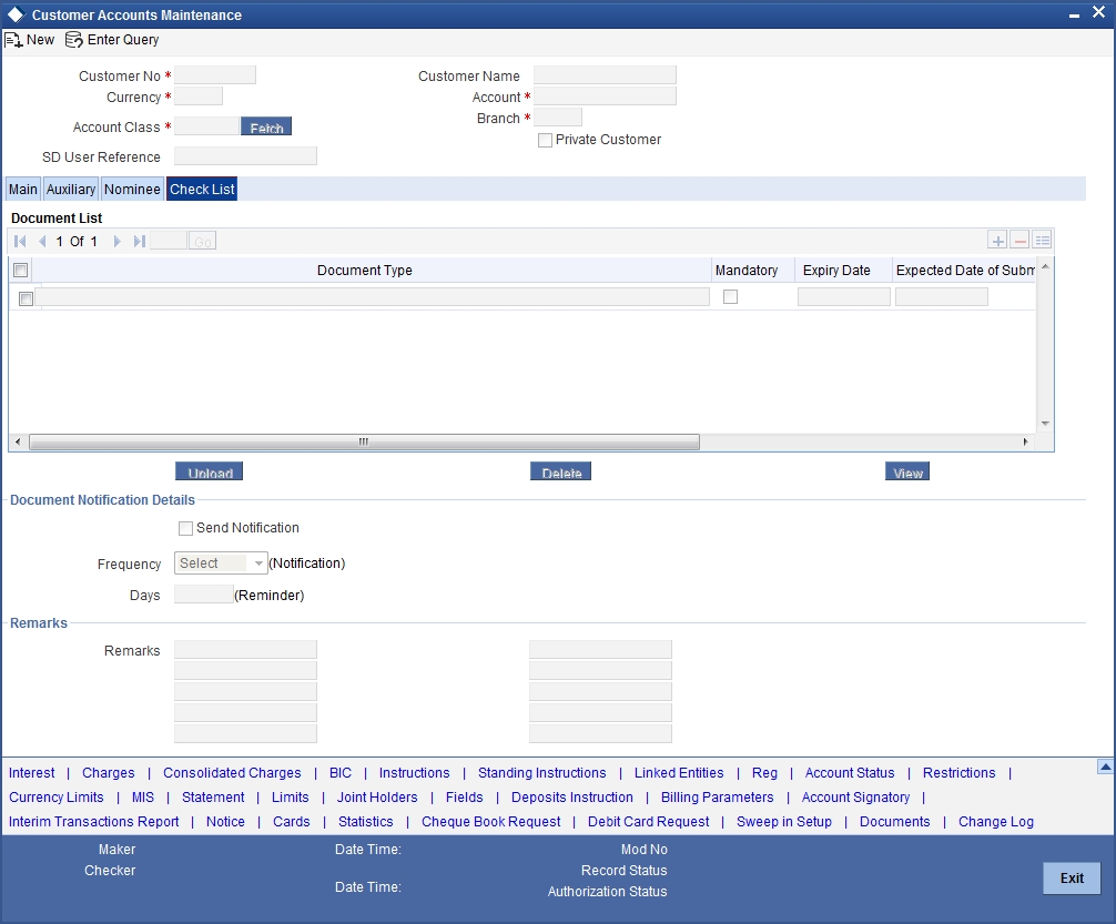

Invoke the ‘Customer Accounts Maintenance’ screen by typing ‘STDCUSAC’ in the field at the top right corner of the Application tool bar and clicking the adjoining arrow button. Click the new button on the toolbar.
Note
You can query or modify the account details of the customers whose accounts are permitted to you for the query/modification in the ‘Group Code Restriction’ screen
The ‘Customer Accounts Maintenance - Main’ screen is displayed by default when you invoke the ‘Customer Accounts Maintenance’ screen. The Branch Code of the sign-on branch is on display.
Customer No
To create an account, you need to input the CIF number of the customer for whom the account is to be created. The adjoining option list displays all the valid customer codes. You can select the appropriate one.
If the CIF number is a part of the account mask, the specified CIF should be as part of the account number as per the length of CIF in the mask.
If you have included the CIF Number of the customer as part of the Account Mask, the system automatically defaults the CIF code of the customer in the respective field. You can modify this code.
However, while defining the Account Mask in the Account Parameters section of the Bank-wide Parameters screen, if you have specified that the CIF Number should not be a part of the account mask you will have to specify the customer code manually. A list of all the valid customer codes is displayed in the available option list. You can select the appropriate.
Customer Name
The name of the customer is displayed based on the CIF ID that you have mentioned in ‘Customer No’ field.
Currency
You have to identify the currency of the customer account. A list of all the currencies maintained in the system will be displayed in the available list. You can select the currency of transaction for the respective account. If the currency of the account is not defined for the current period in the ‘Turnover Limit Maintenance’ screen, you will not be able to save the account.
Refer the section ‘Maintaining Turnover Limits’ in the chapter titled ‘Maintaining Mandatory Information’ in this User Manual for details about the ‘Turnover Limit Maintenance’ screen.
Account
You can indicate the account number of the customer. One customer can have any number of accounts.
The structure of the account number is defined in the customer account mask maintained in the Account Parameters sub-screen of the Branch-wide parameters screen. The account number can be a combination of the account class, customer code (CIF Number), serial number or currency as defined in the customer account mask.
The last constituent of the account number is always a system generated check digit (it could be alphabetical or numeric depending upon the mask defined).
You cannot alter the relative position of the constituents of customer account (as defined in the mask) while maintaining actual customer accounts.

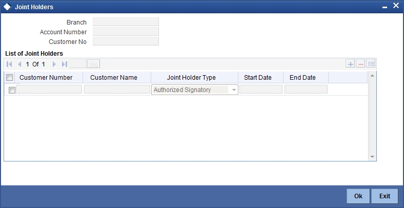

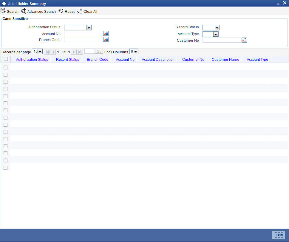

To view the joint holder’s details of an account and the mode of operation maintained at the account level, place the cursor on the Account field and press Ctrl+J. The system displays the ‘Joint Holder’ screen.
For more information on the ‘Joint Holder’ screen refer to the section ‘Joint Holder Maintenance’ in this User Manual.
Account Class
In Oracle FLEXCUBE, you can classify the customer accounts of your bank into different groups. Each group is referred to as an account class and is maintained in the ‘Account Class Maintenance’ screen. For each class, you have to define certain common attributes applicable to all accounts in the particular class.
While maintaining a specific account you have to identify the class to which the particular account belongs. You can select the appropriate account class from the list of all the valid account classes maintained in the system. Account classes that have surpassed their end date (expired) will not be displayed in the option list.
If the account class is a line account, then the system runs a check on whether the account is credit and debit blocked. If the account is not credit and debit blocked, then the system displays an override message as follows ‘Line Account should be Credit and Debit blocked’.
Refer the chapter ‘Maintaining Mandatory Information’ in the Core Entities User Manual for details about maintaining account classes.
Fetch
Fetch button is used to fetch the account number. The system will fetch the account number if the following ways:
Branch Code
The system displays the branch code of the sign on branch. If the you have Multi Branch Access Rights, system allows you to select the branch where the account is to be created.
Note
The branch selection option list will display all the active branches, to which the user has access.
SD User Reference
The system displays the SD user reference for the account; however, this is not applicable for CASA.
Private Customer
The system defaults whether the customer is private or not from the customer screen. You cannot modify this field.

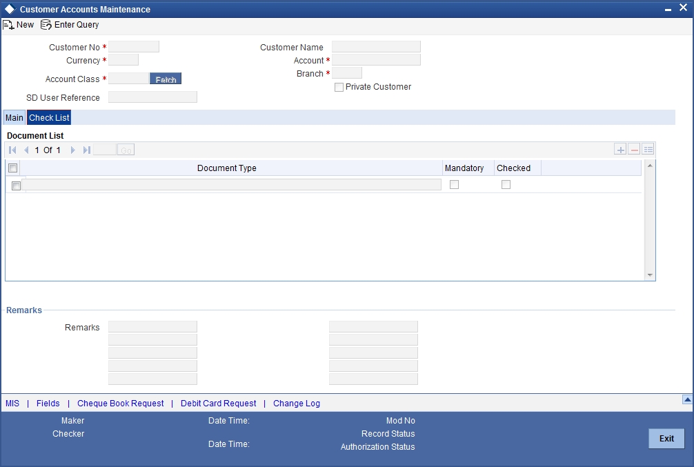

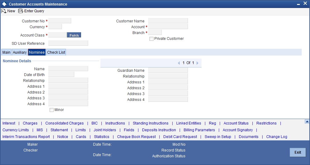

Details maintained in this screen are classified into four broad tabs and are discussed in detail in the subsequent sections:
| Tab | Remarks | ||
| Main | Here you maintain the main attributes of each customer account like the account number, customer code, the account class, account currency, type of account - single or joint, account status, other statuses applicable, Cheque Book preferences etc. | ||
| Auxiliary | Under Auxiliary you can view other details like provisioning etc. | ||
| Nominee | Nominee details are maintained under Nominee head. | ||
| Check List | Document details like document type, expiry date, expected date of submission and so on are maintained under Check List. |

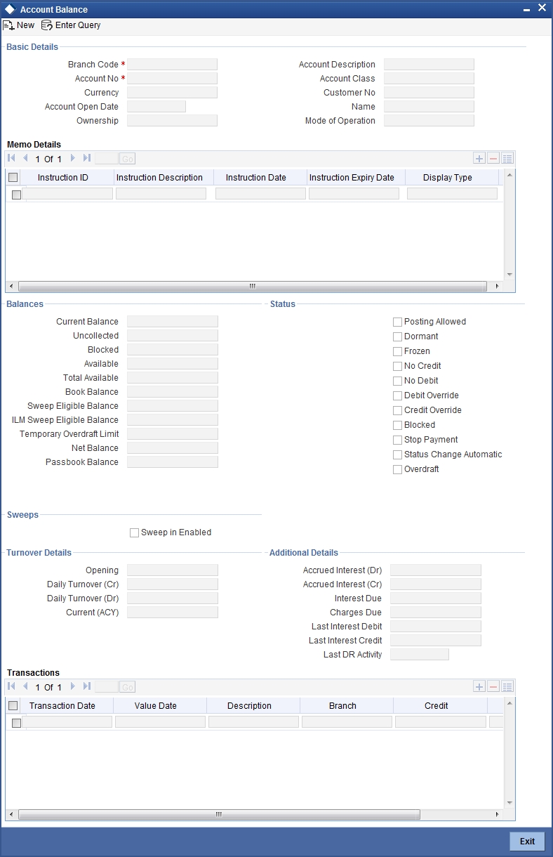

In the Customer Accounts Maintenance - Amounts and Dates screen you can view all financial details of this customer’s account along with the details of the previous debit or credit activities. However, access to all financial information of an account can be restricted for any user. The financial details of an account include the account balance, the sweep eligible balance, the uncleared debit and credit balances, the debit and credit turnover, and the interest details. The turnover limit details of an account include the current financial period, currency, utilized and unutilized limit balances.
Click ‘Amounts and Dates’ button in the Customer Accounts Maintenance screen.
The total available balance displayed by the system includes the initial funding amount and unutilized line amount (in case the customer enjoys an OD limit).
In the Amounts and Dates screen, you can view the outstanding debit interest and/or charges due on the account, as on the current date.
You can also view the amount that can be withdrawn against uncollected funds, on the account.
The System computes and displays the following
Click ‘F11’ to compute sweep eligible balance. Based on the available balance, an authorizer in a bank authorizes debit transaction on primary source CASA account which has sweeps arrangement in place. Click ‘Details’ button to view the details
Accrued interest (Dr/Cr) shows the amount accrued till date on the account.
System displays the outstanding interest due & charge due in these fields. If the check box Liquidation Using Receivable is checked at the account class level and if the account has insufficient balance, then system debits interest and charges from the receivable GL and the same will be displayed in these fields.
When this branch is under EOD processing, the inter-branch transactions originated from other branches are tanked. The funds are made available automatically after BOD and till such time they are treated as unposted items.
You can view the account balance status with respect to the turnover balance limit set for the financial period. You can view the financial period, currency, total deposited amount and the permissible limit for deposits. The period and limit details are inherited from the limit code associated with the parent account class.
During every credit transaction on the account, the system updates the limit utilization and checks the balance amount against the permissible threshold. On account of a transaction, if the balance breaches the limit threshold, the system will display an override message.
You can view the component-wise outstanding amounts in ACY and the component-wise oldest outstanding dates for overdraft accounts.

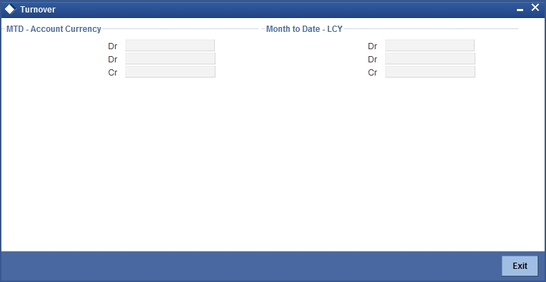

In the Customer Account - Turnover Amounts screen you can view the total turnover of this customer account from the first date of this month to the current day’s system date. Also, you can view the accumulated interest associated with debit or credit transactions after the last liquidation.
To view the turnovers for the account, click the ‘Turnover’ button. The Customer Accounts - Turnover Amounts screen is displayed.
After maintaining the required details, you can return to the Amounts and dates screen.

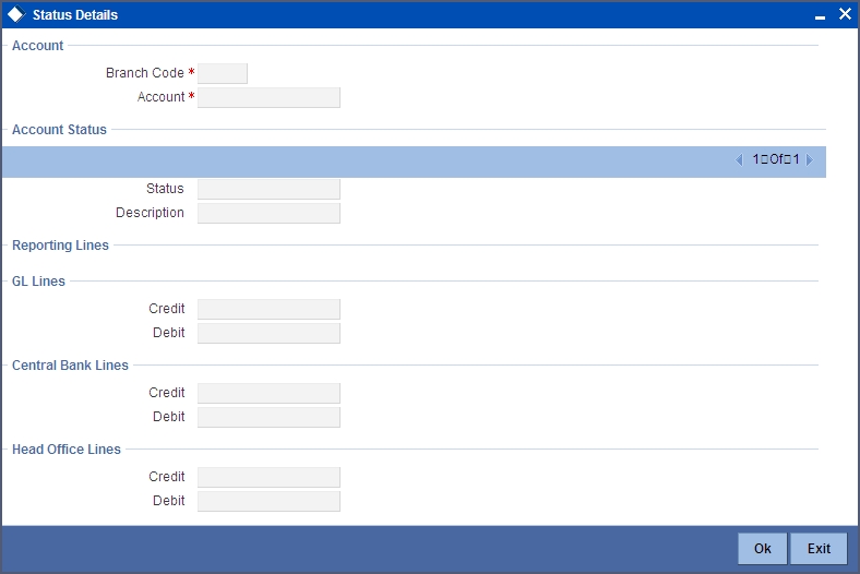

Status Details
The account status reflects the status of the account. The account may have a No Credit or No Debit order issued against it or a Stop Payment order or it may have been frozen for some reason and therefore dormant.
While posting transactions to the customer account, the system checks the status of the account before the entry is processed. If the status of the account is dormant, then the system will display an override message indicating the same.

First Nominee
You can nominate two persons who would have the right to the balances in your account after the account holder’s demise
Subsequent to the account holder, the first nominee is called to claim the balances in the account. If the first nominee is no more or is missing then the second nominee is called upon to claim the balances in the account.
Second Nominee
You can nominate two persons who would have the right to the balances in your account after the account holder’s demise.

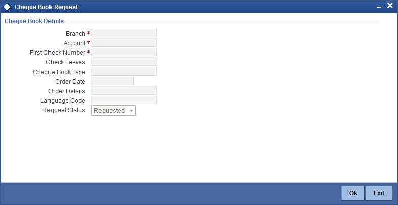

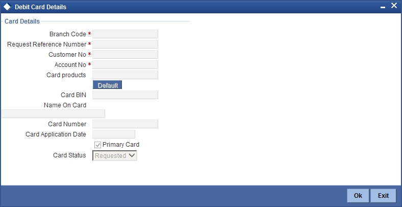

Auto Cheque Book Request
Check this box if you want the system to create a request for the cheque book automatically, for the account during account creation.
When you check this box, the system allows you to capture cheque book request details in the Cheque Book Request screen, as part of account creation.

Auto Debit Card Request
Check this box, if you want the system to create a request for the debit card automatically, for the account during account creation.
When you check this box, the system allows you to capture debit card request details in the Debit Card Request Details screen, as part of account creation.

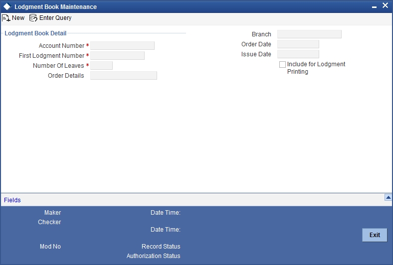

Lodgement Book (Deposit Slip Book)
If you have allowed the use of lodgment books for an account class, this specification is defaulted for all customer accounts that use such a class. You can change the Account Class default and make the required specification.
If you wish to allow orders of lodgment books for individual customer accounts, you can indicate so, in the Customer Account Maintenance screen, by selecting the Lodgment Book option.

Dormant
The system updates this status for an account based on the dormancy days specified in the Account Class Maintenance screen
Frozen
If you have frozen a customer account in the ‘Customer Information Maintenance – Basic’ screen the accounts gets frozen. For instance, at the behest of a court order, the status of the account is reflected here in the ‘Customer Accounts Maintenance’ screen.
Posting Allowed
The system checks or unchecks this check box based on the value maintained at Account Class level.
This check box facilitates Inter-branch Accounting through Entity/Accounts instead of GLs. The accounts maintained for these Inter-Branch transactions are used only for posting system generated Inter-Branch entries and not for any direct posting using ‘Journal Entry’ or Teller Transaction screens.
Status Change Automatic
This specification will be defaulted from the account class to which the account belongs. However, you have the option of changing it at the customer account level. If you check this option, the status of the account will be changed automatically by the system as per the conditions maintained in the ‘Status Rule Definition’ screen (invoked from the Account Class Maintenance screen). If you do not select this option, you have to change the status manually through the ‘Manual Status Change’ screen.
For details on conditions maintained in the ‘Status Rule Definition’ screen, refer the chapter ‘Maintaining Mandatory Information’ in the Core Entities user manual.
Overdraft
The system displays a check in the check box if the customer account has overdraft facility. The system checks or un-checks the check box based on the information available in Account Class Maintenance.
Note
If you want to amend any of above statuses, you can do only via 'Manual Status Input' screen.
Status
At the time of maintaining a customer account for the first time, the account status will be ‘NORM’ (Normal) by default. The ‘Status Since’ field will display the current system date i.e. the date on which the account is maintained in the system. The system will update the status whenever a status change occurs. Therefore, at any point of time, this field will display the current status of the account. The ‘Since’ field will reflect the date on which the account moves to the current status.
Subsequently, the system will default the value of CIF Status as available in the ‘Customer Maintenance’ screen. This status is the worst status among all the loans, savings accounts and current accounts for the customer in the current branch.
Note
This is done if you have opted for status processing at the ‘Group/CIF’ level as part of your branch preferences.
Since
The date on which the status of the account is changed to the current status is displayed here
Propagate Reporting Details
This field indicates whether the reporting lines defined for status movement, for the account class that this account reports to, must also be applicable to it.
The following GL’s are defined in the Account Class Maintenance for posting account balances when a status movement occurs on any accounts belonging to the account class:
When you select this option, the GL’s maintained for the account class will be applicable to the customer account you are defining in this screen. The reporting lines will be propagated to the account whenever a status change occurs.
If you do not want the account class details to be propagated to the account as well, you have the option of maintaining the status codes and the reporting lines exclusively for an account. You can achieve this through the ‘Status Details’ screen. Click the ‘Account Status’ button in the Customer Accounts Maintenance screen to invoke it.
Account Auto Closed
The system checks this box to indicate that the account has been closed automatically through the auto account closure feature. You will not be allowed to modify this.
Account Derived Status
The system displays the current status of the account here. This is applicable for CASA accounts (current accounts and savings accounts)

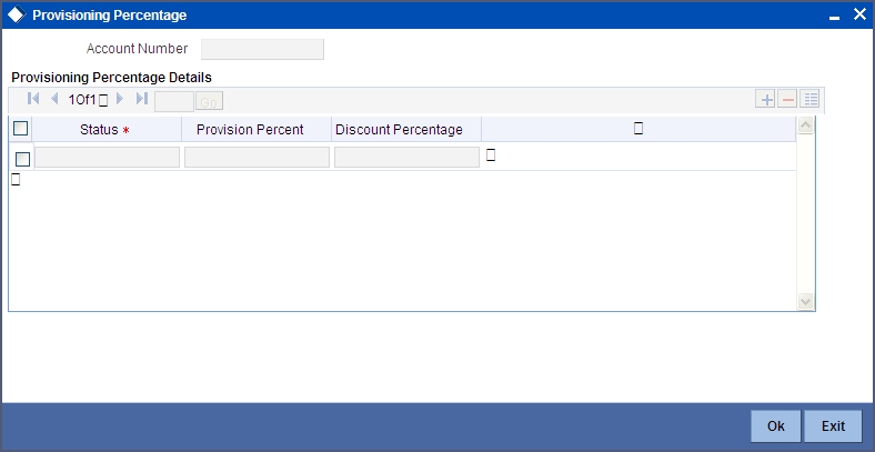

An account inherits the provisioning parameters defined for the account class it uses. You can change the defaulted parameters and make the following specifications, as required, in the Provision Details section of the Customer Account Maintenance screen:
Auto Provisioning Required
You can indicate whether the provisioning for bad loans in corporate loans and deposits module is applicable for the account. If you indicate so, the provisioning batch, when executed, picks up the account for provisioning.
Exposure Category
If the logic for deriving the exposure category of the CIF or customer group to which the customer belongs, based on the total exposure, has been maintained in the Exposure Type Category Linkage maintenance, then the exposure category of the account is identified. If no logic has been maintained, you can specify the exposure category in the Customer Account Maintenance screen.
Risk Free Exposure Amount
You can indicate the risk-free collateral amount that would be used in computing the provisioning amount for the account.
Provisioning Currency
You can indicate the currency in which the provisioning amount must be calculated – either account currency or local currency. This specification is defaulted from the preferences for the account class used by the account, and you can alter it if necessary.
In addition to the provisioning preferences listed above, you must also indicate the applicable provisioning percentage and the discount percentage details in the Provision Percentages screen that you can invoke by clicking on the ‘Provisioning Percentage’ button in the Provisioning Details section of the ‘Customer Account Maintenance’ screen.
Account Number
The system displays the customer account number
Status
Specify the status of the account for which you are maintaining provisioning percentages. The adjoining option list displays all valid status codes maintained in the system. Select the appropriate one.
Provision Percent
If you wish to indicate a specific provisioning percentage to be applicable for the account, you can specify it in the Provisioning Percentage screen.
If you do not specify any provisioning percentage, the provisioning batch picks up the applicable provisioning percentage from the Exposure Provisioning Percentage Maintenance, for the exposure category of the account and the account status.
Discount Percentage
If you wish to indicate a specific discount percentage to be applicable for the account, you can specify it in the Provisioning Percentage screen.
If you do not specify any discount percentage, the provisioning batch picks up the applicable discount percentage from the Exposure Provisioning Percentage Maintenance, for the exposure category of the account and the account status.

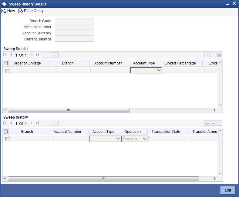

Enable Sweep In
The system checks or unchecks the check box based on the status maintained at Account Class Maintenance level.
Enable Reverse Sweep in

Click ‘Nominee’ tab in the ‘Customer Accounts Maintenance’ screen in order to capture nominee details for the account.
Specify the following details:
Name
Specify the name of the nominee of the account.
Date of Birth
Specify the date of birth of the account nominee.
Relationship
Specify the relationship that the nominee shares with the primary account holder.
Address 1 – 4
Specify the address of the nominee.
Minor
Check this box to indicate that the nominee is a minor (less than 18 years old).
Guardian Name
In case the nominee is a minor, specify the name of the nominee’s guardian.
Relationship
Specify the relationship that the nominee shares with the guardian.
Address 1 – 4
Specify the guardian’s address.
Click the ‘Check List’ tab from the ‘Customer Accounts Maintenance’ screen to capture the details of document types that are to be maintained.
Document Type
Specify the document type. The adjoining option list displays all the document types that are maintained in the system. You can select the appropriate one.
Mandatory
Check this box to indicate that the document specified here is mandatory.
Expiry Date
Specify the expiry date of the document provided by the customer.
Note
Expiry date will always be greater than ‘Expected Date of Submission’ and ‘Actual Submission Date’.
Expected Date of Submission will always be greater than current date.
Specify the expected date on which the customer is accepted to submit the required documents.
Actual Date of Submission
System displays the actual date on which customer has submitted the required documents.
Document Reference
System defaults the document reference here.
Checked
Check this box to indicate that the received documents are acknowledged.
Note
You cannot save and authorize an account if the mandatory documents are not confirmed as ‘Checked’.
Upload
Click on this button to upload the selected document type.
Delete
Click on this button to delete the selected document.
View
Click on this button to view the selected document.
System defaults notification details from the ‘Account Class Maintenance’ screen.
Send Notification
This check box indicates whether to send notifications or reminders for not submitting the mandatory documents.
Reminder Frequency (Notification)
System defaults the frequency of notification to be sent. The frequency can be one of the following:
Notes
The check box ‘Send Notification’ is checked in Account Class Maintenance’ screen.
The account status is active and authorized.
The mandatory documents are not submitted.
Days (Reminder)
System defaults the number of days left for the expiry or submission due date of the documents for sending the reminder.
System will send the following reminders:
Note
If there are more than one notifications or reminders of the same message type for which the notification schedule date falls on the same day for the same account, a single notification will be sent which will have the details of all the related documents.
Remarks 1 to 10
Specify the additional information, if required.
You can capture additional details for the account by clicking the following buttons in the ‘Customer Accounts Maintenance’ screen:
| Button | Function | ||
| Interest | This invokes the ‘IC Special Conditions Maintenance’ screen. | ||
| Charges | This invokes the ‘Account level charges conditions’ screen. | ||
| Consolidated Charges | This invokes the ‘Account Level Consolidated Charges Conditions’ screen. | ||
| BIC | This invokes the ‘Authorized SWIFT BICs for Customer Account’ screen. | ||
| Instructions | This invokes the ‘Account Operating Instructions Maintenance’ screen. | ||
| Standing Instructions | This invokes the ‘Instruction Diary Summary’ screen. | ||
| Linked Entities | This invokes the ‘Linked Entities’ screen. | ||
| REG | This invokes the ‘REG Details’ screen. | ||
| Account Status | This invokes the ‘Status Details’ screen. | ||

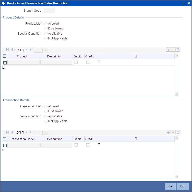

| Restrictions | This invokes the ‘Products and Transaction Codes Restriction’ screen. | ||

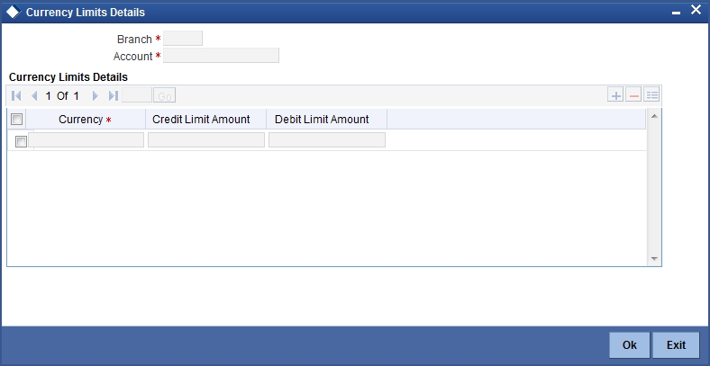

| Currency Limits | This invokes the ‘Limits’ screen. | ||
| MIS | This invokes the ‘Management Information System’ screen. | ||

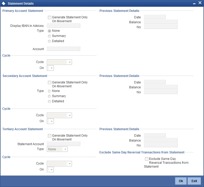

| Statement | This invokes the ‘Statement Details’ screen. | ||

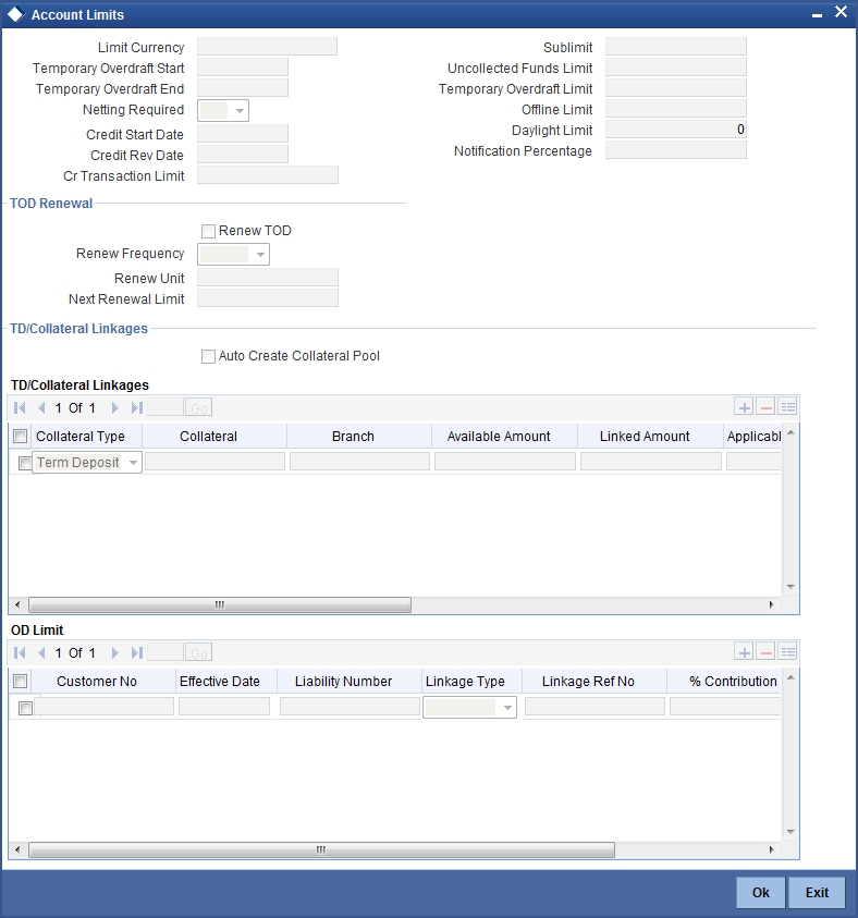

| Limits | This invokes the ‘Account Limits’ screen. | ||
| Joint Holders | This invokes the ‘Joint Holder screen. | ||
| Fields | This invokes the ‘UDF’ screen. | ||

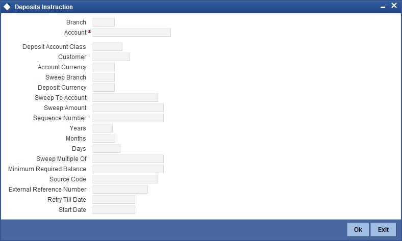

| Deposits Instruction | This invokes the ‘Deposits Instruction’ screen. | ||

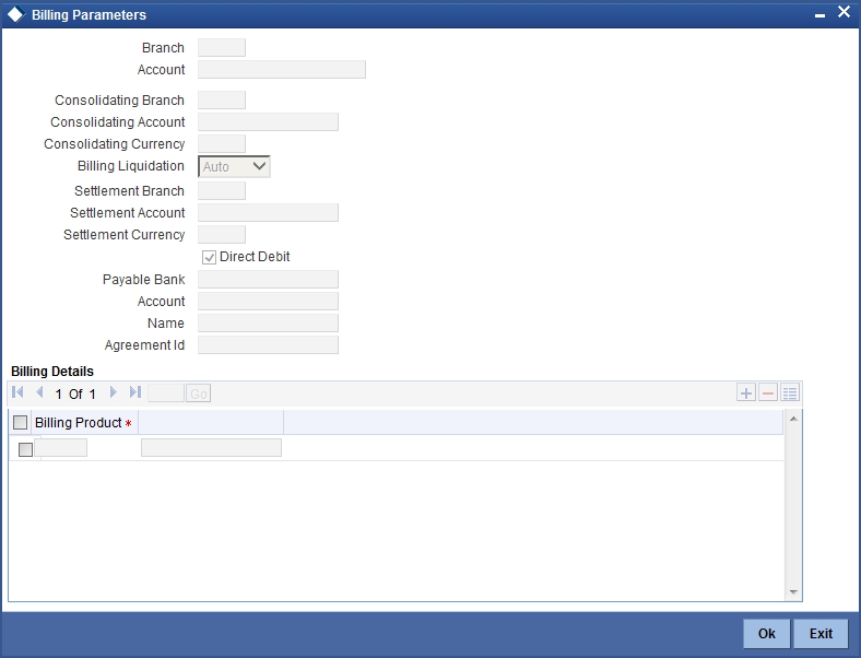

| Billing Parameters | This invokes the ‘Billing Parameters’ screen. | ||

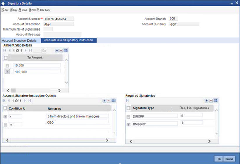

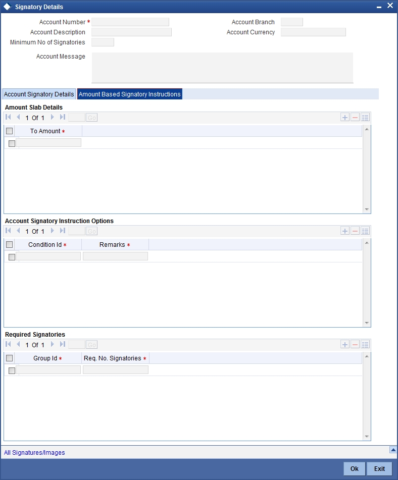

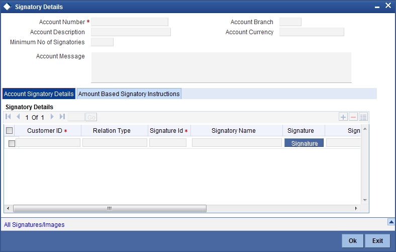

| Account Signatory | This invokes the ‘Signatory Details’ screen. | ||

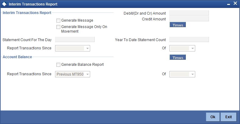

| Interim Transactions Report | This invokes the ‘Interim Transactions Report’ screen. | ||

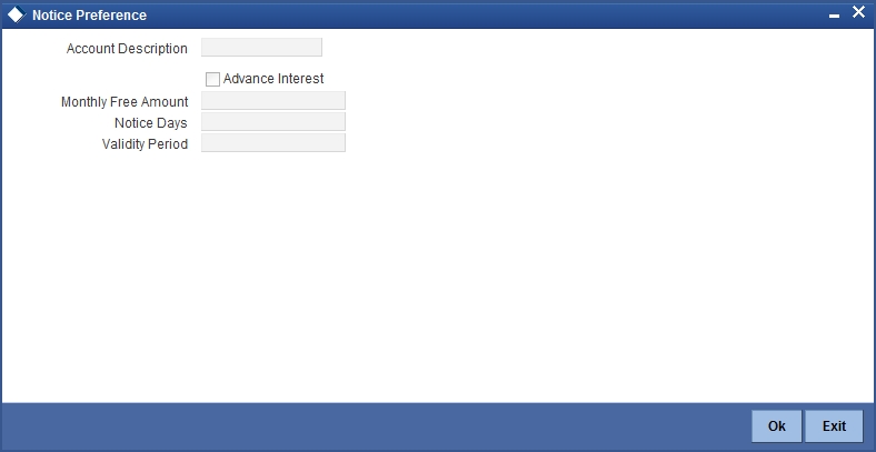

| Notice | This invokes the ‘Notice Preferences’ screen | ||

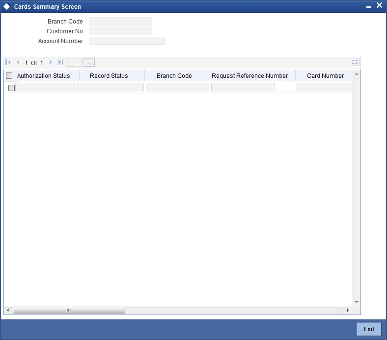

| Cards | This invokes the ‘Cards Summary’ screen. | ||

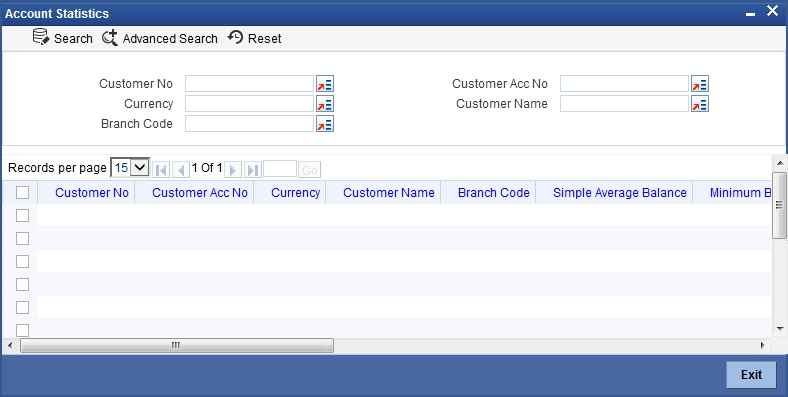

| Statistics | This invokes the ‘Account Statistics’ screen. | ||
| Cheque Book Request | This invokes the ‘Cheque Book Request’ screen. | ||
| Debit Card Request | This invokes the ‘Debit Card Details’ screen. | ||

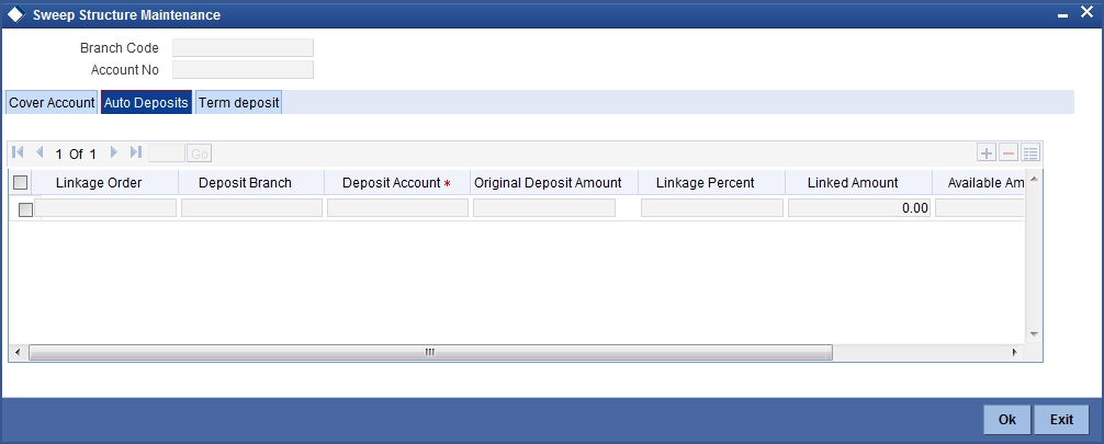

| Sweep In Setup | This invokes the ‘Sweep Structure Maintenance’ screen, | ||
| Documents | This invokes the ‘Document Upload’ screen, | ||

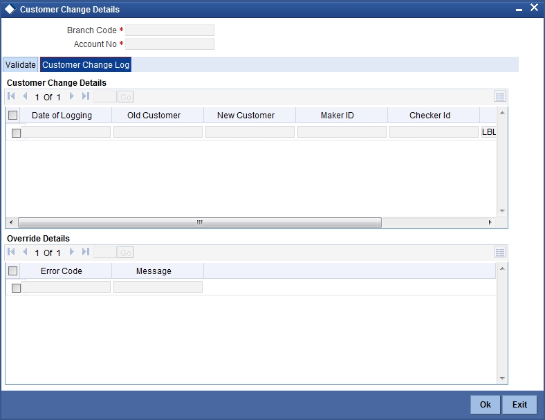

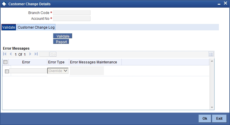

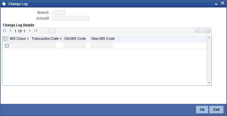

| Change Log | This invokes the ‘Customer Address Change Log’ screen. |

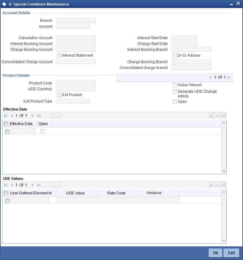

You can capture details of interest for the account, using the ‘IC Special Conditions Maintenance’ screen. Click the ‘Interest’ button in the ‘Customer Accounts Maintenance’ screen to invoke this screen.
Interest Booking Branch
By default, the customer’s account in the current branch will be displayed in this screen (in the Interest/Charge Booking Account and Interest/Charge Booking Branch fields). However, you have the option of booking interest/charge to a different account belonging to another branch also. You can select the Interest/Charge Booking Branch from the option-list available. ]The accounts maintained in the selected Booking Branch will be available in the option-list provided for Interest/Charge Booking Account. You can select the account from this list. Interest/Charge will be liquidated into the selected account.
Interest Booking Account
You can select the accounts for booking interests on transactions processed at your bank.
At the time of creating an IC product, if you have maintained the booking account type as Interest (in the ‘Interest and Charges – Product Definition’ screen), the Interest will be liquidated into the Interest Booking account. By default, the customer’s account in the current branch will be displayed in this screen (in the ‘Interest Booking Account’ field). However, you have the option of booking interest to a different account belonging to another branch also. The accounts maintained in the selected Booking Branch will be available in the adjoining option list. You can select the appropriate account. Interest will then be liquidated into the selected account.
Calculation account
Specify the calculation account. When you specify a calculation account, then all balances and turnovers for the specified account are clubbed with the balances and turnovers for the combined account for calculation purposes.
By default, the customer’s account in the current branch will be displayed in this screen (in the Interest/Charge Booking Account and Interest/Charge Booking Branch fields). However, you have the option of booking interest/charge to a different account belonging to another branch also. You can select the Interest/Charge Booking Branch from the option-list available. The accounts maintained in the selected Booking Branch will be available in the option-list provided for Interest/Charge Booking Account. You can select the account from this list. Interest/Charge will be liquidated into the selected account.
You can select the accounts for booking charges on transactions processed at your bank
At the time of creating an IC product, if you have maintained the booking account type as Charge (in the ‘Interest and Charges – Product Definition’ screen), the charge will be liquidated into the Charge Booking account. By default, the customer’s account in the current branch will be displayed in this screen (in the ‘Charge Booking Account’ field). However, you have the option of booking charge to a different account belonging to another branch also. The accounts maintained in the selected Charge Booking Branch will be available in the adjoining option list. You can select the appropriate account. Charges will then be liquidated into the selected account.
Interest Statement
You can also indicate if you would like to generate an interest statement for the account. The Interest Statement will furnish the values of the SDEs and UDEs and the interest rule that applies on the account.
Consolidated Charge Branch
By default it will be same as the current branch. However you can select the branch of the consolidated charge account from the adjoining option list.
Consolidated Charge Account
The consolidated charge will be a group of charge products that are linked to one IC product. Select the account that is identified as the master account for collecting the consolidated Fall Below Fee.
The Fall Below Fee is a kind of fee that is charged if sum of average monthly balance of all the accounts is less than the minimum required balance.
Note
Dr Cr Advices
You can indicate whether you want to generate an interest liquidation advice for a customer account. Check the ‘Debit/Credit Advices’ box to indicate that the system must generate payment advices when interest liquidation happens on an account. The advices are generated in the existing SWIFT or/and MAIL format. No advices will be generated if you leave this box unchecked.
The preference you have made in the Customer Account Class screen will be defaulted here. However, you can choose to change your preference to generate or suppress these Advices.
Interest Start Date
For the account for which you are defining special conditions, you must specify the date from which you would like to apply interest. Interest for this account will be calculated according to the special conditions that you define subsequently.
Charge Start Date
For the account for which you are defining special conditions, you must specify the date from which you would like to apply charges. Charges for this account will be calculated according to the special conditions that you define subsequently.
By default, charges on an account would be applied when the free banking period (if any) elapses. This means that the Charge Start Date is arrived at by the System by adding the Free Banking Period days (if any, specified for the account class used by the account) to the Account Opening Date. If no Free Period has been indicated for the account class used by the account, the Charge Start Date is defaulted to the Account Opening Date (that is, charges on the account would be applied right from the account opening date) and displayed in the Special Conditions Maintenance screen.
You can override the default Charge Start Date and specify the desired start date for charge application.
Product
To calculate interest for an account, you must apply an interest product on the account. To recall, every interest product that you create is linked to an interest rule. The logic to calculate interest is built into an interest rule. When you apply an interest product on the account, interest for the account will be calculated according to the interest rule definition.
For the account for which you are defining special conditions choose the product(s) that you wish to apply. To recall, you can define a Special Condition for an account only if the account class of the account has a General Condition defined for the product. Thus, the picklist from where you select the product for which you want to define a Special Condition will contain products that satisfy one of the following conditions:
The interest rule that is linked to the product(s) will determine the interest that is applied on the account.
You may want to apply more than one interest product on an account. For example, you may want to pay credit interest on the credit balance maintained in a current account and levy a debit interest if the account lapses into a debit balance. In order to achieve this, you would have to apply two products (one defined for credit interest and another defined for debit interest). In this screen, you can choose the interest products that you want to apply on an account.
Note
The UDE currency, defined for the product (in the Interest Product Preferences screen) that you apply on the account, is displayed. Note that the UDE values that you specify for the account subsequently will be taken to be in this currency.
You can opt to generate an advice, for the benefit of the customer, when the values of the UDEs defined for the interest rule change.
Generate Rate Change Advice
Check the box ‘Generate UDE change advice’ at account level, to indicate that interest rate change advice has to be generated for the account at EOD. System generates interest rate change advices for Customer Accounts and Savings accounts when the interest rate changes as part of EOD. For those accounts, when interest rate changes the details are handed off for rate change advice generation and the same is generated in the pre determined swift format as per MT 935.
The advice tag used for interest rate change is RTCHG_ADVICE.
The advice format for interest rate change as per MT935 is given below:
| Status | Tag | Field Name | Content/Options | Remarks | |||||||||
| M | 20 | Transaction Reference Number | 16x | Unique Transaction Reference Number generated by system | |||||||||
| O | 23 | Further Identification | 16x | Specifies the kind of interest rate | Field 23 populated as per account class type. | IF Class Type is S or Y Tag will be populated with Currency+’DEPOSIT |
If Class Type is C | Tag will be populated with Currency+CURRENT | |||||
| O | 25 | Account Identification | 35x | Customer Account Number for which advice is generated | |||||||||
| M | 30 | Effective Date of New Rate | 6!n | Effective date of New interest rate in YYMMDD format | |||||||||
| M | 37H | New Interest Rate | 1/12d | Indicator (C or D depending on whether new interest rate is a credit or debit rate) & New interest rate in decimal comma format. | |||||||||
| O | 72 | Sender to Receiver Information | 35x | ||||||||||
| M = Mandatory, O = Optional | |||||||||||||
A rule identifies the method in which interest or charge is to be calculated. An interest rule consists of System Data Elements and User Data Elements.
When you apply a product on an account (while defining special conditions for it), interest for the account will be calculated according to the interest rule that you have linked to the product. That is, you merely define the following:
You now have to specify the numeric values of all the UDEs that you identified for the interest rule. The value that you specify here will be used to calculate interest for the account.
All the UDEs that you have identified for the rule (to which the product is linked) will be displayed here. The UDEs that are displayed here can be of four types. They are:
The interest that you charge on a debit balance is an example of a debit rate. The interest that you charge on a credit balance is an example of a credit rate.
A User Data Element will be an amount under the following circumstances:
When building an interest rule you may have indicated the UDE to be a number if the interest or charge is based on the number of transactions or the number of account statements. A UDE under this category can also be used to store a numerical value that may be used in a formula.
Now, for each of the UDEs that are displayed, you must specify the values individually. If the type of UDE that you have identified for the rule is a ‘Rate’ element, you can either specify a Rate Code or enter a “value” for the Rate element.
If you specify a Rate Code for the UDE, the value that you have maintained for the rate code will be picked up while calculating interest. However, if you choose to enter a “spread” for the Rate Code, the appropriate value will be computed. (A “Spread” is a positive or negative value that you add or deduct to the value specified for the Rate Code). If you do not specify a spread, the rate maintained for the Rate Code will be picked up.
If the type of UDE is an amount, the value that you enter will be in the currency that you specified in the UDE Amounts Currency field (in the Interest Product Preferences screen). If you specified the UDE amounts currency as the local currency and the account is in a foreign currency, the currency conversions will be on the basis of the mid rate for the day.
Note
The UDE values that you specify here will only be applied to this account.
The ‘Customer Credit Rating’ field at the Customer level will be used as a SDE CUSTOMER_CREDIT_RATING for defining status change rules. This will also be available for provision rule definition at the CL product level.
Waive Product
Check this box if you want to waive of a particular interest or charge product that has been specified.
Open
More than one product may be applicable on an account class at the same time. You can temporarily stop applying a product on an account class by ‘closing’ it
You can achieve this by un-checking the box ‘Open’. The product will cease to be applied on the account class. You can make the product applicable again by checking the ‘Open’ box.
Effective Date
The ‘Effective Date’ of a record is the date from which a record takes effect. You can maintain different values for a UDE, for different effective dates, for an account. When interest is calculated on a particular day for an account with special conditions applicable, the value of the UDE corresponding to the date will be picked up.
Typically, you would want to open records with different Effective Dates if the values of UDEs vary within the same liquidation period.
Integrated LM Product
The system defaults the Integrated Liquidity Management flag based on the IC product associated with this account (Please refer Integrated Liquidity management for more information).
IL Product Type
The IL product type will be defaulted to pool lead/pool re-allocation based on the ILM product maintained at IC product level.
Specify the variance in the interest rate. This is the variance alone. This value can be modified at any point of time.

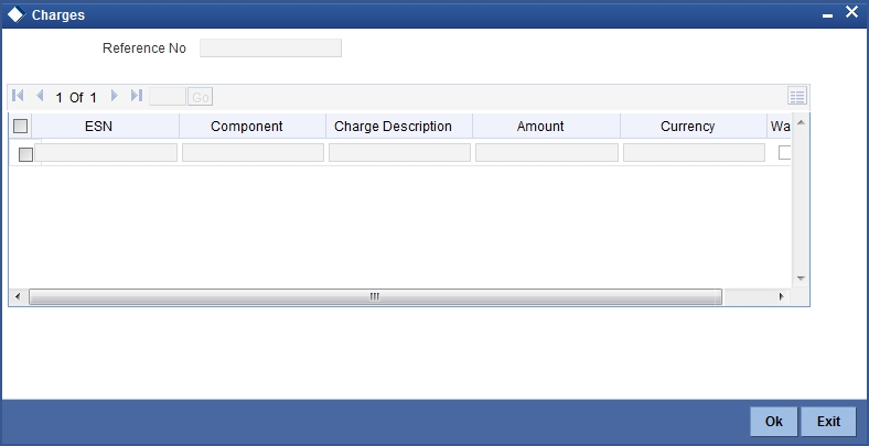

You can capture details of charges for the account, using the ‘Account level charges conditions’ screen. To invoke this screen, click the ‘Charge’ button in the ‘Customer Accounts Maintenance’ screen.
Branch Code
The Branch Code to which the account belongs (for which you are defining special conditions) is displayed in this field.
Account
The Account number of customer (for which you are defining special conditions) is displayed in this field.
Note
You can click the ‘Default’ button to default the Charge Products and the corresponding details applicable for the account. You can then modify these values to define the special conditions.
Product
The system defaults a product when you click the ‘Default’ button at the time of account creation. You must modify it to identify the Charge product using which the applicable charges would be collected.
Currency
The charges would be collected in the currency defined for the selected charge product, and this currency is displayed on the screen.
Minimum and Maximum
You must indicate the charge amount range, representing the minimum and maximum charge that can be applied for the account.
Free Items
You must indicate the number of free items for which the customer will not be charged. The number of free items is derived based on the charge basis defined for the charge product in the IC module.
Open
By default, each charge consolidation charge setup that you set up is enabled and active. You can also disable the setup by checking the ‘Open’ box.
Waive Charges
You can choose to waive charges for an account.

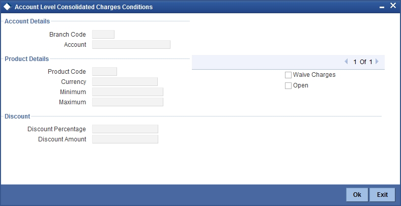

You can capture details of consolidated charges for the account, using the ‘Account Level Consolidated Charges Conditions’ screen. To invoke this screen, click the ‘Consolidated Charge’ button in the ‘Customer Accounts Maintenance’ screen.
Branch
Product
You must identify the consolidated charge product using which the applicable charges would be consolidated. The charges would be consolidated in the currency defined for the selected consolidated charge product, and this currency is displayed on the screen.
When you opt for a consolidated charge product, all the consolidated charge parameters defined for the selected product are defaulted to the account for which the product has been linked. You can change the default in respect of the following parameters:
Currency
Minimum
You must indicate the minimum charge that can be applied for the account.
Maximum
You must indicate the maximum charge that can be applied for the account.
Open
By default, each charge consolidation charge setup that you set up is enabled and active. You can also disable the setup by checking the Open box.
Waive Charges
You can choose to waive consolidated charges for an account.
Discount Amount
In this field, you can indicate the flat discount amount, if any, which would be applicable for the consolidated charge calculated for the account. After the discounting has been applied, the Maximum and Minimum validations are performed.
Alternatively, the discount, if any, which is applicable, can be specified as a percentage of the calculated consolidated charge amount.
Discount Percentage
You can indicate the discount percentage, if any, which would need to be applied to the calculated charge. After the discounting has been applied, the Maximum and Minimum validations are performed.
The discount, if any, which is applicable, can also be specified as a flat discount amount.

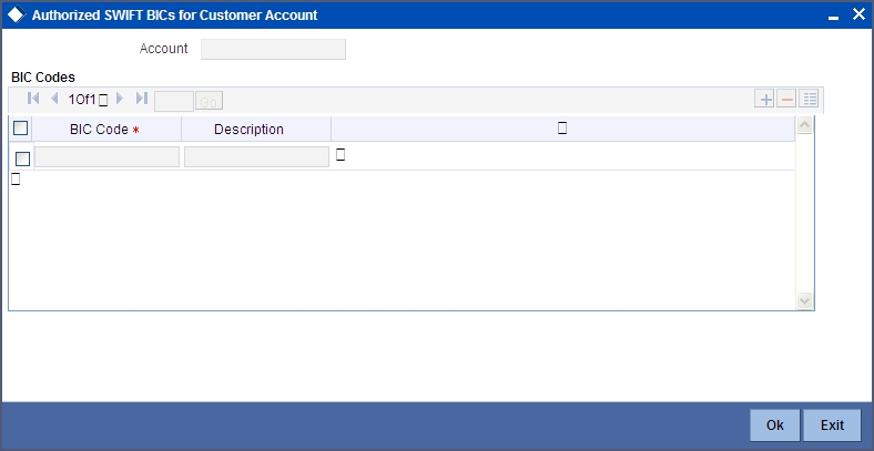

You can capture details of all SWIFT BIC that should be allowed for a customer account, using the ‘Authorized SWIFT BICs for Customer Account’ screen.
To invoke this screen, click ‘BIC’ button in the ‘Customer Accounts Maintenance’ screen.
Account Number
The system defaults the account number of the customer in this field.
BIC Code
Specify the BIC here. You can choose any valid BIC maintained in the ‘BIC Code Maintenance’ screen.
Description
The system displays the description for the corresponding BIC that you have specified.

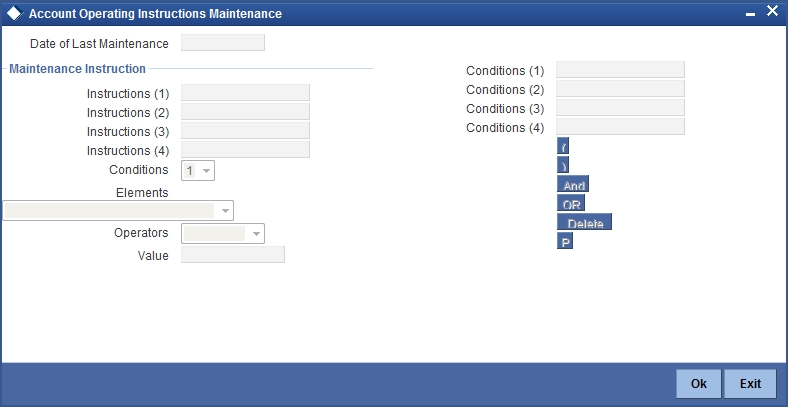

You can capture details for operating the account, using the ‘Account Operating Instructions Maintenance’ screen. To invoke this screen, click ‘Instructions’ button in the ‘Customer Accounts Maintenance’ screen.
Date of Last Maintenance
The current system date is also displayed
Instructions
Specify the instructions to be borne in mind when operating a customer account
Conditions
You can maintain the instructions using the above screen during the account opening. The maintained instructions can be viewed from the 'Account Maintenance' screen invoked from Signature Verification screen.

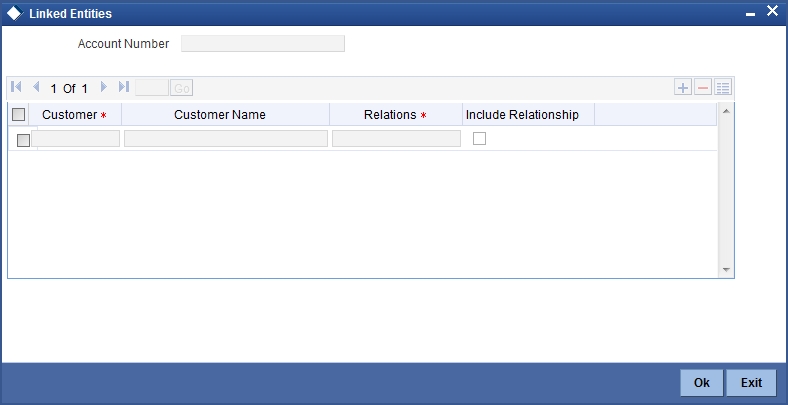

You can capture details of linked entities for the account, using the ‘Linked Entities’ screen. To invoke this screen; click the ‘Linked Entities’ button in the ‘Customer Accounts Maintenance’ screen.
Customer
Select the customer from the option list with whom you want to establish the relationship with the customer account that you are maintaining.
Description
In this field, the system displays the name of customer that you have selected in the previous field. You cannot change the description.
Relationship
You have to choose a relationship code to establish a relationship between the customer being selected and the customer account you are maintaining.
By default, the system will select the customer of the account as the Primary Holder. This is a pre-shipped relationship and you will not be allowed to change the relationship.

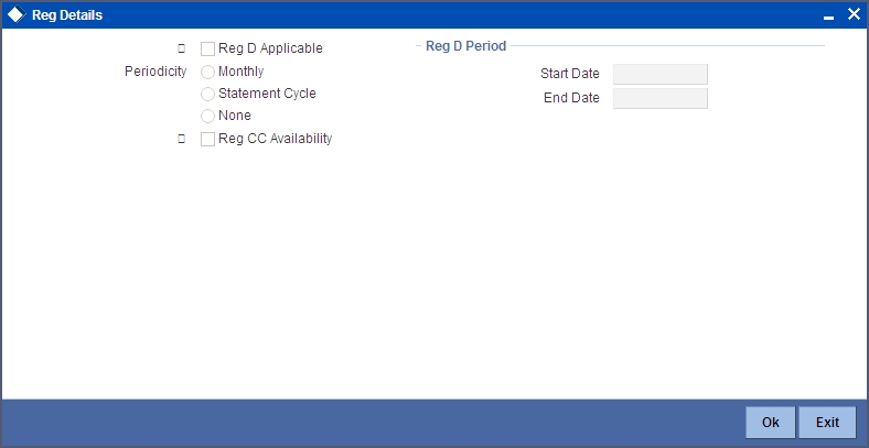

Reserve Requirements for Depository Institutions (Regulation D) is a US Federal Reserve Board regulation that limits the number of preauthorized withdrawals and transfers from a savings account or money market account. The regulation applies to all United States banking institutions offering such accounts. In consumer banking, ‘Regulation D’ often refers to §204.2(d)(2) of the regulation, which places a limit of six withdrawals or outgoing transfers per month from savings or money market accounts via several transaction methods.
The Expedited Funds Availability Act (EFA or EFAA) was enacted in 1987 by the United States Congress in order to standardise hold periods on deposits made to commercial banks and to regulate institutions' use of deposit holds. It is called as Regulation CC or Reg CC after the Federal Reserve regulation that implemented the act. Regulation CC stipulates four types of holds that a bank may place on a cheque deposit, at its discretion.
You can capture limited Regulation D and regulation CC details for the customer account, using the ‘REG Details’ screen. To invoke this screen, click the ‘REG’ button in the ‘Customer Accounts Maintenance’ screen.The screen is shown below:
Reg CC Availability
Check this box if the check deposits into this account should be considered for Regulation CC aggregation.
Specify the following details.
Reg D Applicable
Indicate whether the Regulation D limits are applicable for the account
Periodicity
If you indicate the periodicity of Regulation D applicability as ‘Statement Cycle’, the restricted transactions would be counted over the primary statement cycle defined for the customer account.
Start Date
The start date for Regulation D applicability is first set to be the date on which you mark the availability option in this screen. Subsequent to the first period, the EOD process would update the start date according to the periodicity defined.
End Date
Subsequent to the first period, the EOD process would update the end date according to the periodicity defined.
You can specify status details for the account, using the ‘Status Details’ screen. To invoke this screen, click the ‘Account Status’ button in the ‘Customer Accounts Maintenance’ screen.
Here you can capture the following details:
Branch
The system defaults the code of the current branch
Account Number
The system defaults the account number from the main screen
Status
You can select the different status codes applicable to the account, in this field. Use the Add icon to define each status and the attributes for the same. You can use the navigation icons to move from one status to the other.
On selection of the status, the associated description will be displayed alongside
Dr and Cr GL Line
Select the debit GL account, to which all debit balances within a specific account class will report to, when it moves to the status being defined. You can identify the debit GL from the list of existing GLs. Likewise, all credits within a particular account class will report to the GL account that you have identified to track credits.
Dr Central Bank Line
Specify the Central Bank line to which this account will report to, if it is in debit. This line is maintained in the ‘Reporting Lines Maintenance’ screen.
Cr Central Bank Line
Specify the Central Bank line to which this account will report to, if it is in credit. This central bank line is maintained in the ‘Reporting Lines Maintenance’ screen.
Dr Head Office Line
Specify the Debit Head Office GL to which the account will report, if they are in a debit
Cr Head Office Line
Specify the Credit Head Office GL to which this account will report, if it is running in credit.
You can specify restrictions for the account, using the ‘Products and Transaction Codes Restriction’ screen. To invoke this screen, click the ‘Restriction’ button in the ‘Customer Accounts Maintenance’ screen.
Special Condition
By default, the restrictions maintained at the account class level will be displayed here. When you define transaction code or product restriction attributes for an account itself, rather than for the account class to which it belongs, it is referred to as a Special Condition. You can apply special conditions by selecting the option ‘Special Condition Applicable’ at the account level. If you opt to define special conditions for an account the ‘restrictions’ defined for the Account Class, to which the account belongs, will NOT apply to this account. If you wish to continue with the account class restrictions, opt for ‘Special Condition Not Applicable’.
Restriction Type
Specify the restriction type here. The options available are:
Product Code
You can select the products and specify the type of transaction (Dr, Cr or both) that you would like to allow/disallow for each product. In contracts involving the selected products, the accounts would be used for processing the selected type of transaction. For instance, assume that for the account A1, you have allowed ‘Dr’ for the product ABCD. This would mean that if a Dr entry for the product ABCD is passed to the account, A1, it would go through but in case a Cr entry is passed for this product, then the system will display a message indicating that the transaction is restricted for the account.
Description
The system displays the description for the product code that which you have specified
Dr
During transaction processing, the system will validate whether any restrictions are placed on the account based on either product and/or transaction code. If you have indicated to allow Dr Transactions for the product ABCD, and attempt to post a credit entry, the system will seek an override. You can continue the transaction, despite the restrictions, by providing appropriate reasons for the same.
During maintenance or online operations, in the respective contract screens for the restricted transactions, when you specify the customer account, the system checks whether the account is restricted for the product that has been selected, or the debit/credit transaction type. If so, an override is sought when such contracts are saved.
Cr
During transaction processing, the system will validate whether any restrictions are placed on the account based on either product and/or transaction code. If you have indicated to allow Dr transactions for the product ABCD, and attempt to post a credit entry, the system will seek an override. You can continue the transaction, despite the restrictions, by providing appropriate reasons for the same.
Special Condition
Restriction Type
Transaction Code
Likewise, you can maintain restrictions for transaction codes as well
Description
The system displays the description for the transaction code that you have specified
Dr
During transaction processing, the system will validate whether any restrictions are placed on the account based on either product and/or transaction code. If you have indicated to allow debit transactions for the product ABCD, and attempt to post a credit entry, the system will seek an override. You can continue the transaction, despite the restrictions, by providing appropriate reasons for the same.
Cr
You can specify restrictions for the account, using the ‘Currency Limits Details’ screen. To invoke this screen, click the ‘Currency Limits’ button in the ‘Customer Accounts Maintenance’ screen.
Account Number
The system displays the customer account for which PC limits are being maintained
Currency
Specify the currency in which the auto exchange limits should be maintained. The adjoining option list displays the currency codes maintained in the system. You can choose the appropriate one.
Cr Lmt Amt
Specify the credit limit amount in the chosen currency.
Dr Lmt Amt
Specify the debit limit amount in the chosen currency.

You can specify restrictions for the account, using the ‘Statement Details’ screen. To invoke this screen, click the ‘Statement’ button in the ‘Customer Accounts Maintenance’ screen.
Account Number
The system displays the account number for which you are setting the statement details
Primary A/c Statement
This refers to the type of statement to be generated periodically by the system, for this account. You can specify whether you want a detailed or summary statement or if you do not want a statement for this account at all.
Cycle
You can specify the frequency for generating the account statements. To specify the frequency of the statements, click on the adjoining drop-down list. The following list is displayed:
On
For a weekly statement you specify the day of the week on which account statements should be generated and for fortnightly and monthly statements the dates of the month. To specify for weekly statements, click on the adjoining drop-down list. The following list of days will be displayed:
To specify for monthly statements enter a number between 1 and 31 (corresponding to the system date)
If you set the statement date to 30, then account statements will be generated on:
If you set the statement date to 31, then account statements will be generated on:
For a fortnightly statement you could specify 1 and 15
For all other cycles, account statement will be generated on the last day of that cycle
Generate Stat. Only On Movement
You can indicate that an account statement should be generated for the customer’s account only when there has been a movement of funds into the account or when funds have been transferred out of the account.
For instance, let us assume that on the August 21, 2001, you have set the account statement generation frequency as Daily for the account LI020804. On the September 5, 2001, there has been no movement of funds in the particular account. If you have opted for the Generate Only on Movement option, the system will not generate a statement message for September 5, 2001.
If you choose not to enable this option, account statements will be generated regardless of whether there has been a movement of funds or not.
Display IBAN in Advices
If you would like to print the IBAN number of the customer on advices sent to the customer, you can enable the Display IBAN in Advices option by checking it. This specification will be defaulted from the account class linked to the customer account. You will be allowed to change it for a specific account.
You can choose to print the IBAN Number in advices that are sent to the customer by enabling the check box positioned next to the Display IBAN on Advices field. If the Display IBAN on Advices check box is disabled, you can enable this option by checking the box. Consequently, the IBAN Account Number will be printed on all customer correspondence (Debit/Credit advices) involving the particular account.
Because of choosing to print IBAN numbers in the correspondence sent to the customer, the Oracle FLEXCUBE account number will be replaced by the IBAN number. The lists of SWIFT messages that will include IBAN account numbers are as follows:
Note
While processing incoming payments, the system checks to see whether the account involved is an IBAN account. If the account is an IBAN account, it will be processed with the corresponding Oracle FLEXCUBE account number.
Secondary A/c Statement
Cycle
On
To specify for monthly statements enter a number between 1 and 31 (corresponding to the system date).
For a fortnightly statement, you could specify 1 and 15
For instance, let us assume that on the August 21, 2001, you have set the account statement generation frequency as Daily for the account LI020804. On September 5, 2001, there has been no movement of funds in the particular account. If you have opted for the Generate Only on Movement option, the system will not generate a statement message for September 5, 2001.
Tertiary A/c Statement
Cycle
On
For instance, let us assume that on the August 21, 2001, you have set the account statement generation frequency as Daily for the account LI020804. On September 5, 2001, there has been no movement of funds in the particular account. If you have opted for the Generate Only on Movement option the system will not generate a statement message for September 5, 2001.
Exclude Same Day Reversal trns from Stmt
If you do not wish transactions booked and reversed on the same day to be reflected in the account statement, you can specify the preference here. This feature is applicable only for the customer account legs and not for the related GL legs. Also, reversals made through the DE module will not be considered for exclusion.
This specification is defaulted from the account class linked to the account. You can change it for a specific account.
Statement Account
A customer may have two or more accounts with your bank but may desire to receive a single consolidated account statement.
Oracle FLEXCUBE allows you to link accounts. For the particular account whose statement preferences you are defining you can indicate the parent account to which the account should be linked for statement generation purposes.
The statement account is applicable for all type of account statements (Primary, Secondary and Tertiary). If the statement account has been specified, you cannot enter other statement details.
If the statement account is not specified for a particular account then the account can be a statement account for other accounts. If statement accounts have been maintained, during EOD, the account statement will not be individually generated for the child accounts. Instead a consolidated account statement would be generated based on the frequency specified for the parent account.
While closing a parent account, a message will be shown requesting removal of the parent-child account linkage.
To view the details of loan instalment recovery and charge recovery details in the Account Statement Report following tags will be included:
You can capture details of account limits, using the ‘Account Limits’ screen. Click the ‘Limits’ button in the ‘Customer Accounts Maintenance’ screen to invoke this screen.
Temp. OD Start and End
The start and end dates represent the dates from which the temporary overdraft limit becomes effective upto the date on which it should ceases to be effective.
Netting Required
To process linked accounts, which are marked for referral, you will need to enable the Netting Required option. This option is defaulted from the Credit Line associated with the customer account. If you change the default option, the system displays an override message.
Temp. OD Limit
The temporary OD limit is the limit upto, which any overdraft is allowed, for a specified time period, over and above the limit set for this account.
This limit is independent of any credit line linked to this account. This is mostly used for short term overdrawing.
Sublimit
The sub-limit represents that portion of the total credit amount that can be used by this customer account. The sub-limit need be input only when the account is to be limited to a portion of the available line amount.
While passing transactions to an account with a sub-limit the first credit check made is against this sub-limit amount. If the sub-limit is crossed, you will be asked for an override.
Uncoll. Funds Limit
The uncollected funds limit represents the credit transaction amounts that have not been collected as of the current day. You can set the limit upto which withdrawal is allowed against uncollected funds.
The uncollected opening balance is reset with the current uncollected balance amount during the EOD process. This amount is to be considered when calculating Central Limit availability.
Offline Limit
This is the limiting amount till which transactions will be carried out between account(s) for the account class you are defining here, between branches when the database connectivity is not functional.
Daylight Limit
The daylight limit is the limit up to which an overdraft is allowed for the business day. The daylight limit will be added to temporary overdraft to calculate the available balance if EOD is not in progress. Daylight limit is not considered during EOD.
Note
You can specify the daylight limit only if ‘Daylight Limit’ option is checked in linked ‘Account Class - Preferences’ screen. By default, the system will display the value as zero. You can however change it.
SOD Notification %
Specify the consolidated percentage utilization used for notification of the limit breach under the SOD (secure overdraft).
For more information on SOD Alert Generation, refer topic ‘Generating Alert for SOD Utilization’ later in this chapter.
Cr Transaction Limit
This is the limit for credit transactions in the account currency. When a transaction exceeds this limit, an override is displayed. The override requires a dual authorization to save the transaction.
Credit Start Date
This is the date from which this monitoring comes into effect. The check will be performed for all entries to customer accounts with transaction (booking) date greater than or equal to the start date.
Credit Rev Date
This is the date on which you would wish to revise this limit. The limit check will continue irrespective of the date maintained here. The revision date must be greater than the start date and can be left blank.
Renew TOD
Check this box if you want to renew TOD. Renewal of TOD will be done as part of casapks batch process.
Renew Frequency
Specify the renew frequency from the drop-down list. The available options are:
Renew Units
Specify the renew units.
The following validations need to be done for the frequency:
Next Renewal Limit
Specify the TOD amount that can be renewed in next cycle.
Auto Create Collateral Pool
Check this box to indicate that collateral pool needs to be created automatically based on the collateral linkage details specified. You can enter collateral linkages details only when you check this field.
Here you can specify the following:
Customer No
Specify the customer number to link the credit line. You can link customer of the account or customers linked as a part of joint venture.
Effective Date
Specify the effective date for the linked line. The system defaults the application date if the effective date is left blank. Effective Date can be past or current date but cannot be a future date.
Note
Effective Date should not be earlier than the:
If multiple lines are attached to an OD account then the:
The interest is recalculated if the effective date or limit amount is changed.
If the effective date is within the current period, then the interest is recalculated from the period start date and the accrual entry is passed.
If the effective date is earlier than the current liquidation period, then interest recalculated for the period prior to the current liquidation period is posted as adjustment entries.
Effective date is applicable only for the linkage type ‘Lines’. If effective date is specified for Collateral or Collateral pool, then the system displays an error message.
You cannot attach a line which was active on past date and inactive on the system date. The option for facility displays the facilities active on application date and not for the effective date.
You can delink the unutilized lines. The date of delinking is stored in an internal data store. From the effective date till the date of delinking the line will be considered as linked.
Any modification of the facility amount is also stored in internal data store to get the effective line amount for a specific date.
For interest calculation, the existing SDE , LINE_AMOUNT will be used to give the total limit amount available on that effective date.
If back valued line is attached or an expired line is renewed from a back value date, then you can recompute the interest considering the line which is available from back value effective date or from the old expiry date.
On the expiry date of a particular line, it is considered for the interest calculation. LINE_AMOUNT SDE will return the line amount on the date of expiry and will return to zero after the expiry date
Liability No
The system displays the liability number of the customer.
Linkage Type
Specify the linkage type from the adjoining drop down list. The list displays the following values:
Linkage Ref No
Specify the linkage reference number based on the type of linkage. You can specify the following:
% Contribution
Specify the percentage of contribution that needs to be tracked for each Credit Line or Collateral Pool.
Note
The total sum of ‘Percentage of Contribution’ should be equal to 100%, excluding the line for JV customers. If the total sum is not equal to 100%, then the system will display the error message as “Sum total of Limits Percentage should be 100”.
Sequence No
Specify the sequence number of the limit linkage. If you do not specify any value then the system will generate data automatically. However, if there is any rounding related mismatch then the system will pass a different amount in the sequence number of the linkage.
Note
If an account does not have sufficient balance or the balance is already used from the line, the system updates the utilised amount of all lines and liabilities which are part of ‘Customer Account Maintenance’ screen. The amount utilised for the specific line is based on the percentage specified. If there is any rounding issue during allocation of utilisation amount to different credit lines, the system will adjust it with the last credit line with which it is linked. However, if credit line is added, deleted or a percentage of contribution is changed then based on the updated maintenance, the system will update the utilisation of credit lines.
If the credit line is not maintained for Joint venture then the system will track the utilization at liability level only.
Oracle FLEXCUBE facilitates linking a new TD or collateral and de-linking the existing TD or collaterals. Also, you can modify the linked amount and spread for existing collaterals. The modified linkages will be effective from the start of the current liquidation cycle.
Here you can specify the following collateral details:
Collateral Type
Select the collateral type from the options available. The options available are as follows:
Note
Collateral
Specify the Term deposit or the collateral which needs to be linked to the overdraft account from the adjoining option list.
Note
Multiple TDs/Collaterals can be linked to a single OD Account.
Branch
The system displays the branch code of the TD or collateral.
Available Amount
The system displays the available amount of the TD or collateral.
Linked Amount
Specify the linkage amount. The linked amount should not be greater that the available collateral amount
Applicable Interest Rate
The system displays the interest rate applicable to the TD or collateral on choosing the collateral.
Interest Spread
Specify the spread amount which will be used to calculate the rate of interest.
If collateral type is chosen as unsecured collateral then you should input the interest rate in the interest spread field. On saving, the system defaults the rate of interest same as interest spread.
Rate of Interest
The system displays the interest rate applicable to the OD Account.
Collateral Category
Specify the collateral category using which collateral will be created from the adjoining option list. If collateral type is TD or collateral then only secured collateral category will be displayed in the option list. If collateral type is unsecured collateral then only the unsecured collateral category will be displayed in the option list.
You can De-link or Add new TD/Collateral. For existing collaterals, system supports modification of linked amount and spread. The modification will be effect from the start of the current liquidation cycle
Hair Cut
Specify the haircut percentage available for the collateral category you entered.
System validates whether the TD Linked to the OD account is marked for auto rollover. If Auto rollover is not marked for the TD then the system will automatically mark the TD as Auto rollover during authorization of the OD Account. Rollover type will be set to P+I if interest booking account is same as TD and payout details for interest component is not maintained for the TD. Rollover type will be set to P if interest booking account is not same as TD or payout details for interest component is maintained for the TD.

You can capture details of joint holders of the account, using the ‘Joint Holders’ screen. Click the ‘Joint Holders’ button in the ‘Customer Accounts Maintenance’ screen to invoke this screen.
Account Number
The system displays the account number here.
Customer Number
The system defaults the customer number based on the selected account number.
Branch Code
The system displays the branch code of the current branch.
You can add the joint holder details in this section if the selected account type is ‘Joint’. Maintain the following details:
Customer Number
Specify the customer Id for the joint holder. The adjoining option list displays the list of all valid customer numbers. Select the appropriate one.
Customer Name
The system displays the customer name based on the selected customer number.
Joint Holder Type
Specify the type of authority. Select the appropriate one from the drop-down menu. The options are:
Start Date and End Date
The Start Date and End Date display the validity of the joint holder of the account. This is for information purpose only.
Note

The system defaults the latest modified /sequence number record from ‘Deposit Instruction’ screen. This latest modified /sequence number is applicable for creation of new Auto Deposit creation.
Every modification at Account level reflects at ‘Deposit Instruction’ screen, based on the sequence number.
Oracle FLEXCUBE allows you to create auto deposits from a savings account if the balance in the account exceeds a certain limit. You can capture details for creation of auto deposits, using the ‘Deposits Instruction’ screen. To invoke this screen, click the ‘Deposits Instruction’ button in the ‘Customer Accounts Maintenance’ screen.
While saving auto deposit instructions of customer account;
The following batches are available in the system to handle batches for AD creation:
You can capture billing parameters for the account, using the ‘Billing Parameters’ screen. To invoke this screen; click the ‘Billing Parameters’ button in the ‘Customer Accounts Maintenance’ screen.
You will have to maintain a set of parameters for the billing module. While settling or liquidating the bill, the default parameters that you have maintained for the account involved in this module will be used.
The screen also displays the Product Code and Description of all Billing Products applicable to the account.
Consolidating Account
You can specify a consolidating account for the given account. From the option list you can choose:
Billing Liquidation
You have two modes of liquidation i.e. Auto or Manual. The preference you have maintained for the billing product will be defaulted here. You can choose to change the mode for the specified account under the following scenarios:
Note
If the consolidation account is different from the present account, then the system uses the liquidation parameters specified at the consolidation account level and liquidation parameters specified, if any, at this account level is ignored.
Settlement Account
As mentioned above, you need to specify the settlement account to enable automatic liquidation of billing.
For liquidating the billing amount and also for collecting the bill amount, the system makes use of the account specified here.
Maintaining direct debit details
If you have maintained the mode of settlement for auto liquidation of bills as Direct Debit instructions, you need to specify the following details:
During liquidation, the direct debit contract is uploaded into the system in case you have maintained the settlement mode as direct debit transaction. The upload happens for both automatic liquidation and manual liquidation.

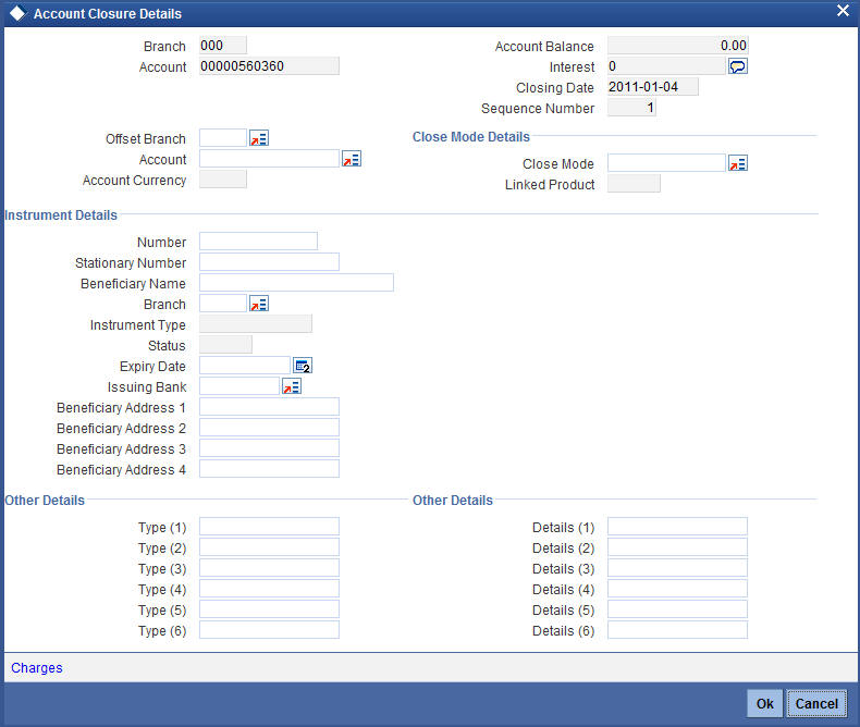

In the event of account closure, the system allows closure only after all invoice are generated and payment of outstanding bill amount is made.
Before closing the account, you need to:
All the components of a bill can be liquidated automatically or manually. In the Product Preferences screen, you can indicate whether the mode of liquidation of bills is to be automatic or manual. The system automatically liquidates those bills marked for auto liquidation. If the bills are marked for manual liquidation, you have to liquidate them through the Billing Liquidation screen.
The liquidation is triggered differently for each of the following scenarios:
Refer the section ‘Defining parameters for settlement/liquidation of bill for an account’ in Billing User Manual under Modularity for details about this screen.
You can capture details of signatories for the account, using the ‘Signatory Details’ screen. To invoke this screen, click the ‘Account Signatory’ button in the ‘Customer Accounts Maintenance’ screen.
Account Branch
The system defaults the current branch here.
Account Number
This system displays the account number to which signatories are to being linked.
Account Description
The system displays the description for the account selected.
Account Currency
The system displays the account currency.
Minimum Number of Signatories
Specify the minimum number of signatories necessary to endorse an instrument involving the account.
Note
If the linked or replicated signatories are less than the specified minimum number then the system displays an error message.
Account Message
Specify a brief description about particular signatories. It can be related to the name, number and the type of signatory of your customer. You can specify a maximum of 4000 characters as account message length.
For instance you can capture a message like - "This signatory is a joint account holder with rights to sign instruments only up US 8000".
You can maintain account signatory details for different customers using this tab.Click on ‘Account Signatory Details’ tab to invoke the following screen
Customer ID
Specify the customer signatory you want to link to the account.
You can link a customer signatory to an account either by:
Note
If the signatory ID that you specify has not been maintained, the system will generate an error and you will not be able to create an account. ".
Relation Type
The system displays the relation type of the customer.
Signatory ID
Specify the signatory ID of the customer. Alternatively, you can select the ID from the option list. The list displays values maintained in CIF signatory for the customer number.
Signatory Name
The system displays the corresponding name of the signatory number specified.
Signature Type
Specify the signatory type of the customer. Alternatively, you can select the type from the option list. The list displays signatory types maintained for the customer number.
Approval Limit
Specify the amount up to which the account signatory can approve for debits.
Signatory Message
Specify additional signatory message details in this field. You can enter a maximum of 4000 characters, alphanumeric.
Solo Sufficient
Check this box to indicate whether one signatory detail is sufficient.
You can maintain account signatory instructions for different amount slabs in this tab.Click on ‘Amount Based Signatory Instruction, tab to invoke the following screen:
To Amount
Specify the slabs by setting a ‘To Amount’. The amount slab will start from zero and the first value entered sets the slab from zero to that amount. The amounts are arranged in ascending order. For next slab, an amount above the previous ‘To Amount’ is considered as the ‘From’ value.
For example, If the ‘To Amount’ entered are as below
| To Amount | |
| 10,000 | |
| 100,000 | |
| 1,000,000 |
Then the maintenance will indicate the below amount slabs:
| From Amount | To Amount | ||
| 0 | 10,000 | ||
| Above 10,000 | 100,000 | ||
| Above 100,000 | 1,000,000 |
You can define different conditions for the amount slabs in this section.
Condition Id
Specify a unique Id for condition to be set.
Remarks
Give a brief description for the condition id.
You can provide the required signatories for the conditions set in this section.
Signature Type
Select the signature type required from the option list. The list displays the signature types maintained in static type maintenance screen.
Note
The signature type cannot be repeated for a condition.
Required No. of Signatories
Specify the number of signatories for each signatory type.This number should be less than or equal to the total number of signatories maintained under the signatory type.
Note
The Amount Based Signatory Instructions tab will be enabled in the following RT screens only if the value of param ‘AMOUNT_BASED_SV’ is Y in CSTM_BRANCH_LOC_PARAMS.
Click ‘All Signatures/Images’ button to view ‘Customer Signature/Image Consolidated View’ screen.
The following details will be displayed in the above screen
The ‘Signature/Image’ tab displays nine signatures/Images for a signature id in a single pane with three signatures/Images in a row.
If there is more than one signature id linked to a customer account, then they would be displayed in different pages.
Each image is provided with the following buttons:
The Customer accounts maintenance provides you with the facility to generate balance reports for the customer account. These details are defaulted from the account class maintenance performed for the account class category the customer account comes under. You can however, alter these details utilizing the Customer account maintenance screen.
To invoke this screen click the ‘Interim Transactions Report’ button, in the customer account maintenance screen. You need to specify the details for an MT 941 message.
This screen contains the details necessary for the account generation parameters. The message details the balance of the customer account that is under a particular account class. The account balances indicate the condition of the customer account for an identified time period.
Generate Message
Check this box to indicate that the periodic interim statement (MT942) generation is required for the account. This will be defaulted from ‘Account Class Maintenance’ screen. However, you can modify it. The ‘Consolidated Statement’ and ‘Generate Message’ are mutually restricted.
Generate Message Only on Movement
Check this box to indicate that the interim statement generation is required, only if additional entries have been posted subsequent to the previous interim statement generation. This will be defaulted from ‘Account Class’ screen, however you can modify it.
Report Transaction Since
This section lists all the transactions of the interim account statement, which are supposed to be reported. This will be defaulted from ‘Account Class’ screen, however you can modify it. You can choose the appropriate values applicable:
Debit (Dr and Cr) Amount
Specify the minimum transaction amount for the debit transaction to be eligible for reporting in the interim statement. The corresponding amount for the account currency will be defaulted. However, you can modify the amount defaulted. If the amounts are not defined at the account class for the currency in which the account is being created, no defaulting of amounts shall be done.
If you do not specify the minimum credit amount, the system will consider the amount specified in this field for reporting the eligible credit transactions also.
Credit Amount
Specify the minimum transaction amount for the credit transaction to be eligible for reporting in the interim statement. However, you can modify the amount defaulted. If the amounts are not defined at the account class for the currency in which the account is being created, no defaulting of amounts shall be done.
Daily Statement Count
Specify the count of interim statement generated during the day. In case a statement is scheduled to generate, but is not generated because there is no movement, the counter will not be incremented. The counter will be reset at End of Day.
Year to Date Statement Count
Specify the count of interim statement generated for the account since start of the financial year. The financial year will be as defined in the Accounting Period maintenance. This counter would be set at the end of year.
Generate Balance Report
To indicate that the customer account is considered for generation of its balance message, check this box
Of
Select the mode of message for balance generation from the option list
This section lists all the transactions the customer account has undergone, in the interval of balance messages generated for the account. You can choose the appropriate values applicable:
You can synchronize the time instance by hours for generation of the balance message by clicking the ‘Times’ button.
This screen is employed to indicate the the time instance in hours for the generation of the balance report.
Message generation time
Specify the timing for generation of the MT 941/ MT942 message. You can specify the time interval in hours only.
The details for issuing the balance reports are discussed in the chapter ‘Maintaining Mandatory information, for different accounts under a particular class. The details involved in generation of a balance report for a specific customer account correspond with those discussed for account classes.
The balance statement can be handed off as part of scheduled task under Oracle FLEXCUBE. You need to assign its frequency in hours. This process is initiated for all accounts requiring a balance account statement. As discussed previously the time for generation of the statement is determined and specified. In case of no subsequent transactions reports, the statement is not generated.
The balance statement can be facilitated to run as part of a scheduled job as part of the Oracle jobs initiated during processing. The Jobs Browser screen of the application provides you the facility to run the balance statement as a synchronized task, subject to specified time intervals in hours.
Invoke the ‘Jobs Browser’ screen from the application typing ‘CSSJOBBR’ in the field at the top right corner of the Application tool bar and click on the adjoining arrow button.
Select the option ‘Generate Balance Report’ from the Process option list. All associated accounts of the particular branch that have been marked for generation of balance statements are procured by Oracle FLEXCUBE
The debit and credit accounts considered since the previous issue of an MT941/MT942, are picked up for the current processing. The previous messages are based on the parameters maintained for each account. This processing produces details of the statement generation.

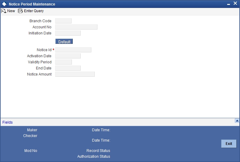

You can view and modify the notice preferences maintained at the account class level for the withdrawal of amount from savings account through the ‘Notice Preferences’ screen. Click ‘Notice’ button in the ‘Customer Accounts Maintenance’ screen. The ‘Notice Preferences’ screen is displayed as follows:
Note
This screen is applicable only for saving type of account
The following field is displayed in this screen:
Description
The following details are defaulted from the account class maintenance level. However, at the account level you are allowed to modify this.
Advance Interest
Check this field to levy the advance interest on the account
Note
The customer is liable to pay this advance interest in case he/she fails to provide the required notice to the bank
The system deducts the advance interest from the credit Interest earned by the customer on his/her credit balance in the account

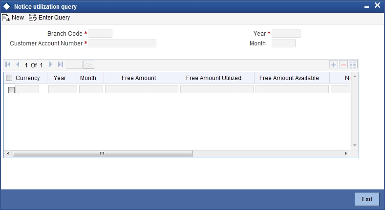

Monthly Free Amount
Specify the amount that the customer can withdraw per calendar month from his/her savings account without being liable to pay advance interest.
Notice Days
Specify the number of days before which the customer should notify the bank if he/she wants to withdraw an amount more than the ‘Free Amount’ from his/her account.
Validity Period
Specify the validity period in number of days. During this period, the customer can do the withdrawal of the amount for which he/she notified the bank.
For more details on ‘Notice Accounts’ refer the following section ‘Levying penalty interest on notice accounts’.
Click ‘Cards’ button to view details about debit cards issued against the account.
Here, you can view the following details.
Branch Code
The branch code is displayed from the main ‘Customer Accounts Maintenance’ screen.
Customer No
The customer identification code (CIF) of the account holder is displayed from the main ‘Customer Accounts Maintenance’ screen.
Account No
The account number is displayed from the main ‘Customer Accounts Maintenance’ screen..
Authorisation Status
Indicate the authorisation status of the debit card by selecting one of the following values:
Record Status
Indicate the record status of the debit card by selecting one of the following values:
Branch Code
The system displays the branch code where the debit card has been issued.
Request Reference Number
The system displays the request reference number of the card issuance record.
Card Number
The system displays the debit card number of the card holder.
Multiple cards can be issued to a customer.
Click ‘Statistics’ button to view the details on Highest Debit Balance for the last 12 months including the current month.
You can view the following details here:
Click on the ‘Change Log’ button in the ‘Customer Account Maintenance’ screen to invoke the Change Log screen
Branch
The current logged-in branch code is displayed here.
Click on the ‘Cheque Book Request’ button in the ‘Customer Account Maintenance’ screen to invoke the Cheque Book Request screen.
You will be able to invoke this screen, only if you have checked the ‘Auto Cheque Book Request’ check box in the ‘Customer Account Maintenance’ screen.
Branch
The branch detail gets defaulted from the account branch.
Account
Select the account number to which a cheque book needs to be issued. The adjoining option list displays all the accounts which are enabled for the cheque book issuance.
First Check Number
Specify the number of the first cheque leaf of the cheque book. If the cheque book number is auto generated, you need not specify.
Check Leaves
Specify the number of cheque leaves in the cheque book.
Cheque Book Type
Specify the cheque book type. The adjoining option list displays the cheque types maintained in the system. You can choose the appropriate one.
You need to specify the cheque book type if the cheque book is generated with inventory tracking.
Order Date
The order date gets defaulted as the current date. However you can change the same.
Order Details
Specify the order details.
Language Code
Specify the code of the language. The adjoining option list displays all valid language codes maintained in the system. You can choose the appropriate one.
Request Status
The value of this will be defaulted to ‘Requested’ status.
Click ‘Ok’ to save the cheque book request details.
Click on the ‘Debit Card Request’ button in the ‘Customer Account Maintenance’ screen to invoke the Debit Card Request Details screen.
You will be able to invoke this screen, only if you have checked the ‘Auto Debit Card Request’ check box in the ‘Customer Account Maintenance’ screen.
Branch Code
The reference number of the request is auto generated and populated, when you click on the ‘Default’ button.
Customer No
The customer number of the account gets defaulted.
Account No
The account number gets defaulted from account details.
Card Products
Specify the card products. The adjoining option list displays the card products maintained in the system. You can select the appropriate ones.
Card Bin
Specify the card bin. The adjoining option list displays the card bins maintained for the specified card product. You can choose the appropriate one.
Name on Card
Specify the customer name that is to be printed on card.
Card Number
Specify the debit card number to be requested. The adjoining option list displays the valid debit card numbers maintained in the system. You can choose the appropriate one.
Card Application Date
The card application date would be defaulted as the current date of the branch. However you can change the same.
Primary Card
The primary card check box remains checked by default.
Card Status
The status of the card will be defaulted to ‘Requested’
Click ‘Ok’ to save the Debit card request details.

Click ‘Auto Deposits’ tab in the ‘Sweep Structure Maintenance’ screen to verify auto deposit details.
Click ‘Term Deposits’ tab in the ‘Sweep Structure Maintenance’ screen to maintain auto deposit details.
You can maintain the following deposit account details:
Linkage Order
The system defaults the linkage order of the specified parent deposit account, when you save the sweep structure record. This number is used to identify the preference level of the deposit account.
Deposit Account
Specify the deposit account that should be linked with the specified linkage order. The adjoining option list displays a list of valid accounts maintained in the system. Select the appropriate one.
Once you specify the deposit account, the system defaults the following details:
Linkage Percent
Specify the linkage percent for the linked deposit account.
Linked Amount
Specify the linkage amount. The linked amount should not be greater that the available collateral amount.
Note
Specify the Linkage percentage /Linked amount only during new operation. You cannot maintain both Linked amount and Linkage percentage of the deposit amount during new linkage of Deposit.
Secure Overdraft (SOD) facility is given against collaterals for an account. Oracle FLEXCUBE facilitates generation of alert when SOD utilization is closer towards the consolidated limit amount of the collaterals.
Oracle FLEXCUBE runs a batch process to identify such breached SOD accounts and generates alerts as per the maintained percentage parameter at SOD account level and decides the breach limit for every account. The system sends the generated alerts as ADVICE format (email) or ASCII flat file. It defines the message format for email and captures the following key information to send these alerts to OD customer:
The system runs a CASA batch adding the following process ‘SODALERT’:
You need to create a message advice format through the ‘Advice Format Maintenance’ screen with the format named ‘SOD_CR_UTIL’. You should also create an outgoing generic interface to generate ASCII file where in the component details for the generic interface are the elements from the new data store. You need to schedule this generic interface to be executed during EOD through ‘GIDPRSIF’ batch.
Note
The system processes alerts only if the email address and mobile number are maintained for a customer.
You can know the Limit Utilization Breach for the account by the application of the following formula:
‘(Utilized limit amount) ≥ (SOD Amount * SOD notification percentage) / 100’

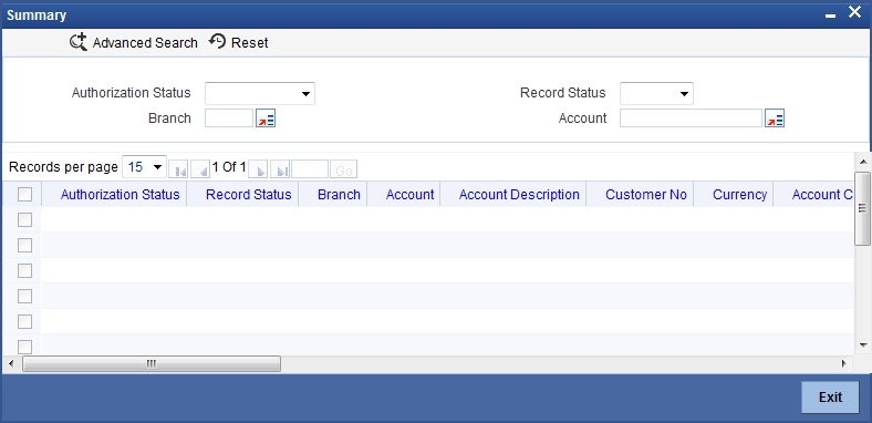

You can view the customer accounts details maintained in the ‘Customer Accounts Maintenance’ screen using the ‘Customer Accounts Summary’ screen. You can invoke this screen by typing ‘STSCUSAC’ in the field at the top right corner of the Application tool bar and clicking on the adjoining arrow button.
In the above screen, you can base your queries on any or all of the following parameters and fetch records:
Select any or all of the above parameters for a query and click ‘Search’ button. The records meeting the selected criteria are displayed.
Note
You can query or modify the account details of the customers whose accounts are permitted to you for the query/modification in the ‘Group Code Restriction’ screen.
If you are allowed to query customer information, then system displays the following details pertaining to the fetched records:

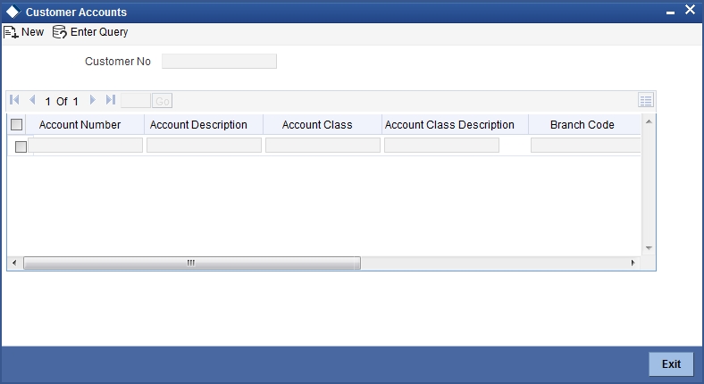

You can view the details of all accounts maintained for a specific customer using ‘Customer Account’ screen. You can invoke this screen by typing ‘STDACCDT’ in the field at the top right corner of the Application tool bar and clicking on the adjoining arrow button.
Customer Number
Specify the customer number. On search, the system displays the following details pertaining to all the accounts held by this customer.
To view the joint holder’s details of an account and the mode of operation maintained at the account level, place the cursor on the Account Number field and press Ctrl+J. The system displays the ‘Joint Holder’ screen.
The system computes the Sweep history details when Cover Accounts / Auto Deposits / Term Deposits are linked to the primary CASA account in ‘Sweep in Structure’ screen at customer account level.
You can view Customer Account Sweep details in the Customer Account Sweep History Details screen. You can invoke this screen by typing ‘STDSWHIS’ in the field at the top right corner of the Application tool bar and clicking the adjoining arrow button.
In the above screen, you can base your queries on following parameters and fetch records:
If you are allowed to query sweep details for the account, then system displays the details pertaining to the Sweep and Sweep History:
Sweep Details
Sweep History for the customer account:

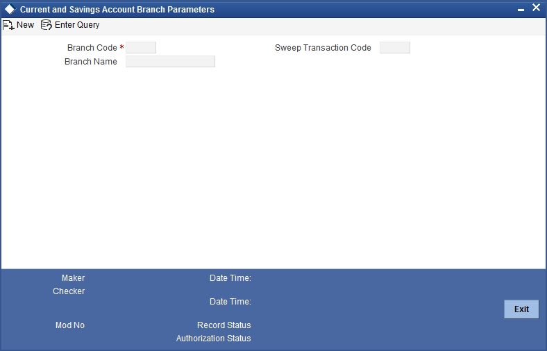

You can maintain CASA related branch parameters in the ‘Current and Savings Account Branch Parameter’ screen. To invoke this screen, type ‘CADBRMNT’ in the field at the top right corner of the application toolbar and click the adjoining arrow button.
You can specify the following parameters:
Branch Code
Specify the branch code from the adjoining option list.
Sweep Transaction Code
Specify the sweep transaction code from the adjoining option list.
Branch Name
System displays the branch name.

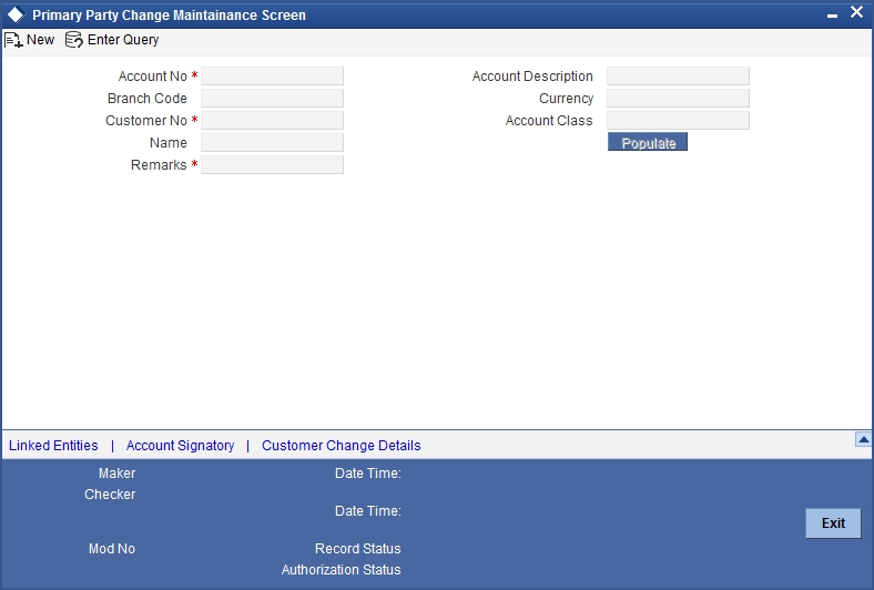

You can change the primary customer of a specific account using ‘Primary Party Change Maintenance’ screen. To invoke this screen, type ‘STDCUSCH’ in the field at the top right corner of the application toolbar and click the adjoining arrow button.
Account
Specify the account number for which you need to change the primary customer. The option list displays all valid active and open accounts under the current branch. Unauthorized and tanked accounts will not be available for selection.
Select the appropriate account number.
Description
Based on the account selected, the system displays the account description.
Branch Code
The system displays the current branch code.
Currency
The system displays the currency associated with the selected account.
Customer Number
The system displays the customer number of the primary customer of the account.
You can modify this and specify the customer number as per requirement. The option list displays all valid active and open customer numbers. Select the appropriate one.
The customer number that you select here must be different from the customer number displayed on selection of the account number.
Once you have selected the customer number, click ‘Populate’ button. The system will update the ‘Account Signatory’ and ‘Linked Entities’ details based on the changed customer number. If you do not click the ‘Populate’ button, on saving the record, the system will display an error message.
Customer Name
Based on the customer number, the system displays the name of the customer.
Account Class
The system displays the account class to which the selected account belongs.
Remarks
Specify your remarks related to the change of primary customer.
Click ‘Linked Entities’ button to view the linked entities.
When you click ‘Populate’ button after selecting the customer account, the system will update the changed customer as the primary account holder in ‘Linked Entities’ screen. The other details will remain the same. However, you can modify the details.
For further details on the ‘Linked Entities’ screen, refer to the section ‘Specifying Linked Entities’ in this chapter.
Click ‘Account Signatory’ button to view the account signatory details.
When you click ‘Populate’ button after selecting the customer account, the system will update the account signatory details based on the changed customer.
The amount based signatures will be defaulted from the account level. In case modifications are done on these, system will reflect in the changes in STDCUSAC after authorization.
If you have checked the box ‘Replicate Customer Signature’, then the system clears the signatures maintained for the old customer in the ‘Account Signatory’ sub-screen and displays the rest of the signatures. This may include signatures of the joint holders. The system will also default the signature maintained for the changed primary account holder.
If you have not checked the option ‘Replicate Customer Signature’, then the system clears the signatures maintained for the old customer.
For further details on the ‘Account Signatory’ details, refer to the section ‘Specifying Account Signatory Details’ in this chapter.
Click ‘Customer Change Details’ button to view the details of primary customer changes.
You can view the following details:
Branch Code
The system displays the branch code.
Account
The system displays the account number for which the primary account has been changed,
From the ‘Validate’ tab, you can validate the customer changes and view the error/override messages. Click ‘Validate’ button. The system will displays the following details if there is a possible error or override during the process.
Error Code
This is the error code for the error\ override message.
Type
This indicates whether the message was an error message or an override message.
Message
This field displays the details of the error/ override message.
The list will contain the details of possible errors in the beginning, followed by the possible overrides.
You can generate a report of the error/ override messages using the ‘Report’ button. Once you click this button, the system will display the ‘Report Options’ screen. Select the appropriate options and click ‘OK’ button to generate the report.
You can view the following details in the report:
Header
Under the Header, you can view the following details:
Detailed
Under detailed section, you can view the following details:
Based on the possible error information received, you can resolve such issues and proceed to save the customer change.
Under this tab, you can see the history of all customer changes that has happened for the selected account.
In this tab, you can view the history of all customer changes happened on a given account. Against each customer change information, you can view all the overrides triggered during the change process.
This screen will display the details of unauthorized customer changes, if any. The authorizer can view the overrides and take a decision whether to authorize the change or not.
For each primary party change, you can view the following details:
For every selected change record, you can view the following details of the errors/ overrides:

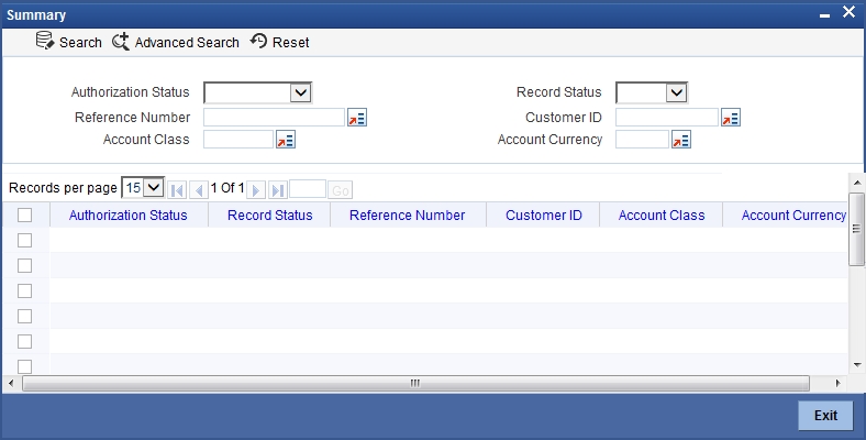

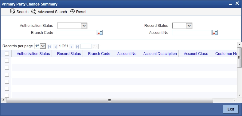

You can view a summary of primary party changes made in the system using ‘Primary Party Change Maintenance Summary’ screen. To invoke this screen, type ‘STSCUSCH’ in the field at the top right corner of the application toolbar and click the adjoining arrow button.
You can search for the records based on one or more of the following parameters:
Once you have specified the parameters, click ‘Search’ button. The system displays the following details of all records that match the search criteria.
Note

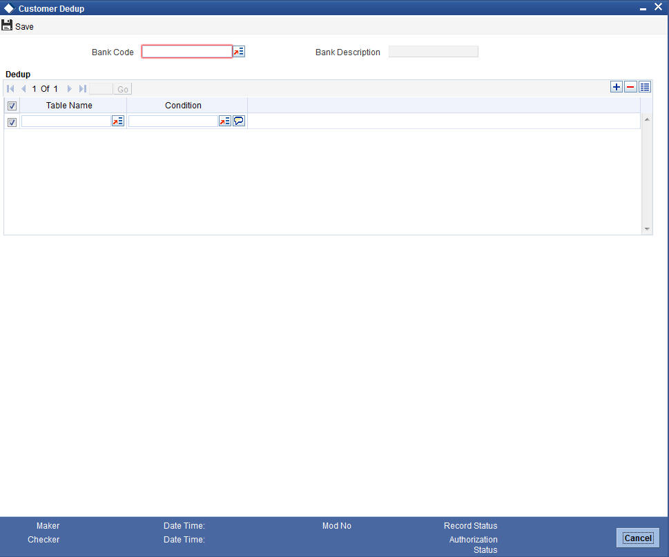

You can frame the rule to avoid the duplicate the customer data using ‘Customer Dedup Maintenance’ screen. Also, you can modify the existing the De-duplication rule condition. You can invoke this screen by typing ‘STDDEDUP’ in the field at the top right corner of the Application tool bar and clicking on the adjoining arrow button.
You need to specify the following details:
Bank Code
Specify the unique bank code from the adjoining option list.
Bank Description
System defaults the bank name depending on the bank code selected.
Sequence Number
System generates a new sequence number for each column whenever a parameter is changed.
Condition
Select the field name for the de-duplication check from the adjoining drop-down list. System displays all the fields of the below tabs in the customer creation screen.
System will check the data duplication for the selected fields.
Note
System performs the de-duplication check for all existing customers against the latest available de-duplication condition maintained at the bank level.
System performs the de-duplication check for the new customers during customer creation and for existing customer during customer reopening as well as if the de-duplication rules are updated.
System performs de-duplication check for customers uploaded through Excel and also for customers created through BPEL.
System allows modifying the de-duplication rule condition if and whenever required.
You can maintain joint holders details using ‘Joint Holder Maintenance’ screen.You can invoke this screen by typing ‘STDJHMNT’ in the field at the top right corner of the Application tool bar and clicking on the adjoining arrow button.
Account Number
Specify the account number for which you want to enquire about the joint holder details. The adjoining option list displays the list of all valid account numbers. Select the appropriate one.
Based on the account number selected, the system defaults the following details:
Customer Number
You cannot specify the primary customer number here.
Customer Name
The system displays the customer name based on the customer number selected.
Joint Holder Type
Specify the type of a joint account, a type of authority. Select the appropriate one from the adjoining drop-down menu. The options are:
Note
One joint holder can have only one joint holder type of relation with the account. For example, if a customer is added as an ‘Authorized Signatory’ for the account, the same customer cannot be added as any other joint holder type.
You cannot modify the primary holder in this maintenance.
Start Date
Specify the starting date or valid from of the joint account.
End Date
Specify the date on which the joint account has ended.
The system validates the specified details and saves the record.
You can view the joint holder details maintained in ‘Joint Holder Maintenance’ screen using the ‘Joint Holder Summary’ screen. You can invoke this screen by typing ‘STSJHMNT’ in the field at the top right corner of the Application tool bar and clicking on the adjoining arrow button.
Note

The linked cover accounts, Auto Deposits and Term Deposits are debited online or real time and Primary CASA account is funded immediately to ensure that primary CASA account is not moved into debit balance due to Sweep in before EOD batch processing and complete the Debit Transaction.When a Sweep in transaction is initiated due to shortfall in Primary CASA account, the system will identify the linked accounts and the amount to be debited during sweep in.The system will post two sets of accounting entries in a single transaction to complete the debit transaction. This debit transaction involves online funding of Primary CASA account and then debiting of Primary CASA account.
The following accounting entries are posted:
Set 1:
Debit Linked Accounts (To the extent of shortfall amount)
Credit CASA Account (To the extent of shortfall amount)
Set 2:
Debit CASA account (Transaction amount)
Credit Target account (Transaction amount)
Both sets of accounting entries are passed in a single transaction, so that the amount swept in to primary account will be utilized to honour the debit transaction.When the TD account is linked in sweep in structure, the system imposes amount block on linked TD accounts to the extent of linked amount.If the available balance is not sufficient to meet the shortfall in Primary CASA account, then the system will only consider available balance of cover account and proceed with next linked account.
The system performs few validations for sweep in at account level and account class level.
The following validations are performed for sweep in at account class level:
The account level validations and process for CASA, Cover, Auto Deposit and TD accounts are detailed below:
This validation is enable only during linkage of cover accounts.
If there is a change in holding pattern of primary/cover accounts after the linkage of cover account, then the system will not validate during the process of changing the holding pattern. This process needs to be handled manually.
If there is a change in primary customer of primary/cover accounts after the linkage of cover account, then the system will not validate during the process of changing the primary customer. This process needs to be handled manually.
Note
The following are the validations and processes for auto deposits on specified deposit account:
The order of linkage of auto deposits at ‘Sweep Structure Maintenance’ level does not influence the order in which auto deposits are broken for sweeping out funds from auto deposits to primary CASA account.
The following are the validations and processes for term deposits on specified deposit account:
During Sweep in and Reverse Sweep in process, the system sequences processing of linked accounts. Cover, auto deposits and term deposits are utilized in the defined order of sequence.
Sweep in Sequence
The sequence followed for sweep in is:
If there are multiple cover accounts, then the system follows the sequence of linkage in ‘Sweep Structure Maintenance’ screen at Primary account level.
If there are multiple auto deposits, then the system follows the value selected for ‘Break Method’ parameter in Auto Deposit section of CASA account class.
If there are multiple term deposits, then the system follows the linkage sequence in ‘Sweep Structure Maintenance’ at Primary account level.
Reverse Sweep in Sequence
If there are multiple Cover accounts, Auto Deposits and Term Deposits, then the system uses the sweep in sequence of utilization to replenish the funds.
Oracle FLEXCUBE supports reversal of the Sweep in transactions, irrespective of whether the reversal is attempted on same day or subsequently. This will be supported for all types of transactions for which reversal is allowed. Reversal will be allowed even for back value dated debit transactions involving sweep in of funds.
Reversal of sweep in will not restore the original position, however, it is treated as credit to linked accounts. Similarly, reversal of reverse sweep in would be treated as debit to linked accounts.
Oracle FLEXCUBE facilitates online reverse sweep in. When a Primary CASA account receives credit after sweep in transaction and before EOD batch processing, the system will reverse sweep in funds to linked accounts immediately without waiting for EOD batch process. Credit can either be partial or full. Based on the credit criteria, the system process the online reverse sweep in.
Partial Credit to Primary CASA account
During the day, if CASA account is partially credited, then the system debits the CASA account and credits the linked accounts in the reverse order of original utilization sequence followed during Sweep in. The system will also keep track of remaining amounts to be replenished in linked accounts.
The system will not handle accounting/amount block during EOD batch, as the linked accounts were debited online during Sweep in. Remaining amount is tracked as ‘Amount to be reverse swept’ and the same is adjusted next time when funds are credited.
Full Credit to Primary CASA account
During the day, if CASA account is credited with sufficient amount to cover the amount swept in, then the system debits the CASA account and credits the linked accounts in the reverse order of original utilization sequence followed during Sweep in.
The system will not handle accounting/amount block during EOD batch, as the linked accounts were debited online during Sweep in. Only after complete replenishing of swept in funds, the system will create Auto Deposits. However, only if there are surplus funds available in Primary CASA account.
De-linking Cover Account
The cover account can be de-linked from sweep in structure any time during the life cycle, after utilization. Once the cover account is de-linked, the system reverses sweep in amount stored against the cover account and updates as zero.
De-linking Auto Deposits from Primary CASA account
If ‘Enable Sweep in’ check box is unchecked for Primary CASA account as part of account amendment, then the system will de-link the existing Auto deposits from Sweep structure. These de-linked Auto deposits and new auto deposits created after the change are broken whenever CASA account balance goes below minimum balance.
De-linking Term Deposit from Sweep In Structure
The system facilitates you to de-link the term deposit utilized as part of sweep in, from Sweep in structure. The moment Term deposit is de-linked, the system reverses sweep in amount stored against the term deposit account and updates as zero. So that the system need not track it for replenishment.
Oracle FLEXCUBE facilitates batch closure of auto deposits with zero balance if any or all of the following criteria are satisfied:
The ‘Notice Account’ is a savings account for which the bank levies ‘Advance Interest’ if the account holder withdraws an amount more than the ‘Free Amount’. The free amount is the amount that a customer can withdraw per calendar month from his/her savings account without providing any notice to the bank and without being liable to pay advance interest.
Oracle FLEXCUBE facilitates the setting up of a ‘Notice Account’ using the ‘Customer Accounts Maintenance – Notice Preferences’ screen by enabling the option, ‘Advance Interest’. You can also configure an account class for advance interest by enabling the option, ‘Advance Interest’ at the ‘Account Class Maintenance – Notice Preferences’ screen.
For more details on the ‘Customer Accounts Maintenance – Notice Preferences’ screen, refer to the preceding section titled, ’Maintaining Notice Preferences for Withdrawal’.
For more details on the ‘Account Class Maintenance – Notice Preferences’ screen, refer to the section, ‘Maintaining Notice Preferences’ in the chapter, ‘Maintaining Mandatory Information’ of this User Manual.
These Notice Accounts are linked to the ‘Notice Period’ maintained at Account Class/Customer Account level for the withdrawal of amount from the account. The account holder should provide a notice of specified days/months to the bank to withdraw an amount more than the ‘Free Amount’. Once the notice period is crossed, the notice becomes active and the customer can withdraw the noticed amount during the validity period of the notice. For example, if the Notice Period is 3 months then the customer should inform the Bank 3 months in advance about the amount the customer wants to withdraw from his account.
The noticed amount can be withdrawn at one go or in several installments within the notice validity period window. After the validity period expires, the status of the notice remains closed.’
Note
The system deducts the advance interest from the credit Interest earned by the customer on his credit balance in the account
If the customer does not withdraw his free amount during any month he is not allowed to carry forward the same in the subsequent month
You have to maintain an SDE for advance interest calculation on the amount withdrawn from the customer account. The system takes up all accounts belonging to a product, for which the option ‘Advance Interest’ in ‘Notice Preferences’ screen is enabled, for calculating the Advance Interest.
For more details on maintaining this SDE refer to the section, ‘Maintaining SDEs for Computing Advance Interest’ in the chapter, ‘Maintaining System Data Elements’ of the ‘Interest and Charges’ User Manual.
You can specify the notice for withdrawal of amount from the accounts using ‘Notice Period Maintenance’ screen. You can invoke this screen by typing ‘‘STDNPMNT’ at the top right corner of the application tool bar and clicking the adjoining arrow button.
The following details are captured in this screen.
Branch Code
The current branch code is defaulted here.
Account Number
Specify the account number for which you wish to maintain the notice period.
Initiation Date
Specify the date on which the notice is initiated.
Note
After specifying the initiation date click ‘Default’ to display the Notice Id, Activation Date, Validity Period, End Date and Notice Amount. The system defaults the following fields based on the Notice Preferences you maintain at the Customer Account level.
Activation Date
The activation date gets defaulted based on the account number and initiation date entered.This is the date from which the notice period becomes active. However, you can modify this date.
Validity Period
The validity period of the notice as maintained in the ‘Notice Preferences’ screen at the account level gets defaulted here. However, you can modify this period
Notice Amount
Specify the amount to be withdrawn within the Notice Period. The amount you specify here should be in account currency.

For a customer account, you can record details of lodgment book requests, provided the use of lodgment books is allowed for the account. You can capture these details in the ‘Lodgment Book Maintenance’ screen. You can invoke this screen by typing ‘CADLDGBK’ in the field at the top right corner of the Application tool bar and clicking the adjoining arrow button.
For each request, you need to capture the following details:
Account Number
You can specify the account number of the customer account in respect of which the request for the lodgment book was received.
Start Number for the Lodgment Book
You can specify the start number for the leaves in the lodgment book. This depends upon your specification in the Bank Wide Parameters, in respect of uniqueness of lodgment book numbers.
For Example, In the Bank Wide Parameters, you have specified that lodgment book numbers must be unique for the branch. This means that lodgment numbers need to be unique across all accounts of that branch. For instance, if a book is maintained with the Start Number as 1, and containing 25 leaves, you cannot start another book in respect of any other account, with these numbers. If you have specified that lodgment book numbers must be unique to accounts in the branch, and a book is maintained with the Start Number as 1, and containing 25 leaves, you cannot start another book in respect of the same account, with these numbers. However, you can start a book with the same numbers in respect of another account in the branch.
Number of Leaves
You can specify the number of leaves that the lodgment book is to have
Order Date and Issue Date
By default, the order date and the issue date of the lodgment book is considered to be the application date; you can change the dates and specify them as required.
Order Details
You can specify order details as required for the lodgment book.
Order Details for Lodgment Printing
If you wish the order details to be sent to the lodgment book-printing agent, you can indicate so. If you indicate this by checking the Include for Lodgment Printing box, the issue date for the lodgment book will be updated by the printing interface.
You can open a quick CASA account using the ‘Quick Customer Account Opening’ screen. The ‘Quick Customer Account Opening’ screen will support the new and authorization operations. Any additional modifications need to be updated in the ‘Customer Accounts Maintenance’ screen.
You can invoke the ‘Quick Customer Account Opening’ screen by typing ‘STDCASAC’ in the field at the top right corner of the Application tool bar and clicking the adjoining arrow button. Click the ‘New’ button on Oracle FLEXCUBE to create a new CASA account.
You need to specify the following information:
Customer No
Specify the customer identification number allotted by the bank. It is a mandatory field.
Customer Name
Specify the customer’s name.
Currency
The system defaults the local currency as the account currency. However, you can change the currency, if required.
Account
By default, the system displays the account number.
Account Class
Specify the account class of the customer.
Click ‘Fetch’ button to fetch the account number. The system will fetch the account number in the following ways:
Branch Code
The system defaults the local branch as the account branch.
SD User Reference
The system displays the SD user reference for the account.
Private Customer
The system displays a check in the box if the customer is a private customer.
In the ‘Main’ tab, the system provides some information and you also need to specify few details.

It contains the nominee’s details. You need to specify the following details:
Name
Specify the nominee’s complete name.
Date of Birth
Specify the nominee’s date of birth.
Relationship
Specify the customer’s relationship with the nominee.
Address 1 – 4
Specify the complete address of the nominee.
Minor
Check the box, if the nominee is a minor.
Guardian Name
Specify the complete name of nominee’s guardian.
Relationship
Specify the nominee’s relationship with the guardian.
Address 1 – 4
Specify the complete address of the guardian.

Check List is an optional tab based on the workflow of the bank.
In the Check List tab, you need to specify the following details:
Document List contains the information about the documents submitted to the bank for various purposes. You need to specify the following details:
Document Type
You can select the documents that are maintained in the account class.
Mandatory
Check the box if the document is mandatory.
Checked
Check the box if the document is checked.
Note
Check list will be defaulted from the account class document list, based on the customer type. If any of the documents is mandatory at account class, then the same should be captured in the account screen and it should be marked as checked, otherwise, system will not allow saving the account.
‘Remarks’ contains the additional information of the document notifications. You need to specify the following details:
Remarks
Specify the additional information of the document notifications, if any.
After providing the necessary information, click the ‘Save’ button to save the information provided. The information is saved differently in the following scenarios:
For more details on the ‘Cheque Book Request’ screen, refer to the section 3.1.32 in this chapter.

You can view the summary details of the quick customer account in the ‘Quick Customer Account Summary’ screen. To invoke this screen, type ‘STSCASAC’ in the field at the top right corner of the Application tool bar and click the adjoining arrow button.
Once you have specified the search parameters, click ‘Search’ button. The system displays the following information:

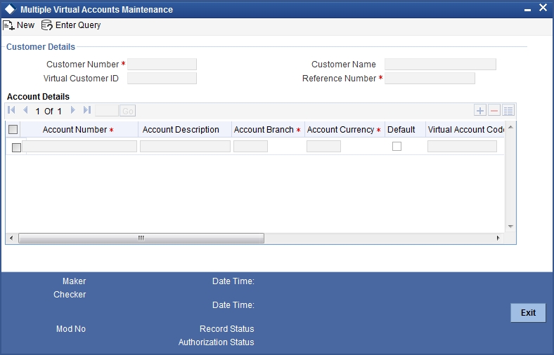

In ‘Multiple Account Maintenance’ screen multiple virtual accounts can be opened for a physical account at a time. However, once the virtual accounts are successfully opened the account data will be stored in the format of single account opening screen, that is, the records created in this screen will get transformed into single records in STDVIRAC screen. You can invoke this screen by typing ‘STDVIRMA’ in the field on the top right corner of the application tool bar.
In this field you need to specify the following details:
Customer Number
The customer number is defaulted in this field. If the ‘Allow Virtual Account’ flag is selected in the Customer Maintenance (STDCIF) screen for a customer, then those customer numbers are displayed here.
Virtual Customer ID
The virtual customer ID is displayed as per the customer number selected.
Customer Name
Customer name of the specified customer number is displayed.
Reference Number
A unique reference number of the transaction is auto generated and displayed.
Account Number
Select the account number from the adjoining option list. The virtual account number is validated against the virtual account mask maintained at bank/branch level.
Account Description
A description of the selected account number is displayed in this field.
Account Branch
The branch of the selected account is displayed here. If there are more than one branches displayed, then you have an option of selecting the specific account branch value.
Account Currency
The account currency of the selected account number is displayed here.
Default
Check this box for at least one physical account, if virtual account number is mapped with multiple physical account numbers with different currency.
During virtual account opening, if the virtual account is mapped to only one physical account, then the ‘Default Flag’ will be checked automatically during the ‘Save’ operation.
If one virtual account number is mapped to multiple physical account numbers, then the default flag can be selected for only one account number.
Virtual Account Code
Select the virtual account code from the adjoining option list. All virtual account codes as defined in the ‘Virtual Account Code Maintenance’ screen (STDVIRPM) is displayed in the list of values.
Description
A description of the virtual account code is displayed here.
Virtual Account Number
Specify the virtual account number.
Virtual Account Name
Specify a name for the virtual account number.
Account Open Date
Specify the date of account opening. The current date will be the default date. Back dated values can be provided but the back date should be greater than or equal to the physical account. Future dated values can also be provided.
Note
Virtual Accounts can be created through bulk upload facility from channels. This is be done through the Generic Interface facility. The interface codes are STIVIRMA and STOVIRMA.
The following operations are allowed in the screen:
A summary screen ‘Virtual Account Maintenance Summary’ is also available to view all the maintained multiple virtual accounts. You can invoke this screen by typing ‘STSVIRMA’ in the field on the top right corner of the application tool bar and clicking the adjoining arrow button
You can query on records based on any or all of the following criteria:
Click ‘Execute Query’ button. The system identifies all records satisfying the specified criteria and displays the following details for each one of them:

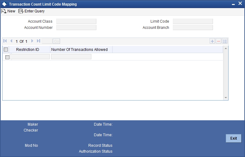

The ‘Transaction Count Limit Code mapping’ screen enables you to map a limit code to an account class or account number. This screen is used to capture the number of transactions allowed for the restriction IDs linked to the limit code. You can invoke this screen, by typing ‘STDTCLMM’ in the field at the top right corner of the application toolbar and click the adjoining arrow button.
Account Class
Select the account class to which the limit code needs to be linked from the adjoining option list. All active account classes as maintained in the system are displayed in the list of values.
Account Number
Select the account number to which the limit code needs to be linked, from the adjoining option list. This can be selected in special cases where account level restrictions are different from account class level. All accounts maintained for the given account class and corresponding account branch code is displayed in the list of values.
In this field, you also have an option of selecting ‘All’ account numbers. Mapping for ‘All’ accounts can be maintained at the head office level only. Mapping for specific accounts can be maintained only in the home branch of the account.
Account Branch
The branch code of the selected account number is displayed. If “ALL” is selected in the account number field, “ALL” is displayed in this field as well.
Limit Code
Select the limit code that needs to be linked to the account class or account number, from the adjoining option list. All limit codes as maintained in the ‘Transaction Count Limit Code Maintenance’ screen is displayed in the list of values.
Restriction ID
Select the Restriction ID for which the restriction needs to be applied from the adjoining option list. All restriction IDs maintained under the given limit ID is displayed in the list of values.
Transaction Allowed
Specify the number of transaction allowed for the selected Restriction ID.
If the “Transaction Counter” value is greater than or equal to the “Transactions Allowed” value, then the system will not allow the transaction to proceed. An error message “This transaction is exceeding the number of transactions (Number) for the restriction code (Restriction Code) allowed for the (Period )” will be displayed.
Note
Only a single limit ID can be attached to an account class, account number, and account branch. Also, if for a given customer account restriction is not required, as an exception, (whereas the corresponding account class to which it belongs to has restrictions), a mapping can be maintained without any restriction ID. This will signify that no restriction is applicable for the given customer account.
If a transaction count limit code mapping is modified, the changes will be effective from the modification date onwards. When specific account mapping is closed, the transaction counter will not be reset till the period end. However, comparisons are done with the allowed number of transaction maintained for “ALL” accounts for the account class.

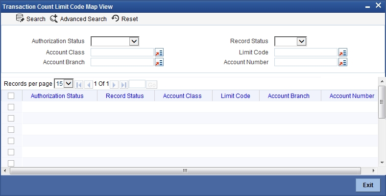

You can view a summary of transaction count limit code mapping in the ‘Transaction Count Limit Code Mapping Summary’ screen. To invoke this screen, type ‘STSTCLM’ in the field at the top right corner of the application toolbar and click the adjoining arrow button.
You can search for records based on one or more of the following parameters:
Once you have specified the parameters, click the Search button. The system displays the following details of all records that match the specified criteria:
