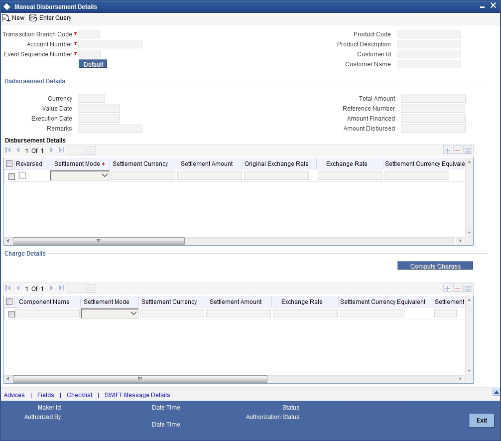

You can initiate a manual disbursement through the ‘Manual disbursement’ screen You can invoke this screen by typing ‘CLDMNDSB’ in the field at the top right corner of the Application tool bar and clicking on the adjoining arrow button.
To begin the disbursement, click on the New icon in the toolbar of the screen. Enter the account number and click the ‘Default’ button. The system defaults the details based on product definition and the account maintained by the bank for the account. You can modify the relevant details.
Transaction Branch Code
The code of the login/sign-on branch is displayed here. However, you can select a different branch from the option list provided. It is the branch where the loan account of the customer resides.
Account Number
Select the Loan Account of the customer to which the disbursement is made. All valid accounts are available in the option list. Select the appropriate one from this list.
Event Sequence Number
The system displays the event sequence number of the current disbursement transaction..
Product Code
The system displays product code associated with the specified account number.
Product Description
The system displays description of the displayed product code.
Customer ID
The system displays ID of the customer holding the specified account number.
Customer Name
The system displays name of the displayed customer ID.
The following disbursement details have to be captured in the ‘Disbursement Details’ section of the screen:
Currency
The system displays the disbursement currency
Value Date
This is the date when the credit entry (for the disbursement amount) is posted to the Cr Settlement Bridge. The current system date is displayed here.
Execution Date
This is the date on which the disbursement is booked in the system. The current system date is displayed here. You may change the date to a date in the future before the maturity date of the loan.
Remarks
Capture any additional information about the disbursements, if required.
Total Amount
This displays the sum total of the amount disbursed across the various settlement modes. It gets incremented by the amount settled.

Settlement Mode
You can make disbursements either through a single mode or by using multiple modes of settlement, depending on the customer’s requirement.
The settlement details that need to be captured depend on the mode you select. The list of modes and the applicable settlement details are given below:
Note
Atleast one mode is mandatory to make a disbursement.
Settlement Currency
After specifying the settlement mode for the disbursement, select the currency in which the disbursement is to be made. The currencies allowed for the branch are available in the option list provided.
Settlement Amount
Here, you have to capture the disbursement amount that is to be settled through the selected mode in the selected currency.

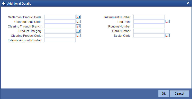

You can capture the additional settlement details by clicking the ‘Additional Settlement Details’ button under disbursement details.

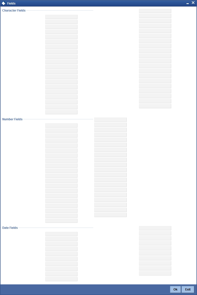

You can enter values for the UDFs that you have associated with the DSBR event in the ‘Account Event UDF’ screen. To invoke this screen, click ‘Fields’ button in the ‘Manual Disbursement’ screen.
The system allows you to enter different values for the same UDF for events that gets repeated for the same loan account. For instance, if you have multiple disbursements for a Loan Account, you can capture different values for UDFs for different disbursements.

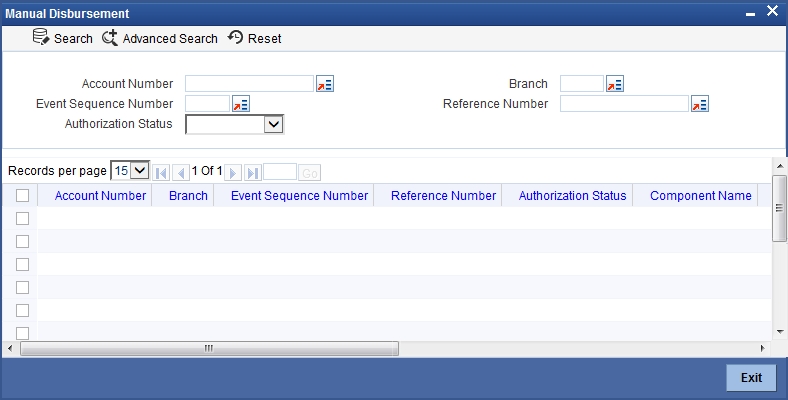

You can view the LC contract using ‘Manual disbursement’ screen. To invoke this screen, type ‘CLSMNDSB’ in the field at the top right corner of the Application tool bar and click the adjoining arrow button.
You can click ‘Search’ button to view all the pending functions. However, you can to filter your search based on any of the following criteria:
Account Number
Select the account number from the option list.
Select the event sequence number from the option list.
Authorized
Select the authorization status of the contract from the drop-down list.
Branch
Select the branch code for which you want to check the contract from the option list.
Reference Number
Select the reference number from the option list.
When you click ‘Search’ button the records matching the specified search criteria are displayed. For each record fetched by the system based on your query criteria, the following details are displayed:
Click ‘Advanced Search’ to display the screen below:
You can query a contract based on any of the following details:
