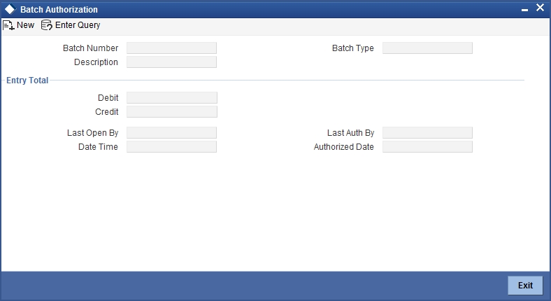

4.2.1 Authorizing Batch
You can invoke the ‘Journal Batch Authorization’ screen by typing ‘DEDBTHAU’ in the field at the top right corner of the Application tool bar and clicking the adjoining arrow button.
If automatic generation of batch numbers has been allowed at your bank in the ‘Bank Wide Parameters’ screen, the system automatically generates the batch numbers sequentially. The number of the first batch will be 0000. The series in which the subsequent batch numbers are generated is as follows:
When all the batch numbers are used up, system will display a message stating that all the available batch numbers have been exhausted.
Batch Number
If your bank has not opted for automatic generation of batch numbers, enter a number for the batch in the Batch Number field. You can enter a number between 1 and 9999. If the Batch Number that you have specified is not already in use, you can use the batch to post the transactions that you will enter during the day.
At the description field, you may enter a description for the batch. Every time you reopen, view, delete or authorize the batch the description will be displayed.
An entry in the Check Total field is not mandatory. If the total debit and the total credit, generated by the transactions to be posted in a batch, is known upfront you can enter the values (in LCY) in the Check Total field. In case the actual debit and credit totals posted to the batch do not match the entries in this field, you cannot leave the Teller Entry Form. In such a case, check the transactions that have been entered and correct those that have been erroneously entered or missed out on.
In case you entered a wrong check total in this field, you can change it in the ‘Batch Summary screen’. Click on ‘Batch’ in the Teller Entry Form. The ‘Batch Summary’ screen will be displayed.
Entry Total
Enter any value as the debit and credit total.
Reopening batch
You can reopen a batch that you opened earlier.
To reopen a batch, select ‘Reopen’ from the Actions menu in the Application tool bar or click reopen icon. When you reopen a batch, the system ensures that you are the user who originally opened the batch. You cannot reopen a batch that has been opened by another user — even if it is not in use. The System Administrator has to reassign the batch to you before you can use it.
Deleting batch
If you opt to delete a batch, the system checks if the entries that have been passed into the batch were passed by you. That is, if you were the original user of the batch. If not, you cannot delete the batch. The system also checks if the batch is in use. If it is, you cannot delete the batch. You can delete a batch from the Batch Browser. To delete a batch, select ‘Delete’ from the Actions menu in the Application tool bar or click delete icon.
Note
When you delete a batch all unauthorized transactions in it will be deleted.

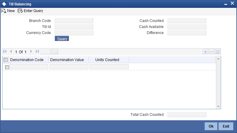

4.4 Till Balancing
This section contains the following topic:
4.4.1 Balancing Till
Till balancing involves checking of the physical balance in the Till (actual balance) against the till balance according to the system. All Tills that have been used for Teller transactions during the day have to be ‘balanced’ before the end-of-day. Note that a Till used by a teller cannot be assigned to another unless it is balanced.
Note
All currencies in a Till have to be balanced for the Till to be considered balanced.
You can balance a Till through the ‘Till Balancing’ screen. You can invoke this screen by typing ‘DEDTILBL’ in the field at the top right corner of the Application tool bar and clicking the adjoining arrow button.
Specify the following details.
Branch Code
The currency logged-in branch is displayed.
Till Identification
Specify the till that has to be balanced. The adjoining option list displays all valid tills maintained in the system. You can select the appropriate one.
Currency Code
Specify the currency in which the till has to be balanced. The adjoining option list displays all valid currency codes maintained in the system. You can select the appropriate one.
Cash Counted
Specify the amount counted based on which till has to be balanced.
Cash Available
The system displays the till balance.
Difference
The system displays the difference between the system computed till balance (cash available) and the manual amount that has been counted (cash counted).
Denomination Code
Specify the denomination code based on which you have counted the balance in the till.
Denomination Value
The system displays the value of the denomination based on the code.
Units Counted
Specify the number of units counted per denomination.
Total Counted
The system computes the total amount based on the units counted per denomination and displays the amount.

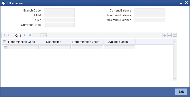

4.5 Till Position
4.5.1 Marking Till Position
You can query on till position through the ‘Till Position’ screen. You can invoke this screen by typing ‘DEDTILPO’ in the field at the top right corner of the Application tool bar and clicking the adjoining arrow button.
Here you can capture the following details.
Branch Code
Specify the branch code based on which you want to query on till position. The adjoining option list displays all valid branch codes maintained in the system. You can select the appropriate one.
Click ‘Query’ button. The system displays the following details for all tills in the branch:
4.5.2 Denomination Button
You can view denomination details for tills by checking the box alongside a record and clicking the ‘Denomination Details’ button.
You can view the following details:
