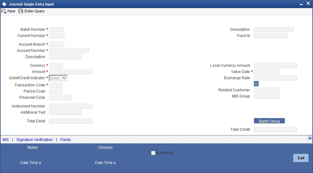

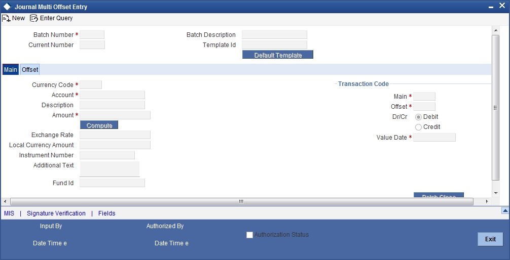

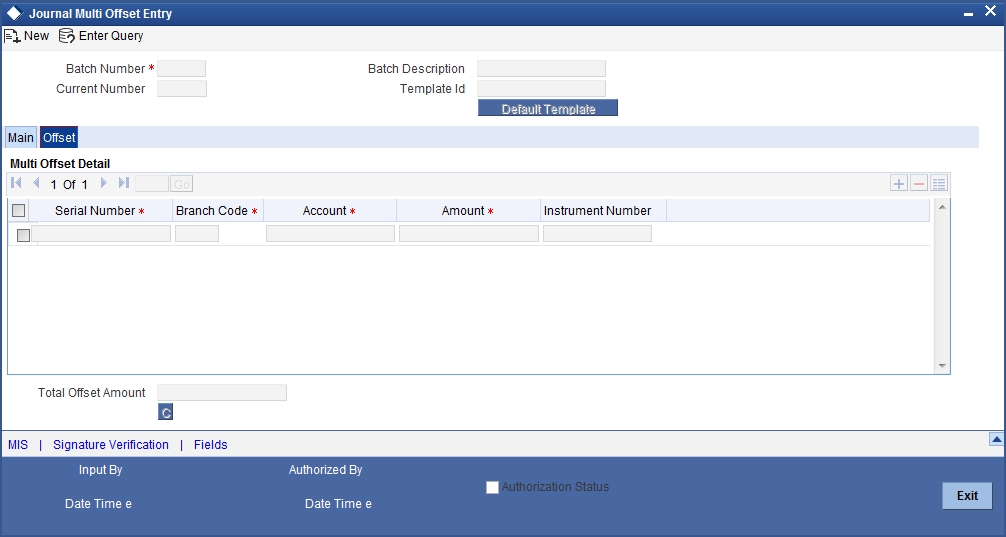

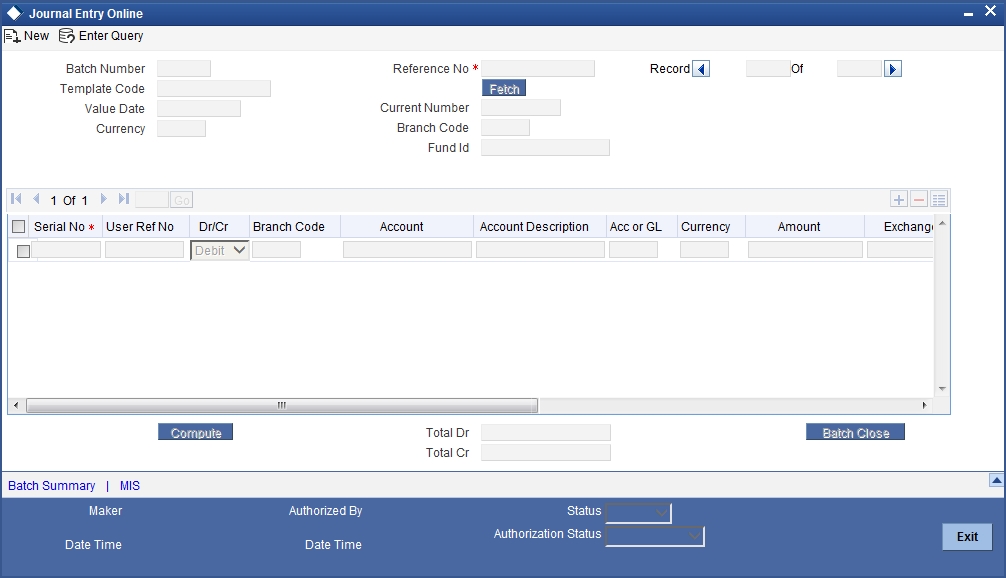

Journal transactions are typically used to post adjustment entries passed to internal accounts.
If a transaction involves one debit entry and multiple credit entries (or one credit entry and multiple debit entries), it may be referred to as a multi-offset entry transaction. The following is an example of a multi-offset transaction.

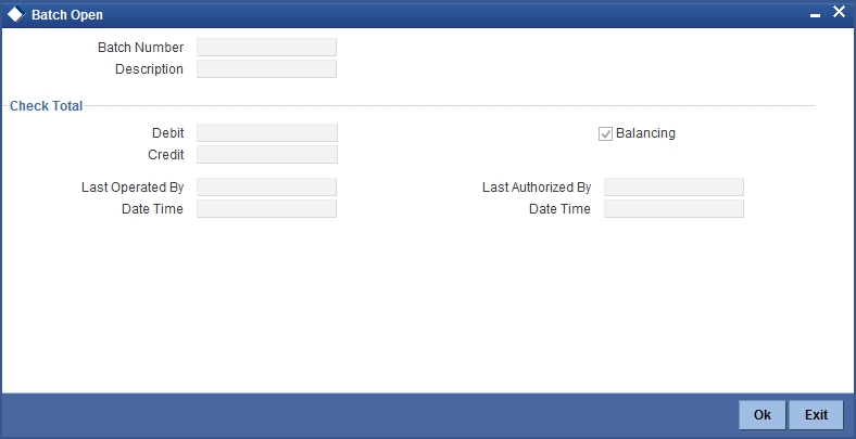

Before you start your regular teller operations for the day such as cash deposit, cash withdrawal etc., you have to perform two preliminary operations. You have to:
These operations are referred to as Beginning-of-day Teller operations. (Please refer the chapter ‘Beginning and End-of-Day operations’ for details).
Now that you have opened a batch and a till — with sufficient cash in it — you can begin teller operations for the day.

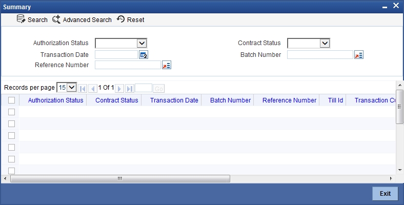

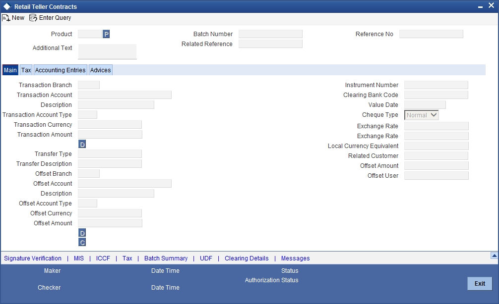

You can enter a teller type transaction in the ‘Teller Transaction Input’ screen. You can invoke this screen by typing ‘DEDTLRON’ in the field at the top right corner of the Application tool bar and clicking the adjoining arrow button.
In this screen, you have to specify the following details for a transaction:
Product
Based on the type of transaction that you are entering, you have to select a product that you have maintained in the system.
To select a product, click on the option list adjoining the ‘Product Code’ field. A list of the products that you have maintained in the branch will be displayed. Click on the product that you would like to offer the customer.
When you select a product the transaction acquires the attributes that you have defined for the product.

Transaction Branch
Specify the branch code wherein transaction is being posted. The adjoining option list displays all valid branch codes available in the system. You can select the appropriate one.
Transaction Account
Typically, you would have to manually enter the account number of the customer involved in the transaction, in this field. However, if the transaction account is a GL, you can click the adjoining option list to invoke a list of the GLs that have been maintained in your branch Double click on the GL that is the transaction account
Note
If you defined an Account Head (the GL/SL) for a product, while creating it, it will default as the Transaction Account for a transaction involving the product.
Description
The system displays a brief description of the account.
Transaction Account Type
Indicate whether the account should be debited or credited.
Transaction currency
The Transaction Currency, by default, is the local currency or the currency of the transaction account. If you want to enter a transaction in any other currency, click on the adjoining option list. Choose a currency from the displayed list by double clicking on it.
Transaction Amount
Enter the Transaction Amount. The amount entered should be within the maximum and minimum transaction amount defined for the product. The transaction size should not exceed the limit defined for the teller.
On saving the transaction after entering all the required details in the system, the system validates the value of the transaction amount against the following:
If the transaction currency and the limit currency are different, then the system converts the amount financed to limit currency and checks if the same is in excess of the product transaction limit and user input limit. If this holds true, the system indicates the same with below override/error messages:

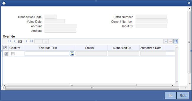

The system will display an override message in the following cases:

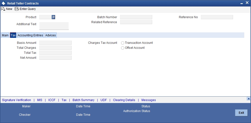

The taxes and charges defined for the product default to the transaction. You can view the tax and charge details that apply on a transaction. In the ‘Teller Transaction Input’ screen choose the ‘Tax’ tab. The taxes and charges that apply to the transaction will be displayed. You can change the tax/charge amount calculated for the transaction. To change the charge/tax amount displayed, click the ‘Tax’ button in this screen.
While processing a transaction, you should indicate the following details.
Amount
The transaction amount specified in the ‘Main’ tab is displayed here.
Total Charges
The sum of all charges applicable as per the linked product is displayed here.
Total Tax
The system computes the tax applicable on the transaction amount and displays it here.
Net Amount
The net transaction amount post deduction of applicable charges and tax is displayed here.
Charges/Tax Collection Account
Indicate the account from which you would like to collect the tax. Typically, this would be the account that you have designated as the Transaction Account. You may also choose the Offset Account. Click the ‘Tax’ or ‘Charge’ button to specify the collection account.

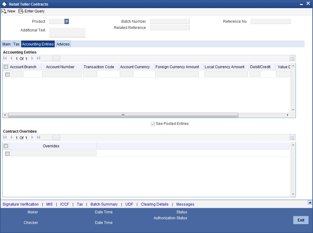

You can view the accounting entries generated by the transaction that you are processing by clicking on the ‘Accounting Entries’ tab in the ‘Teller Transaction Input’ screen.
The following details are displayed here.
See Position Entries
Check this box to view currency position of the entries.
A list of all the system overrides displayed when the transaction was input can also be viewed.

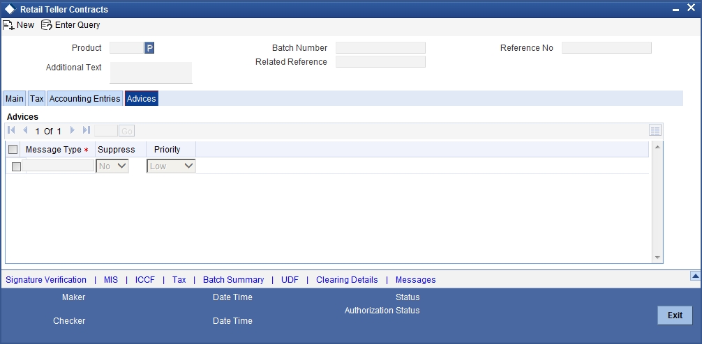

You can print the advices specified for the product the transaction involves. You can view the advices specified for the product while processing a transaction by clicking on the ‘Advices’ tab in the teller input screen.
Here, you can opt to generate, or suppress, an advice that has been defined for the product the transaction involves. You can also prioritize advice generation according to your convenience.

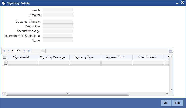

While booking the transaction, you can verify the signature of the customer by invoking the ‘Signatory Details’ screen. To invoke this screen, click ‘Signature Verification’ button.
You can view consolidated customer signature in the ‘Customer Signature/Image Consolidated View’ screen. To view this screen, click ‘All Signatures/Images’ button.
Refer the User Manual on Signature Verification for further details about this screen.

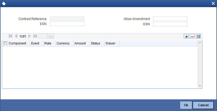

Based on the ICCF maintenance at the product level, the charge details are defaulted for the contract. However, you can change them. Charges will be recovered from the charge or tax account specified in this screen. Click ‘ICCF’ button and invoke the following screen.
Refer the section titled ‘Specifying Charge Details’ in the chapter ‘Defining Attributes of a Teller Product’ in this User Manual for details about this screen.

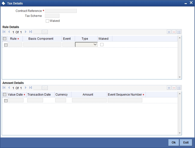

Based on the tax maintenance at the product level, the tax details are defaulted for the contract. However, you can change them. Charges will be recovered from the charge or tax account specified in this screen. Click ‘Tax’ button and invoke the ‘Tax Details’ screen.
Refer the section titled ‘Specifying Tax Details’ in the chapter ‘Defining Attributes of a Teller Product’ in this User Manual for details about this screen.

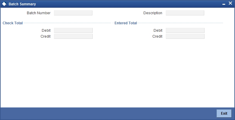

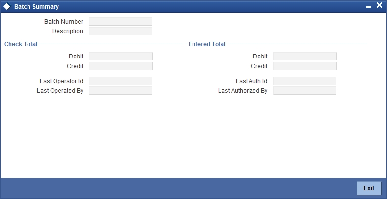

Click ‘Batch Summary’ button and invoke the ‘Batch Summary’ screen. You can view the cheque and entry total pertaining to the batch.
You can view the following details here:

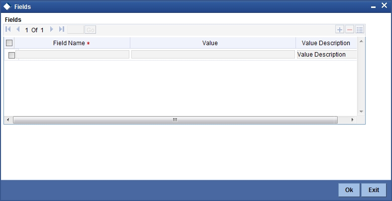

Click ‘UDF’ button and invoke the ‘Fields’ screen to specify values for user-defined fields.
Here you can capture the following details:
Field Name
The system displays all UDFs linked to the product.
Value
Specify a value for each UDF.

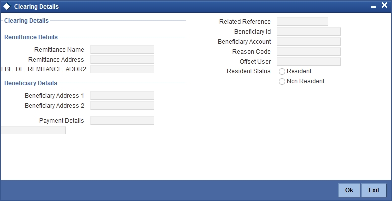

Click ‘Clearing Details’ button and invoke the ‘Clearing Details’ screen to view clearing details for the transaction.
You can view the following details:

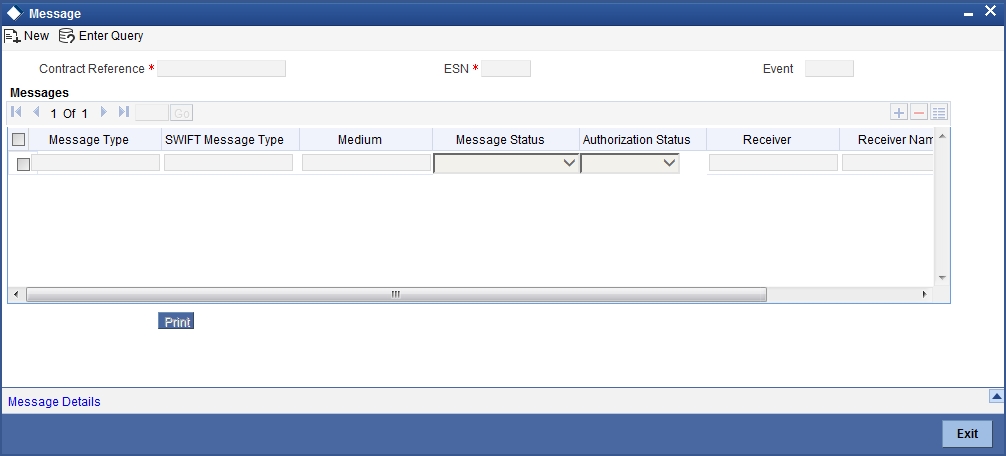

Click ‘Messages’ button and invoke the ‘View Messages’ screen to view messages that have been generated based on the advices defined at the product level.

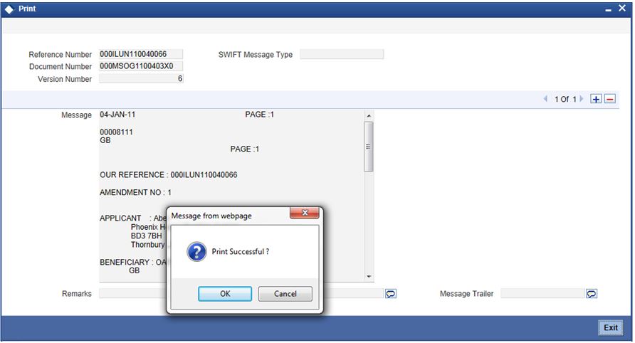

Print Button
Click the print button to print the advices that are generated. When you click the EXIT button the system displays a message if the advices are printed for the first time, Click OK if the print is successful.
Note
When Duplicate Advice Tracker field is checked and you click the EXIT button on the advice generation screen, the system displays a message “Print Successful?”. Click OK button to confirm the successful printing. Every subsequent print of the advices will be considered as duplicate advice. For more information on Duplicate Advice Tracker refer to section “Messaging Branch Parameters Maintenance” in the Core User Manual.

Changing the Check Total
On occasion, you may not be able to close a batch because you entered an erroneous Check Total while opening the batch. In such a case, you can correct the check total in the Batch Summary screen.
To correct the check total, invoke the ‘Batch Summary’ screen from the ‘Teller Transaction Input’ screen. In the Check Total field in this screen you can enter the correct debit and credit check totals for the batch. The total of the debit and credit entries that you have posted in the batch will be displayed in the Entry Total field.
You can correct the check total values in the Check Total field and update them in the system. You may or may not opt to use the changed values. If you opt not to use the original Check Total values the system will use the original values to tally the actual entries that you post to the batch.
You can view a summary of all teller transactions using the ‘Transaction Summary’ screen. You can invoke this screen by typing ‘DESTLRON’ in the field at the top right corner of the Application tool bar and clicking the adjoining arrow button.
You can query on records based on any or all of the following criteria:
Click ‘Search’ button. The system identifies all records satisfying the specified criteria and displays the following details for each one of them:
Double click on a record to view the detailed screen.

How to reopen a batch
When in the Batch Opening screen click on reopen icon on the Toolbar or choose Reopen in the Actions Menu to reopen a closed batch.

Now that you have opened a batch, you are ready to input a journal transaction. In the ‘Journal Entry’ screen, you can enter the following details of the journal transaction that you want to enter.
You can invoke the ‘Journal Single Entry Input’ screen by typing ‘DEDTRONL’ in the field at the top right corner of the Application tool bar and clicking the adjoining arrow button.
Specify the following details.
Batch Number
The batch that you have opened to post the journal transaction is displayed at the top of the ‘Journal Entry’ screen.
Fund Identification
Select the fund id to which the journal entry account will be linked from the adjoining option list. The system defaults the value of ‘Default Mudarabah Fund’ as fund id.
Current Number
Every journal transaction that you enter into the batch is assigned a ‘current number’ by the system. This helps you identify the journal transactions that you enter for the day.
Account Number
Select the account number from the adjoining option list in the Account Number field. The journal entry will be posted to this account or GL. In case you are posting to several accounts, it is advisable to manually enter the account number in this field rather than choose it from the displayed list.
To view the joint holder’s details of an account and the mode of operation maintained at the account level, place the cursor on the Account Number field and press Ctrl+J. The system displays the ‘Joint Holder’ screen.
For more information on the ‘Joint Holder’ screen refer to the section ‘Joint Holder Maintenance’ in this User Manual.
Account Branch
In the Account Branch field, system defaults to the branch that you have logged in to. You can, choose the branch to which you want to post the journal entry.
Currency
The system displays the currency of the account number, if it is a customer account. Else, you have to enter the transaction currency, in this field. Select the currency from the adjoining option list.
Amount
In this field enter the amount of the transaction. The amount that you enter here must be in the currency of the account number that you specified.
Now you must indicate if the amount is to be credited to the account or debited from the account. To do this, you must click on either of the buttons adjacent to this field.
If the amount is to be credited to the account, click on the button against ‘Cr’. If the amount is to be debited, click on the button against ‘Dr’.
Transaction Code
Select the transaction code that you want to enter from the adjoining option list.
Period Code
The financial year of your bank is divided into four quarters. These details are maintained in the Global Parameters module.
When you input a journal transaction you must indicate the financial period to which the transaction belongs. Select the financial period for the journal entry you are entering from the adjoining option list.
Financial Cycle
The period code is further divided into financial cycles. For example, your bank’s Board of Directors meet once a month therefore, you would divide the financial cycle into monthly periods.
When you input a journal transaction, indicate the financial cycle to which the transaction belongs.
Instrument Number
In case you are entering a check transaction, you have to enter the instrument number here if the transaction code specifies an instrument number.
In Single Journal for Credit transaction instrument number should not be entered.
Additional Text
Enter any other additional information related to the transaction.
Local currency Amount
The system displays the transaction amount in case the transaction is in the local currency.
If the transaction that you are entering involves a foreign currency, the system calculates a local currency equivalent of the transaction amount using the Exchange rate that is displayed in the previous field.
Value Date
The system will display the current system date here. You can, however, enter a back dated or a future dated transaction. In Oracle FLEXCUBE, the interest is calculated on the basis of the Value Date.
Exchange Rate
In case the currency of the transaction is a foreign currency, the system displays the standard mid rate for the currency. You can change the Exchange rate that is displayed in this field. Only, the changed value should be within a certain range referred to as the Exchange Rate Variance. The exchange rate variance is specified at the Branch Level for journal transactions.
Note
In case you are entering a Foreign Currency back value dated transaction, the system will pickup the exchange rate applicable on the Value Date. This is possible only if you have maintained the Exchange Rate History for your branch (refer the ‘Branch Conditions’ screen).
Related Customer
The ID of the Customer involved in the transaction is entered in this field. This is used for MIS purposes. The adjoining option list displays a list of the Customer IDs that have been maintained in your branch. Double click on the ID that you want to enter in this field.
MIS Group
The MIS group to which the transaction belongs gets displayed here.
Total Debit
The total amount debited for the whole batch is converted into the local currency equivalent and displayed here.
Total Credit
The total amount credited for the whole batch is converted into the local currency equivalent and displayed here.
When you have entered all the details of a transaction you have to save the transaction in the system.
To save a transaction, select ‘Save’ from the Actions menu in the Application tool bar or click save icon.
The system will update the transaction as an unauthorized transaction. The user ID of the teller who entered the transaction and the date and time at which the transaction was saved will be displayed at the bottom of the screen.

You can invoke the ‘Journal Multi Offset Input’ screen by typing ‘DEDMJONL’ in the field at the top right corner of the Application tool bar and clicking the adjoining arrow button.
The following are the details of a Multi-offset transaction that you need to enter in this screen:

Overrides
If you change the exchange rate to a value between the maximum and minimum exchange rate variance
You cannot change the exchange rate to a value that is greater than the specified maximum exchange rate variance.

To enter details of the Offset leg of the transaction, click Offset.
Branch
In this field, enter the branch IDs of each of the offset accounts.
Account
Enter the account number of each of the offset accounts in this column.
Amount
For each of the offset accounts enter the offset amounts.
Instrument Number
If the Offset leg of the transaction involves an instrument number, enter the same in this column. The total offset amount will be displayed at the bottom of the screen. After you have made your specifications in the above columns map each offset entry to the branch, an account and the amount.

You can invoke the ‘Journal Entry Input’ screen by typing ‘DEDJNLON’ in the field at the top right corner of the Application tool bar and clicking the adjoining arrow button.
Once you invoke the ‘Journal Entry Input’ screen, click on ‘New’ option in the Application tool bar, to invoke ‘Batch Open’ screen.
In this screen, you can enter the following details:
Batch Number
Specify the batch number.
Description
Enter a brief description about batch.
Check Total
Debit
Enter the total debit amount of the journal transaction.
Credit
Enter the total credit amount of the journal transaction.
Balancing
Check this box to indicate whether the total debit amount and total credit amount has to be balanced.
Once you specify the batch number in the ‘Batch Open’ screen, you can specify the transaction details in the ‘Journal Entry input’ screen:
Batch Number
The system displays the batch number for which the journal entry transaction is to be created.
Template code
Specify the template code. The adjoining option list displays all valid template codes available in the system. You can select the appropriate one.
Value Date
Specify the value date of the transaction. By default the system displays current branch date value.
Currency
The system displays the branch local currency here.
Reference Number
The system will generate a unique reference number based on the batch number.
Current number
The system displays the current number for which the journal entry transaction is to be created.
Click ‘Fetch’ button once you enter the ‘Template Code’, the system will display the following details:
Branch Code
Specify the branch code. The branch code specified needs to be validated against the ‘Allowed / Disallowed’ lists maintained in the branch restrictions screen.
Fund Id
Select the fund id from the adjoining option list. The system defaults the value of Default Mudarabah Fund as fund id.
Serial No
The system displays the serial number.
User Reference No
The system displays the reference number for the journal transaction.
Dr/Cr
The system displays the debit or credit indicator based on the account class/GL for the selected template code. However you can indicate, if template code is not specified.
Acc or GL
The system displays the account number selected in the Template. However you can specify the account number/GL. The adjoining option list displays all valid account numbers/GLs available in the system. You can select the appropriate one.
Amount
Enter the amount to be debited or credited.
Ex. Rate
For the foreign currencies entered, the system displays the mid rate by default based on the value date entered. However you can modify it. The tolerance will be validated.
Amount - LCY
The system displays LCY equivalent amount.
Instrument Number
In case the transaction is through an instrument, you need to specify the instrument number.
Customer
Specify the customer. The adjoining option list displays all valid customer ids and names available in the system. You can select the appropriate one.
Total Debit Amount
The system displays the net debit amount.
Total Credit Amount
The system displays the net credit amount.
Additional text
The system displays the narration from the Template. However you can modify it.
Click ‘Batch Summary’ button on ‘Journal Entry input’ screen to invoke the ‘Batch summary’ screen.
Click ‘MIS’ button on ‘Journal Entry input’ screen to invoke ‘MIS’ screen. In this screen you can maintain the MIS value for a transaction (screen and functionality similar to single entry and multi offset entry).
You can view the summary of all journal entry input, using the ‘Journal Input Entry Summary’ screen. You can invoke this screen by typing ‘DESJNLON’ in the field at the top right corner of the Application tool bar and clicking the adjoining arrow button.
Here, you can query on journal entry input details based on any one or all of the following criteria:
Click ‘Search’ button. The system identifies all records satisfying the specified criteria and displays the following details for each one of them.
